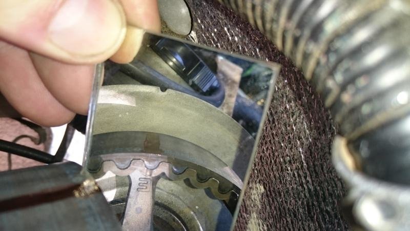

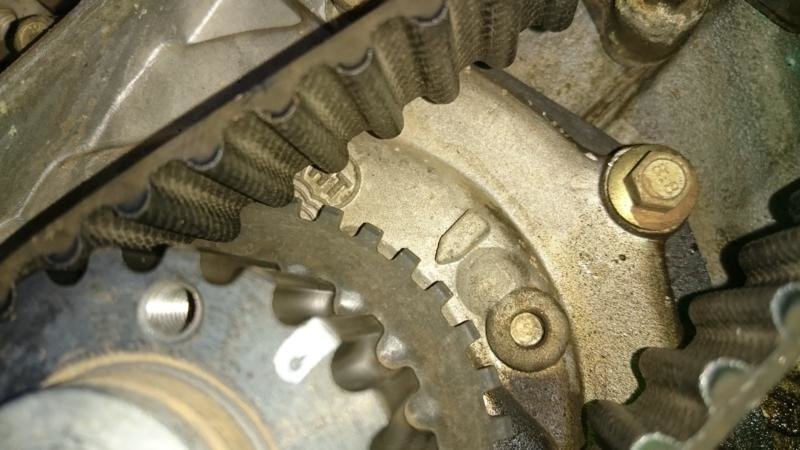

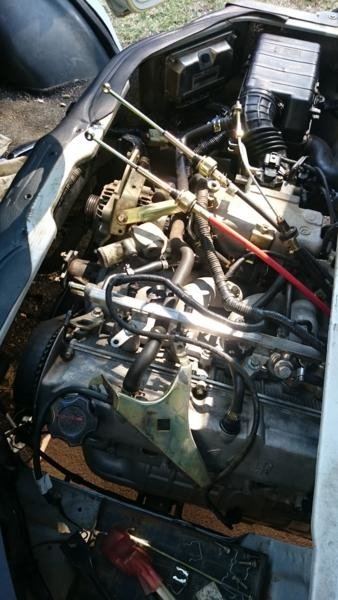

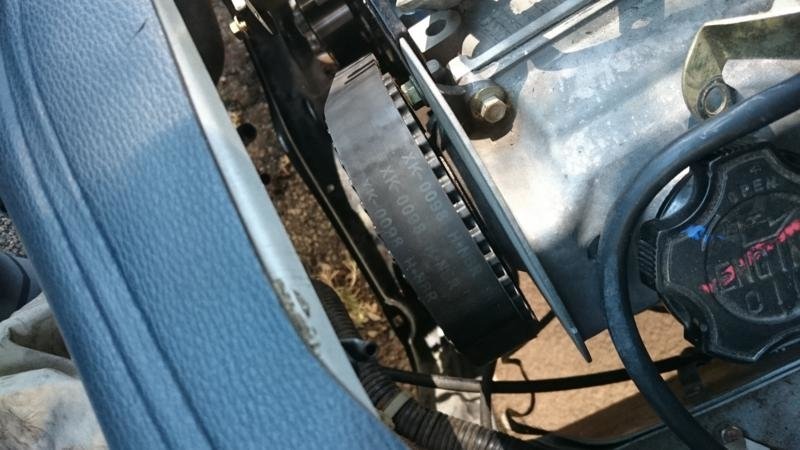

My van is a DFSK (Dongfeng Sokon) 1.3 16v
I stripped pipes & covers this morning to access my cam belt & all seems to be in order. Please note that it is impossible to where the Camshaft pulley head on, due to body work being in the way.
The symptoms definitely resembles a "one tooth out" situation, but it seems dead on.
Could a stretched belt cause this?

Nice work on the pictures, I have seen where the crankshaft key way will dig into the bottom crank gear for the timing belt which will retard the timing even though the marks are on, can you put the engine on top dead center then pull the number #1 plug and using a flash light check the piston to see if its at the top of its stroke, you will need to have someone rock the engine back and forth at the crankshaft while you watch, this will let us know if the bottom is all good.

Replaced the timing belt tensioner. Lined up the marks & confirmed #1 piston is at the top. Engine will briefly fire up at about a quarter throttle but die if there's variation on the throttle position. Sounds like it's completely flat/hollow/running on 2.
One of the belts also squeals intermittently. Tightened up the alternator's belt but the squeal persisted.
Trying to figure out how the cam belt might be squealing. I'll open all this up again tomorrow.
