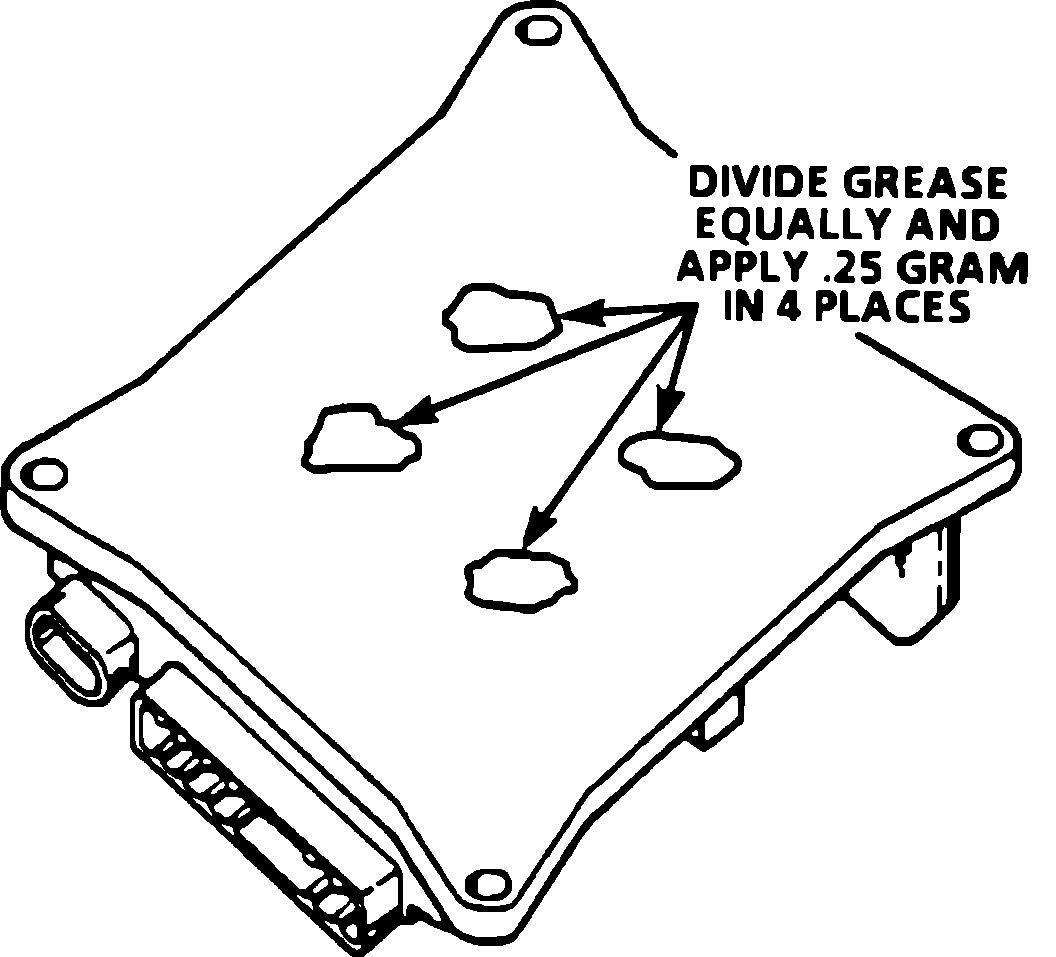

Brake fluid? I'm not sure what that would be used for. What I would suggest is to reconfirm ignition spark to the plugs. As far as the ignition module, it is under the coils. Here are directions for replacement.
The attached pic correlates with the directions.
______________________________
1993 Oldsmobile Cutlass Ciera V6-3300 3.3L MFI VIN N
Ignition Module Replacement
Vehicle Powertrain Management Relays and Modules - Powertrain Management Relays and Modules - Ignition System Ignition Control Module Service and Repair Procedures Ignition Module Replacement
IGNITION MODULE REPLACEMENT
Dielectric Grease Application
pic 1
REMOVAL
1. Disconnect negative battery cable.
2. Disconnect DIS electrical connectors.
3. Disconnect spark plug wires. (Note proper relationship of wires to coils).
4. Remove DIS assembly to block bolts (3).
5. Remove DIS assembly from engine.
INSTALLATION
1. Install DIS assembly to engine.
2. Install DIS assembly to block bolts (3). Torque to 20-30 Nm (15-22 lbs ft).
3. Connect spark plug wires to proper coils.
4. Connect DIS electrical connectors.
5. Connect negative battery cable.
_______________________________________________________
I hope this helps you. Please let me know if you have other questions. I believe some of the parts stores have the ability to test the module, so you may want to have it checked before replacement.

After changing the unit I have gotten it to run for a second or two 2 times, but it still doesn't run.

Coil 1/4 no longer have spark after replacing the module. I will test my injectors tomorrow. I ruled out the crank position sensor assuming if it was faulty it would throw a code and when I checked nothing came up. If this is not the case I will also look into it.
