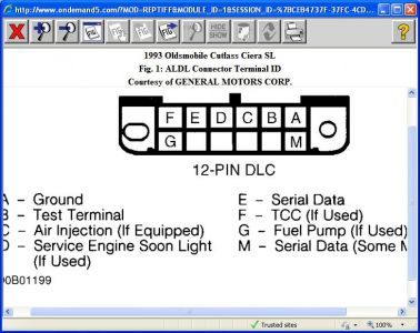

https://www.2carpros.com/forum/automotive_pictures/416332_1993_oldsmobile_cutlass_ciera_code_retrival_part1_1.jpg

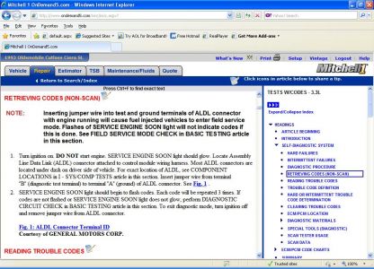

https://www.2carpros.com/forum/automotive_pictures/416332_1993_oldsmobile_cutlass_ciera_code_retrival_part2_1.jpg
First of all thank you so much for your donation.If you could please see if you have any code's i posted how you can do that for you.Also have you checked all the fuse's?You need to get a a noid light hook it up to each injector wire harness and have someone crank the engine while you watch for the noid light to flash.When you replaced the computer did you have it programed or was it programed already?Did you swap your prom chip from your old computer to your new computer?Also did you change your computer for this no start condition?

To check the code's you only need a jumper wire I posted how you can do that. Also from what you tell me you said it will run on starter fluid so sound's like you have spark. You said you have 42lbs of fuel pressure so sound like you have enough pressure there. Looks like we should be looking to see if you have a injector pulse no pulse no fuel goes into the engine and no start. Your going to have to get a few basic tools to figure it out. It's cheaper to get the tools then guess wrong most of the time. Have you checked all the fuse's yet?

So you have no ground injector pulse to the dark green or dark blue wire's?Also can you check for code's that may help us find the problem.
