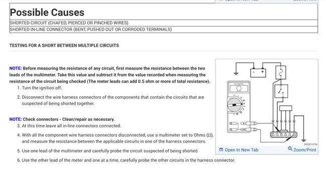

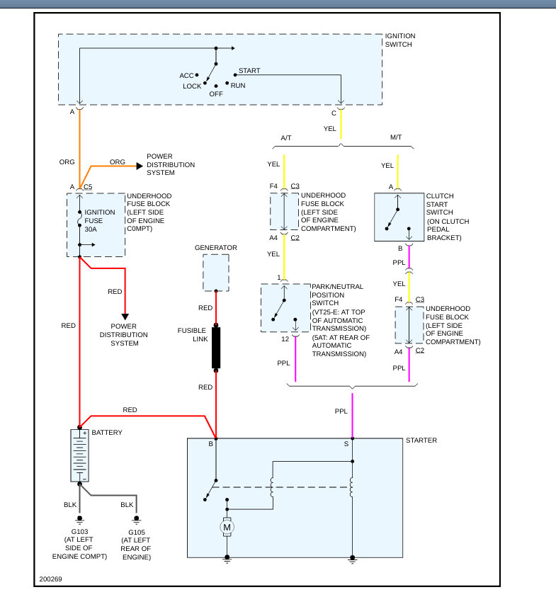

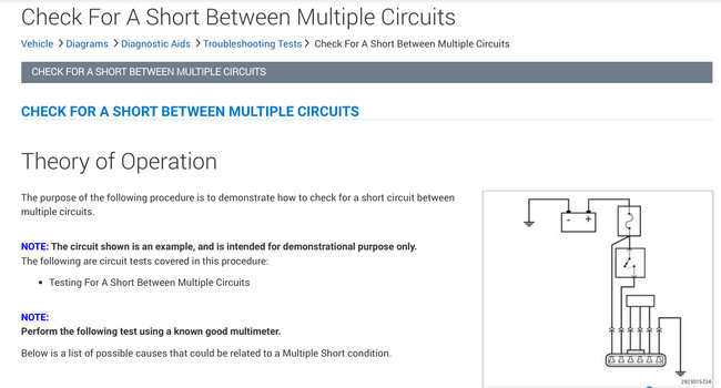

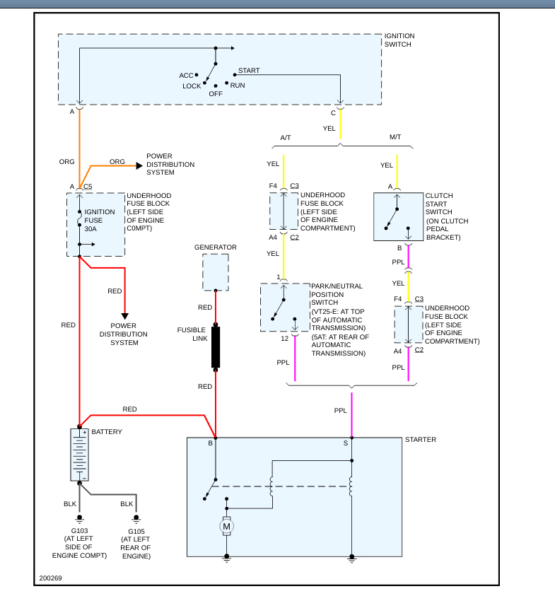

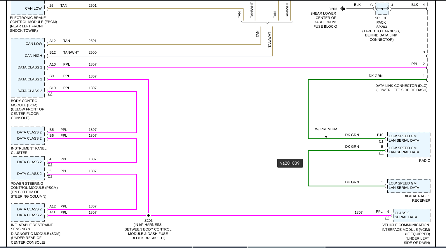

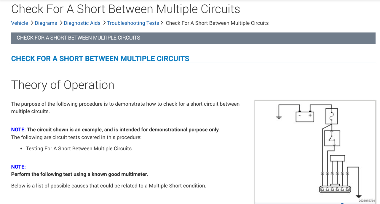

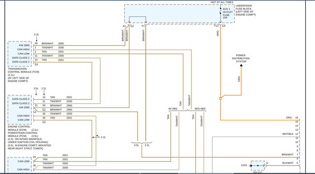

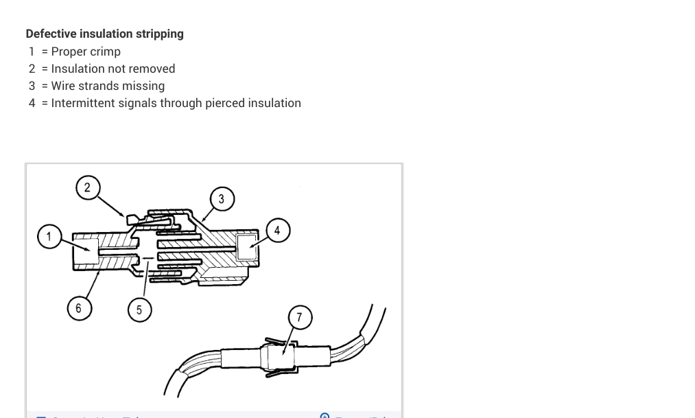

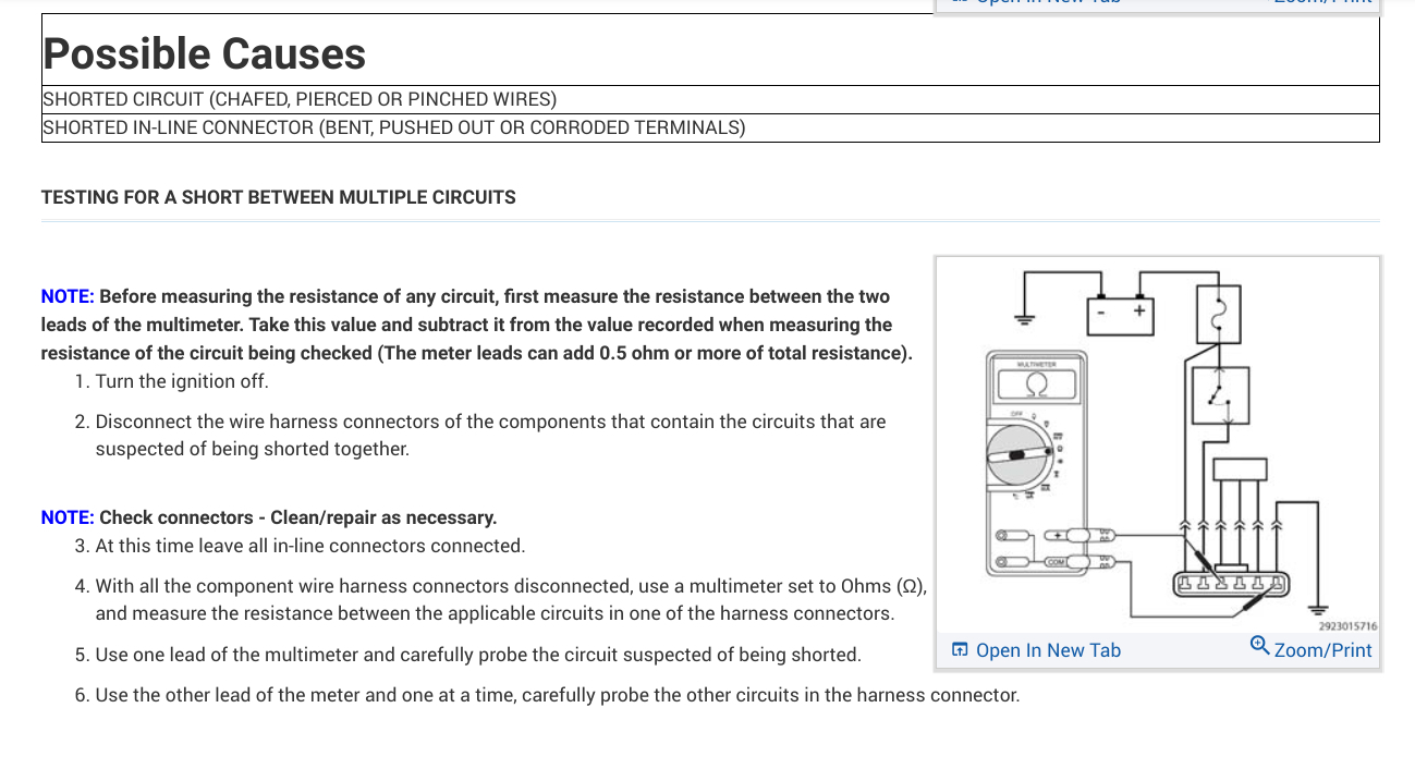

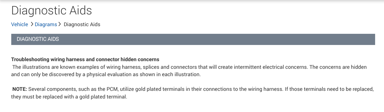

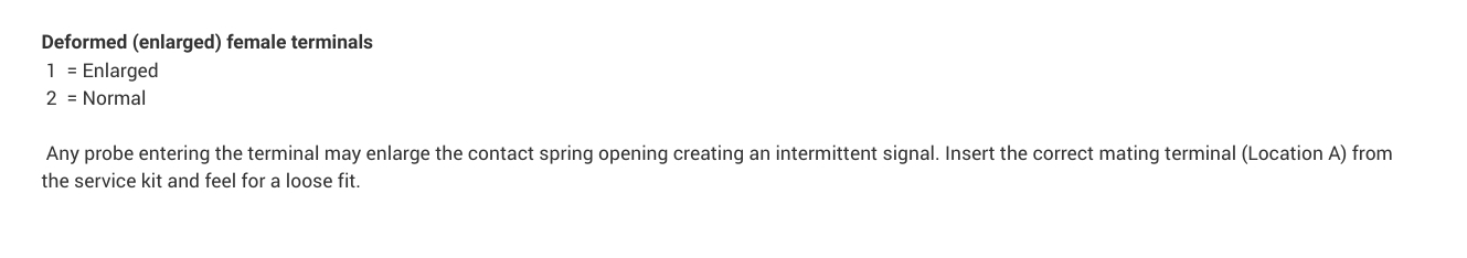

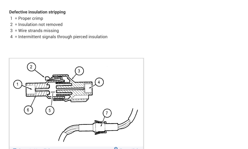

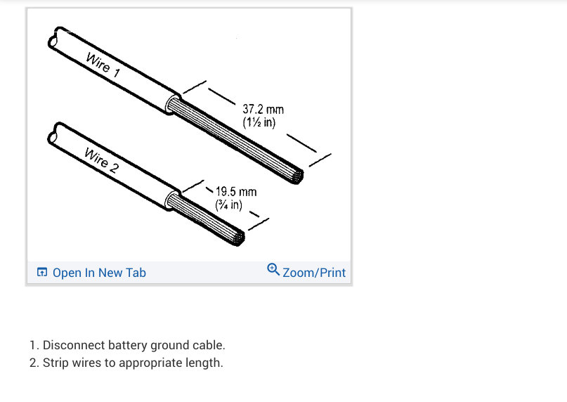

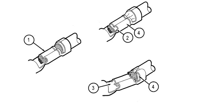

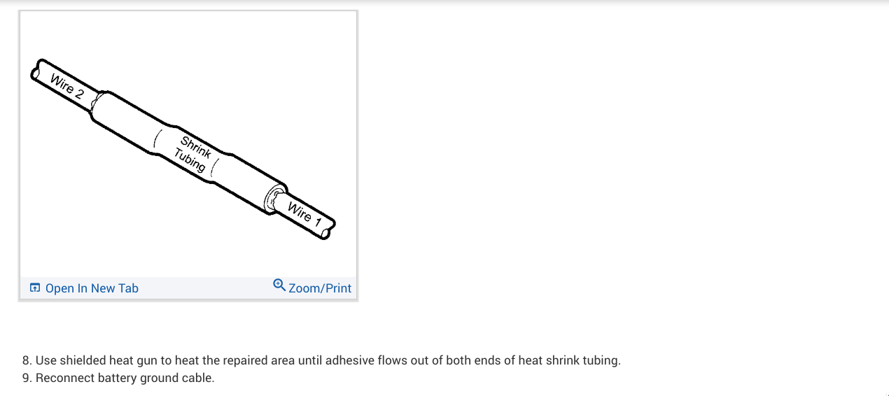

Hello again,

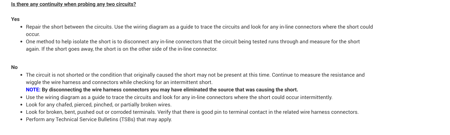

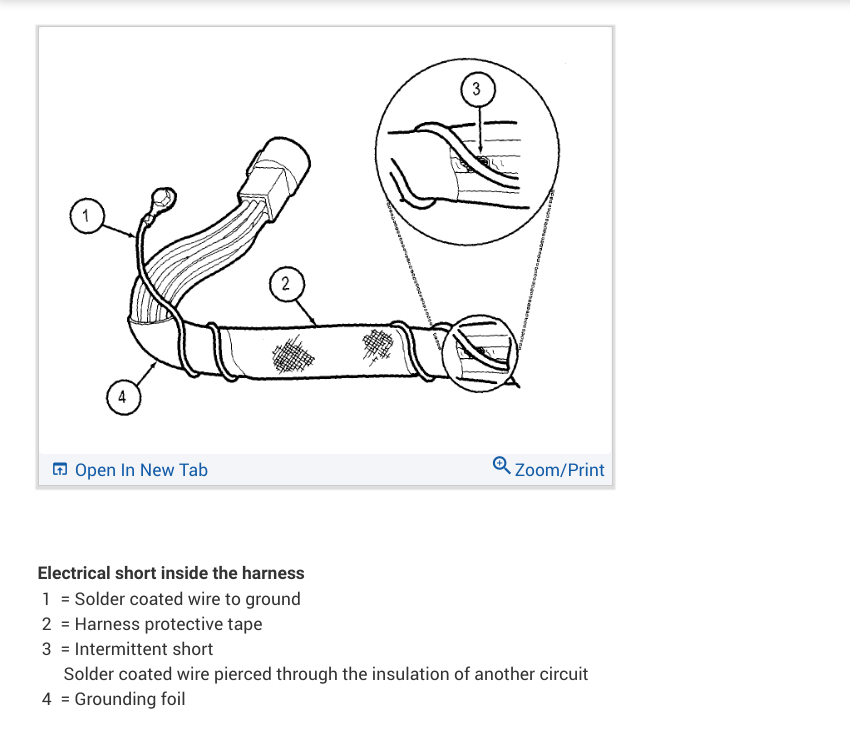

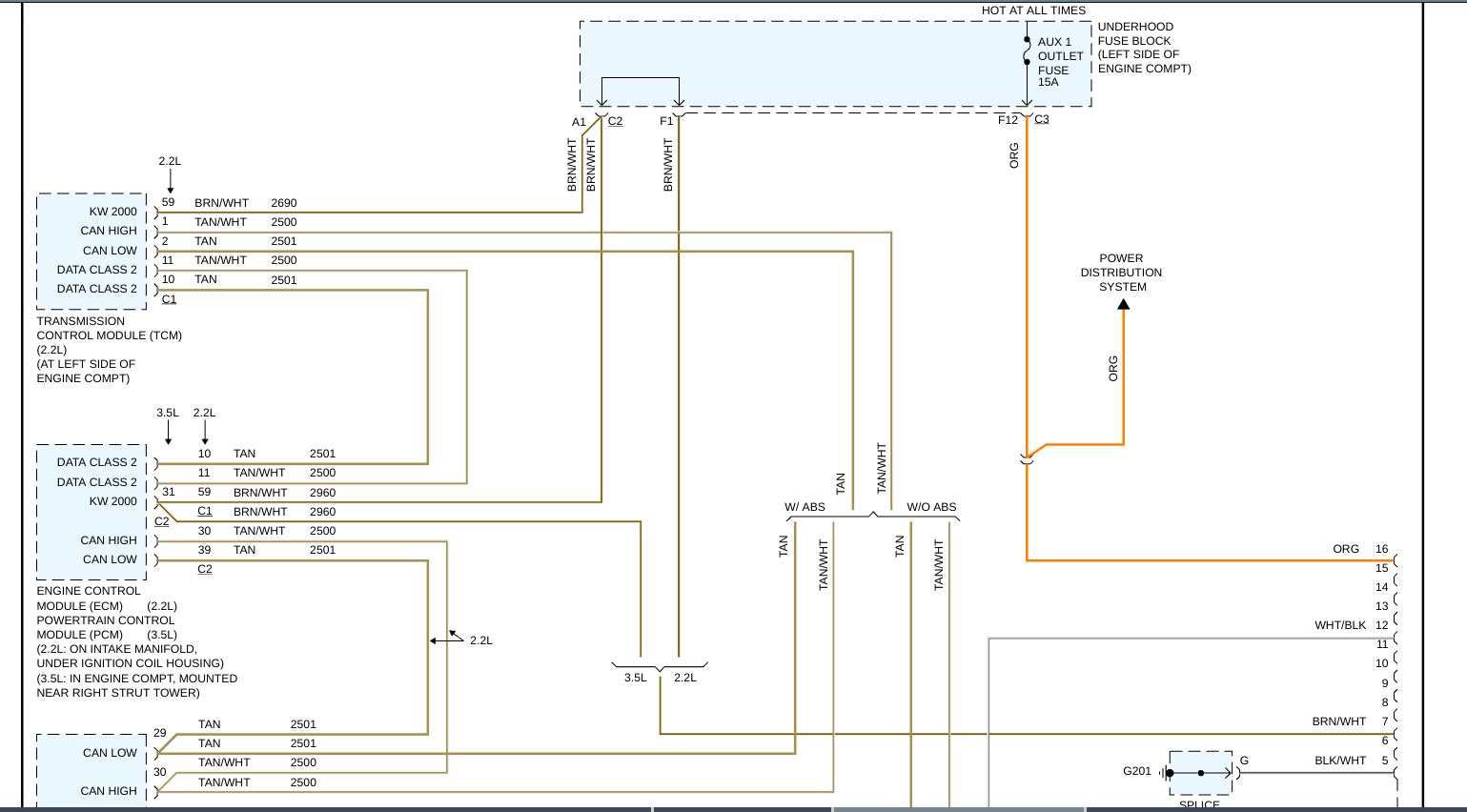

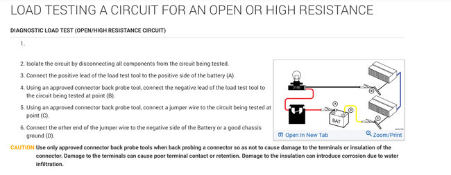

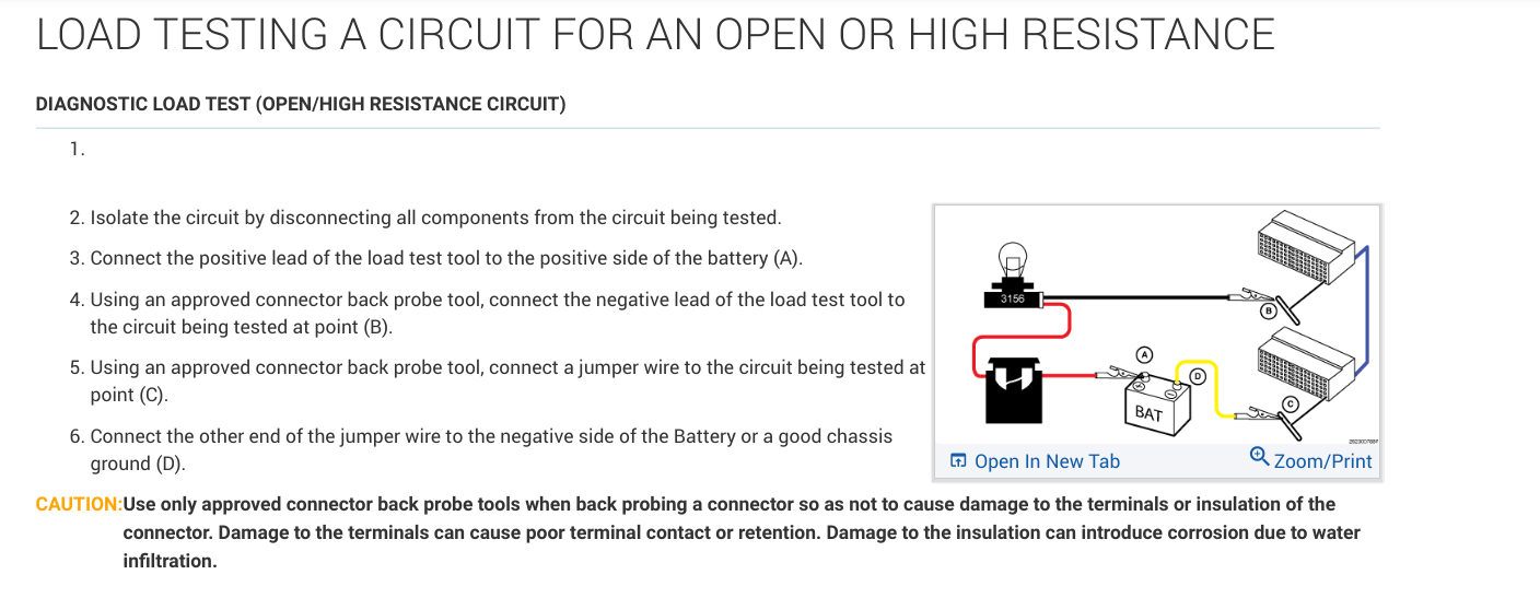

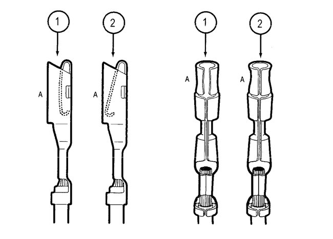

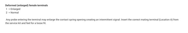

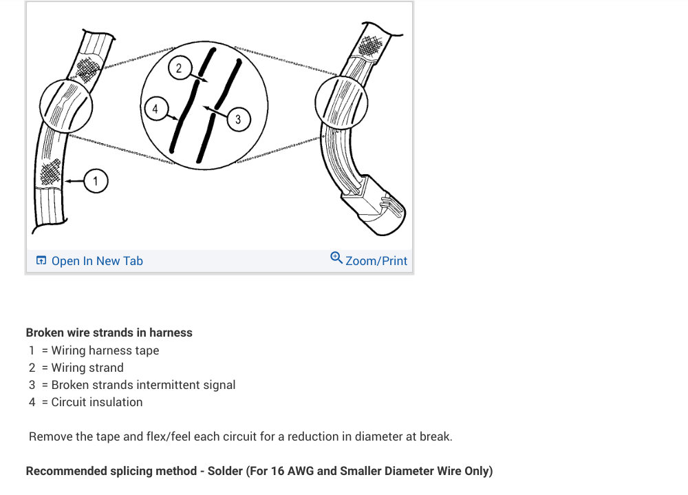

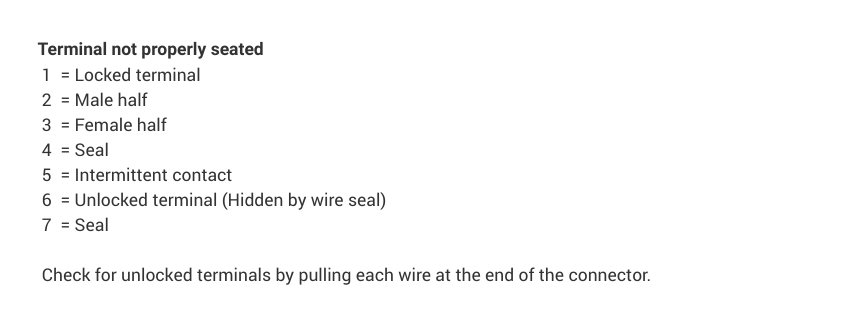

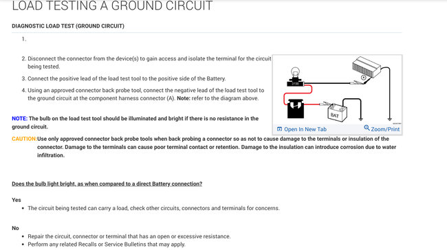

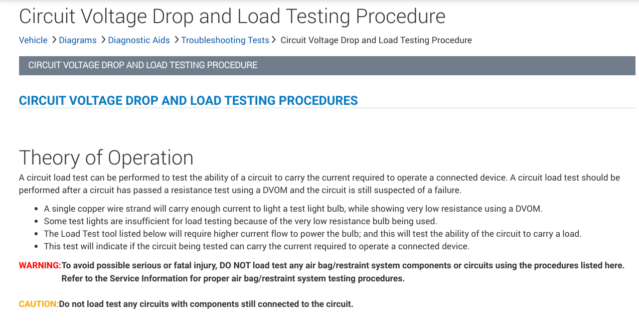

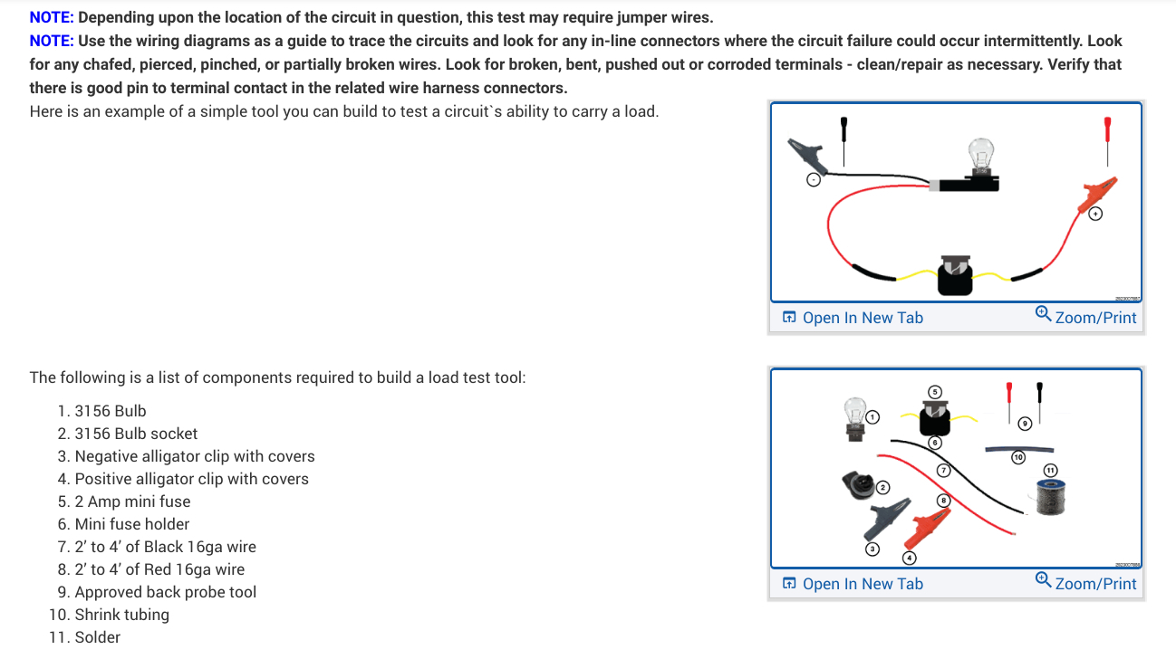

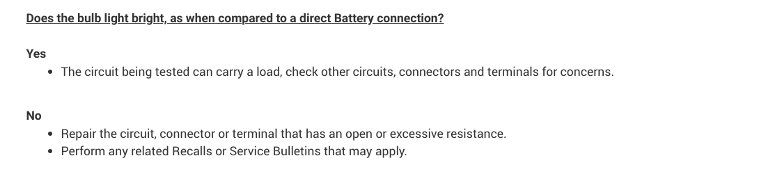

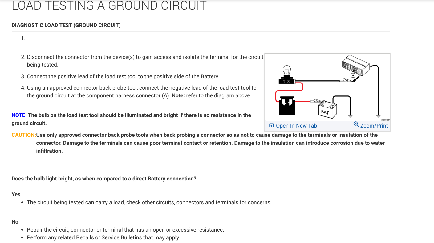

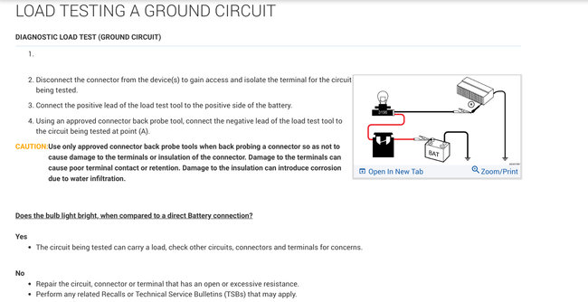

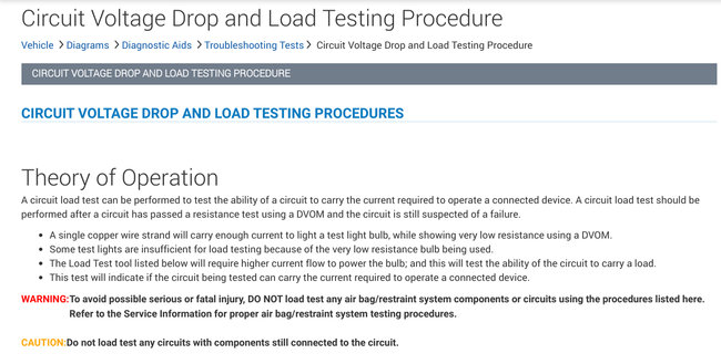

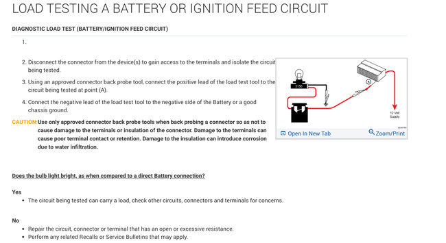

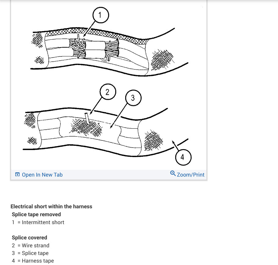

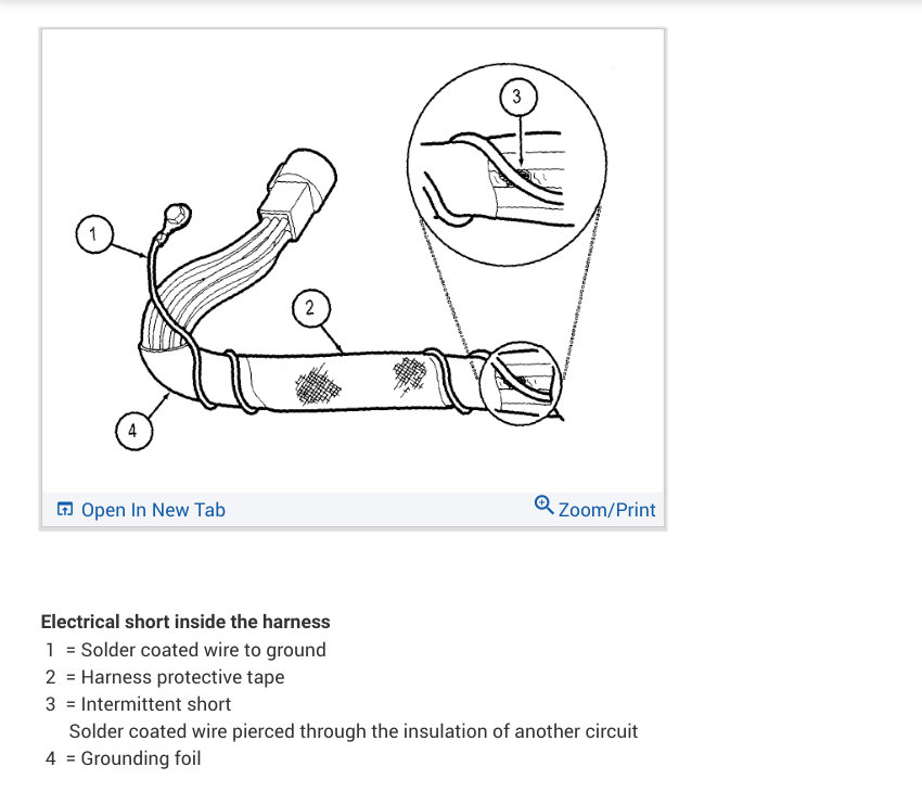

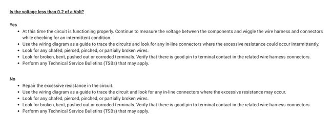

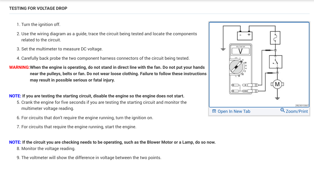

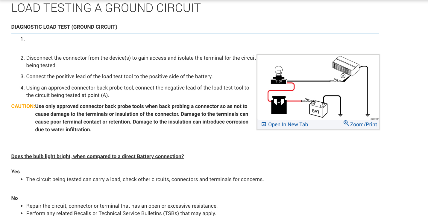

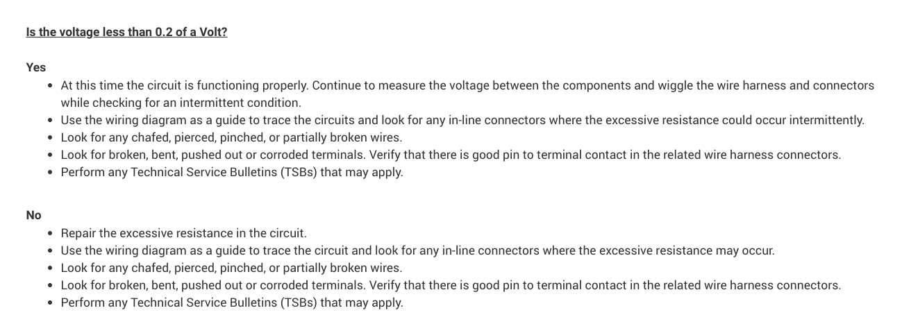

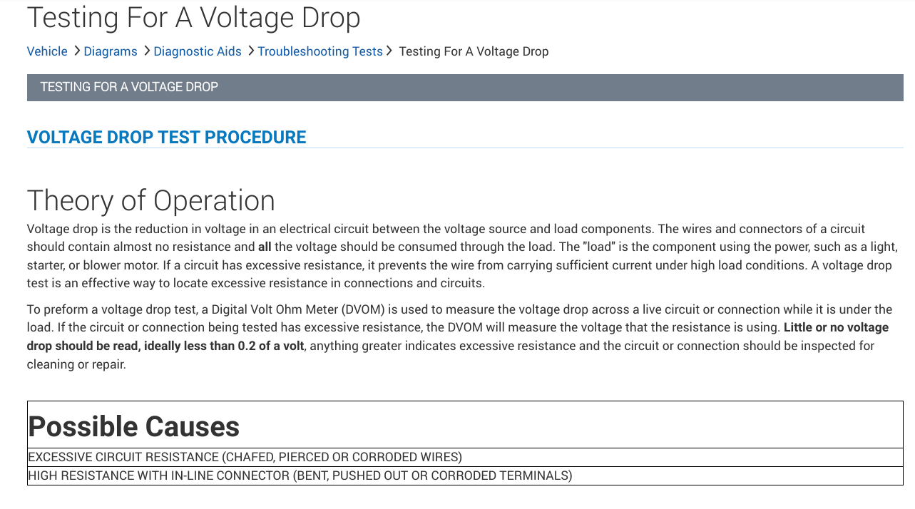

Okay, my mistake. I misunderstood the question. So this sounds like it could be a short to power between the Controller Area Network wires and your vehicle's starting circuit. Also there could be a problem with the ground strap going from the engine block to the vehicle frame. This would account for the white smoke as the amperage from the battery would encounter high unwanted resistance on it's way back to the negative battery terminal. In the diagrams down below I have included the wiring diagrams for the Controller Area Network and the starting circuit for your vehicle. I have also included guides on how to find unwanted resistance in an automotive electrical circuit with voltage drop and the causes of unwanted resistance in an automotive electrical circuit for you as well. Please go through these guides and inspect the wiring harness and ground strap and get back to us with what you are able to find out. You will need to use a Digital Multi-meter [DMM] to use these guides so here is a link below explaining the use of one, if needed:
Thanks,
Alex
2CarPros
