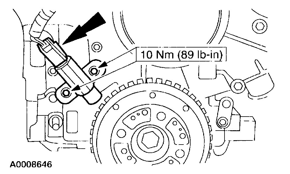

Hi and welcome back:
Yes, it could be a crankshaft position sensor. I focused on the fuel system because you were working on it. Here is a link that shows symptoms, another that shows in general how one is replaced:
Here are the directions specific to your vehicle. It is for both the 4.0L and the 5.0L:
REMOVAL
NOTE: The 5.0L is shown, the 4.0L SOHC and the 4.0L (push rod) engines are similar.
1. Disconnect the battery ground cable. For additional information, refer to battery.
2. Remove the Crankshaft Position (CKP) sensor.
INSTALLATION
1. To install, reverse the removal procedure.
NOTE:
4.0L SOHC and 4.0L (push rod) CKP sensors need to be touching the damper. The CKP sensor has wear tabs that will wear off after several engine revolutions.
Be sure sensor wiring is routed away from the battery cable.

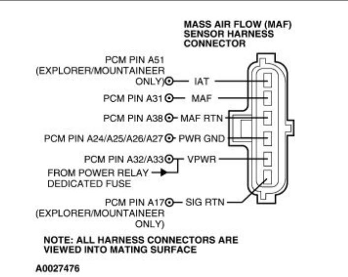

It wont start until I unplug the mass air flow sensor. Then it stops when I mash the gas. Why?
Tuesday, December 29th, 2020 AT 12:18 PM (Merged)
  • 52,797 POSTS

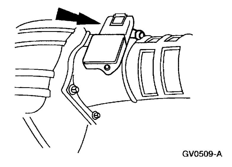

Good morning,
Did you replace the mass airflow sensor? It could cause it not to start.
https://www.2carpros.com/articles/how-to-replace-a-mass-air-flow-sensor-maf
Are there any codes set in the system?
I attached a pin out for the connector. Can you do some checks at the connector?
