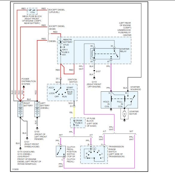

I put a new starter and fuse in, we were even able to put two clamps on the starter underneath and do a jump to see if it would jump start and it would. It would not do a full start but would turn over, all lights work, when I turned the key you could hear a clicking sound in the fuse box and that is gone. You can hear the fuel also. So I was told it might be the purple wire. I'm not sure what that is and is this hard to take care of? Do I need to do a complete wire from battery to starter or ignition to starter? What do you recommend? Thank youu so much for your help

Good evening,
There is a lot to the starting system. It starts at the ignition switch to the fuse block to the relay and then to ground.
I attached a wire diagram for you to view. If you have a voltmeter we can do some checks at the relay.
