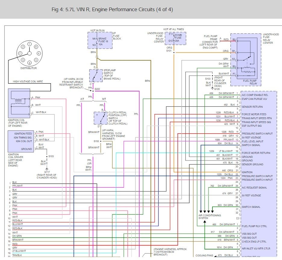

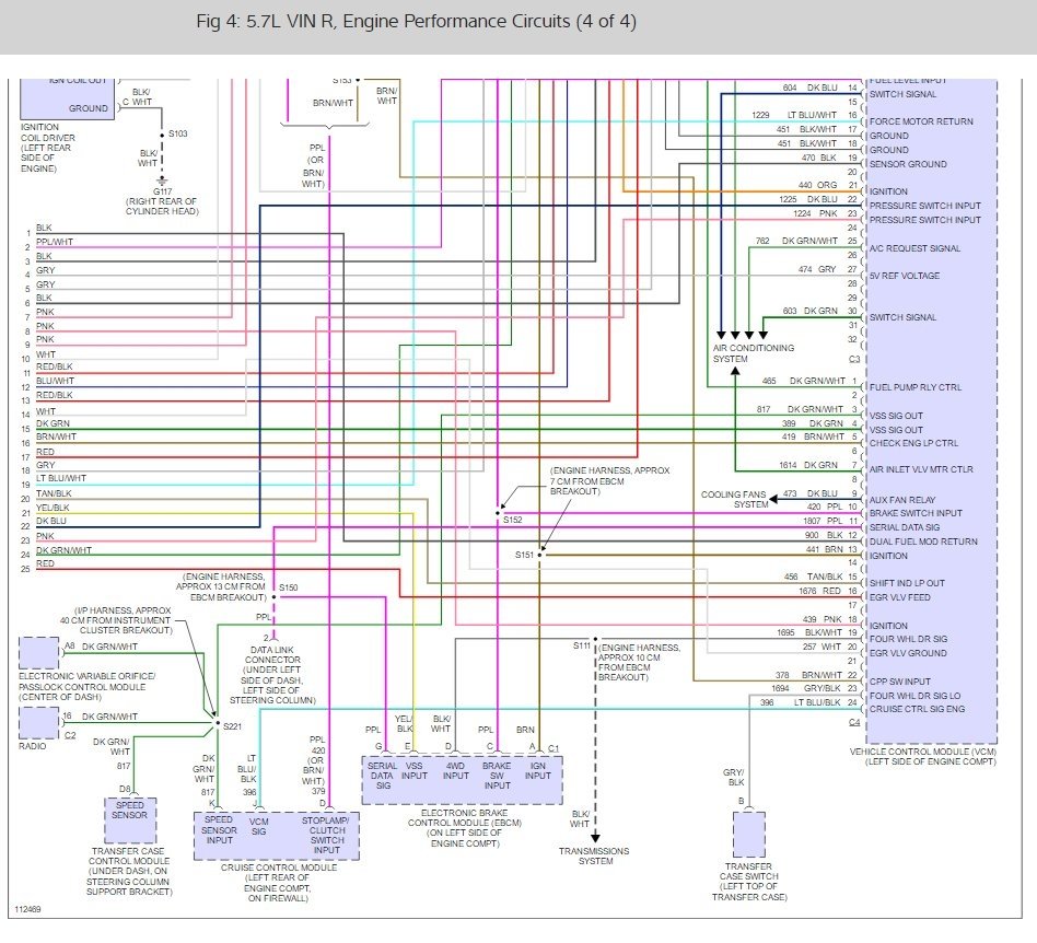

engine will not run. replaced gas tank, fuel pump. engine runs with gas being poured into throttle body, but when you quit pouring gas engine stalls.
May 15, 2017 at 6:54 AM
  • 55,710 POSTS

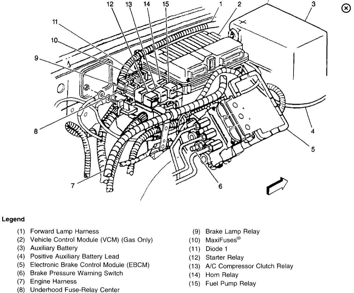

It sounds like the fuel pump is not getting power. Can you hear it run in the back?. Here is a wiring diagram for the fuel pump and the location of the relay.
Please run some tests and get back to us so we can continue helping you.
