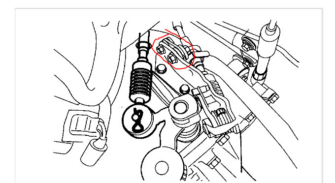

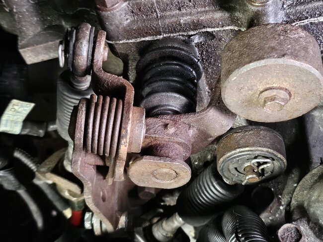

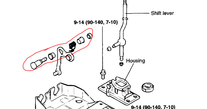

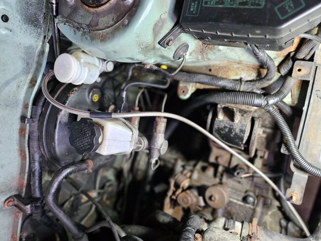

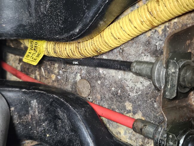

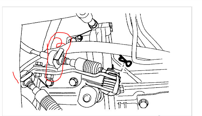

I attached three pics below. The last pic I numbered. Number two, I believe, is where we are looking on your part.
Also, it appears a bolt broke. In your second picture, which is a welded nut to the part and you can still see the threads from the original bolt still there.
Let me know if this helps. Looking at the manual and then your pics, the orientation is different, so I had to spin the laptop in circles a few times to make sense of it. LOL

I fixed that but it still won't shift. I thought for sure that was it.
Wednesday, February 7th, 2024 AT 5:21 PM
ANN SENN
  • 49 POSTS
Lol yes, I get mixed up on some diagrams the same way. I extracted the partial bolt out and put new one in but still something else.

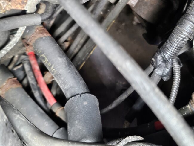

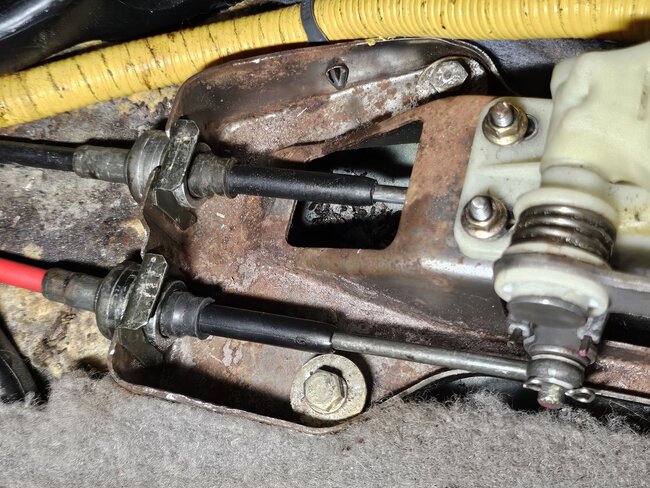

Hi Ann, are the cable retainers holding the cables properly, not allowing them to move? Also, could you take a couple of pics of what you have and upload them for me to see?
Let me know what is happening at this point.
Thanks,
Wednesday, February 7th, 2024 AT 6:05 PM
ANN SENN
  • 49 POSTS
Sure. The cables are in there correctly I believe, I went off the pics.

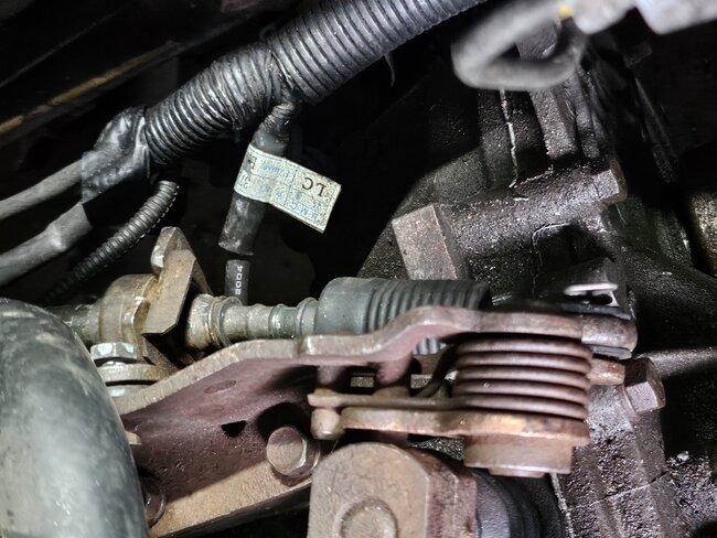

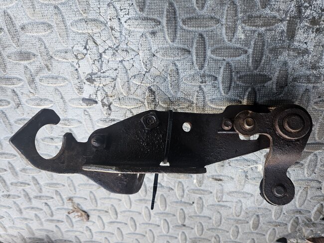

So sorry for the delay, I was sick as a dog but here are the pictures.
Saturday, February 10th, 2024 AT 2:03 PM
  • 109,951 POSTS
Sorry to hear you've been sick.
Everything looks good in the pics. When you try shifting, can you see movement in the cables at the transmission?
Saturday, February 10th, 2024 AT 6:02 PM
ANN SENN
  • 49 POSTS
Yes, they seem to work correctly now. Not sure if I told you when I push the car in gear it no longer rolls. That was the linkage issue that was fixed.

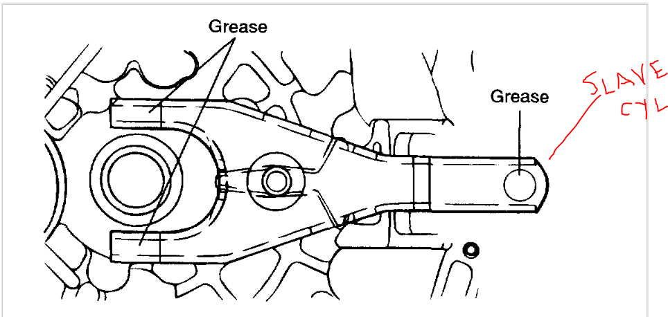

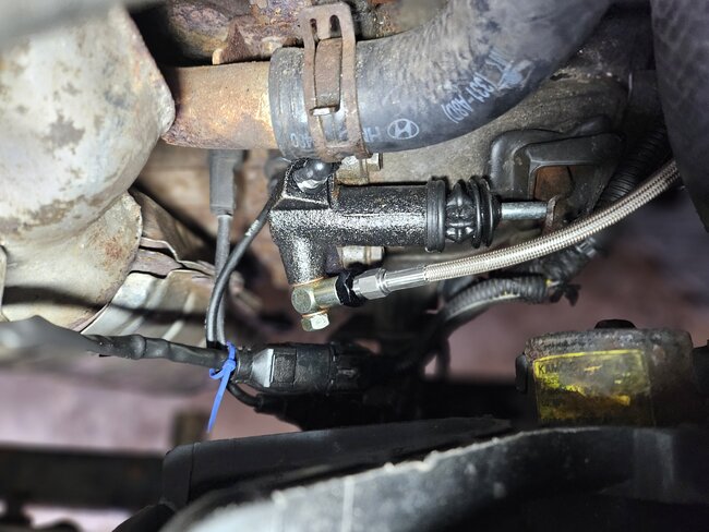

  • 109,951 POSTS

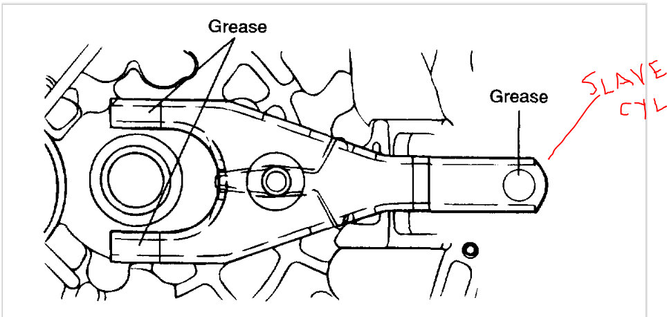

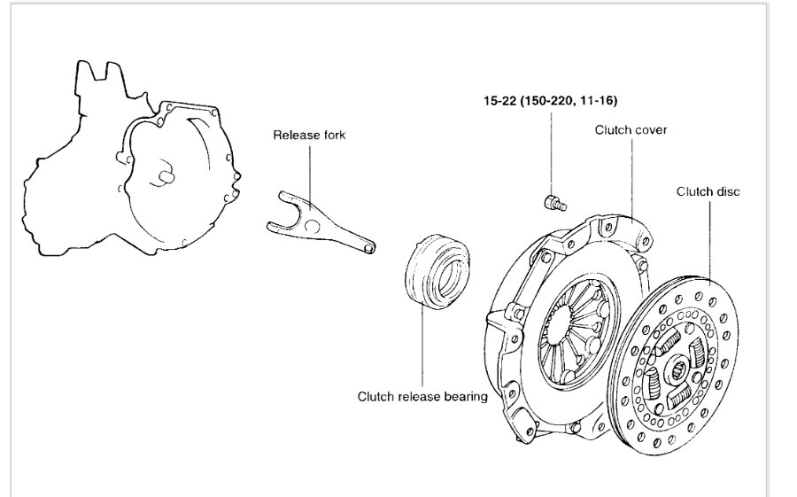

I went back and watched the slave cylinder operate. It appears to work correctly. Even if the transmission was internally locked, when you press the clutch, it should disengage and allow you to shift.
Take a look at the two pics below. When the clutch was replaced, did you inspect the clutch release fork? Is it reaching the release bearing to disengage the clutch? Something in there isn't doing what it is designed to do.
