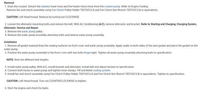

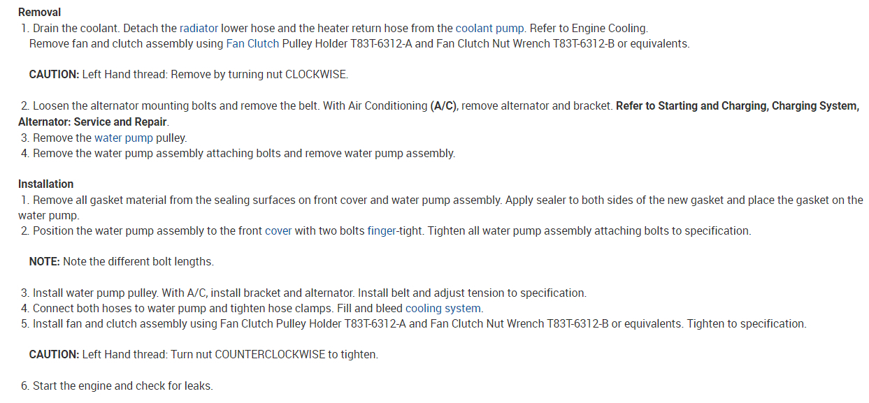

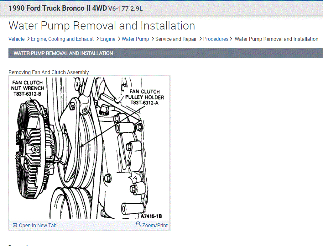

Now, the water pump. To get you started, here is a link that shows in general how it is done:
https://www.2carpros.com/articles/water-pump-replacement

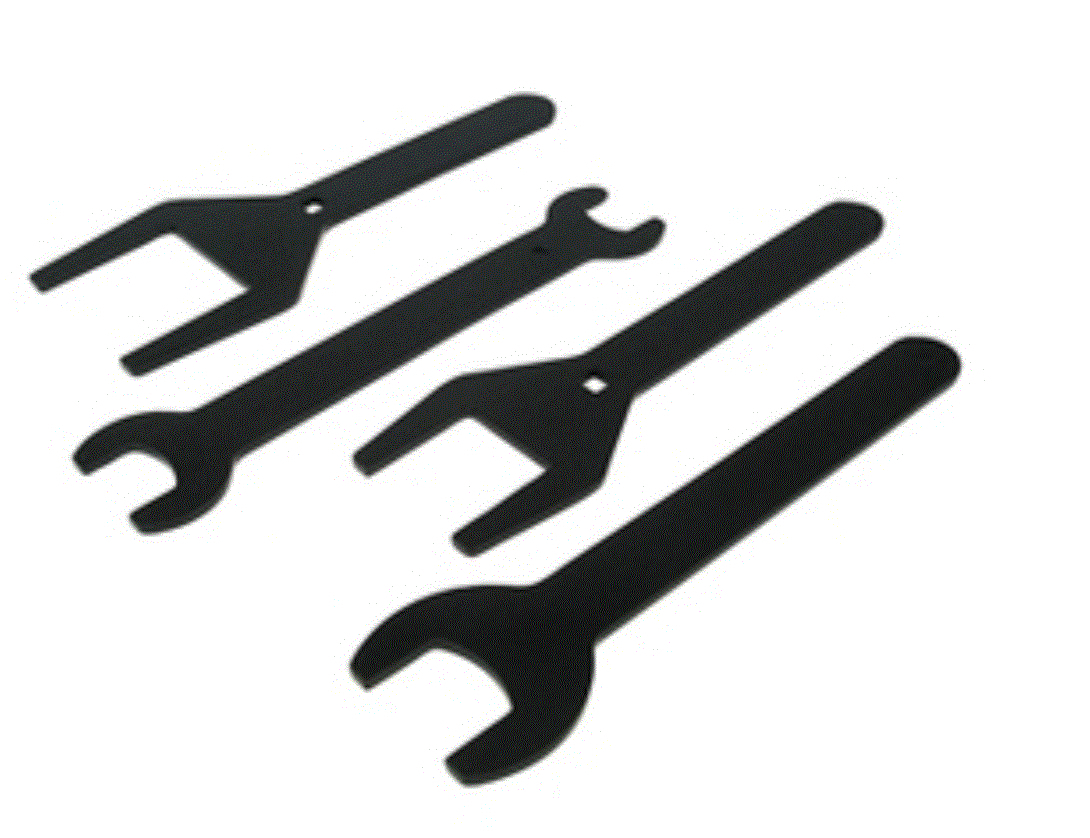

If you look at the attachments below, they are the directions specific to your vehicle for the replacement of the water pump. As far as the fan, yes it will need removed and reinstalled on the new pump. This will require a special tool that holds the fan clutch while loosening the nut retaining the clutch to the pump/pulley. However, most parts stores will lend you the tool to do it. Pic 3 below shows what the special tools look like.
