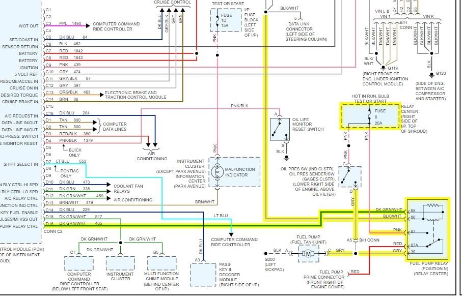

CHARLES STEELE
  • 37 POSTS
Pump does not run. had an over the dirt bank and bounced a couple of time now no fuel. does this have a impact shut off sensor and if so where? I cannot see one by the center of dash on floor like usual.
Aug 4, 2020 at 9:21 AM (Merged)
Good afternoon,
No, the only car with an inertia switch is Ford products.
Did you look under the car at the tank and check for damage? You may have damaged the tank where the fuel pump sits.
Can you check the connector for power to the fuel pump?
Check the grey wire in the connector at the tank.
CHARLES STEELE
  • 37 POSTS
No damage to tank wires and hoses all good. can't check connector right now need to get car up in air at my age I can no longer crawl under it.
Got it. Check it when you can and get back to us.
Aug 4, 2020 at 9:22 AM (Merged)
CHARLES STEELE
  • 37 POSTS
Darn online parts computer lie all the time. it said switch available for Buick and also sold me cabin filter for 2002 Toyota that does not have.
Do not use internet for anything for a car. They are usually wrong.
CHARLES STEELE
  • 37 POSTS
I have a 6 hour round trip drive to closet town with a parts store so i buy most of my parts on line from Napa, Rock Auto or AutoZone and have them shipped we live way out in Nevada outback, UPS only comes out this way 2 times a week.
Okay, I get it.
Rock auto is the one I trust the most. I have dealt with them for years with no issues.
What were the results of the checks for the wiring? I would not order anything until you know the issue.
CHARLES STEELE
  • 37 POSTS
has power. need to drop tank but can't get bolts that hold tank strap out. they turn on the top and can't get to them to hold. do i need to cut hole in trunk or cut strap and replace when i get tank out?
I would cut the straps and deal with the bolts when you have the tank down. Then you can access the top or make access to the top easier.
CHARLES STEELE
  • 37 POSTS
looked in to that, but the front of the strap is hooked into the body and can't see any to replace it ,so if i cut them not sure how to reinstall the tank, but i might have to and live with it some way to hold it up maybe weld strap back.
Once the tank is down, you could cut access into the body to get to the nut. Then you cut the bolt and remove it. Then install a new bolt from the top-down and the nut will be on the strap side.
CHARLES STEELE
  • 37 POSTS
but then you can't get to it to install the tank because it will just turn instead of tighten up. need to install some kind of lock on top to keep from turning, that is the problem. no if i could hold the top i could get it loose.
If you use a long enough bolt and use a lock washer and nut, you can start the nut and hold the stud with a pair of vice grips from turning while you tighten the nut.
I have done this dozen of times.
CHARLES STEELE
  • 37 POSTS
Okay, i will see if i can find new straps before i cut the old ones.
Okay.
Keep me updated.
CHARLES STEELE
  • 37 POSTS
got it out cut the bolt with die grinder replaced it with new bolt and tee bar on top so it can't turn replaced pump and assembly and new hoses. looks like it will work. now got fuel pressure.
