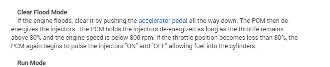

It definitely sounds like it is getting too much fuel. When you are holding the accelerator down to the floor, you are entering what is called clear flood mode. Basically this tells the PCM to cut the injectors off. If it is still not running on all cylinders then I suspect those injectors are still dumping fuel or there are other issues.
I would suggest starting with pulling the plugs and seeing if they are fouled. If they are wet or smell like fuel after cranking this way then it is still dumping fuel. The reason it starts this way is because it is getting fuel but when you cut the injectors, the plugs are able to fire with the remaining fuel in the cylinders.

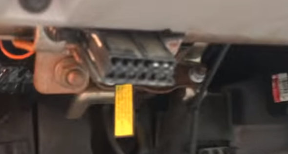

plugs were dry but black this morning when i pulled them, but it set all night fuel pressure had dropped to 0 overnight as expected. does the 1995 have obd2? it has a plug but my reader just gives me a connector error will not read anything. i know some 1994 and 1995 do but some don't. i just have a cheap code reader. check engine light is on but engine is not running. according to the Buick book i have it can be on when engine is not running and have no codes I have not worked as a mechanic since the late 1970's in automotive but worked on plant maintenance at a explosive plant. so i am not up to date on this computer cars and only work on my own stuff and that is getting harder because i am as old as dirt.
Feb 15, 2020 at 10:16 AM

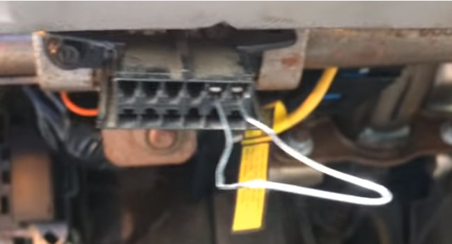

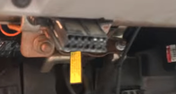

You have an OBD 1 vehicle and to confirm this you should have a connector that looks like the attached picture. In order to retrieve the codes, you need to jump the two terminals together and then count the flashing check engine light.
It should flash once, pause, then flash a certain number, pause, then repeat. It should flash 1-2 three times then give you all the actual codes, then flash 1-2 three more times. The 1-2 are the opening and closing codes and they don't mean anything other than to tell you all the codes have flashed.

just checked my car has a 16 pin and the GM manual i have shows that it could have a 12 or 16 pin and is not flash capable. but my obdii wont read it. just a cheap one of Amazon. but the manual says that the check engine light should be on with key on engine not running. so I need to go from there. I will get some new plugs tomorrow in town and replace them and see if it will start then. when I was trying before I added a can of sea foam to the gas to maybe free up the injectors after two years could not hurt i guess.
Feb 16, 2020 at 7:57 AM
From what I can tell, your vehicle has a 12 pin connector which means it is an OBD 1 which is why your OBD II reader won't work.

Going to get new plugs today. it is a 100 mile trip to town so it will take all day. but the connector is a 16 pin. i would send a picture but i don't have any way to get it on the computer.
Feb 18, 2020 at 3:31 AM
Wow. I thought I lived out there.
If it is a 16 pin, I would think it is an OBD II vehicle but I could be wrong. Keep us updated. Thanks

It is a 16 pin but GM manual says it is obd 1. put in new plugs and got it started but only at full throttle and it runs rough and surges up and down and backfires shuts off if you back off of throttle at all. I think it needs new injectors maybe. fuel pressure on gauge stays at about 40.
Feb 19, 2020 at 5:14 AM
Yes. I would agree that the injectors sound like they are stuck open. Holding the accelerator to the floor is called a clear flood which means it cuts the injector pulse width. The fact that when you remove your foot it stalls just shows that it is too much fuel. I would try not to start it too much until you figure it out or you will foul the plugs again. Black plugs as you found earlier is a sign of carbon fouling which is caused by excess fuel.
If it were me, I would put injectors in it at this point.

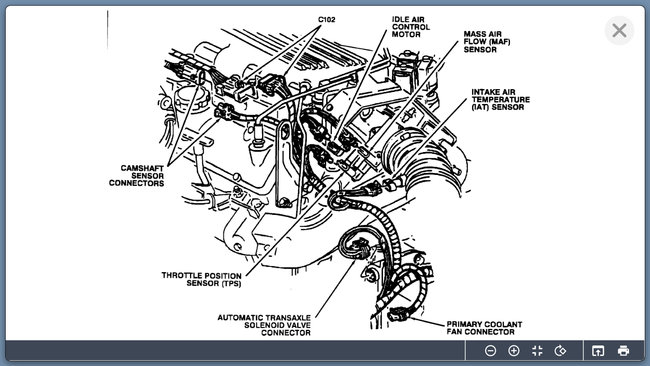

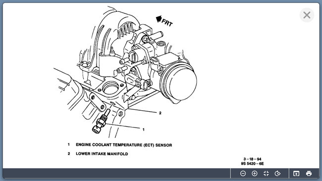

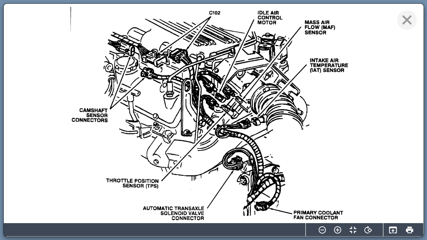

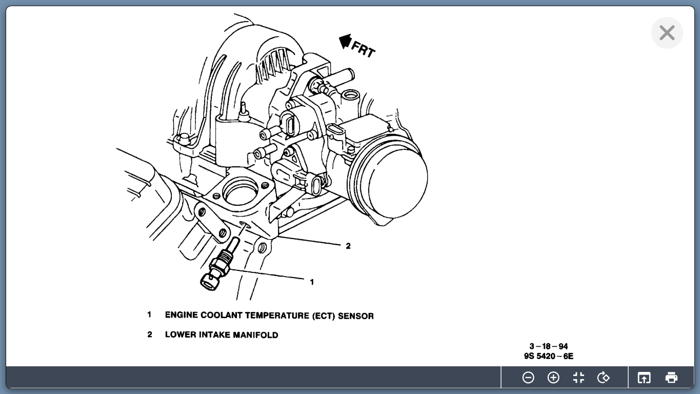

It also could be a Mass Air Flow Sensor. a quick check for this is unplug it and start it up should change the way it runs. It could also be the Engine Coolant Temperature Sensor reading a really low temperature. check it the same way. I'm attaching component location and repair guides below let us know if this was helpful.
https://www.2carpros.com/articles/how-to-replace-a-mass-air-flow-sensor-maf
https://www.2carpros.com/articles/symptoms-of-a-bad-coolant-temperature-sensor
Thanks
Joe T.
Feb 20, 2020 at 5:00 AM
Good point Joe. Thanks. The ECM determines fuel pulse widths based on amount of air (MAF) coolant temp and a couple others. Good easy test. Let us know what happens. Thanks.

unplugged MAS it starts and run okay. cleaned MAS and that did not fix it so replaced it. running okay now. have to run a few miles and see how it works out it had set for 2 years before i got it with a bad fuel pump that i also replaced. thanks for your help .

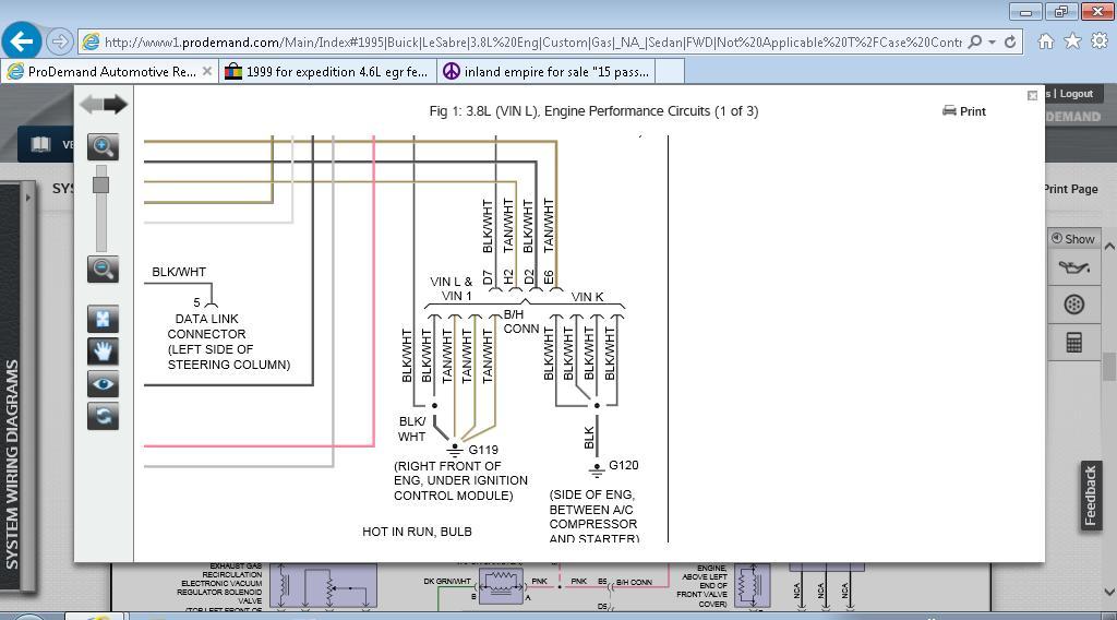

I have seen this happen on a honda would only start with a code reader attached. It was a lopse ground.Do have the 16pin obd2 style connector?
Aug 4, 2020 at 9:18 AM (Merged)
SATURNTECH9
  • 30,869 POSTS
I posted the ground I want you to check depending on the 8th digit of your vin is where the ground is located.Let me know what you find the wires to that ground should have less then 2 ohms to ground.

I figured that buicks started the obd2 style connectors in 1994.Check that ground i posted.
JOHN MESNER
I maid a mistake he said it was obd1 he had all ready checked the ground you indicated. It was a little under 2 ohms . He plugged the tek2 in and started the engine with it. It ran for about 40 minute's and then died it still wouldn't start with the key. But it would still start with the tek2. Tomorrow he is going to take the ground off and clean everything up and see it that make a difference. he may even add a direct ground to the battery.

Its strange that its a obd1 style plug i would suspect it to be a obd2 16pin connector not the 12 pin obd1 connector.It has to be a ground if it runs with the scan tool hooked up.Thats the only thing that really makes sense
