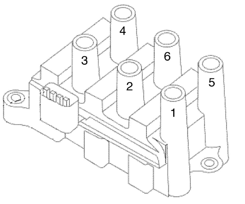

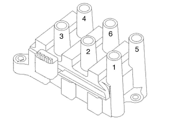

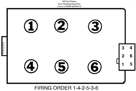

i have had conflicting advice as to plug firing order will you help me?
Mar 28, 2017 at 7:23 AM
CATAFINA
  • 98 POSTS
Check out the diagrams below
Mar 28, 2017 at 7:43 AM
CARADIODOC
  • 34,414 POSTS
That diagram is correct. The firing order is 1-4-2-5-3-6.

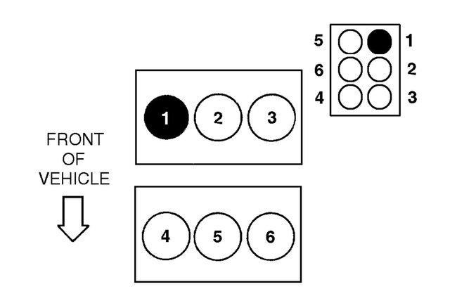

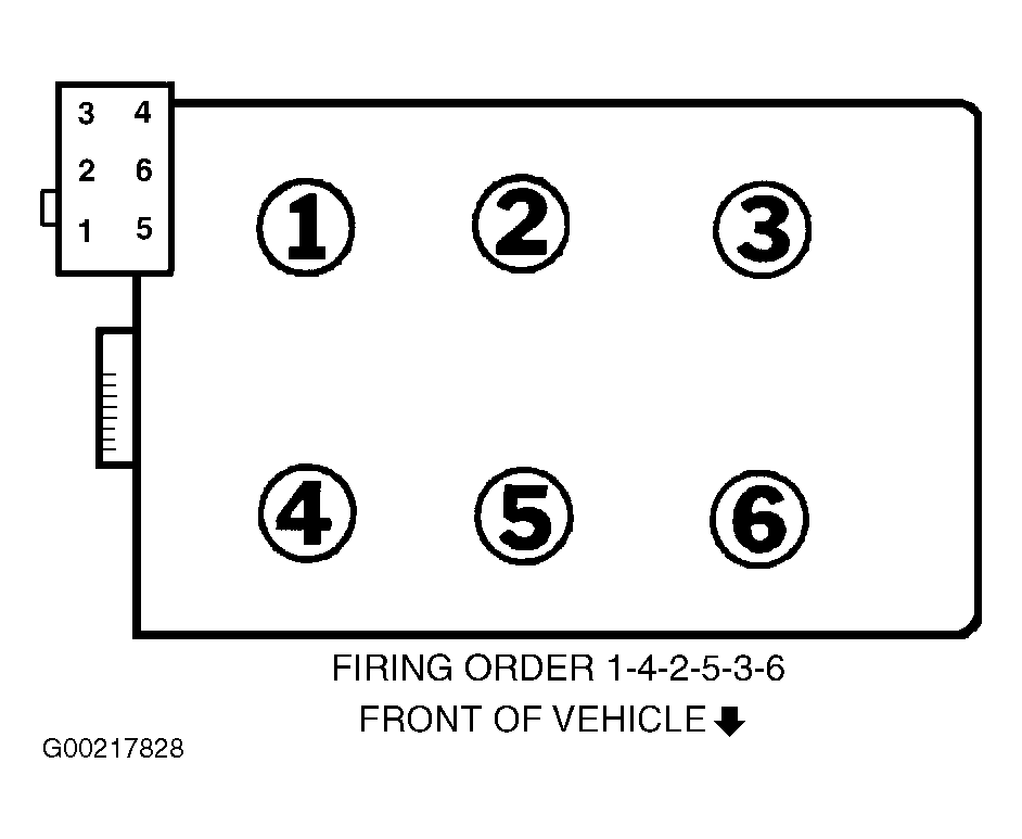

Engine Performance problem Front Wheel Drive Automatic 170000 miles
need diagram or information showing how to attach spark plug wires back on the electronic distributor for a for Windstar 3.8 liter engine
Aug 20, 2019 at 12:29 PM (Merged)
  • 55,691 POSTS
Hello, Here is the engine firing order or as some would call it the ignition coil wiring.
https://images.2carpros.com/forum/automotive_pictures/12900_ford_fo_2.jpg
Here are more diagrams that are larger (below) Please use 2CarPros anytime, we are here to help. Please tell a friend. Cheers, Ken

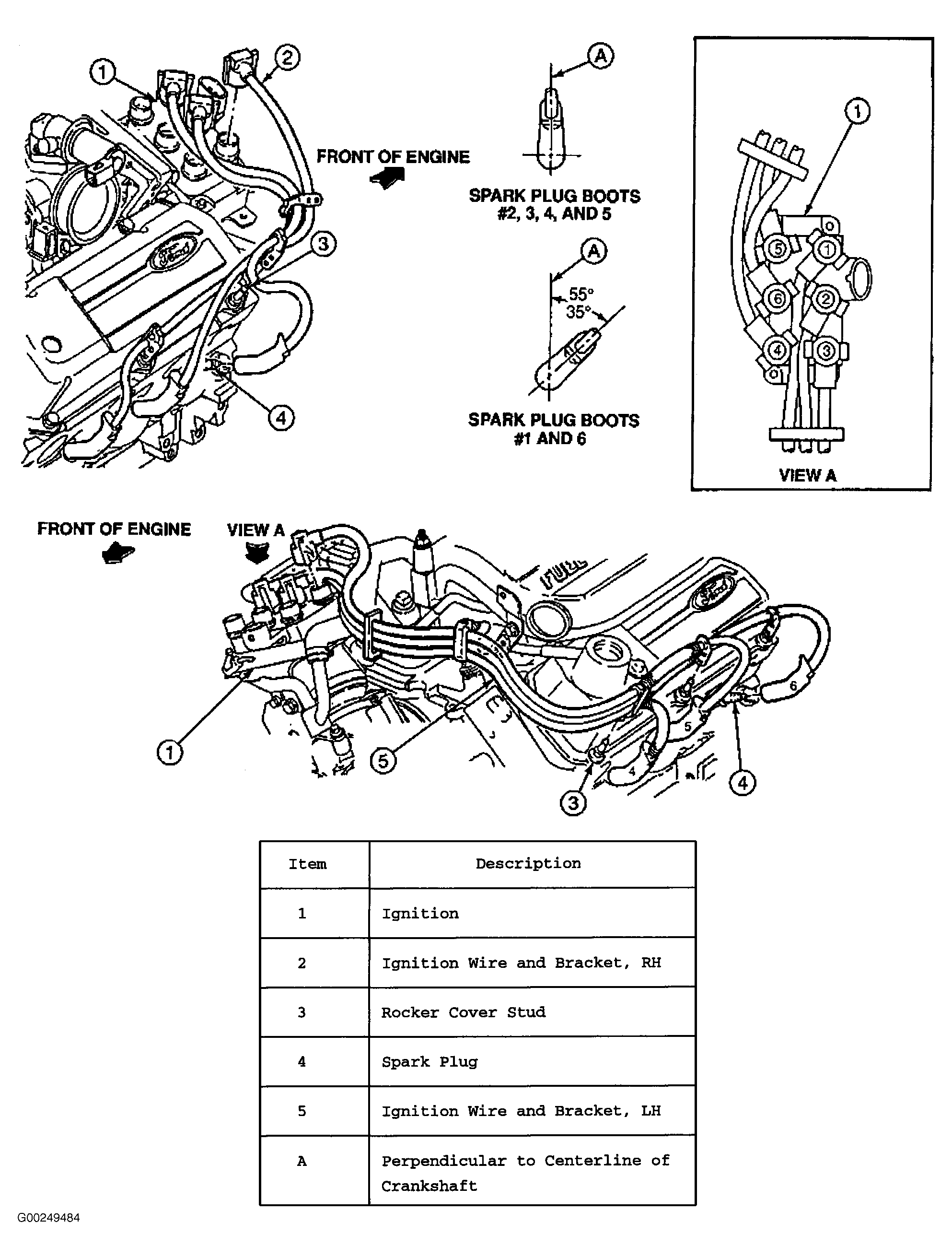

how do you get to the back plugs and wiring next to the firewall
SCHRIMPIEMAN
  • 166 POSTS
If you cannot reach them by removing the air intake snorkel / air filter assembly, jack up the car and go at them from underneath the chassis with a loooong 3/8" drive extension and u-joint ratchet set.
I know it can be a pain...

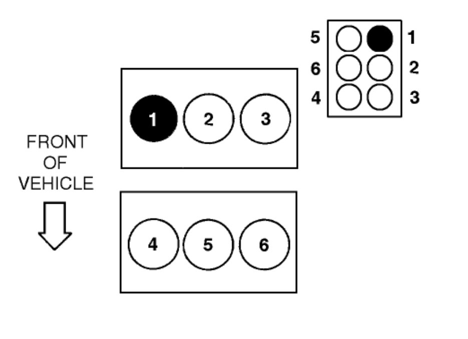

1998 Ford Windstar 6 cyl Two Wheel Drive Automatic
Need firing order for 3.0 engine
  • 75,988 POSTS
https://images.2carpros.com/forum/automotive_pictures/12900_fo_4.gif
6-Cyl Firing Order: 1 4 2 5 3 6

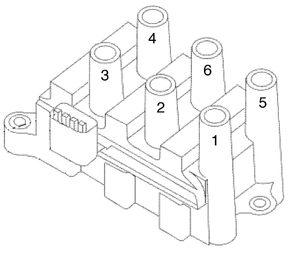

I was attempting to replace my ignition coil and come to find out the replacement was wrong,so I put the old one back in because it worked,just not well,and for some reason it did not wanna work at all,I believe I have gotten a couple wires mixed up,but I cannot remember the order to fix it properly.As well,once I did get it to turn over,I can only hear 4 cyl's running and it was burning rich...
RIVERMIKERAT
  • 6,106 POSTS
Here is the engine ignition spark plug firing order. Check out the diagrams (Below). Please let us know if you need anything else to get the problem fixed.

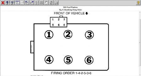

2001 Ford Windstar Front Wheel Drive Automatic
what is the firing sequence please
Sep 28, 2020 at 3:54 AM (Merged)
MERLIN2021
  • 17,250 POSTS
https://images.2carpros.com/forum/automotive_pictures/62217_FO_16.jpg
