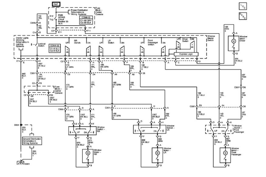

Hello, I have a rear passenger window that stopped working today. It went down, then would not come back up. Then a few hours later, it would not go up or down. I do hear a click when I push the switch down, but not when pushing it up.
I have voltage at the motor and tried replacing the window motor, but that did not change anything.
I pulled the switch from the other side of the vehicle and it did not change the symptoms.
I have around twelve volts on the meter when the switch is pressed down, however when I press it up the voltage jumps all over in the mV range but does not settle on a -12v like I expected it would.
I am a little stumped in where to dig into next.
the symptoms are the same if the switch is used on the drivers door to control the rear windows.
Any help would really be appreciated. Thanks!

It sounds like the dark blue wire has a issue. it may be frayed or partially broken in the door.
the voltage should be battery voltage, not around twelve volts and be steady when commanded to work.
Inspect the wiring from the switch to the motor?

If I am understanding the schematic, I should have continuity between the brown wire from the switch to the motor, and the dark blue wire from the switch to the motor, correct?
I have continuity on the brown, but not the blue. (Used continuity setting on multi-meter) I just was not sure if there was anything else in the path that would cause it to not have a passive signal flow on that wire.

you need to ground your black lead to the body and do your checks. you are doing a voltage drop measurement.
Mar 15, 2018 at 11:12 AM
DREV0012
  • 36 POSTS
Would you be able to explain that a little further, I am not quite sure I am following correctly?
Mar 15, 2018 at 11:25 AM
powers are reversed to run the motor up and down.
when you check for power, it will go from positive voltage to negative voltage. you need to check each wire for it function. when one wire is positive the other is negative and the other way around when the command is the other way.
you ground the black wire on your meter to the body and check for powers in both directions. the blue will be power in one direction but the ground in the other. to check for grounds put your black lead to a positive feed such as the feed to the switch and the red to the ground command from the switch.

Brown wire is not being grounded. that is the issue. it should read as close to 0 as possible.
Mar 15, 2018 at 1:07 PM
The brown wire goes all the way back to the master switch. do a continuity test on the brown wire from the switch to the master switch.

nope, look on the diagram I sent you way back. when it is activated follow the path. it goes back to the master switch.
Mar 15, 2018 at 1:43 PM
DREV0012
  • 36 POSTS

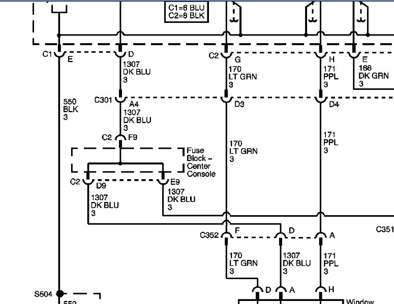

Maybe I am missing something. It looks like the brown wire from the passenger rear window motor connects to the switch on that door, which then switches between dark blue and purple. I only see three wires entering the passenger rear switch (light green, dark blue, purple).
Mar 15, 2018 at 1:55 PM
I am sorry, the brown wire changes to the purple wire which goes back to the master switch.

Pin 11 is the location at the master. check for continuity from there to the switch at the door.

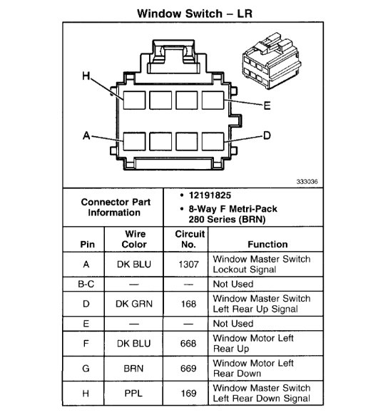

Can you tell me which is pin 11? I do not see any labeling other than letters on the master switch?
Mar 15, 2018 at 2:31 PM
Pin H in the master.

With both of the switches connected to the harnesses, Pin H tests positive for continuity with the dark blue and the light green. When the switches are removed, it does not have any continuity.
Mar 15, 2018 at 2:53 PM
do the tests with the connector not connected. then test continuity.
Mar 15, 2018 at 3:23 PM
DREV0012
  • 36 POSTS
I tested without switches connected on either end and Pin H does not yield any continuity with any wire at the rear door.
Mar 15, 2018 at 3:51 PM
okay, then at least you know the failure. now you have to find the break in the wire.
