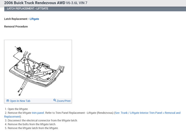

When I try to squeeze the rear hatch handle, nothing happens. Is there a manual release, and what would cause this?
Feb 6, 2009 at 11:07 AM
  • 110,194 POSTS

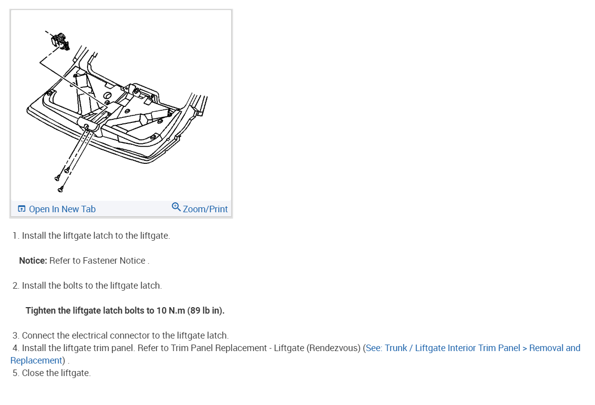

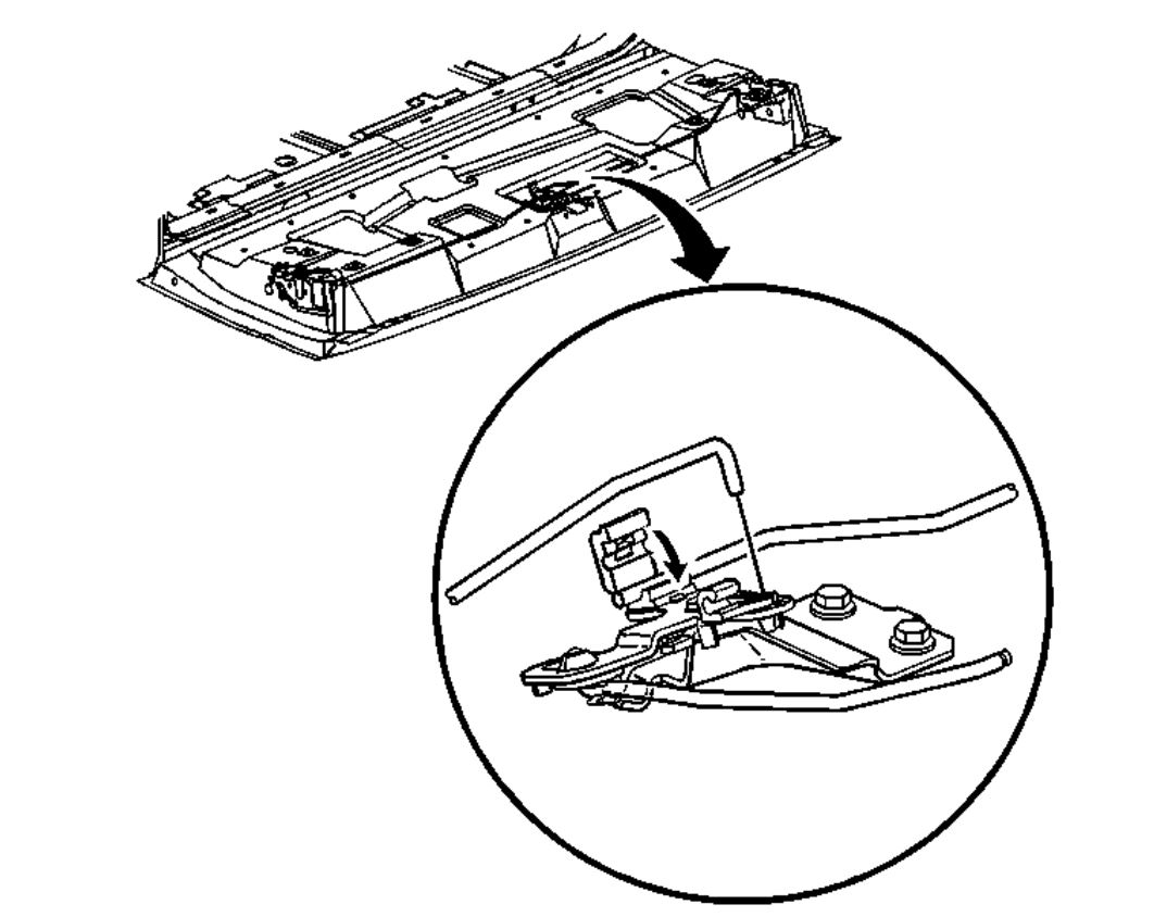

The handle is the manual release. If it isn't working, wither the handle has broken or the linkage has come apart. You will need to remove the door panel to be able to check the linkage and handle. Check out the diagrams (Below). Please let us know what you find.

Some have an electric switch in the inside of the vehicle. Others don't. However some have a handle on the rear hatch. You may need to pull the interior panel to access the latch assembly and work it manually. Check out the diagrams (Below). Please let us know what happens.
