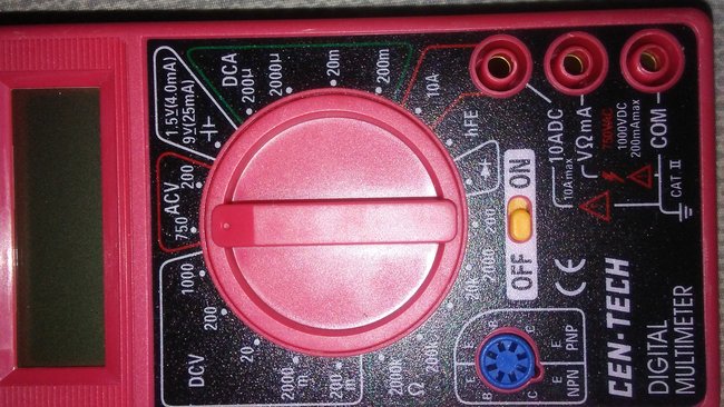

How do I check to see if my window motor is bad using a cen tech 7 function digital multi-meter?
Apr 24, 2017 at 2:19 PM
CARADIODOC
  • 34,415 POSTS
What and how to test depends on the symptom and what you have taken apart or are willing to take apart. The easiest to describe is to measure the voltages on the two wires right at the motor, but that means taking the door panel off. You can also take readings right at the wires on the window switch, but I will have to look up a wiring diagram to tell you the wire colors to test. We can do resistance tests, which can locate a problem, but take longer and are less accurate for some problems. Voltage readings are better, especially for this type of circuit.
Turn the meter's large red range switch three clicks counter-clockwise to the "20 Volt" scale. That means the meter will display any voltage between 0.00 and 19.99 volts. If you connect the test leads backward, the voltage reading will be correct, but it will have a minus sign in front of it. No big deal, and that will not hurt the meter.
To know where to start, you have to list the symptoms. A failed motor will only affect that one window, but that is by far the least common cause of a dead window. If the motor runs the window one way, it is okay. If you hear any sounds when the switch is activated, and the glass just moves a fraction of an inch, suspect cracked plastic pulleys and/or a frayed cable.

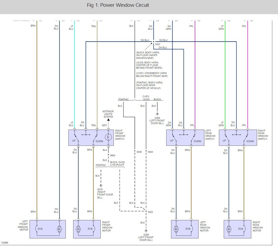

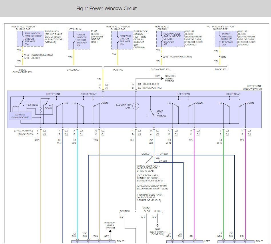

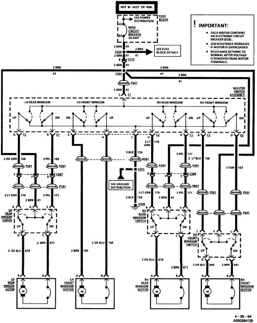

For this kind of testing a test light is easier to use. Here is a few guides and a wiring diagram to help you get the problem fixed.
https://www.2carpros.com/articles/electric-window-repair
and
and
and
Please run some tests and get back to us so we can continue helping you.

Dandy. The secret is you must have 12 volts on only one motor wire at a time. Your results indicate you have the correct 12 volts and a good ground circuit. That leaves two defective window motors.
Switch your meter exactly half a revolution to where it's shown in your original photo, to the 200 ohms position. Now you must not activate a window switch because ohm meters provide their own testing voltage. They must be used in a non-powered circuit. Measure the resistance between the blue and brown wires going to the motor. You should find something in the order of, . . . oh, . . . six to maybe 20 ohms. The exact value is not that critical, but I suspect you're going to find it's much higher, like 100 ohms or more. If you get an over-range indication on the meter, switch to the next higher range.

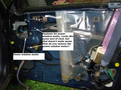

It would seem that the motor was not designed to be replaced, seems to have rivets rather than bolts and screws. Can it be replaced, can I get a quality replacement on the internet, Could it be lubed and then run better? It seems to be binding because it does move some then stop.
Thanks in advance

You will need a drill. A small punch or taper pin. The motor I got was from Advance. It was $42. They had one to order for $29 but I wanted it NOW. Not included in the kit to replace the motor is something to re-attach the entire assembly to the door. Instead of rivets I used two 1" bolts with lock washers. I would say it only took me about 45min to replace the motor. Lubricate the tape and track while you are at it.
Hope this helps.

The only way I could find to access the rear most rivet attaching the motor assembly to the regulator was to drill an extra hole in the door. I used a 1/2" drill to give myself some working room.
