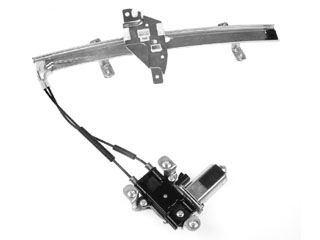

My window motor runs, but the track seems to be broken, Can I buy this separate(used) or do I buy the whole assembly? Is this diifficult to replace?

It comes only as an assembly. It is not hard, but time consuming. You have to remove the door panel, remove the motor from the wall, remove the track and regulator, and reassemble. If you would like to try to do it yourself, I suggest investing $20 for a Haynes manual to guide you. If not it will be 2 hours of labor charge to get that done plus the cost of parts. cskauto.com has it for $114.99
