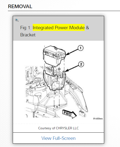

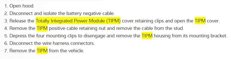

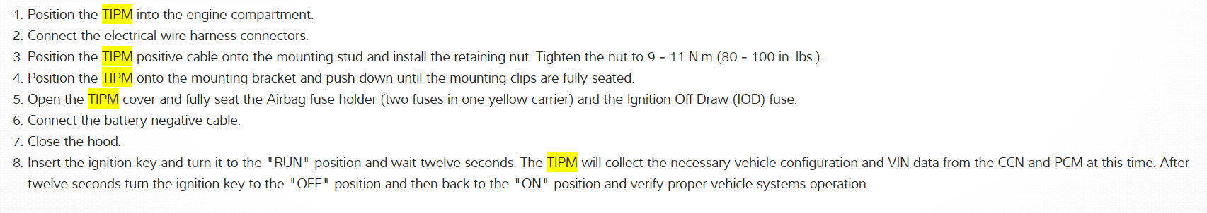

This is a common problem when the TIPM goes out which is easy to replace because it self initializes. Here are the instructions in the diagrams below to help fix the problem. Check out the diagrams (below). Please let us know if you need anything else to get the problem fixed.
