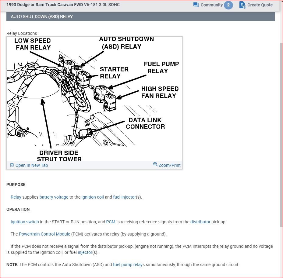

BMRFIXIT
  • 19,053 POSTS
Mark ASD relay and switch with another relay
also try to notice for check engine as cranking and no start if light stay on suspect and replace crank sensor
