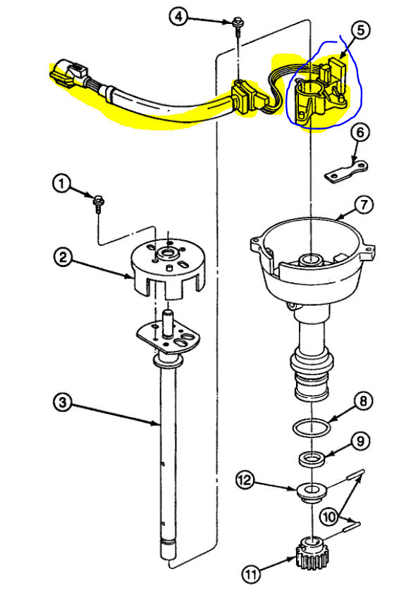

E150 van started stalling and cutting off. Restarted some but not at all now. No spark. Replaced coil and rotor and crank sensor. Coil tested at working (power, primary, secondary). I can hear the fuel pump. Changed fuel filter. This stalling did begin a few days after a fill up where I have been buying gas for years (QT). Could the gas be that bad? What to try next?

Oops. Battery is three months old. Cleaned posts. 12 v at starter. Engine light not on.

There is no longer a stand-alone Ignition Control Module (ICM). The ICM has been integrated into the PCM.
The crankshaft position sensor (CKP) is used to indicate crankshaft position and speed information to the PCM. The PCM uses the information from the CKP to generate an internal profile ignition pickup signal (PIP signal). Once the PIP signal is generated, fuel and spark functions are enabled.

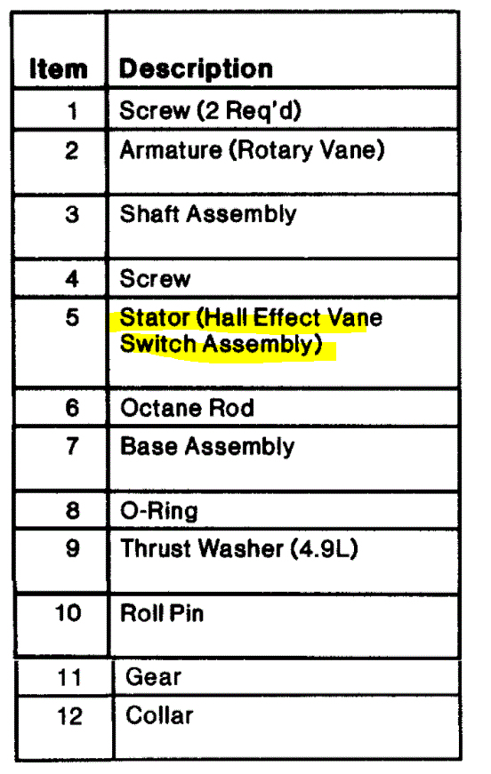

The PIP is also known as the camshaft position sensor. It is located in the distributor. See pic 1 below. If the crank sensor is good, and everything is working, the PIP sensor is the next thing to be checked.

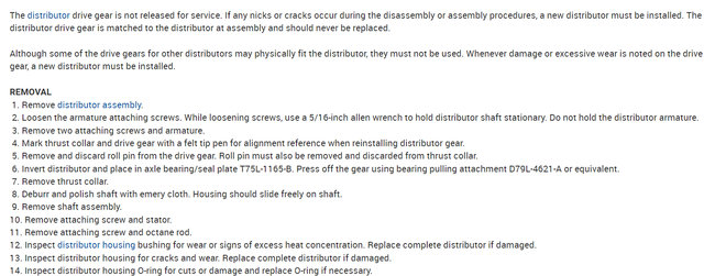

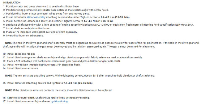

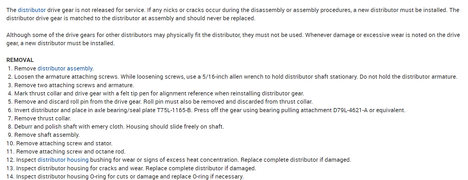

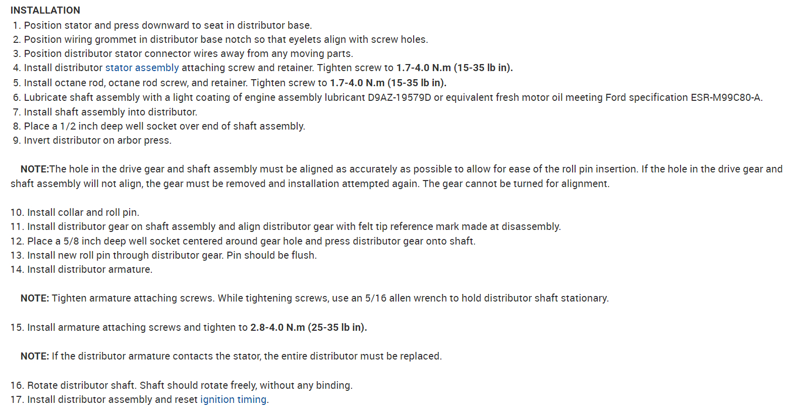

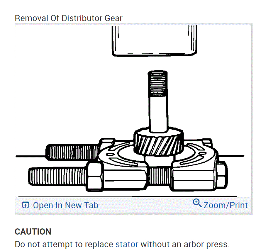

To replace the component, the distributor needs to be removed and disassembled. See pic 1 for sensor location and the remaining pics for replacement.
You need a press to remove this component.
I hope what I described makes sense to you. I tried to make it as understandable as possible. Inspect that component in the distributor. You can see it when the distributor cap is removed.

Thanks Joe! The attached diagram has 12 items. Which one is the PIP? Number 5? The cam position sensor?
It reads like a delicate procedure to take apart the distributor. Would it be easier to buy a new distributor at NAPA for $ 104.99?

The disassembly of the distributor can be difficult and if you don't have a press, the gear can't be removed. The idea that I'm not 100% sure that is the problem, I don't feel comfortable making that call. I don't want you to spend money that isn't going to fix the issue. However, after reading through two different manuals, which is what it's pointing me toward. Sadly, they don't provide a test for it.

I appreciate your time and help! I do have a press. Are the PIP, cam position sensor, stator (Hall effect) all the same thing?
How do we know if that piece is bad?
What is checked after the above piece (cam position sensor)?

The sensor is a hall effect sensor, so you could check for a voltage signal when cranking the engine. As far as the location, in pic 1 above, I highlighted it for you (number 5 as you mentioned). And yes, my manual is referring to that part as both the PIP and the cam sensor.
