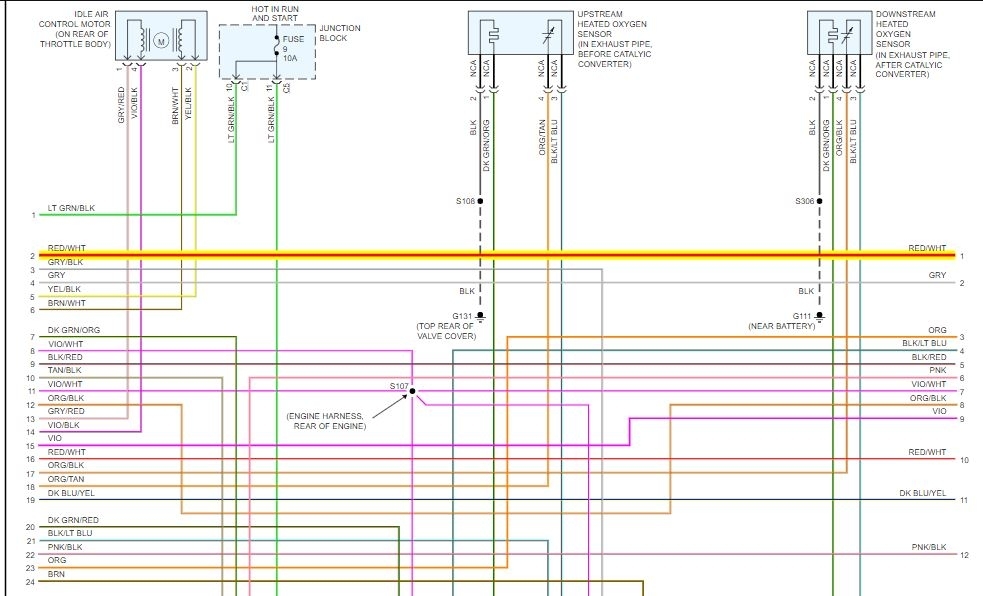

I had new radiator, water pump and starter installed and my vehicle was running well. I parked it for 4 months and now it wont start. I charged the battery added new fuel and also switched around the fuel pump and auto stop relays and still wont start. I checked 4 times on 4 different days to see if I could hear the fuel pump running when the key was turned on and every time not one tick from the fuel pump.
I hooked up an OBD reader and after three attempts I keep getting connection failed. Unable to connect to vehicle computer. Please help! What should I do next?
Thank you
Jan 9, 2021 at 12:29 AM

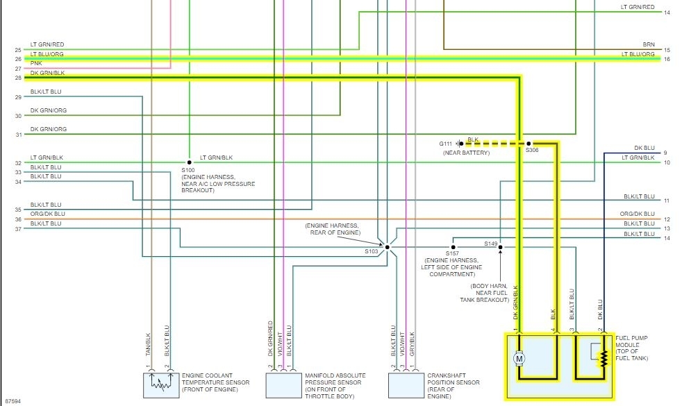

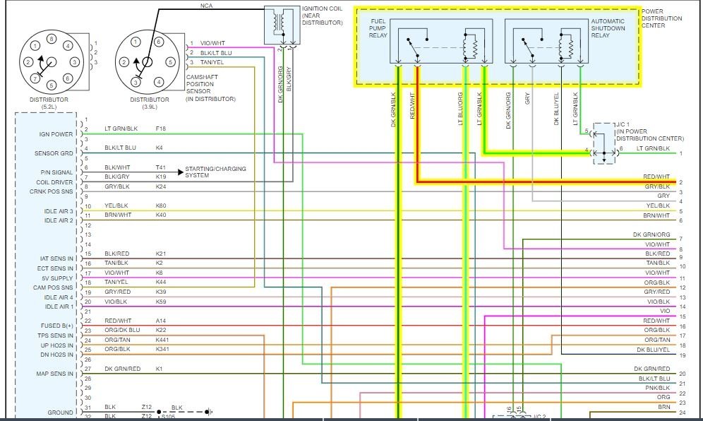

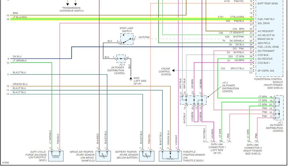

Good afternoon,
I attached the wiring diagram for you of the fuel pump circuit.

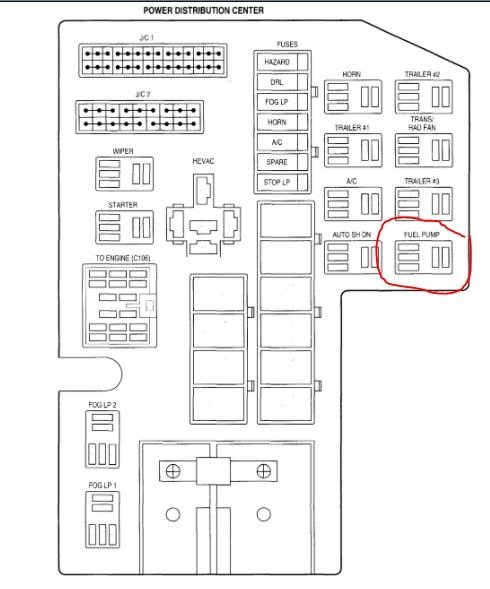

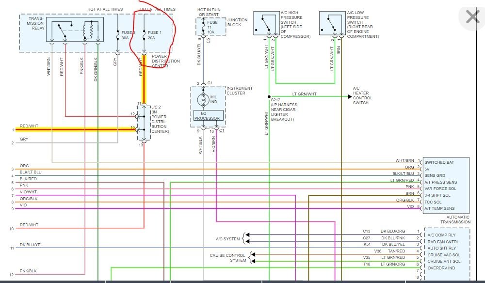

We need to do some testing at the fuel pump relay to see if power is getting to the pump.
Check the fuse I circled for power on both sides.

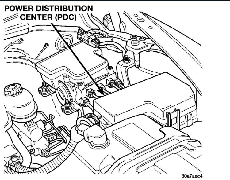

The fuel pump relay is located in the Power Distribution Center (PDC) (Fig. 67). Refer to label on PDC cover for relay location.
REMOVAL
1. Remove PDC cover.
2. Remove relay from PDC.
3. Check condition of relay terminals and PDC connector terminals for damage or corrosion.
Repair if necessary before installing relay
4. Check for pin height
Pin height should be the same for all terminals within the PDC connector).
Repair if necessary before installing relay.
INSTALLATION
1. Install relay to PDC.
2. Install cover to PDC.
Jan 9, 2021 at 5:03 AM
MARWEE
  • 25 POSTS
I will install a new fuel relay today and check I am getting power to the pump.
Jan 9, 2021 at 8:48 PM
Okay, at the relay, can you test for power? One terminal should have power with the key on.
Then another terminal will only have power for 2 seconds after turning on the key. That is the primer from the ECM.
Jan 9, 2021 at 9:06 PM
MARWEE
  • 25 POSTS
yes, I do have power to one terminal at the relay but I have not checked that the two second power is feeding through. I will check after I install the new relay. Hopefully it will just start.
Jan 9, 2021 at 9:11 PM
You do the check with the relay removed.
When you turn the key with the relay installed, does the relay click?
Jan 9, 2021 at 9:36 PM
MARWEE
  • 25 POSTS
I installed a new fuel relay and I can't hear any click when key is turned. i'm a bit hard of hearing. still no start.
Jan 9, 2021 at 10:49 PM
Okay, test for voltage at the relay with the key on. It will only be there for 2 seconds.
Jan 9, 2021 at 10:53 PM
MARWEE
  • 25 POSTS
When I remove the relay there are 5 connector holes. one has constant power.
Are you saying that I should get 2 seconds of power to one of the other holes when the key is turned on?
Jan 9, 2021 at 11:07 PM
That is correct. Only 4 terminals are used with the relay.
Jan 9, 2021 at 11:17 PM
MARWEE
  • 25 POSTS
Okay, now I have the truck in my driveway to work more efficiently.
With the key off I get power at one connector. Key on I get power to that one and another terminal. It stays on during cranking also.
Jan 10, 2021 at 1:07 AM

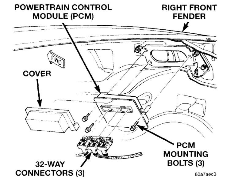

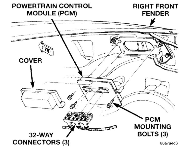

Okay, good. It should have power cranking.
The ECM is what controls that power but if the relay does not click when you turn the key on, then you either have a wire harness issue between the relay and the ECM or the ECM itself.
REMOVAL
1. Disconnect the negative battery cable at battery.
2. Carefully unplug the three 32-way connectors from PCM.
3. Remove three Powertrain Control Module (PCM) mounting bolts and remove PCM from vehicle.
INSTALLATION
1. Install PCM and mounting bolts to vehicle.
2. Tighten bolts to 3-5 Nm (30-40 in lb).
3. Check pin connectors in the PCM and the three 32-way connectors for corrosion or damage. Repair as necessary
4. Install three 32-way connectors.
5. Install battery cable.

The relay does click as the key is turned on and off.
Jan 10, 2021 at 1:25 AM

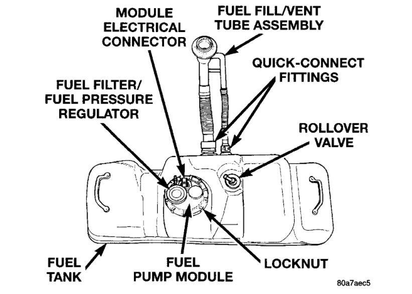

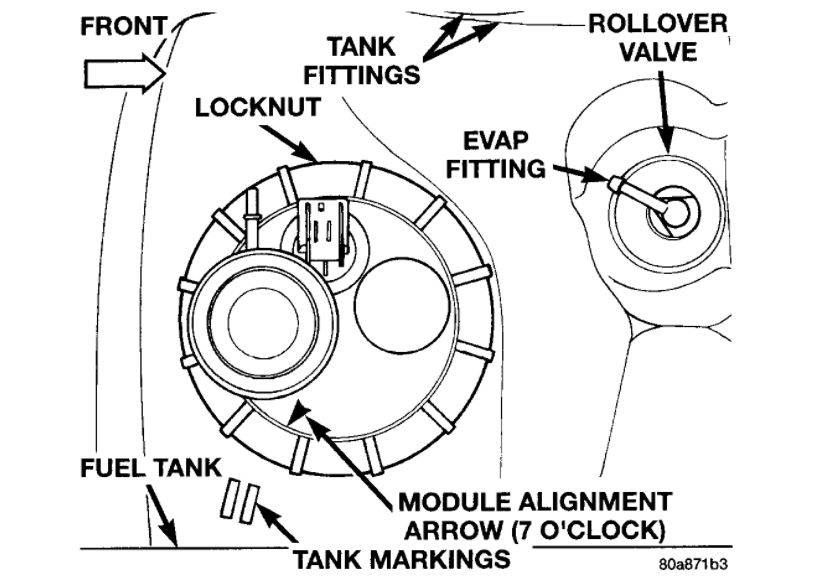

Okay, then you need to go to the fuel pump connector and verify the voltage to the pump.
It looks like you may need a fuel pump.
Warning: the fuel system is under a constant pressure (even with engine off). Before servicing fuel pump module, fuel system pressure must be released.

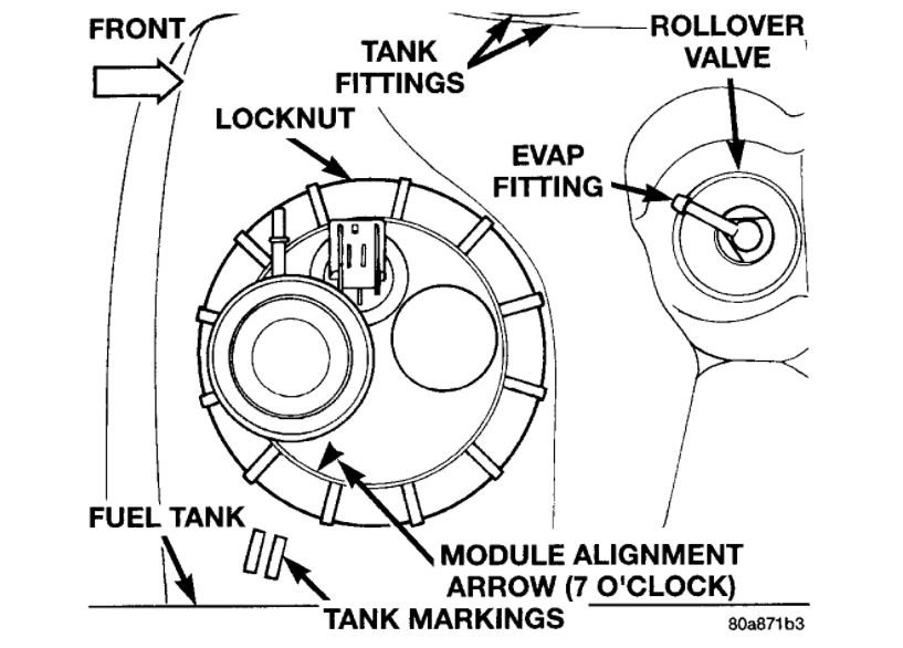

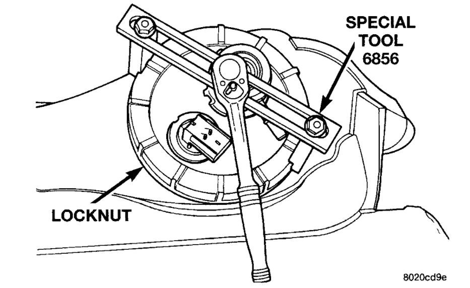

FUEL PUMP MODULE
REMOVAL
1. Drain fuel tank and remove tank. Refer to Fuel Tank Removal/Installation.
2. Thoroughly wash and clean area around pump module to prevent contaminants from entering tank.
3. The fuel pump module locknut is threaded onto fuel tank (Fig. 28). Install Special Tool 6856 to fuel pump module locknut and remove locknut (Fig. 29).
4. Remove module from fuel tank.
CAUTION: Whenever fuel pump module is serviced, the module gasket must be replaced.
INSTALLATION
1. Using a new gasket, position fuel pump module into opening in fuel tank.
Be sure rubber gasket remains in place.
Rotate module assembly until module alignment arrow is at 7 o'clock position (Fig. 28).
This step must be followed to prevent float/float rod from contacting sides of fuel tank.
2. Position locknut over top of fuel pump module.
Tighten finger tight.
3. Carefully rotate fuel filter/fuel pressure regulator until pointed towards drivers side of vehicle (Fig. 28).
4. Install Special Tool 6856 to locknut.
5. Tighten locknut to 54 Nm (40 ft lb) torque.
While tightening locknut, be sure module has not rotated.
6. Install fuel tank. Refer to Fuel Tank Installation.

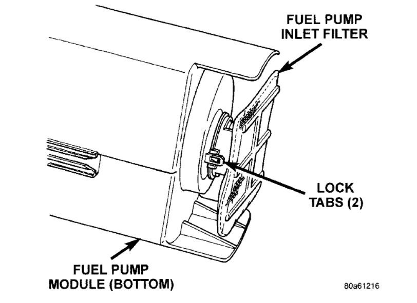

FUEL PUMP INLET FILTER
NOTE: The fuel pump inlet filter (strainer) is located on the bottom of the fuel pump module (Fig. 30). The fuel pump module is located inside of fuel tank.
REMOVAL
1. Remove fuel tank. Refer to Fuel Tank Removal/ Installation.
2. Remove fuel pump module. Refer to Fuel Pump Module Removal/Installation.
3. Remove filter by carefully prying 2 lock tabs at bottom of module with 2 screwdrivers. Filter is snapped to module.
4. Clean bottom of pump module.
INSTALLATION
1. Snap new filter to bottom of module.
2. Install fuel pump module. Refer to Fuel Pump Module Removal/Installation.
3. Install fuel tank. Refer to Fuel Tank Removal/ Installation.

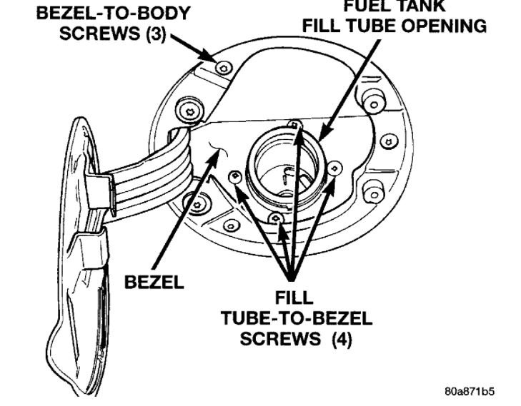

5. The fuel fill tube assembly is mounted to a plastic bezel behind fuel fill door. Remove 3 bezel-to-body mounting screws (Fig. 40). Do not disconnect fuel tubes from tank at this time.

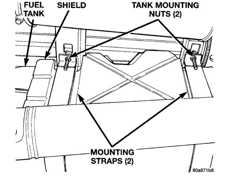

7. Place and secure a transmission jack under center of fuel tank and apply slight pressure.
Fig 41 Fuel Tank Mounting
8. Remove two tank mounting nuts from mounting straps (Fig. 41).
Position tank mounting straps to side of vehicle and lower tank just enough to allow access to connections at top of tank.

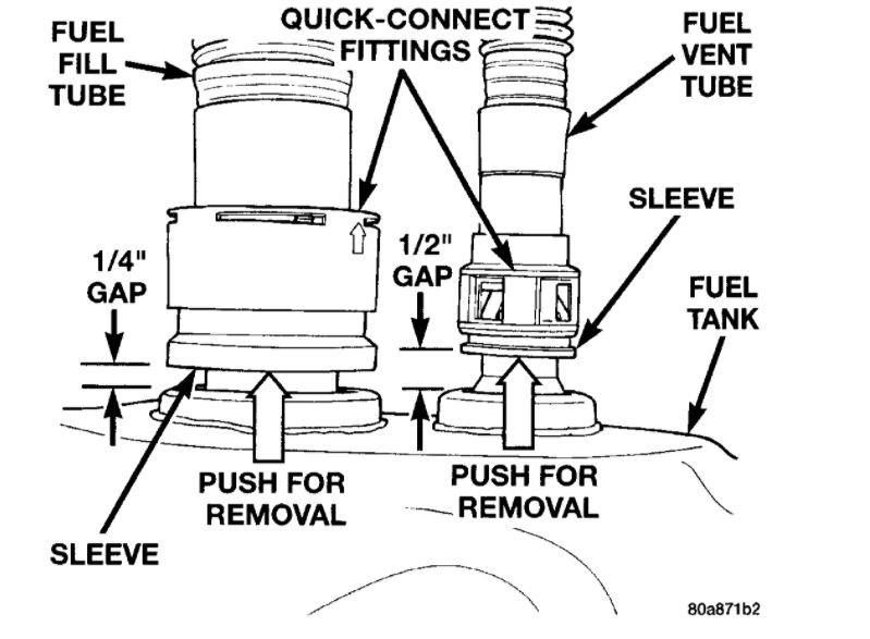

14. To drain fuel from tank, one of the fuel tubes must be disconnected at side of fuel tank.
a. Rotate fuel tank until the tube fittings at side of fuel tank are at highest point.
b. Clean quick-connect fittings of any dirt/contaminants before removal.
Fig 42 Quick-Connect Fittings At Fuel Tubes
c. Disconnect fuel vent tube quick-connect fitting at tank (Fig. 42).
The fuel vent tube is smallest of two tubes.
First, push quick-connect fitting and tube as far as possible onto fuel tank fitting.
While holding quick-connect fitting and tube as far as possible onto fuel tank fitting, push release sleeve (Fig. 42) squarely into quick-connect fitting to unlock release tabs.
Hold sleeve into quick-connect fitting while removing tube from tank.
Failure to push quick-connect fitting onto fuel tank fitting before pushing release sleeve into quick-connect fitting will damage metal retainer within fitting.
d. Position a drain hose into this open fitting on tank.
e. Drain fuel into an approved portable holding tank or a properly labeled gasoline safety container.
15. If fuel fill tube removal is necessary (fuel fill tube is largest of two tubes), push fitting sleeve (Fig. 42) into quick-connect fitting and pull tube from tank fitting for removal.
Fitting is similar to an air hose connector.

4. Continue raising tank into position and install mounting straps and nuts.
Tighten nuts to 27-54 Nm (2O-4O ft lb) torque.

5. Install fuel tube quick-connect fittings to tank fittings.
Be sure they are clean of any dirt/contaminants before installation.
Quick-Connect fittings snap on to tank fittings.
After installation, pull firmly on each tube to confirm good connection to tank fitting.
After verifying good connection, gap from bottom of fuel fill tube sleeve to top of tank fitting should be approximately 1/4 inch (Fig. 42).
Gap from bottom of fuel vent tube sleeve to top of tank fitting should be approximately 1/2 inch. (Fig. 42).

7. Install fuel tube assembly and plastic bezel to body (3 screws).

Jan 10, 2021 at 1:46 AM
MARWEE
  • 25 POSTS
Thank you. I will check for 12v at the fuel pump connector when the key is turned on.
If power is present then I will replace the pump. Question, if power is not present at the fuel pump connector then are we back to the ECM?
Jan 10, 2021 at 2:07 AM
No, if there is no power, then it is a wiring issue between the relay and the pump.

I was able to drop the fuel tank and get the connector off. There is no power to any of the four female terminals at the fuel pump connector when the key is on. The relays seem to be clicking, I have switched them around and bought new to make sure the relays are not the problem. The wiring from the tank to firewall looks good.
Jan 16, 2021 at 5:14 AM
You have a wiring issue from the relay to the tank if all your readings are accurate that you gave me.
Wiring issues are not external, they are internal inside the wire itself.
Jan 16, 2021 at 6:44 AM
MARWEE
  • 25 POSTS
I can check for continuity from tank to a terminal at the relay. That should verify the wiring is good, right?
Jan 16, 2021 at 6:52 AM
It will tell you the wire, yes, but does not verify it can handle the load.
an 18 gauge wire has 10 strands, If 8 are broken, it will ohm out okay but when voltage is applied, the wire cannot handle the current flow.
The wire needs to be load tested either with a power probe or a load pro.
