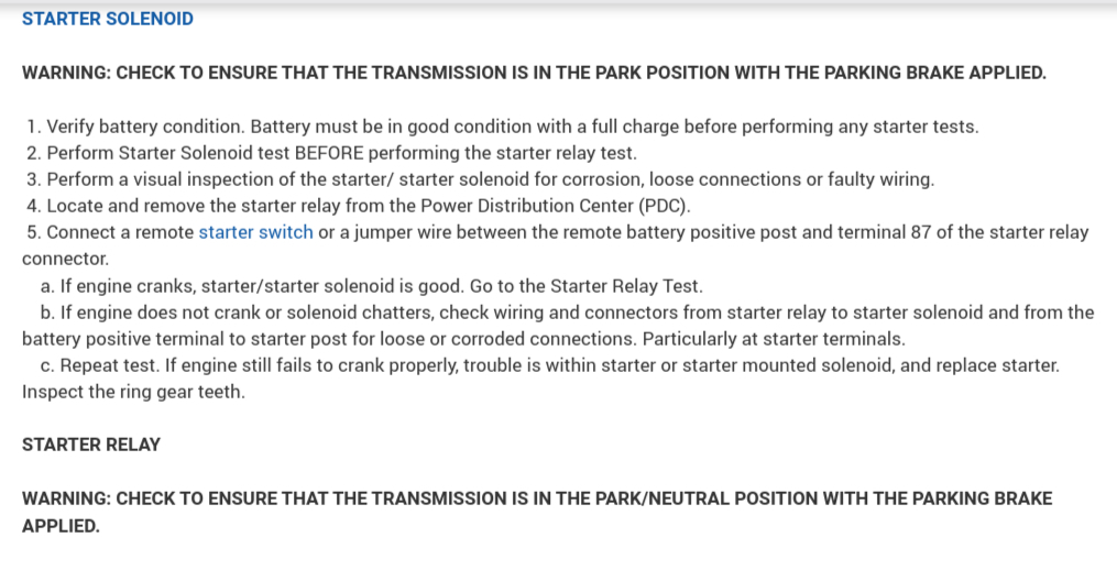

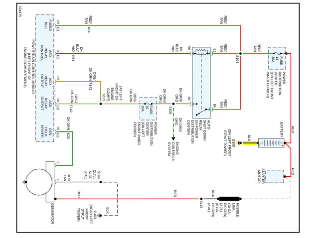

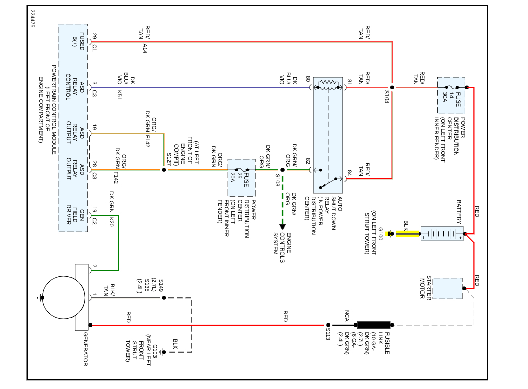

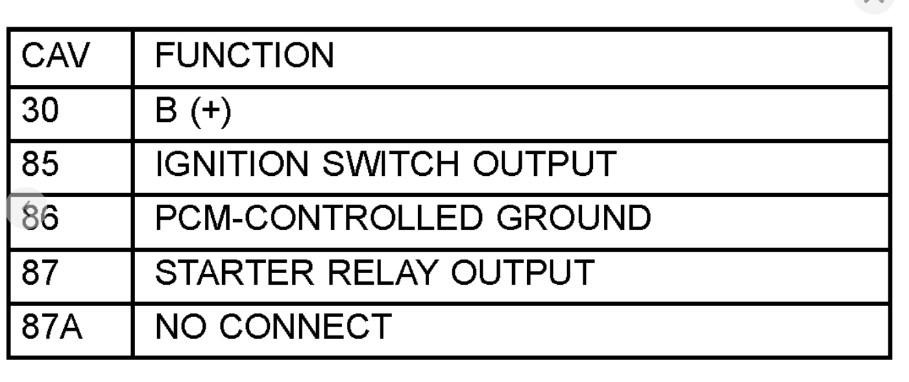

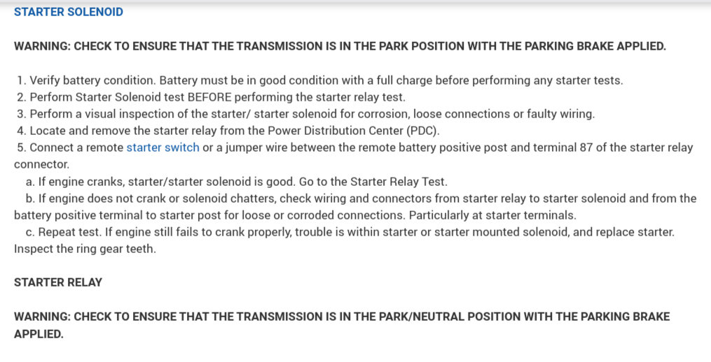

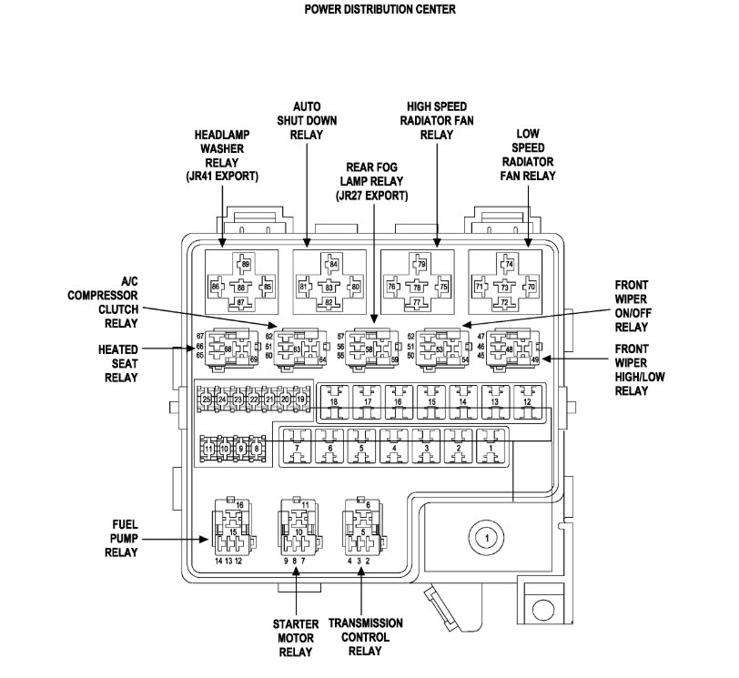

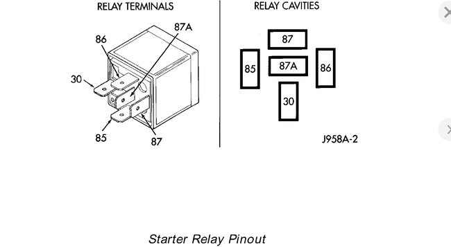

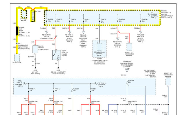

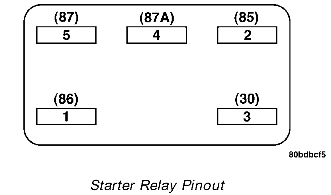

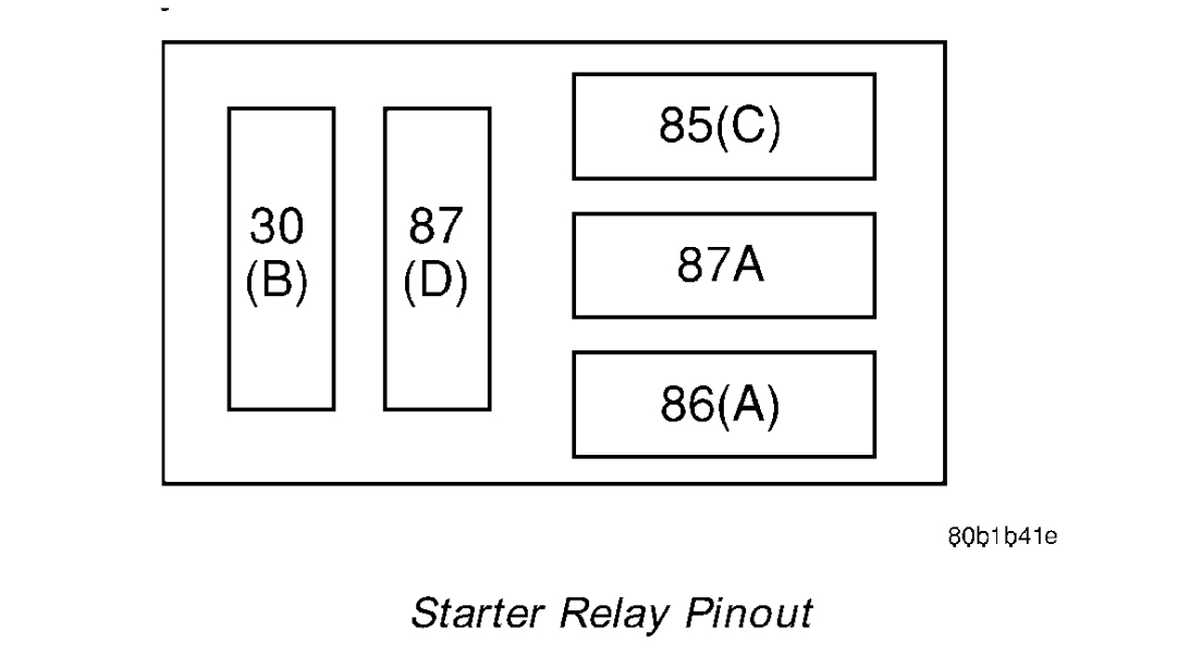

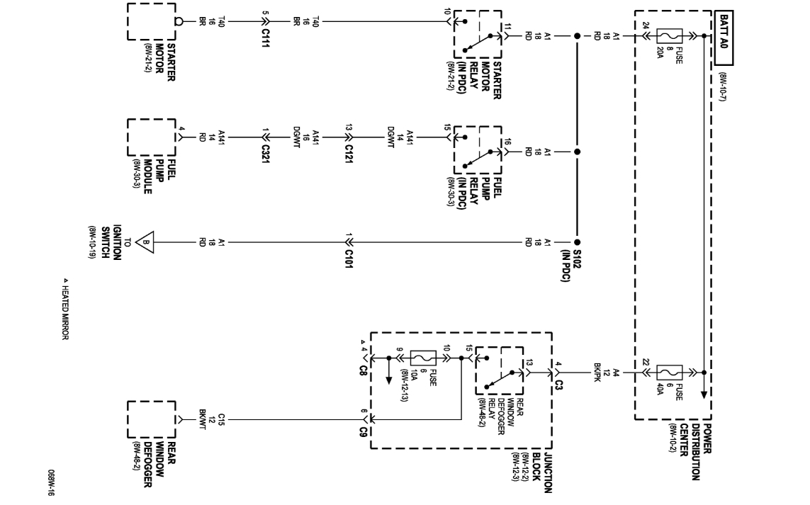

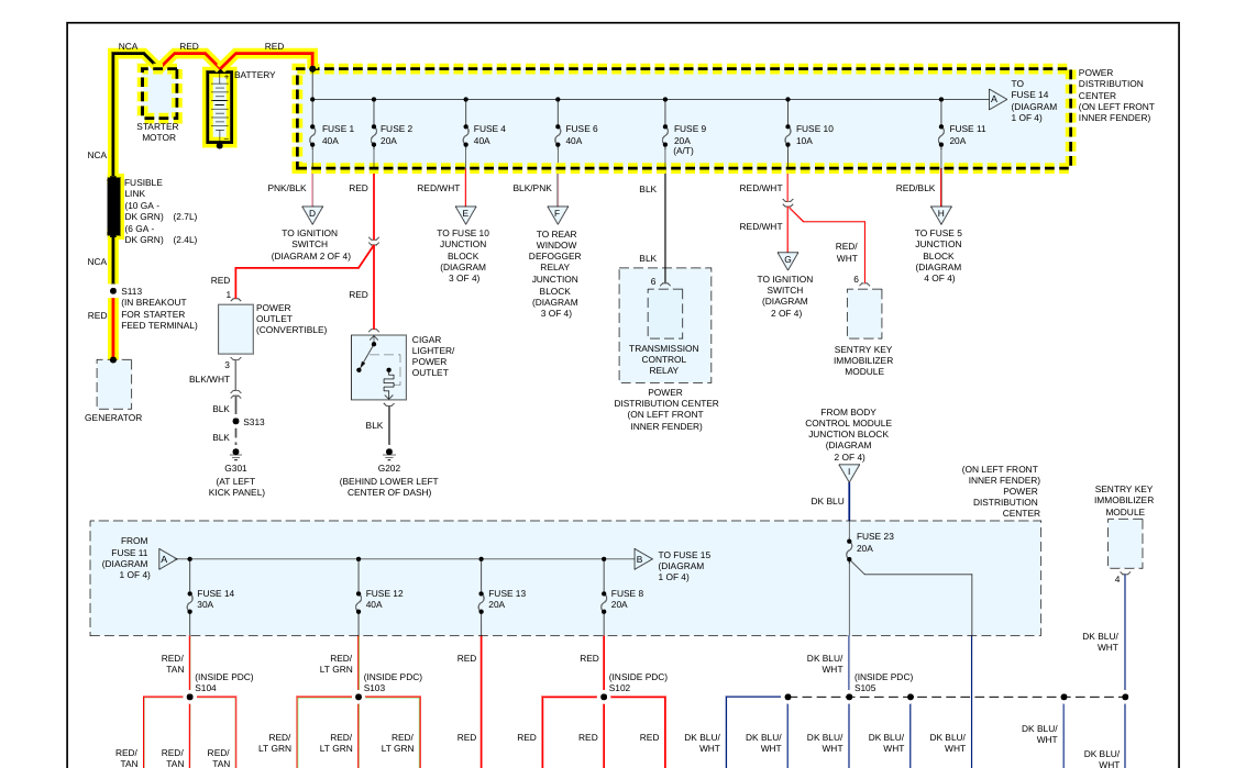

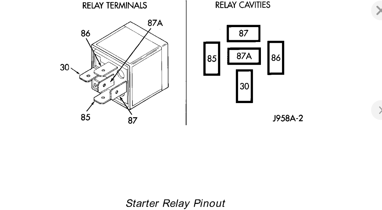

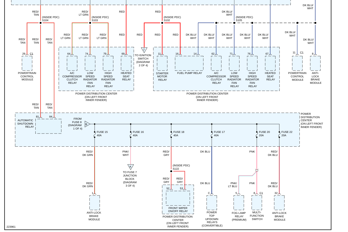

It could be a poor power and ground cable circuit. The battery cables could be rusted and corroded. Check the ground cable at the G100 ground. The Ground Cable from the battery to the strut tower bolt make sure it has a clean tight connection. The cable wire can corrode inside the insulation of the cable check for green powder. This can cause a voltage drop in the electrical system and will cause faulty circuits. I'm attaching Repair Guides, Wiring Diagrams, Solenoid test procedure and Schematics below. Power Distribution Center is located in the left front corner of the engine compartment, just behind the battery. Check them out and let us know if it was helpful. If you need more information we will get it for you.

If it is turning slowly and draining the battery, do me a favor. Check to see if the battery terminals are getting hot after cranking. The starter may be the issue and drawing too much amperage.
Let us know.
