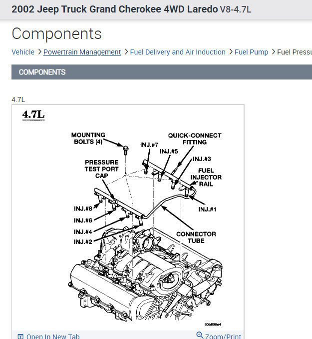

If you have spark then check for fuel. Can you hear the fuel pump come on when you turn the key to the on position?

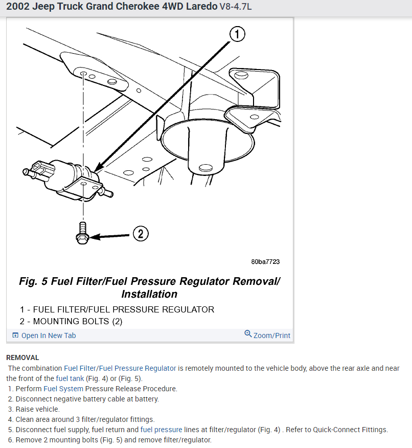

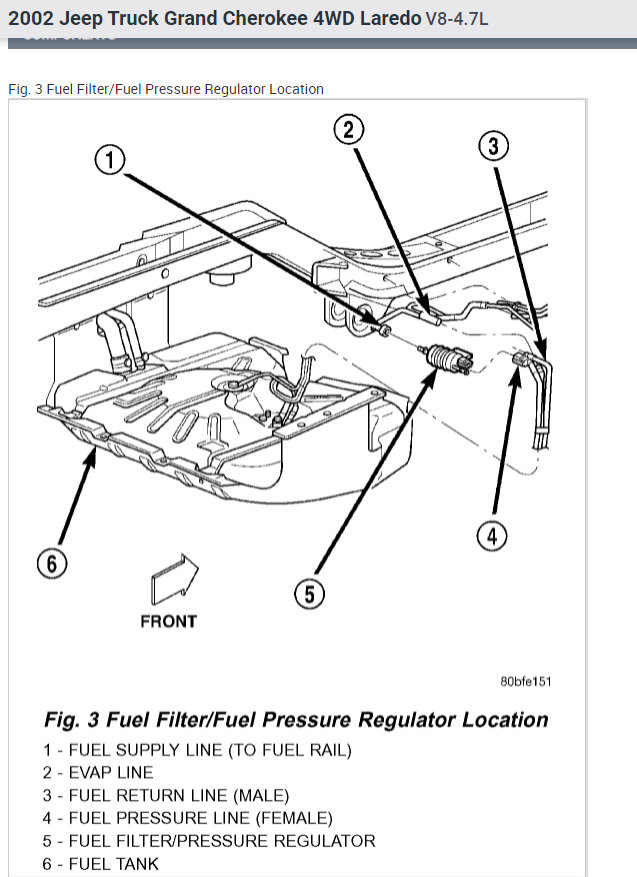

If the fuel pump comes on then you will need to check to see if there is enough fuel pressure at the fuel rail.
The pressure can be checked using a fuel pressure test gauge. That you can borrow from your local parts store to use.

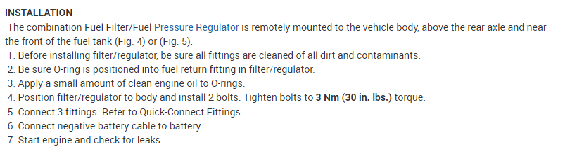

Since this vehicle has been sitting for sometime it is possible to have a clog in the fuel lines. Could have a blocked fuel filter etc.
