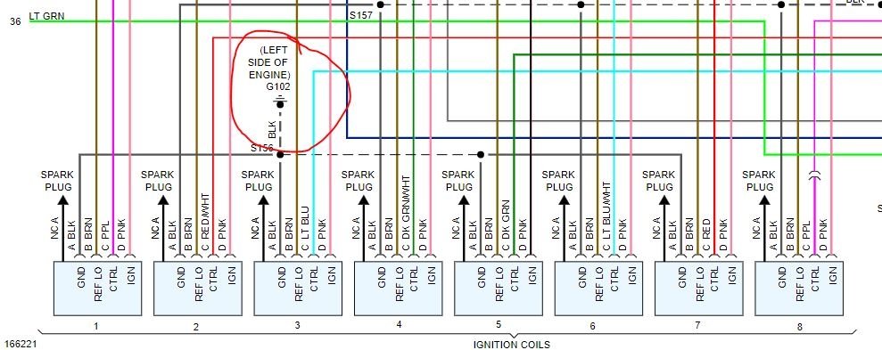

If you have no spark, my first suspect is the crankshaft position sensor. If you have a live data scanner, see if there is an RPM signal (200 to 300 RPM) when cranking the engine.

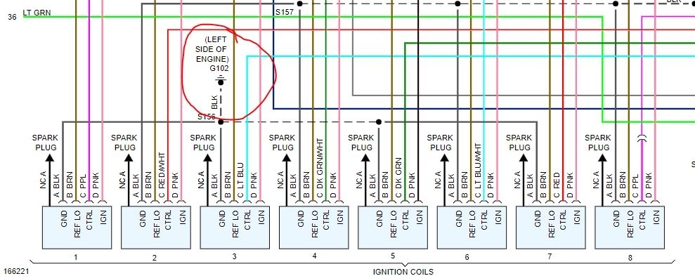

If there is an RPM signal, I need you to check the one common ground for all of the coil packs. It is located on the left lower portion of the engine (driver's side) and they are known to fall apart. If that happens, you lose spark to every coil.
It will be a black wire and the connector it goes to often times will fall apart in your hands when you touch it. Check that. I attached a pic of the ground location. You will see it is for all coils. And this isn't an uncommon problem. Plus, don't depend on checking for continuity because it may show a false positive.
Let me know what you find.
