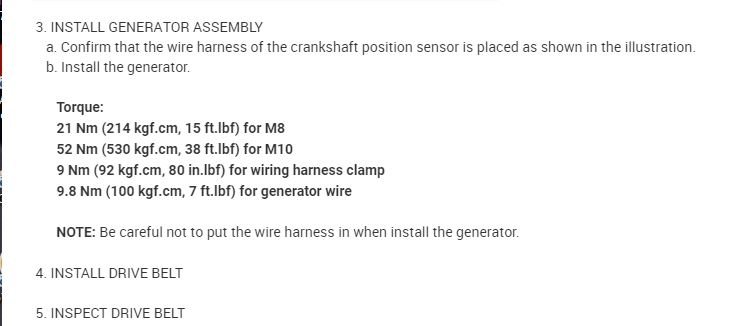

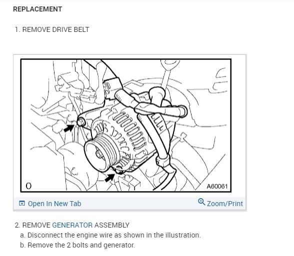

I looked at it today where the hot wire connects to alt. it got hot and melted some insulation off and when I attempted to take the nut off the mounting shaft broke.
Nov 3, 2021 at 4:39 AM
Did you disconnect the battery first?
Nov 3, 2021 at 5:12 AM
UHSNOEBIRD
  • 342 POSTS
yes.
Nov 3, 2021 at 5:13 AM
Okay, you will have to replace the wire end and then replace the alternator. Too much current flow from the old alternator caused that.
