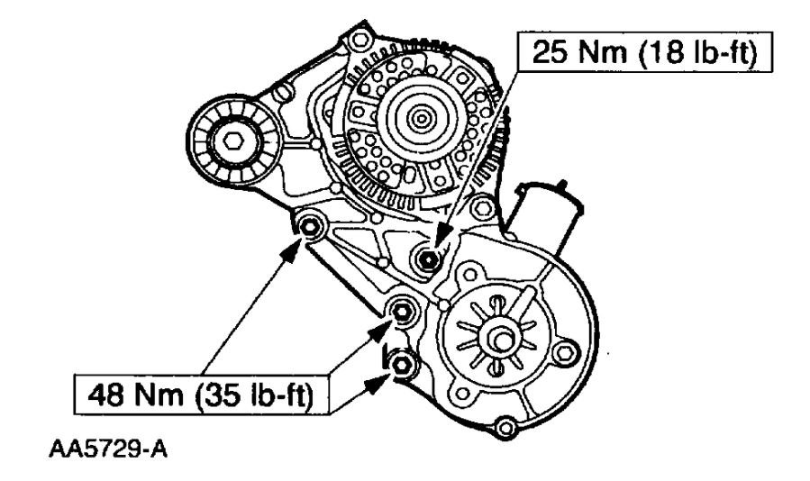

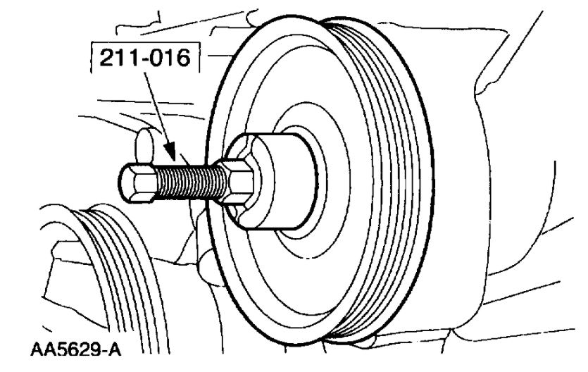

7. Using the special tool, remove the power steering pump pulley.

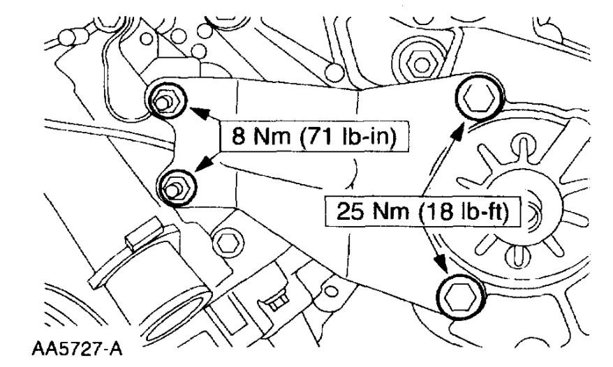

8. Remove the power steering pump bracket.
9. Remove the generator bracket.

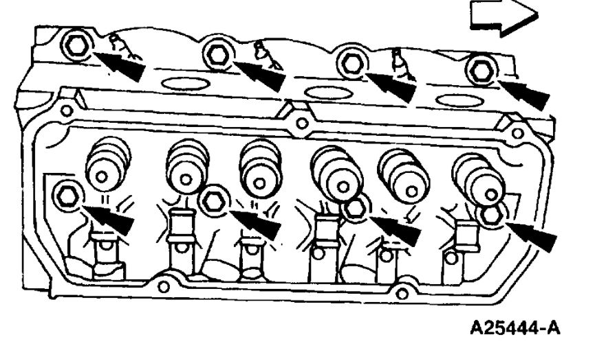

10. Remove the three exhaust manifold studs.
11. Note: Discard the cylinder head gasket.

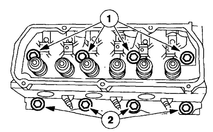

Note: Record the location of the long bolts and the short bolts.
Remove the cylinder head.
Remove and discard the bolts.

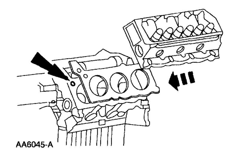

1. Clean and inspect the cylinder head for flatness.
2. Install a new head gasket on the cylinder block with the small hole to the front of the engine.
3. Position the cylinder head.
4. Caution: Always use new bolts.

Install new bolts. Refer to the location note made during removal and make sure the bolts are installed the the correct location.
1 Install the new long bolts.
2 Install the new short bolts.

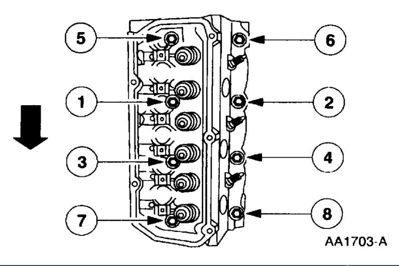

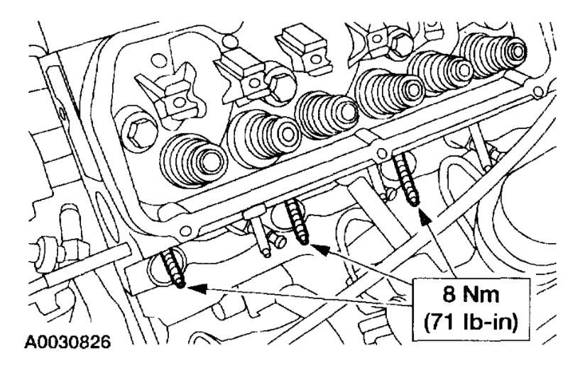

5. Tighten the bolts in the sequence shown in three stages.
Stage 1: Tighten to 20 Nm (15 ft. lbs.).
Stage 2: Tighten to 40 Nm (30 ft. lbs.).
Stage 3: Tighten to 50 Nm (37 ft. lbs.).
6. Caution: Do not loosen all of the bolts at one time. Each bolt must be loosened and final-tightened prior to working on the next bolt in the sequence.
Note: The short bolts are numbered 2, 4, 6 and 8 and the long bolts numbered 1, 3, 5 and 7.
Loosen, then tighten the bolts in the sequence shown:
Tighten short bolts to 25 Nm (18 ft. lbs.), then tighten an additional 180 degrees.
Tighten long bolts to 45 Nm (33 ft. lbs.), then tighten an additional 180 degrees.
7. Install the bracket and bolts.
8. Install the support bracket.
9. Using the special tool, install the power steering pump pulley.
