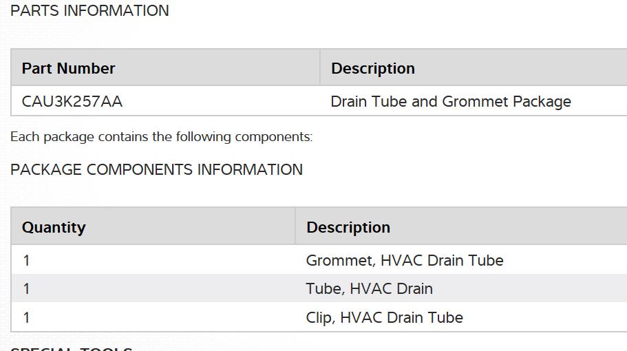

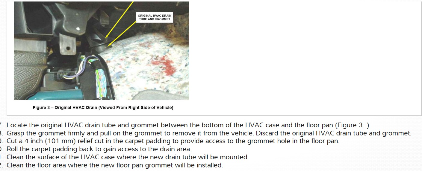

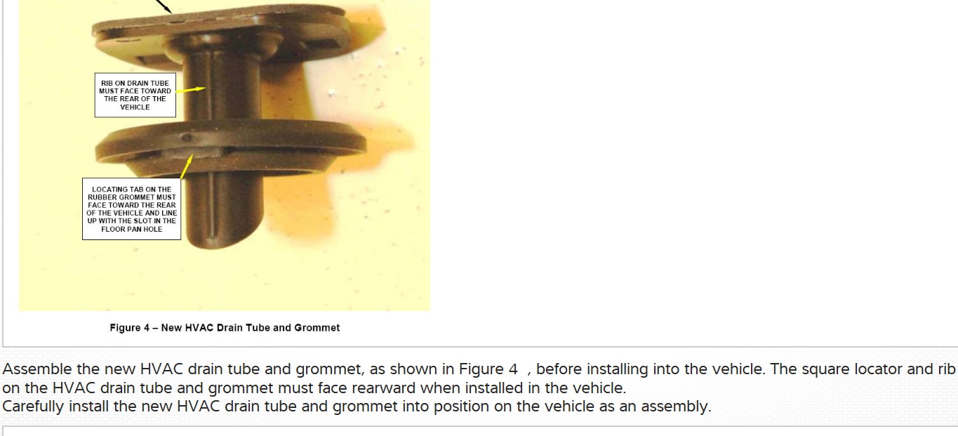

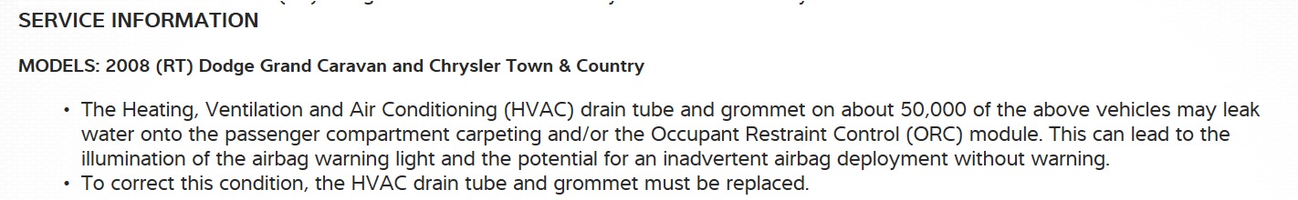

if this was built between june 07-jluy08 call dealer as there is a safety recall for a bad drain tube and it does exactly what you are talking about. it ruins the abs module. a new tube and grommet have to be installed. so check with dealer first, they may replace for free if not I have sent pics if you have to replace it yourself along with part numbers from Chrysler. I have left out a few details like push pins, an d after replacing parts due to space.
