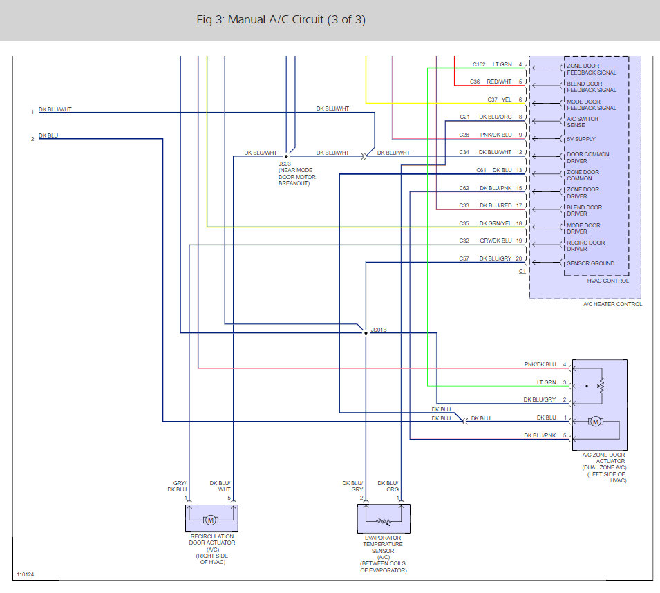

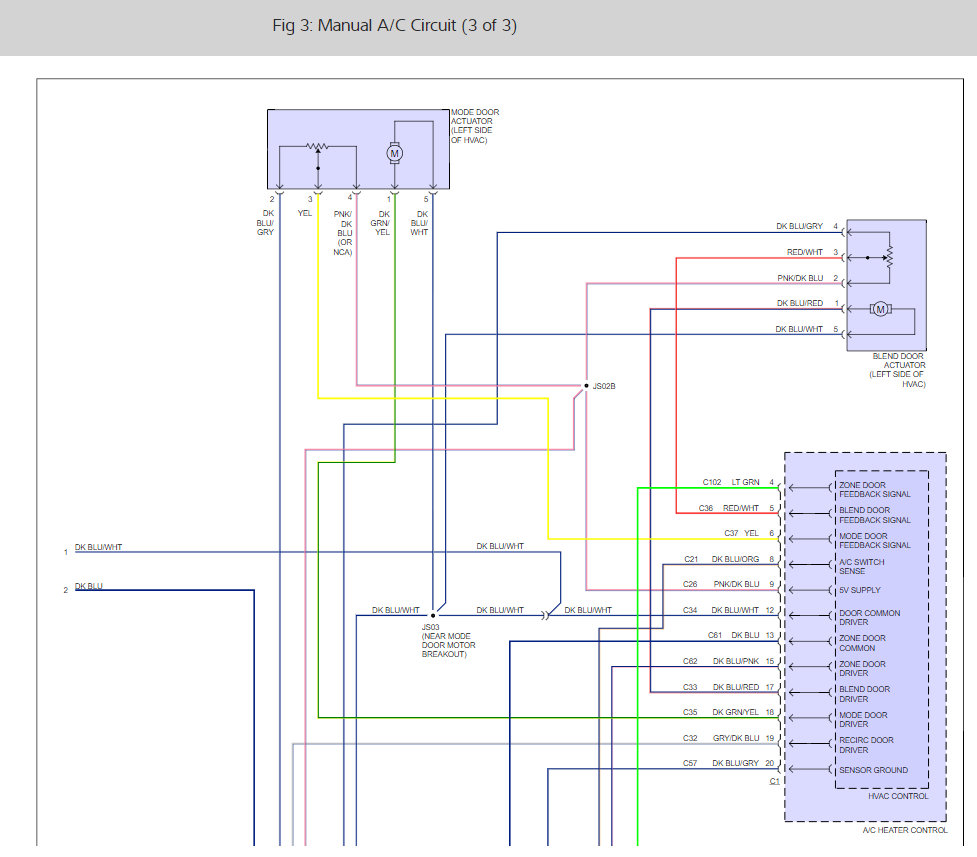

In my 2002 Chrysler T&C the driver side a/c does not blow as cold as the passenger side. The passenger side is very cold and driver side is tepid. Is there some type of actuator or sensor that directs air temperature from the system and is it a quick fix or can I do it myself?
Thanks.
Friday, September 11th, 2020 AT 3:52 PM (Merged)
  • 109,885 POSTS
The only thing that adjust the temp is called the blend air door. It is located near the heater core and opens and closes based on what you need, heat or AC. You could check that to see if it is sticking.
Let me know what you find.

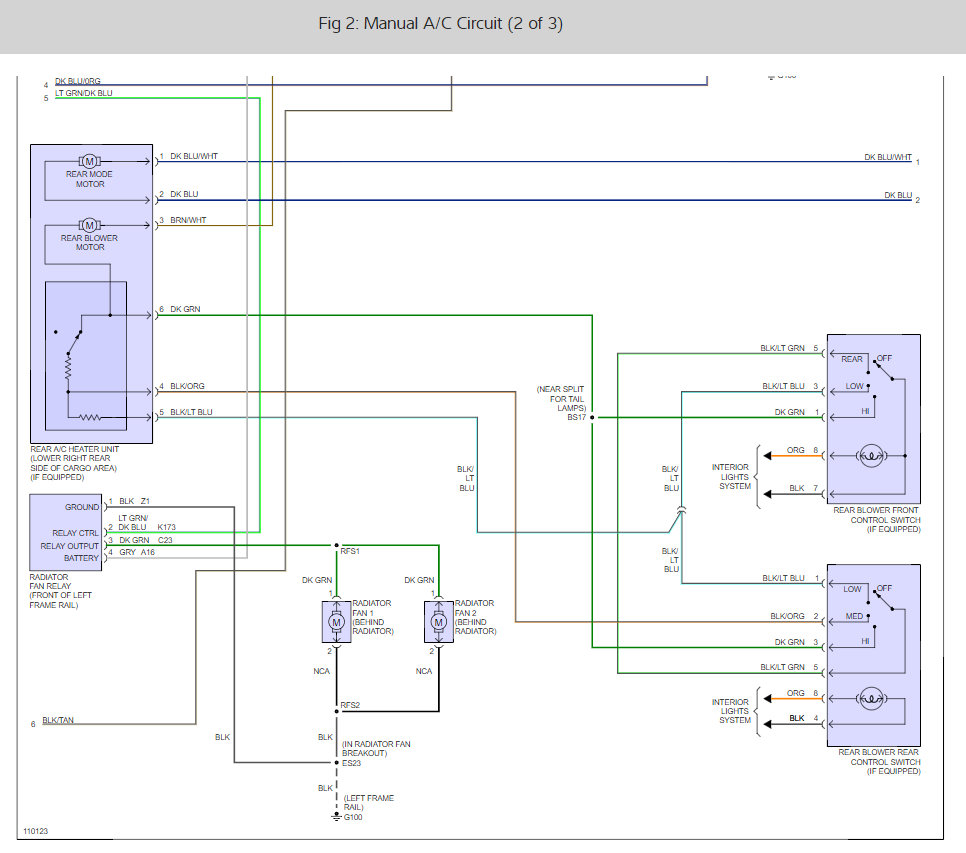

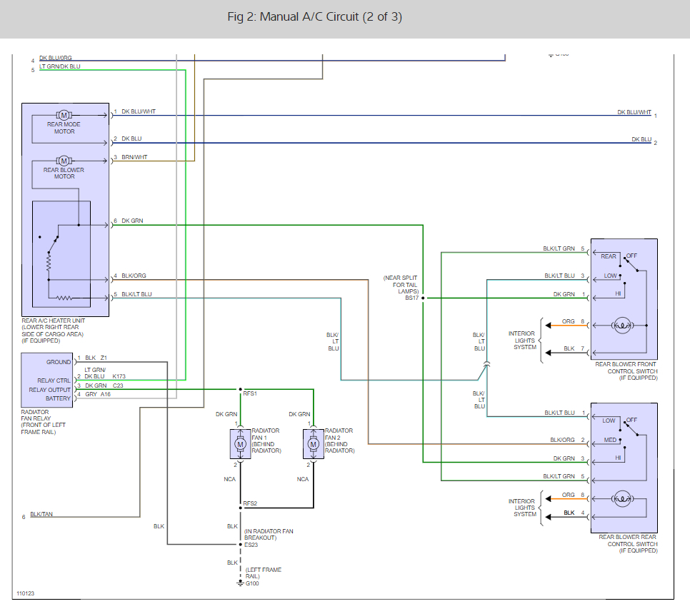

I have an 01 t&c thet hade a bad a/c compreser (locked up) I replaced the compreser and the condencer and flushed the lines, evaced the system and rechard with new R134 now it dose not get cold in front and only cool in the rear, the cooling fan will not turn on some times and it will pop the high presser valve when the fan is working the high presser is 250-300psi with the low at 20-35psi. Any help is greatly needed?
MERLIN2021
  • 17,250 POSTS
You have a blockage in the system, probably in the reciever drier. The desicant bag may have collapsed, and or the old compressor, if it had teflon coated parts may have caused "Black Death" in this case a pancake filter must be installed the systems recharged and run for at least 1 hour, then evacuate, remove filter, replace reciever and orifice tube and recharge.
RACER
  • 8 POSTS
Got napa to give me a new dryer and 2 cans of 134 for the 4 cans I lost ac is working fine now thank you for your help

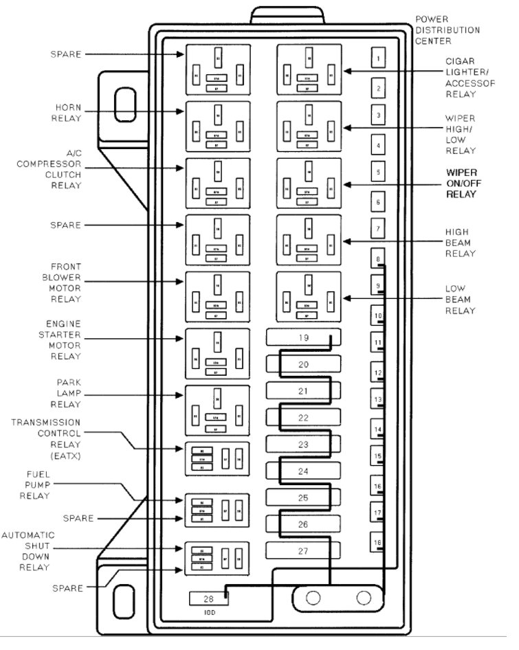

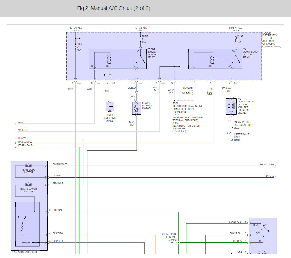

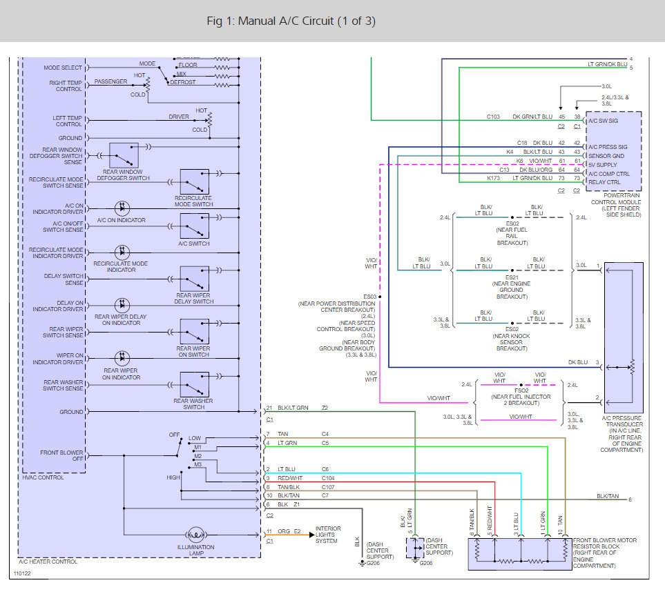

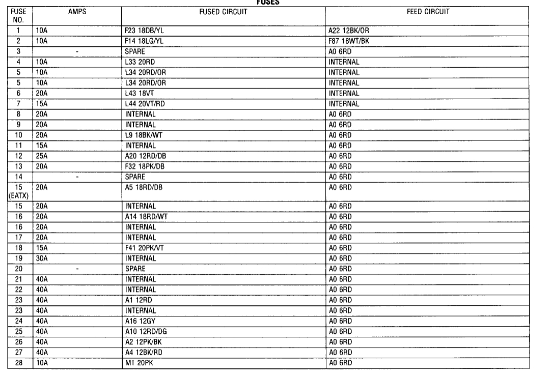

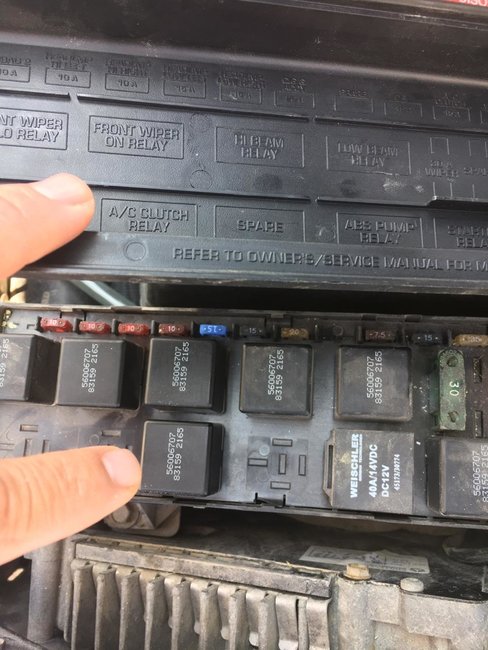

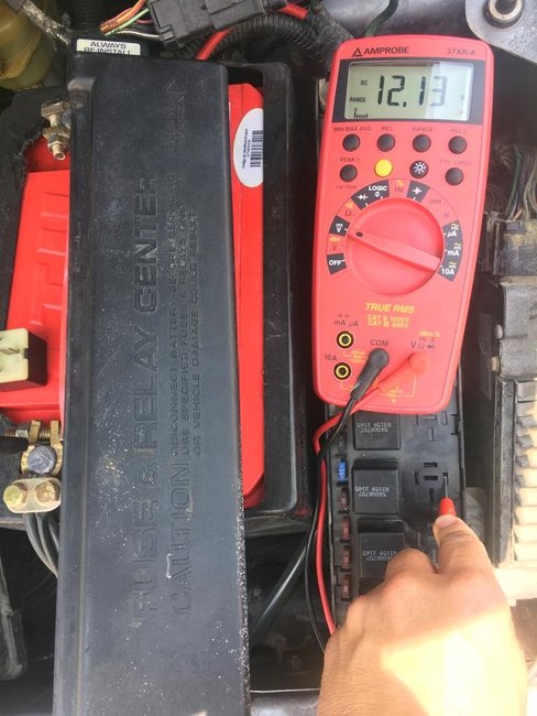

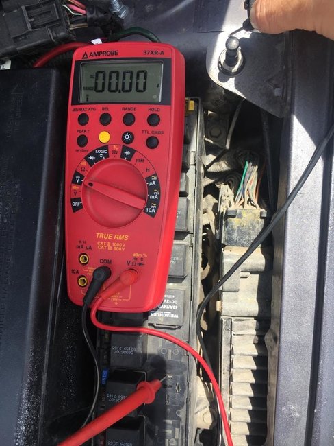

CHUCK WESTFALL
  • 1999 CHRYSLER TOWN AND COUNTRY
  • 3.8L
  • 6 CYL
  • 4WD
  • 114,000 MILES

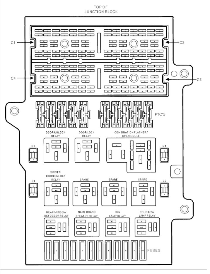

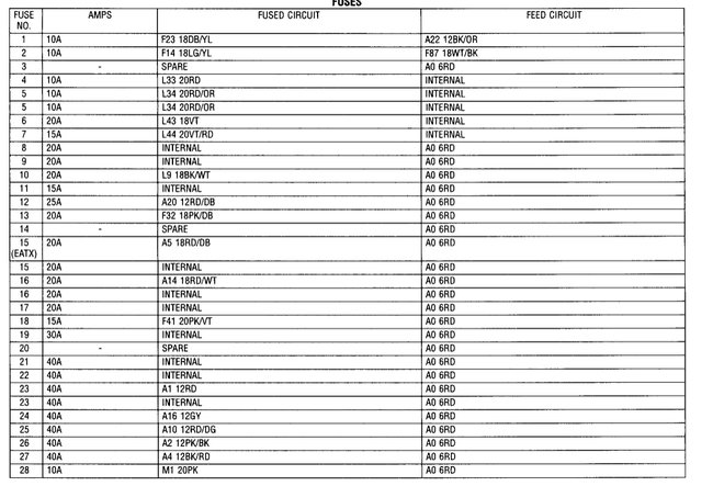

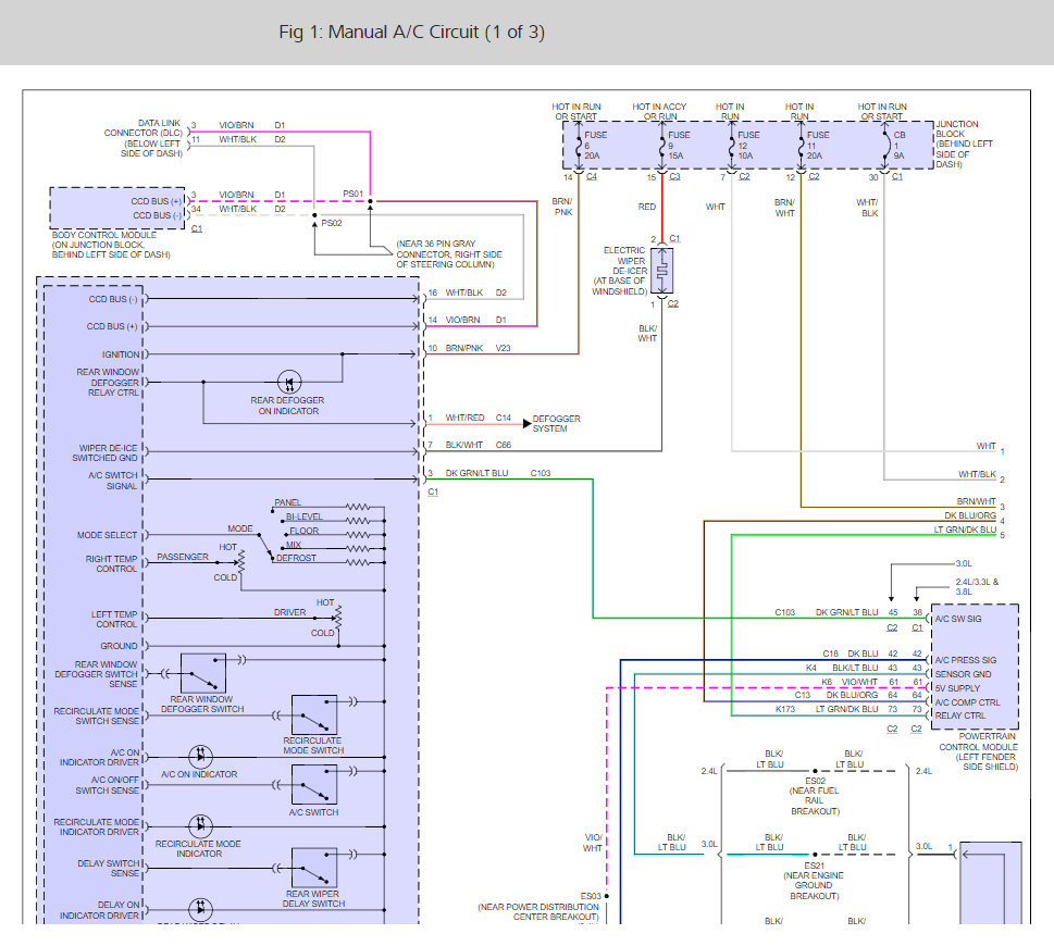

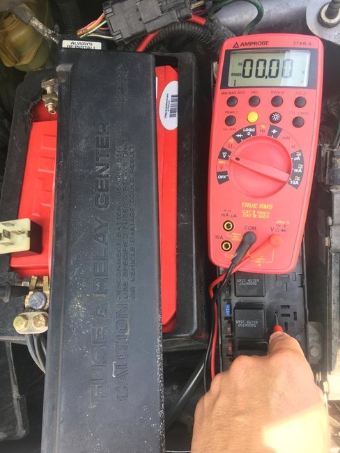

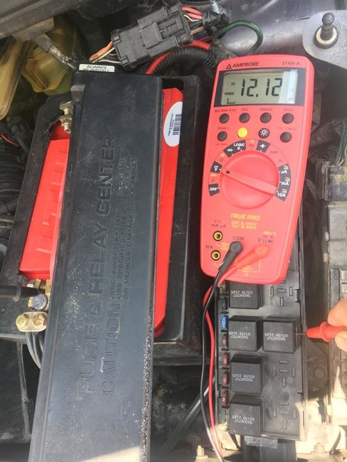

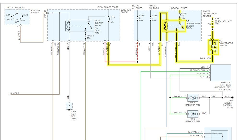

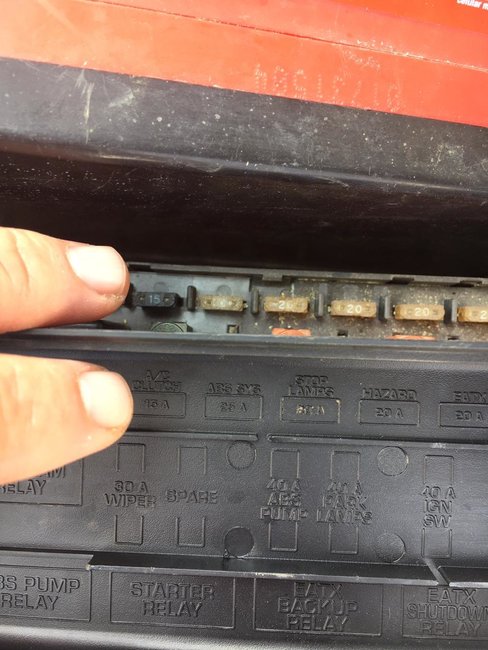

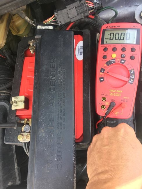

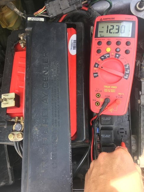

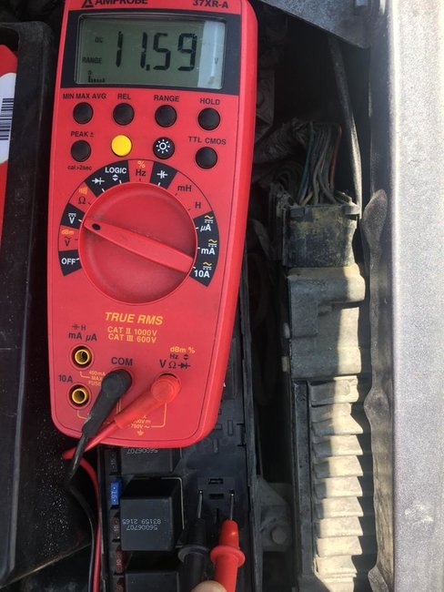

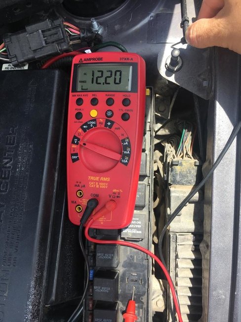

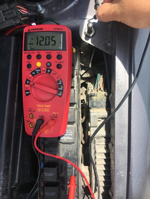

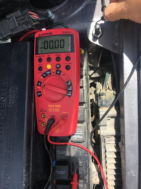

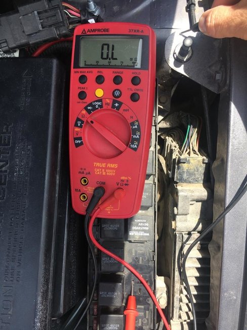

Checked for Freon was really low pulled vacuum and checked for leaks and refilled per manual! After doing this it was driven five miles and it stopped blowing cool air check pressure it was great, but the compressor was not engaging. So I checked the relay when I depressed it down it would work and blow cool for a minute this van is a LXI Need help!
KEN L
  • MASTER CERTIFIED MECHANIC
  • 48,363 POSTS
It sounds like you have a fuse (there are several) that is out or a pressure switch is not working. Here is a couple guides and diagrams (below) to help us do some simple tests to figure out what the problem is.
and
and
Please run some tests and get back to us so we can keep helping you.
