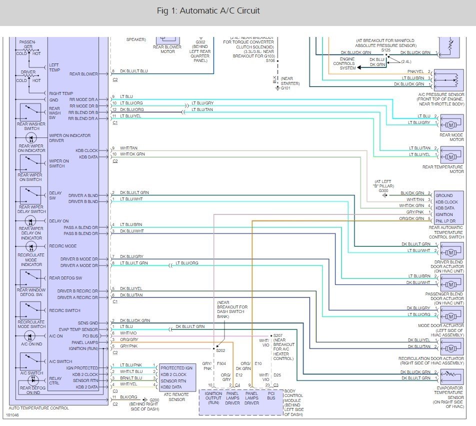

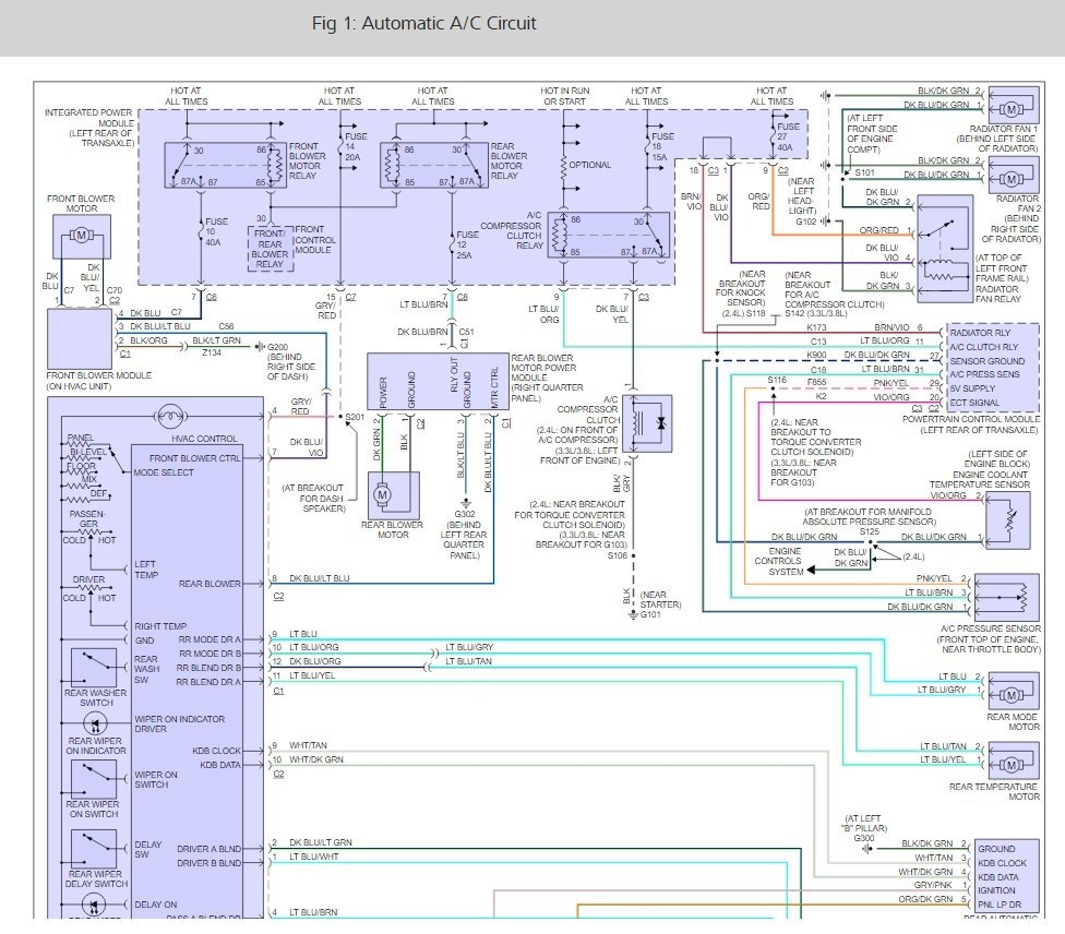

It looks like there is a compressor relay as well as several fuses that run the system. Here is a wiring diagram (below) and a guide to help you do some testing to get the problem fixed.
and
See where the system is dropping the power or not getting signal
Please run some tests and get back to us so we can continue helping you.

Thanks Ken. I had found some other schematics as well. These seem to be a little more detailed. I posted at the chrysler minivan forum and auto ac forum and got little help.

I have 12v+ at pin 30 of the a/c relay and 15 ohms from pin 87 to batt (-).
And I have 12v+ on pin 86 when the a/c switch is turned on at the hvac control.
I'm good to the relay, right?
Jun 23, 2017 at 12:19 AM
  • 55,577 POSTS
Yep the relay is good it sounds like. Do you have power at the compressor?

I didn't go directly to the compressor this time, but if I pull the relay and short the 30/87 contacts the compressor runs and cools.

off you short it and it works. then it's fuse box not making contact try tweeking prongs onrelay and using dielectric grease on them to make compressor work

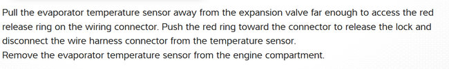

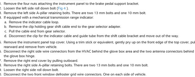

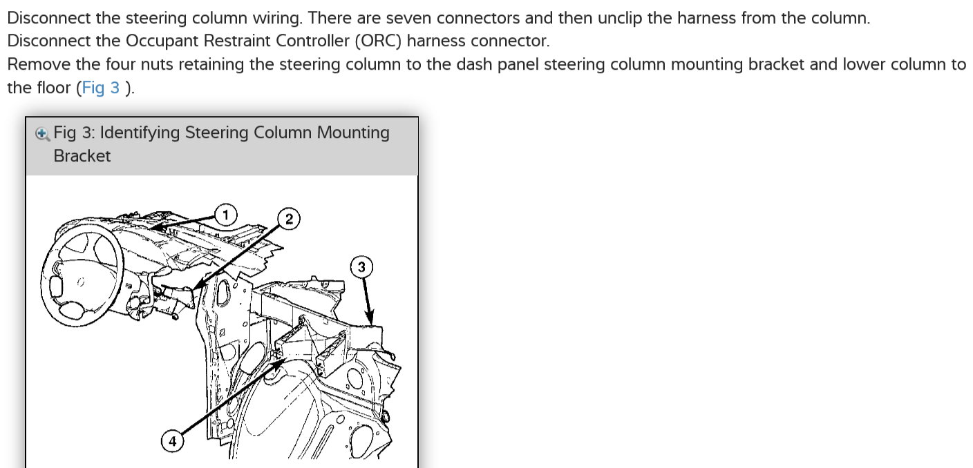

  • 11 POSTS

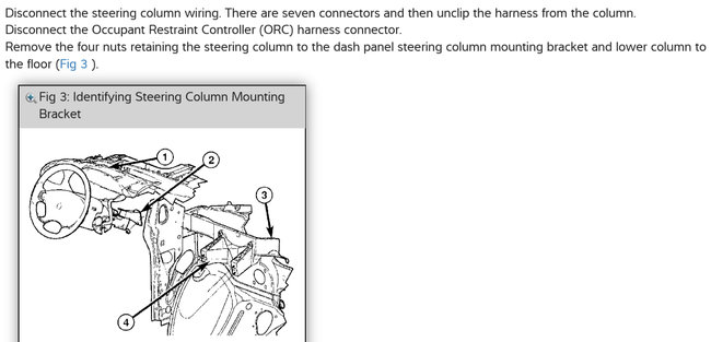

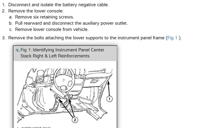

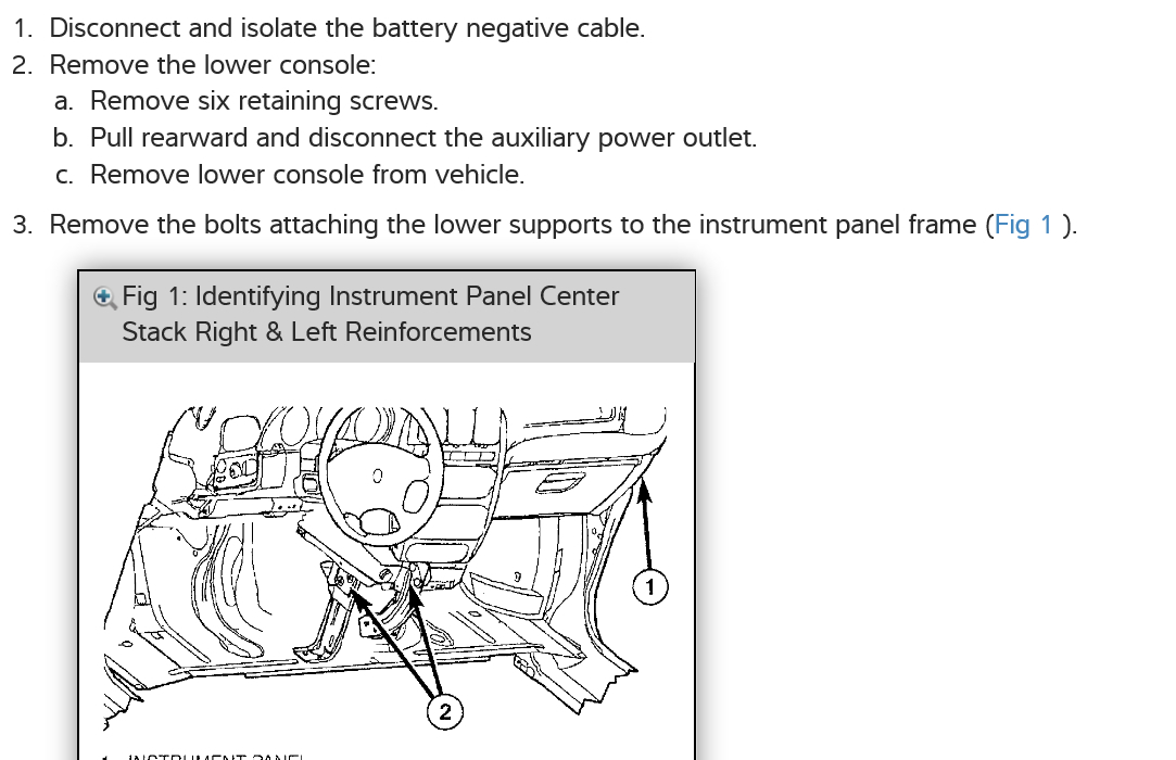

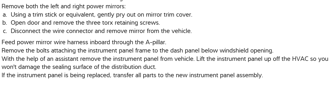

Tech says evap temp sensor. Repair cost over 1k. I will either figure out how to do it myself or get by w/o a/c. I have no info on the sensor other than the tech saying the dash has to come out. Can't find a listing for the part either.
Jul 11, 2017 at 2:42 AM
HMAC300
  • 48,601 POSTS

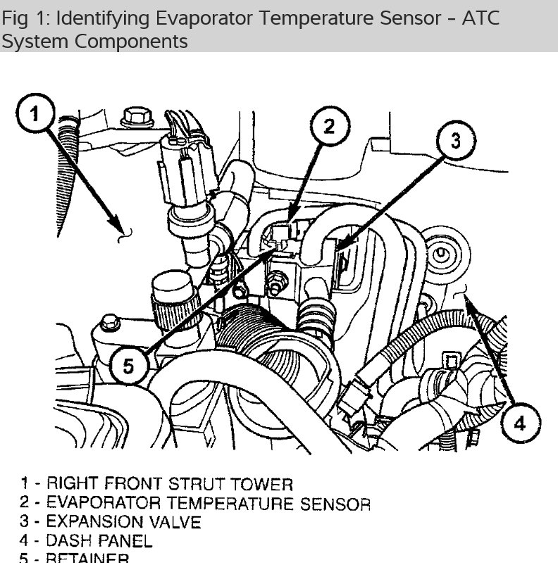

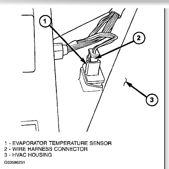

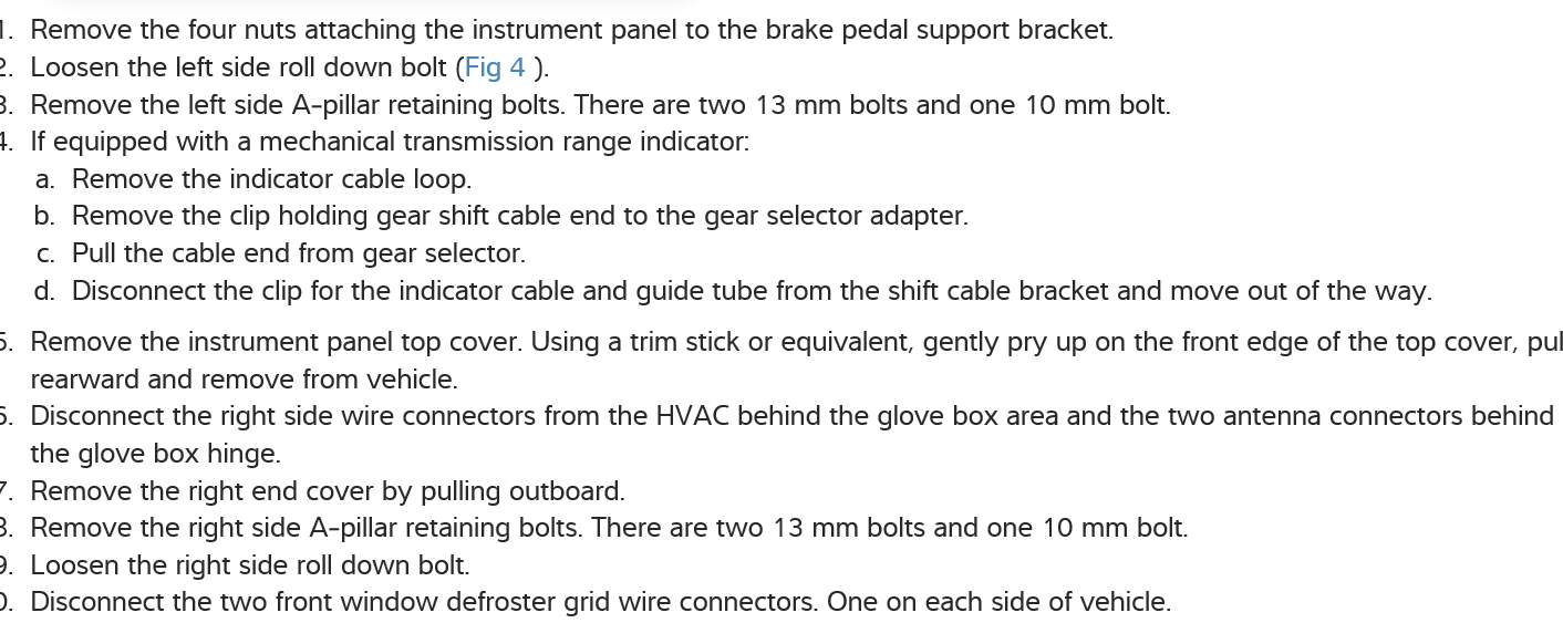

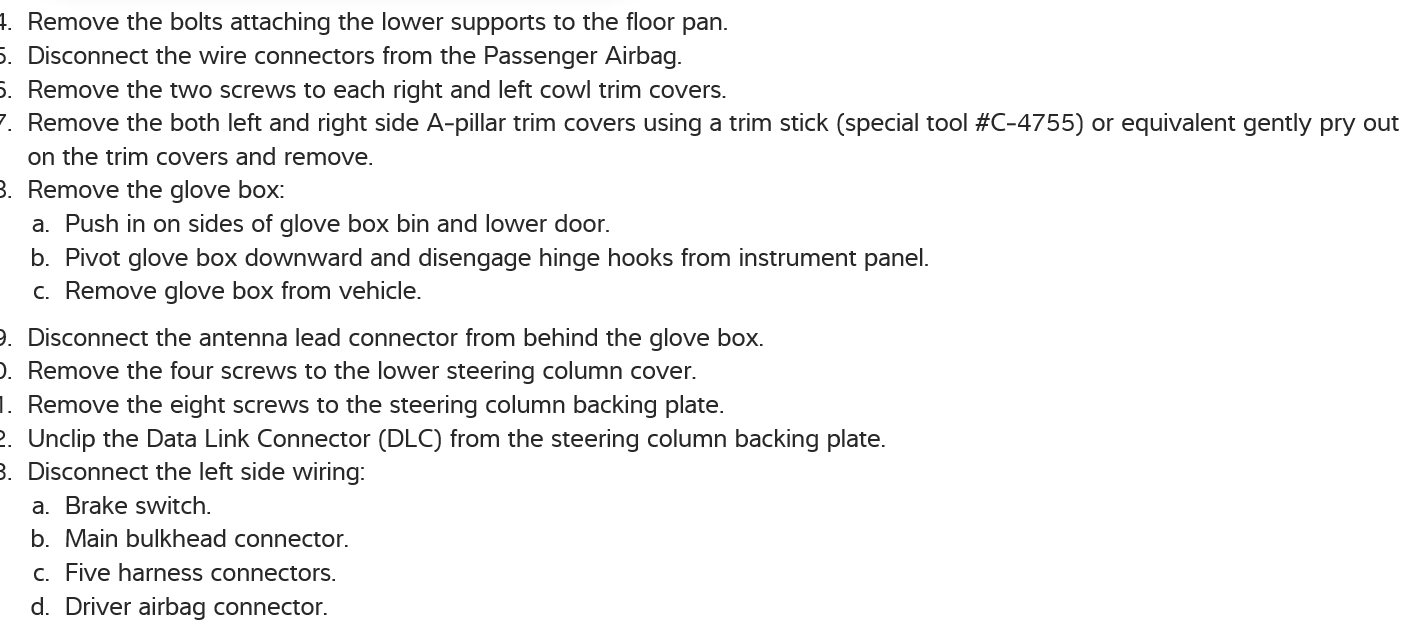

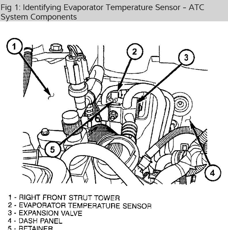

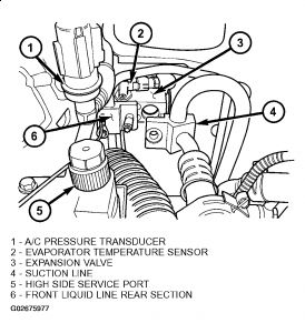

I am assuming this is manual control if it were me i'd try going through glove box with it out and getting evap sensor as it is on top of hvac.there are only 2 bolts for that and harness but here is stuff in pics enjoy
Jul 11, 2017 at 5:10 AM
N2AUDIO
  • 11 POSTS
It's auto
Jul 11, 2017 at 5:22 AM
HMAC300
  • 48,601 POSTS

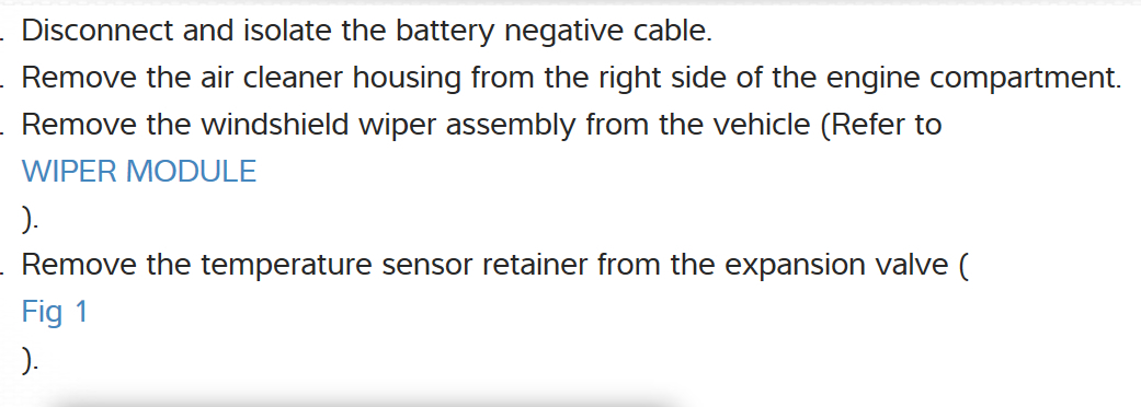

I think it will be the same but let us know about that stuff in future you are very lucky it's underhood and dash doesn't need to be pulled see pics.

This can be done w/o evacuating the refrigerant?
Jul 12, 2017 at 7:04 AM
HMAC300
  • 48,601 POSTS
no evacuate then recharge as it looks like it's attached to expansion valve and that has to come off
Jul 12, 2017 at 8:19 AM
N2AUDIO
  • 11 POSTS
Got it done. Wasn't terribly difficult. Had some problem locating the part because the evaporator temp sensor on this vehicle is actually PART of the expansion valve. The dealership sold me the wrong part.
The OEM expansion valve is a $120 part. I found an aftermarket option for $32.
Also had a problem with the bolts holding the expansion valve to the firewall. The bolts thread into a block of aluminum and the threads partially stripped on removal. I had to buy a tap and die kit to clean the aluminum off the bolt. Luckily the female threads were intact enough to allow the bolt to tighten on reassembly.
