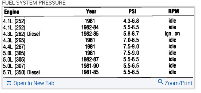

When the car starts it runs ragged and tries to stall
VINCE LETTAU
  • 1990 CADILLAC FLEETWOOD
  • V8
  • 2WD
  • 112,000 MILES
The engine runs real rough when it starts and backfires then after it starts to idle it runs good, but when you come to a stop or turn it want to surge. Someone said to disconnect the air compressor witch I did and did not make a difference. One time it backed fired going down the road at 55 mph and blew the muffler off. Any ideas?

This sounds like a weak fuel pump. To be sure lets run down these two guides to check the pressure and get run the codes.

When I get a fuel pressure gauge I will let you know. Thanks

They will rent one to you for free at AutoZone.
