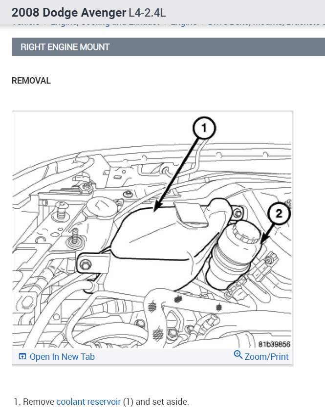

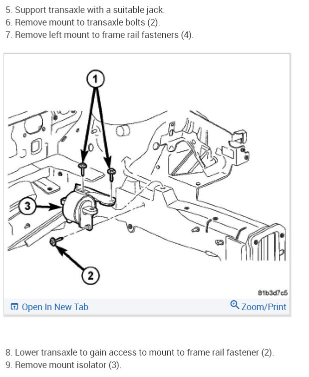

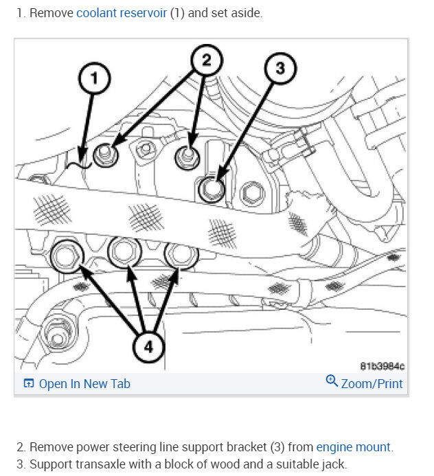

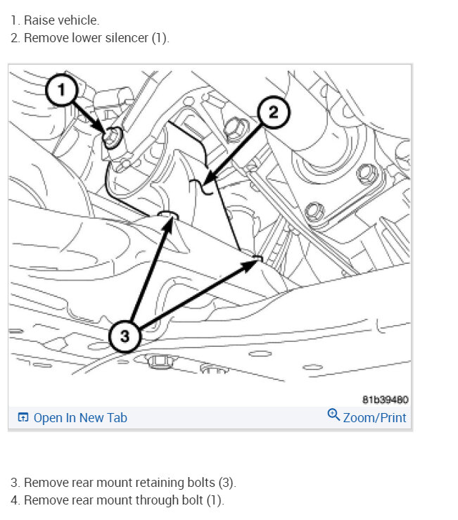

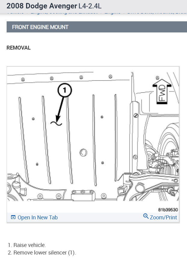

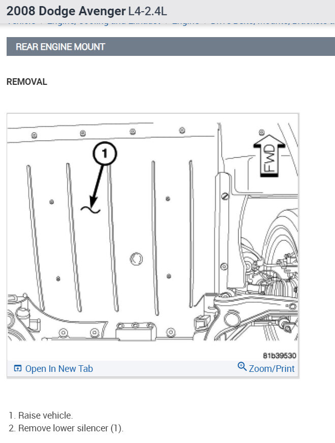

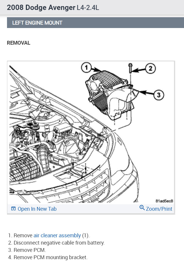

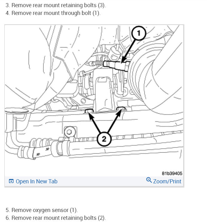

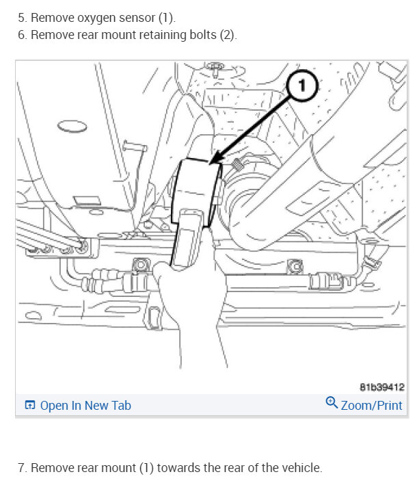

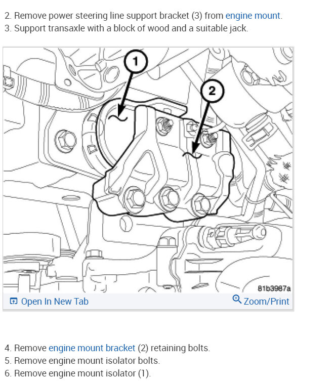

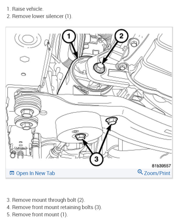

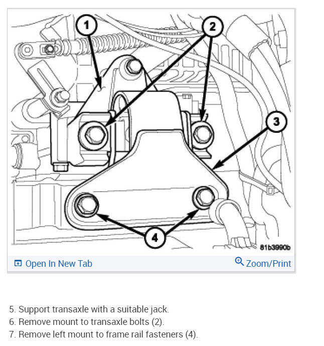

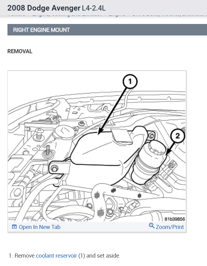

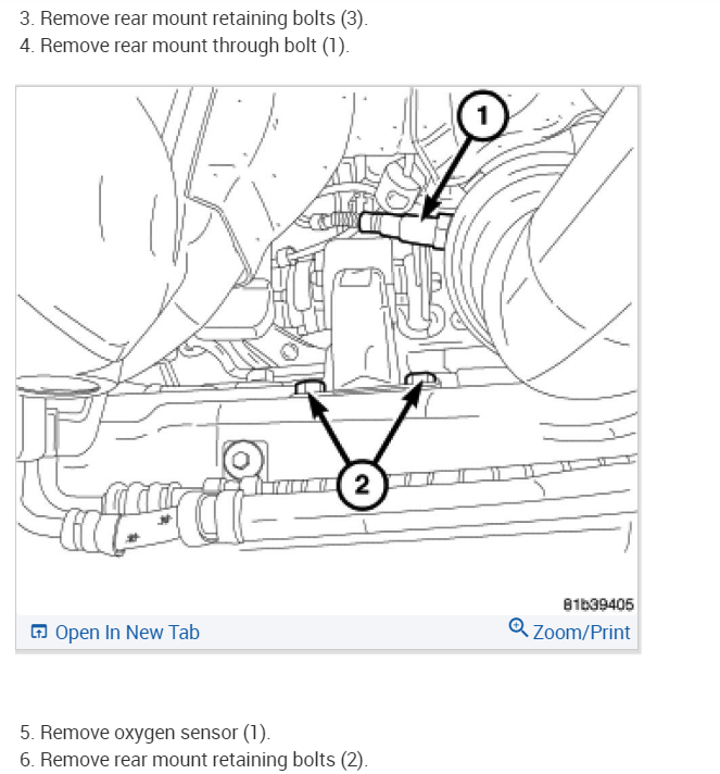

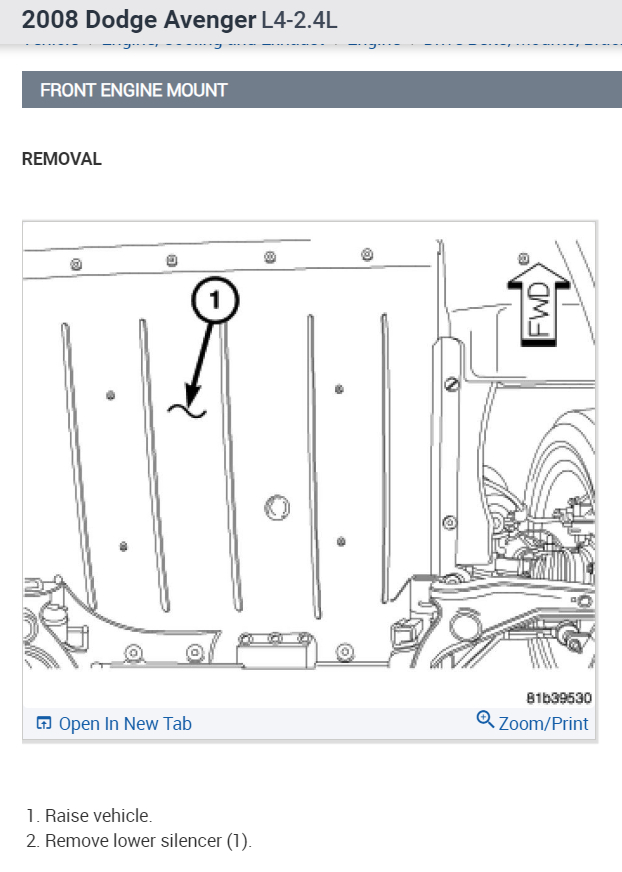

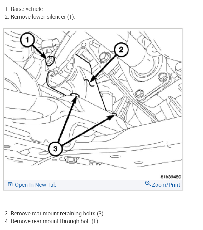

Yep, it can be, can you please shoot a quick video with your phone so I can hear the noise? That way I can tell for sure what's going on. You can upload it here with your response. I would open the hood and have a helper cycle the transmission between drive and reverse while the brakes are on. You observe the engine movement to check if it is excessive. Please check out this guide:
https://www.2carpros.com/articles/comprehensive-guide-to-checking-and-replacing-automotive-engine-mounts
Here is how to change the engine mounts out. Check out the images (below). Please let us know what happens.
Aug 10, 2023 at 10:45 AM

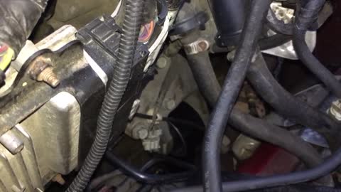

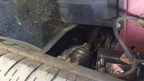

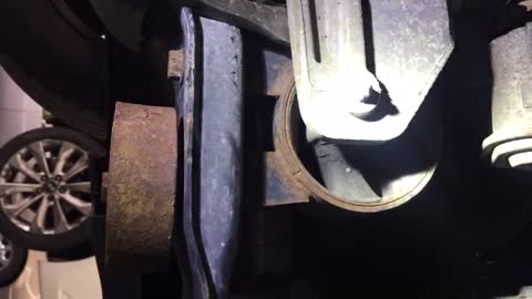

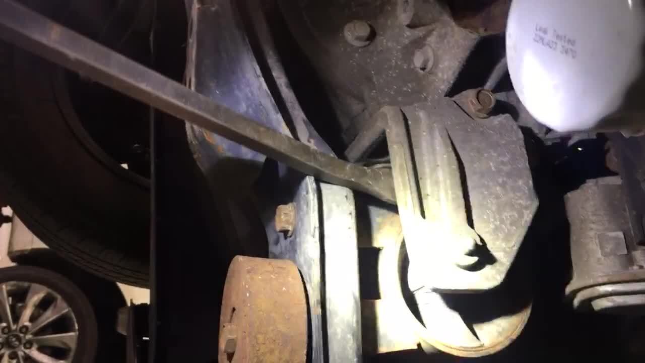

This is the video from when I went to get an inspection. I’ve done exactly what you said yesterday before I got the passenger axle fixed. The engine moves back and forth and makes a clunk only when shifted to reverse. The guy told me to get my passenger side axel (but it’s still clunking just nowhere near as bad) and then he said do the transmission mount (the one that’s on the bottom in the back) should I do both that’s on the bottom in the video I sent? And I’ll send a video tomorrow of how it looks/sounds when shifting.
Aug 10, 2023 at 12:11 PM
  • 55,224 POSTS
Thanks for the video. Yep, those mounts are bad and need to be replaced. Good find on that.

Yes, I would get a full set of engine and transmission mounts, I looked over the mount replacement instructions and it doesn't say the subframe needs to be removed.

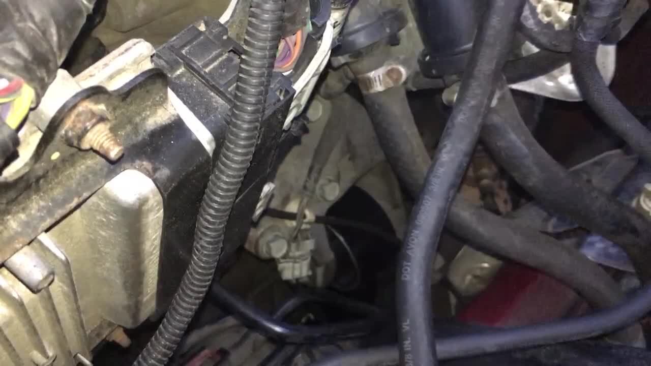

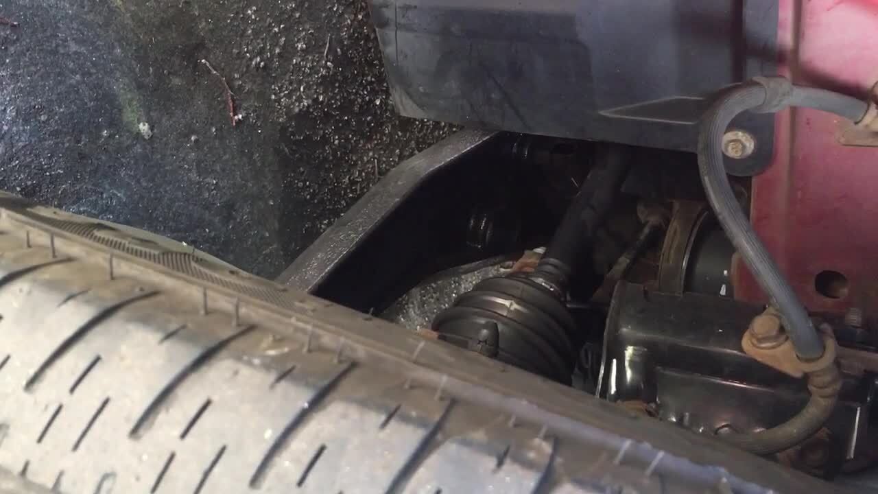

Okay thanks. And I got my bottom engine mounts put on. I put my foot on the brake, shifted to drive, and pressed the gas. I’m still hearing a clunking nose. I’ll send the video now.

The first video I sent you earlier today. Looking at the axle, that’s when I put both brakes, and pressed on the gas and it clunks. This second video is the vibrating in idle. it looks like the transmission mount isn’t secure because the engine is moving and vibrating only in idle on reverse .

  • 55,224 POSTS

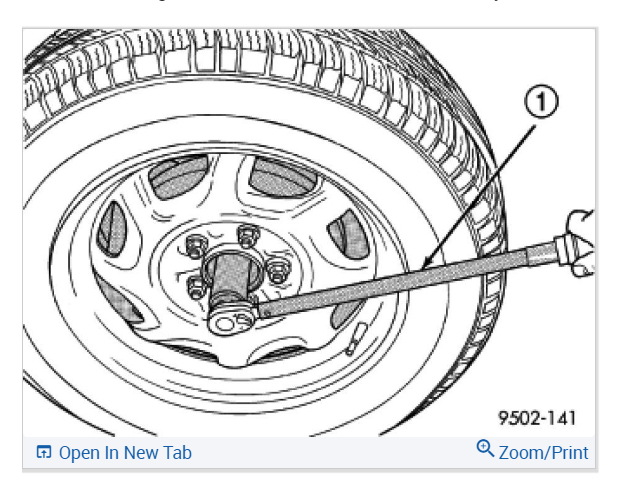

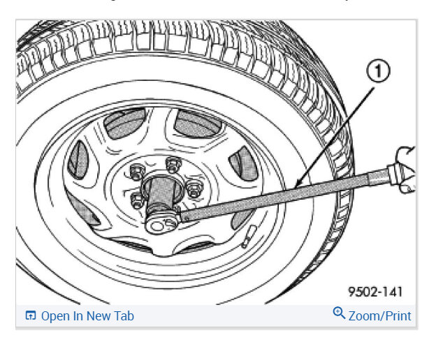

On the first video it looks like the axle is loose in the hub, I would try tightening it to see if it is loose.
1. Install front wheel and tire assembly. Install and tighten the wheel mounting stud nuts in proper sequence until all nuts are torqued (1) to half the required specification. Then repeat the tightening sequence to the full specified torque of 135 Nm (100 ft. lbs.).
2. Lower vehicle.
3. With the vehicle's brakes applied to keep hub from turning, tighten the hub nut to a torque of 160 Nm (118 ft. lbs.).
On the second video it looks the mount is still moving too much, did they replace that one Check out the images (below). Please let us know how it goes.

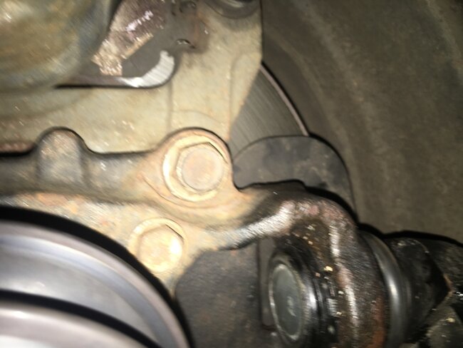

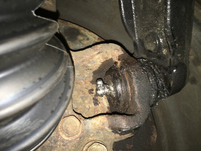

Hey, is this normal? I got both lower ball joints replaced, my driver's side is the one without the ball and the passenger is the one with the silver ball. The passenger has this black thick grease on it and the driver's side doesn’t.
Aug 19, 2023 at 11:51 AM

This is the passenger side with the thick black grease.

  • 55,224 POSTS
Yep, that is normal.

Okay. Why does one side have the thick black goo but the other one doesn’t?
Aug 20, 2023 at 9:09 AM
  • 55,224 POSTS
It looks like the ball joint boot is leaking on the old ball joint.

Hey, so I found out why my car is shaking in idle while in reverse after replacing engine mounts. One my bolts are missing on the bottom trans mount. I tried to put another bolt in, but the thread is gone. Is there anyways I can fix it?
Sep 11, 2023 at 3:25 AM
  • 55,224 POSTS
Good find, yep you can install a Heli coil.
