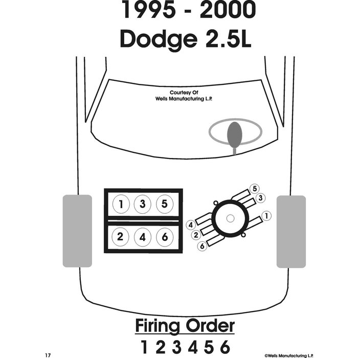

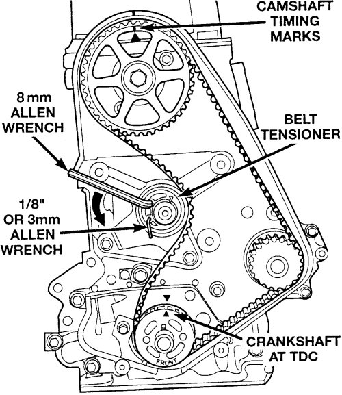

how do i make sure cam or distributer are in the v right place.
1997 DODGE AVENGER
110,000 MILES • 0.5L • 6 CYL • 2WD • AUTOMATIC
BRYCE MCFALL
MEMBER
2 POSTS
Cam and distributer settings.
Jul 8, 2016 at 11:32 AM
RIVERMIKERAT
Experienced Mechanic
6,106 POSTS
See images attached.
