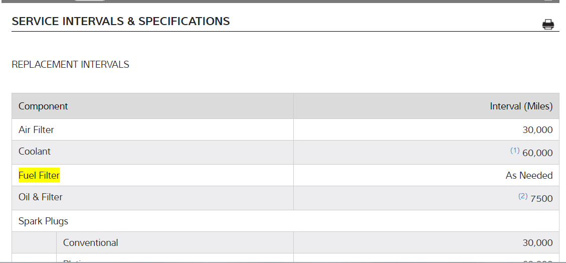

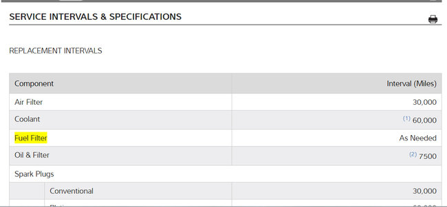

I took the crank sensor back out because it gave me two codes. I put the original one back and no codes. I will check the IAC this weekend because the car is stalling at stoplights and acting like it is not getting fuel? Could this be as simple as a fuel filter?
Friday, June 25th, 2021 AT 12:49 PM (Merged)
SCGRANTURISMO
  • 4,897 POSTS

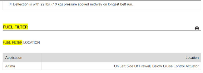

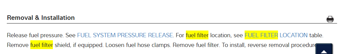

Sure. If the filter gets clocked it would definitely cause idle issues and poor, erratic acceleration until it hits a spot and will have enough fuel passing through it that will start to run fine again. I have included a link for you to go to below:
https://www.2carpros.com/articles/how-to-change-a-fuel-filter
I have also included vehicle specific information for your vehicle in the diagrams down below. Please go through these guides and get back to us with what you find out.
Thanks,
Alex
2CarPros
