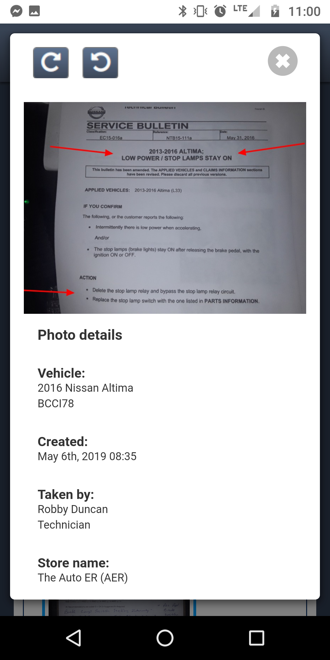

Just got my car fixed! Here's what they found:
May 7, 2019 at 1:10 PM
  • 55,721 POSTS
Nice work! the image is too small to read. can you do a new one or just tell us?
