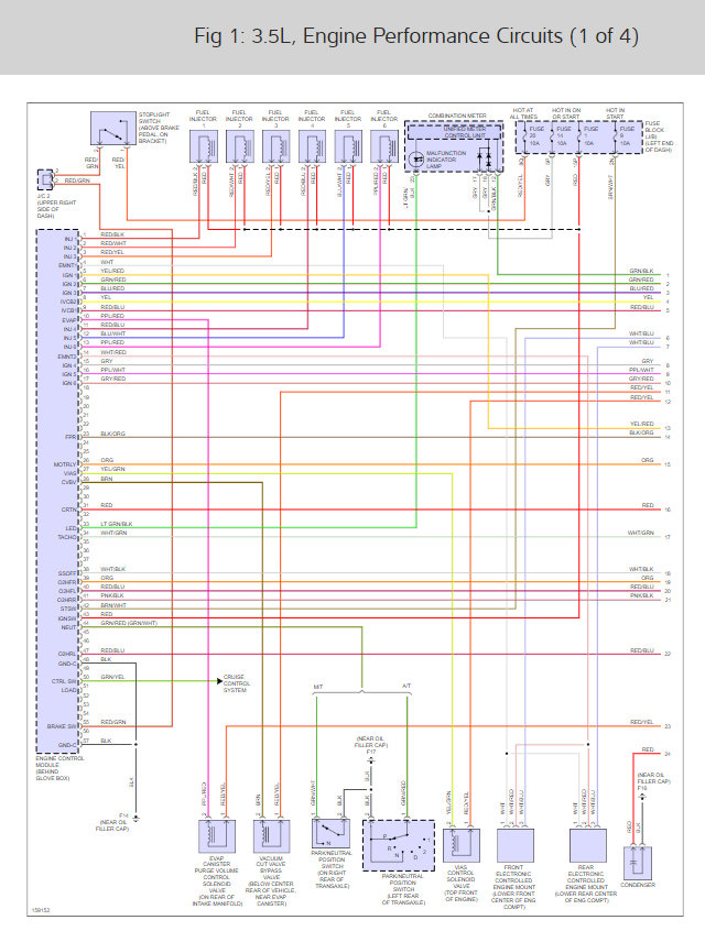

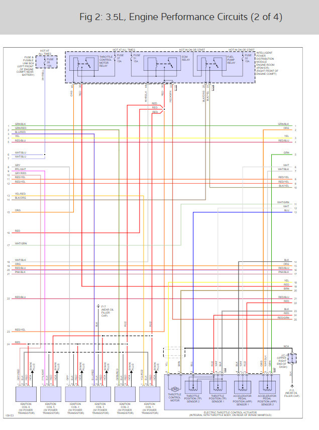

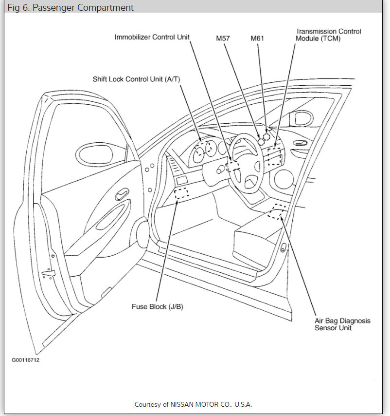

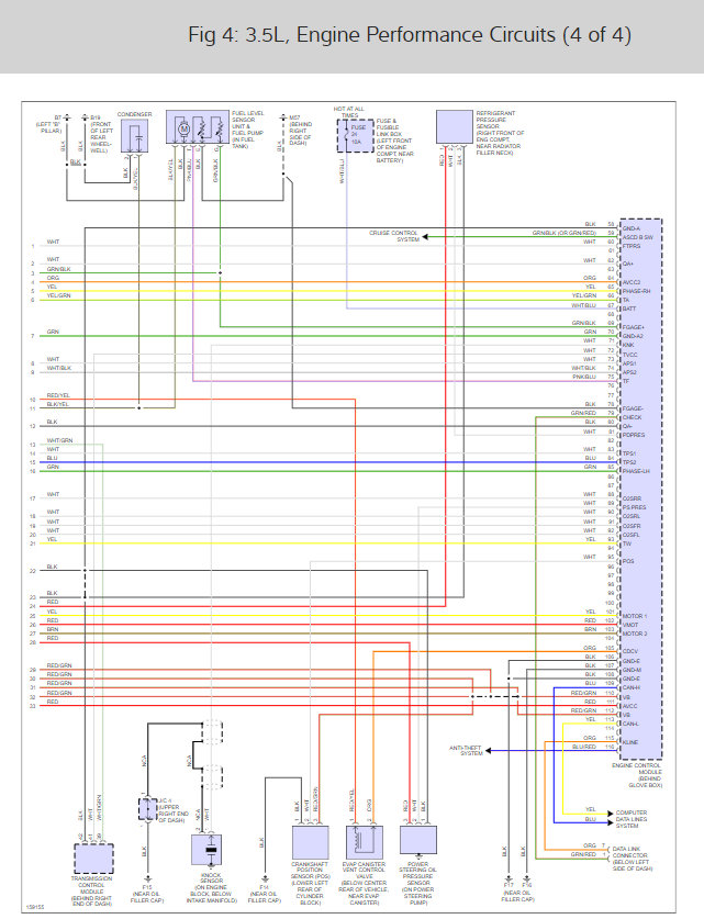

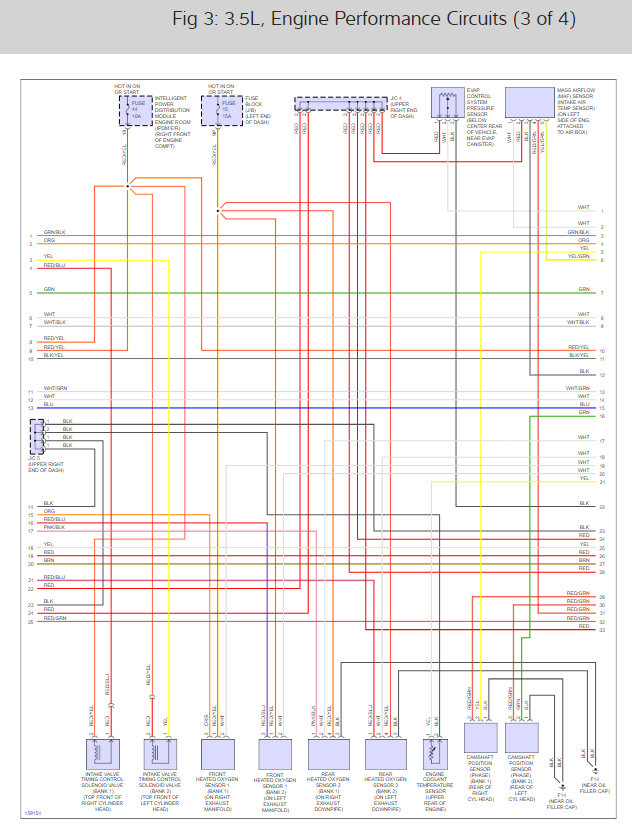

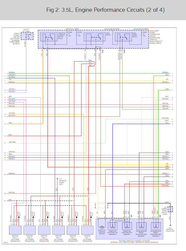

I have a 2002 Nissan Altima with the 3.5L engine. It has 75,000 miles. Yesterday it wouldn't start because the battery was dead. I tried charging it but it didn't help. I replaced the battery but now the car will not accelerate when you push on the gas pedal. It idles perfectly and does not throw any error codes when check by an OBDII code reader. If you accelerate within one second after it starts it will surge, idle, surge, idle and then settle into idle. After that nothing happens when you push the accelerator. Does anyone know what is wrong? Is this something I can repair or reset on the car myself? Thanks for your help.
P.S. I may have posted this already. If so, I apologize for double posting it. Thanks once again.
+4
Tuesday, January 22nd, 2019 AT 1:25 PM (Merged)
2CARPRO JACK
  • 11,533 POSTS

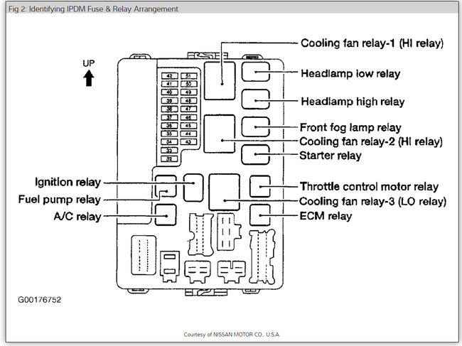

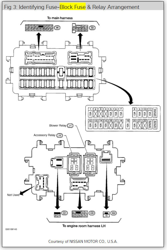

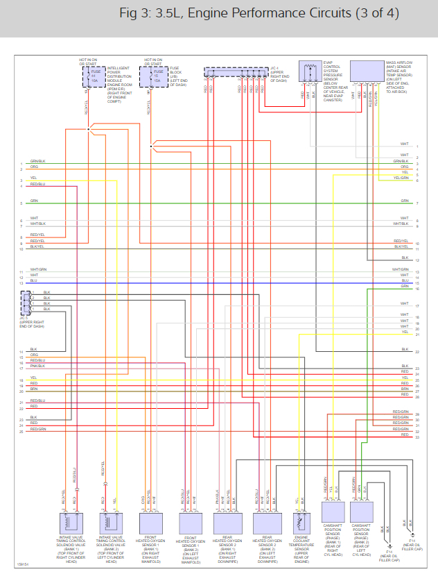

Is sounds like you blew one of the fuses when connecting the new battery due to a voltage surge. Lets start by checking all fuses.
Here are the engine wiring diagrams so you can see how the system works and which fuses to check with the fuse panels location and identification.
Cheers
-1
BARBQME2
  • 5 POSTS
Thanks, Jack.
All the fuses are okay so I let it set overnight. When I started it this morning the accelerator worked like it is supposed to. I drove it and at first it surged but then it settled down and drove correctly. I drove it about 5 miles with no problems. For no reason that I could see it started acting up again. It would surge and then nothing would happen. While it was surging the car would move. When it wouldn't the car would coast. When I checked it with a code reader it gave me a P0733 code. I know what the code means but don't know what causes it. Could this be caused by a failing fuel pump, stopped filter, or is this electronic? Do you know what the next diagnostic step is? Thanks.
