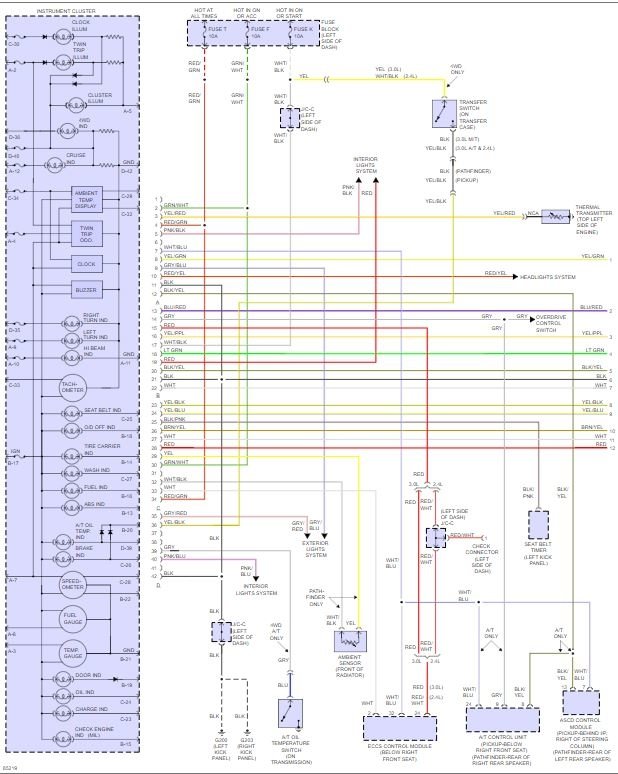

After truck warms up and my gauge gets about to the half way the gauge flutters but never reaches the red side, but close sometimes. Then it will settle down for a few seconds and again flutters. I have replaced the temperature sending unit and it still does it.

If this is the only gauge that that behaves this way? I doubt if it is a bad cluster because I see that gauge shares power and grounds with other gauges, but that does not mean that just that gauge is not bad. I suspect though either a bad gauge or the wire is loose and/or making a bad connection or partially shorted. After the engine warms a little until the gauge registers some in order to check it, wiggle the wire from that "thermal transmitter" located top left side of engine all the way up to the cluster connection and see if you can make the gauge fluctuate when you wiggle the wire. You may need a helper to watch the gauge. If you find a spot that makes the gauge move, check that spot for being loose and/or shorted and if you cannot find anything, and moving it does cause the gauge to fluctuate, the wire strands inside the wire may be broken, so replace the wire.

I just want to say thank you to whomever helped me with this. I can not say for sure what it was but I did as you suggested to wiggle wires and I did so on the temperature sending unit and my gauge has been working great. No problems at all. I sincerely thank you from my heart. I will tell everyone to support this site. Have a good day, Linda
