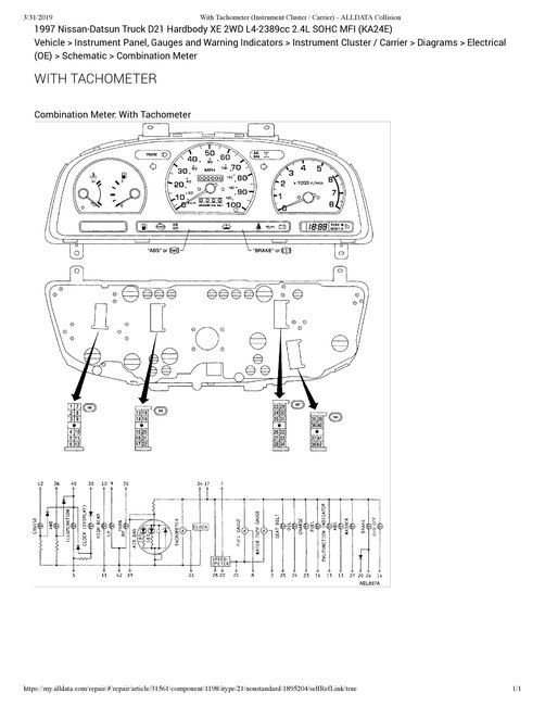

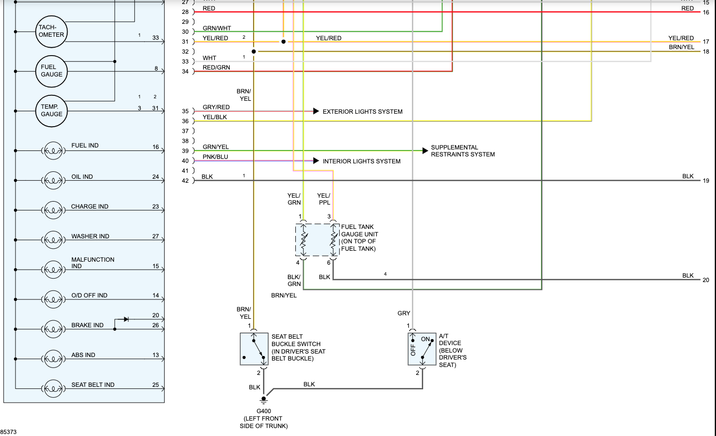

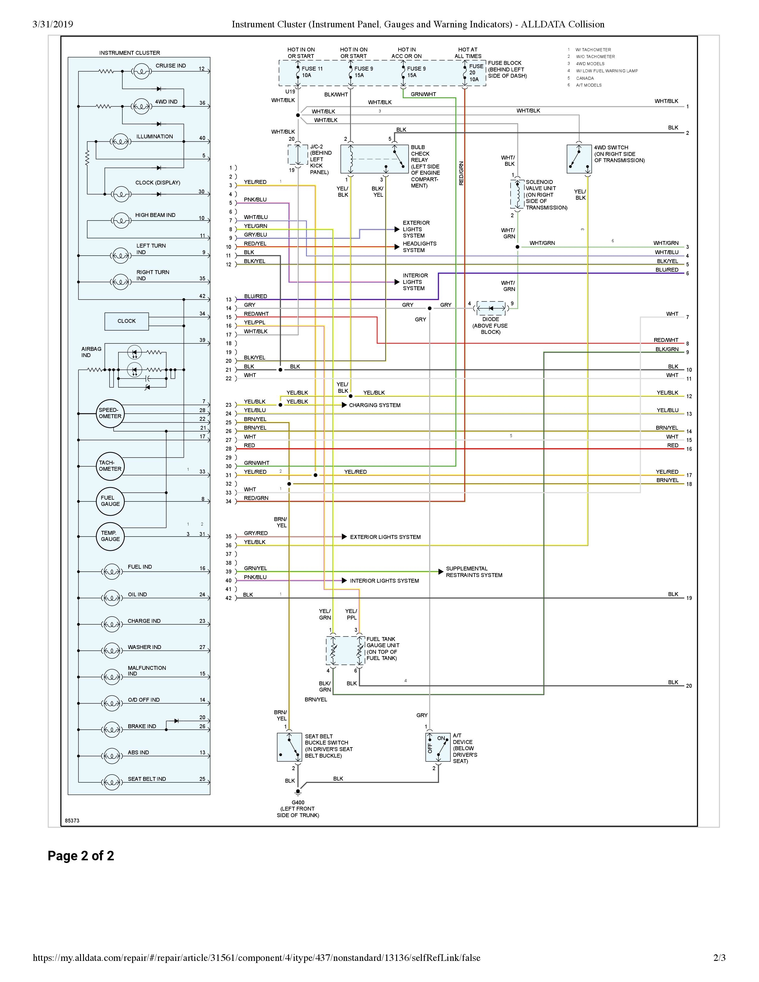

Hey EDBREHM,
We are working on a 1997 D21/Hardbody right?
Please see the attached wiring diagram for the instrument cluster.
I have also attached the pin location diagram.
It looks like the fuel and temperature gauges share a ground connection inside the instrument cluster.
Does the speedometer work correctly?
Do both temperature and fuel gauges rear 0 - needles don't move at all?
You will need to remove the instrument cluster to carry out some tests with a multimeter to pin point the cause of the issue.
Do you have access to a multimeter?
Can you please send a picture of you instrument panel?
Just to make sure we have the right information.
Rgards, Joe

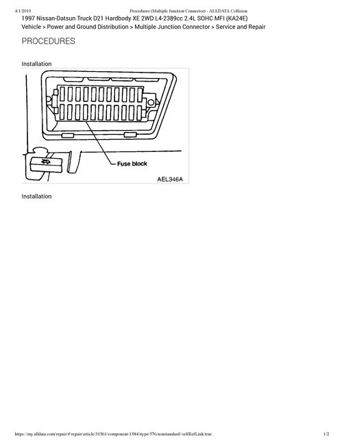

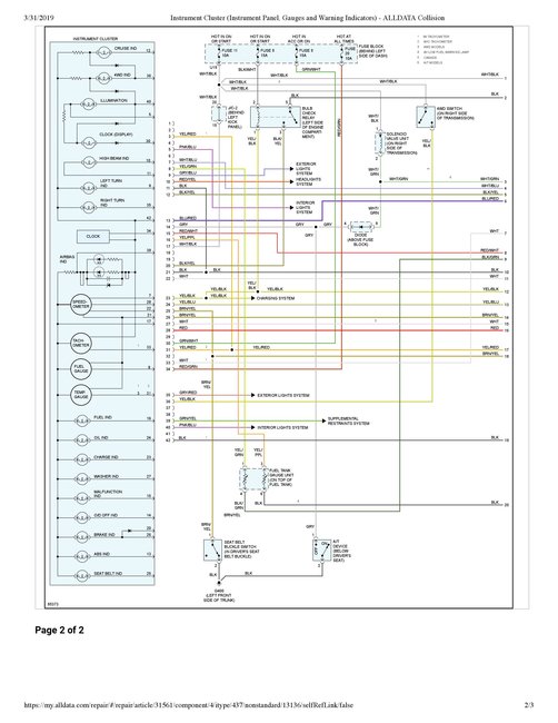

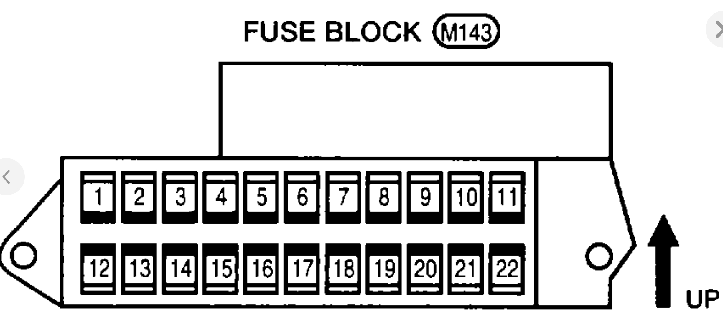

Can you please start by checking the fuses?
Guide on how to check fuses below:
I have attached the wiring diagrams again, the first ones came out a bit small.
You are looking for fuses 9,11 and 20.

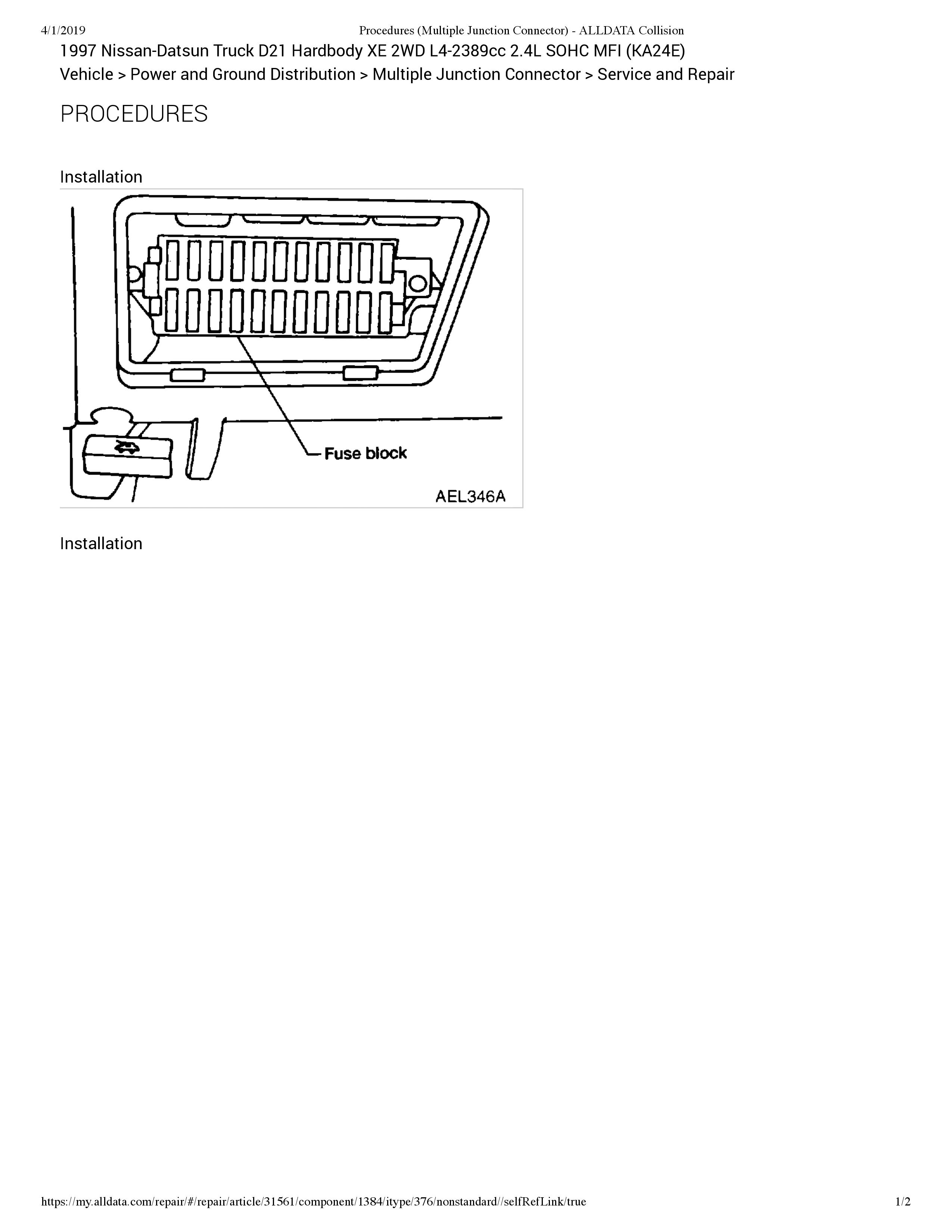

The fuse board should be under the left side of the dash.
Report back on what you find.
If these are okay you will need to check at the back of the instrument panel.
Regards, Joe

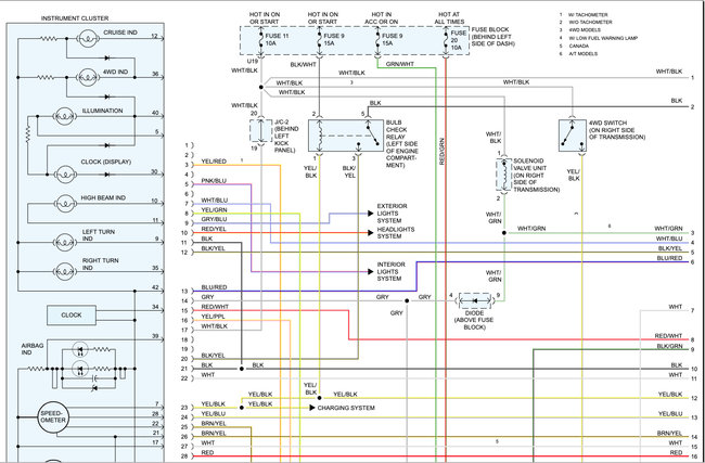

Hey RAJ42763@YAHOO.COM,
Do you own a test light or a multimeter?

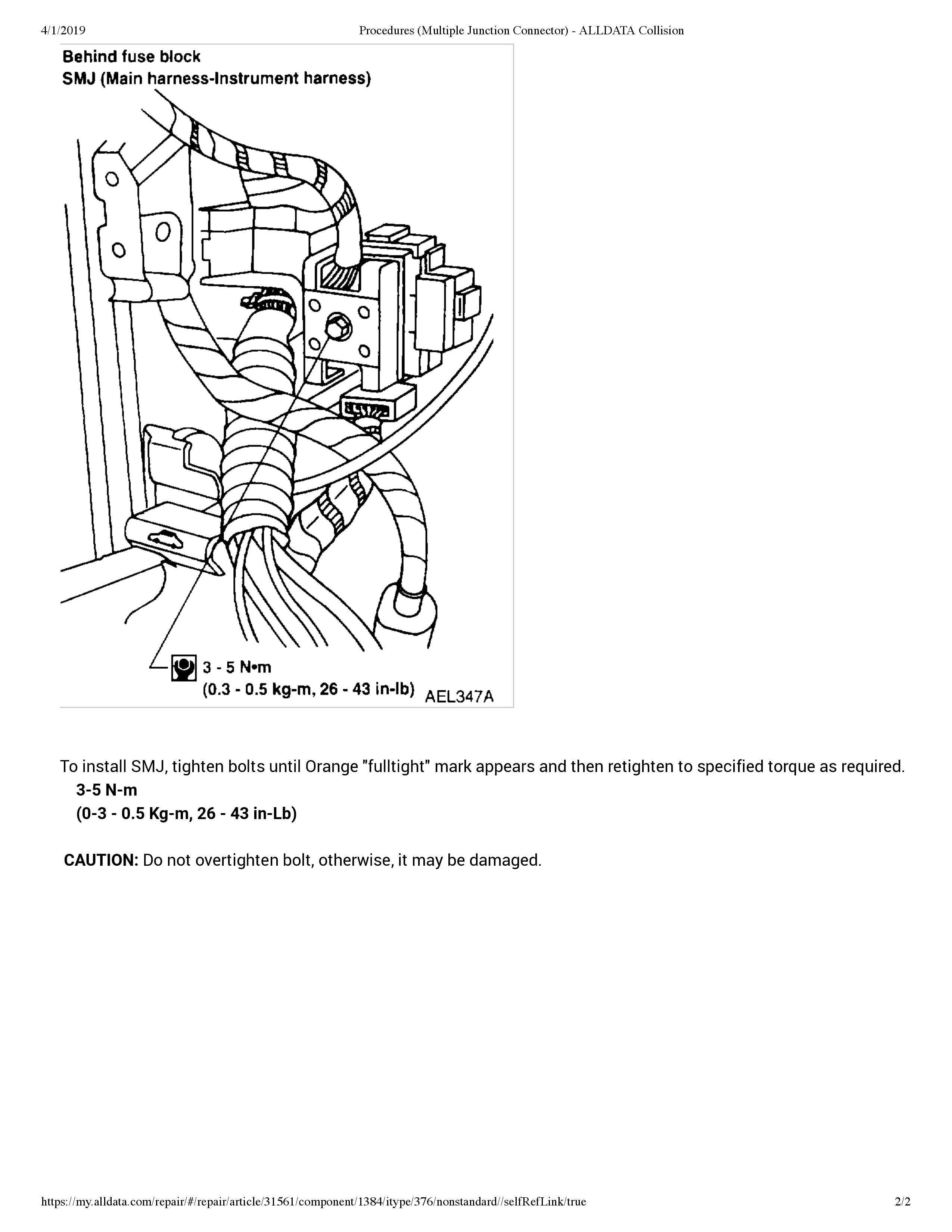

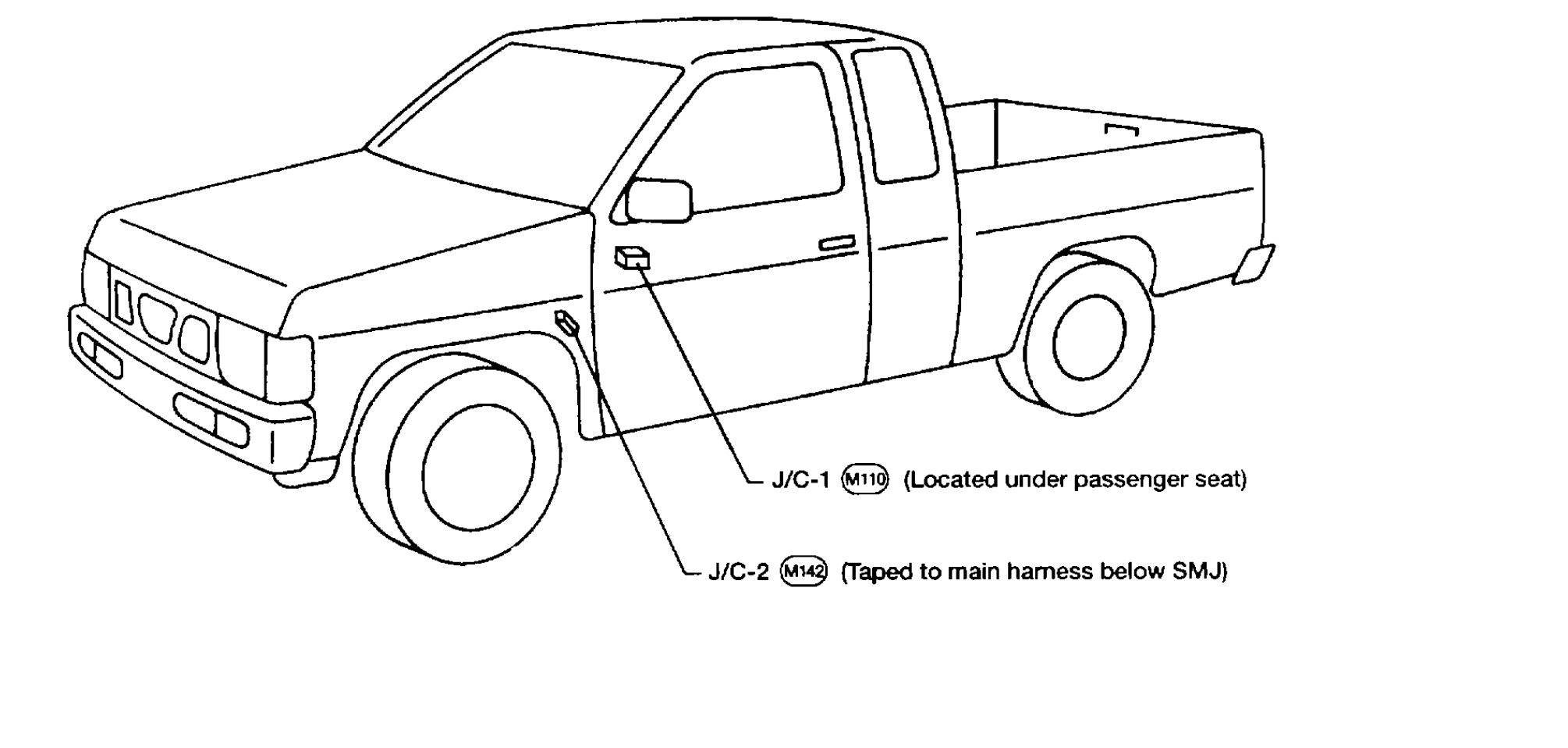

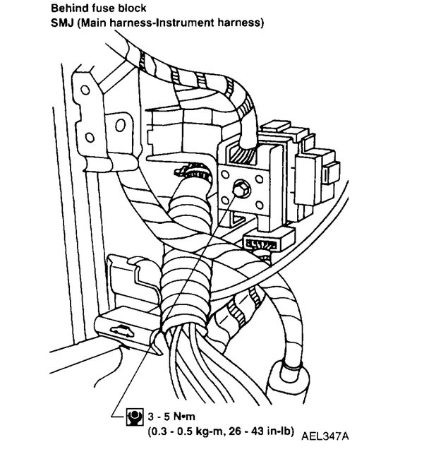

There is a connector that you can check anyway.
The ground for the instruments runs through the connector J/C-2 on the diagram attached.
It is below the SMJ connector i have attached a diagram for this, it would also be good to disconnect the SMJ connector and check this for corrosion.
Check the condition of these connectors, if loose or corroded this could be your issue.
Regards, Joe

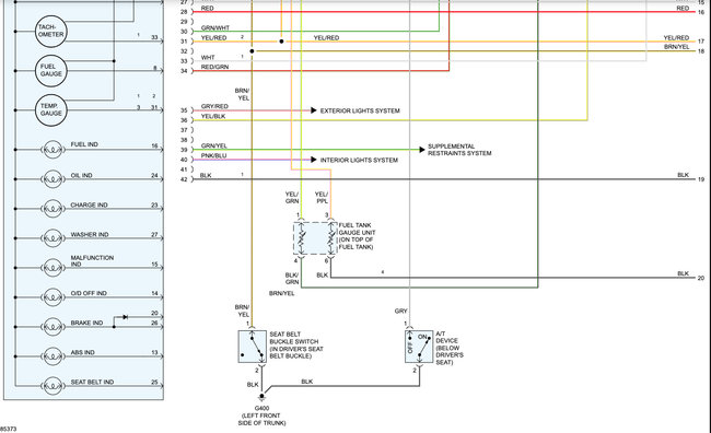

Please remove the instrument cluster and check for voltage between the black wire pin 42 (ground) and the following pins -
pin 34 - red/green wire, should be permanent feed 12V
pin 30 green/white wire should be12V with key in accessory/ignition positions
pin 17 - 12V with ignition on or when cranking
If you get nothing on any of these tests then try the same test but take the black lead from your multimeter and place it on a known good chassis ground instead of at pin 42.
Let me know what you get.
Regards, Joe
Can you recheck that you have voltage at both sides of both fuses 9 and 20?
Pin 17 is a white/black wire.
If you have power to fuses 9 and 20 but no power at the red/green wire or the green/white on the cluster then you must have a break in the wire/bad connection between the fuse box and the cluster.
Have you made sure the ground you are using for testing is good?
If you check between battery positive and that ground you should have 12 volts.
Also if you check between the black wire on the back of the instruments and the battery negative/known good ground you should also have 0 volts.
Regards, Joe

I have unhooked the SMJ connector and checked the red/green wire also the green/white wire and white/black wire with my multi-meter and all wires checked good. I have got power on all the fuses. What do I need to do next?

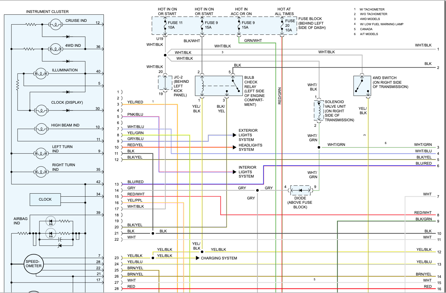

Hey raj42763@yahoo.com,
Okay, so we are getting somewhere.
I think the fuse numbering on the diagram i have must be wrong. So the green/white wire should be fuse 6 15A.
I have gone through the diagram again and it looks like the white/black wire should power most of the functions on the instrument cluster.
When you are checking and have 12.5 volts at the back of the cluster where is your black lead?
Try checking with the black lead on any of the black wires at the back of the instrument cluster, do you still have 12.5V? There should be three black ground wires connected to the back of the instrument cluster but the all connect further down in the harness.
I think potentially you have a bad ground.
Regards, Joe

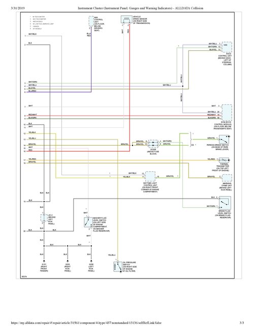

A quick test with your multimeter set to voltage can you check between the black wires on the back of the cluster and the negative on the battery?
You should have 0V if the ground is good.
Have you checked the connector Below the SMJ?
it should have the black/white wire running through.
Do you have daytime running lights?
It looks like there is a daytime running light controller at the right front corner of the engine compartment that is also supplied by the same wire.
Regards, Joe

Then check where the black white wire goes in/out of the connector below the SMJ.
You should still have 12V.
If you have 12V in all of these places then you have to have an issue between the connector (SMJ) and the panel.
Take your black lead and put it on the SMJ connector black white wire and put your red lead on the black/white wire on the back of the cluster. If this checks out you should have 10V roughly, the voltage used before the cluster and causing your issue.

Hey RAJ42763@YAHOO. COM,
You have 14.2V at the SMJ?
From the diagram the only place that black/white wire goes between the fuse box and the cluster is a black connector jc-2 which is below the SMJ.
Can you find the JC-2 connector?
What do you have there?
Regards, joe

No, I have 14.2 volts on both sides of fuse #11. Is the J/C2 connection behind the kick panel. The only connection of wires that go to the instrument cluster I can find is in a gray connection block. and I checked the voltage on the white/black wire both at the gray connection block and the instrument cluster and only got 1.43 volts on it. I also found out that I have no backup lights on the truck either. They used to work on it.
The JC-2 is behind the left kick panel, taped to the main harness below the SMJ.
I will reattach a picture of the SMJ.
Sorry i said the JC-2 was black before it doesn't state the colour.
We are on track here if you find this JC-2 connector and probe the black/white wire do you get a the same low voltage as at the cluster?
Try both sides of the connection are they the same?
If the voltage is low here and good at the fuse you have an issue between the fuse and the JC-2 connector. Try with red lead at the fuse (fuse 11) and black lead at the JC-2, what do you get?
You can try jumping a 12V feed from the battery positive to the black/white wire on the instrument cluster, The cluster should then work and you know the issue is on the black/white wire.
Regards, Joe
