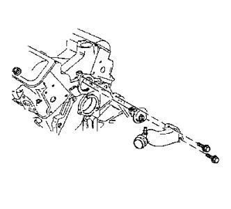

Yes, the thermostat can be replaced without removing the intake manifold. 1. Partially drain the cooling system. 2. Remove the air cleaner and duct. 3. Follow the upper radiator hose to the engine to locate the thermostat housing cover. The thermostat is located at the end of the lower intake manifold on the driver's side of the engine compartment. You may also want to disconnect the coolant hoses connections between the throttle body and thermostat bypass pipe to make it easier to fit a socket wrench in there. 4. Loosen the hose clamp, then detach the hose and the coolant reservoir tank line form the thermostat housing cover. 5. Remove the thermostat housing cover and the thermostat. (Note: Remember which end is supposed to face out when you do this.)
https://images.2carpros.com/forum/automotive_pictures/377707_32107_mali_g0051_1.jpg
6. Install thermostat with the new seal. 7. Reconnect hoses and refill cooling system. When choosing the coolant for your car, GM recommends the orange-colored "DEX-COOL" silicate-free coolant and replacing it every 100,000 miles or 5 years. You can also use the green-colored ethylene glycol anti-freeze, replacing it every 30,000 miles or 24 months. Before deciding which coolant to use, keep in mind DEX-COOL has been known to eat away at gaskets.
