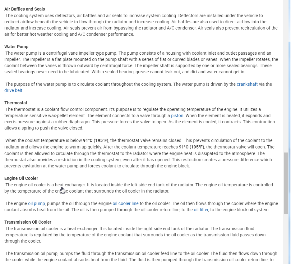

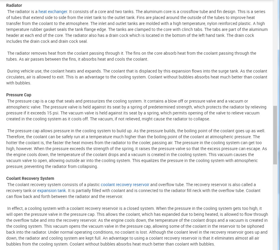

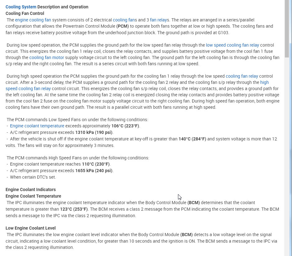

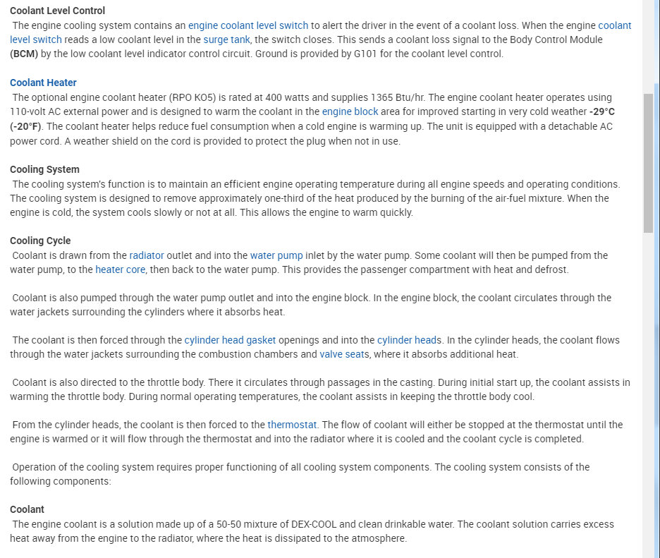

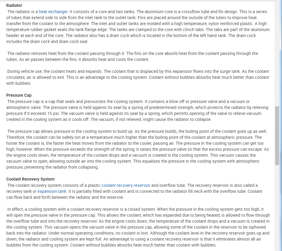

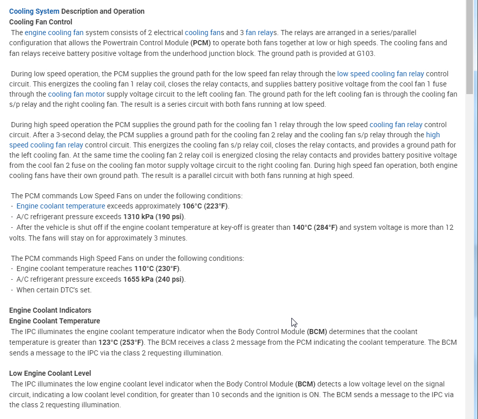

I attached the system info so you can get familiar with how it works but we need to start with filling the system and monitoring if the cooling fans behind the radiator are coming on. If they are then we need to check the upper hose to see if it is hot. If when the temp is in the middle of the gauge that the upper hose is not hot to the tough then your thermostat is not opening and needs to be replaced. It could be a failed water pump but a thermostat is much more likely. I would remove it and put in boiling water and see if it opens before the water gets to 215 degrees. If it doesn't open then that is the issue.

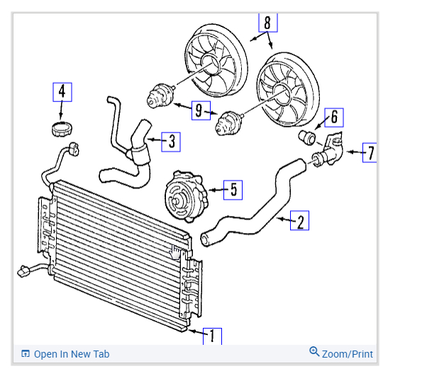

Are the cooling fans working? this guide will help us

Cooling fans are working on time-radiator not clogged-could be airlock in it-try bleeding the cooling system -don't work get it block and pressure tested
This guide can help us

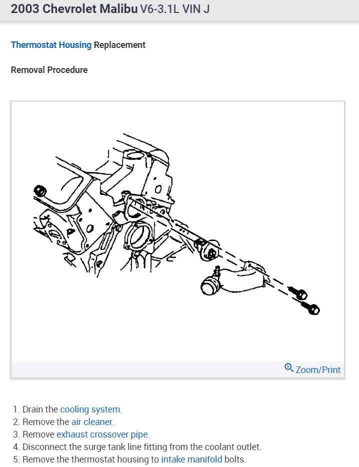

can the themostat be replaced without removing the intake manifold and what type of coolant do I use?
