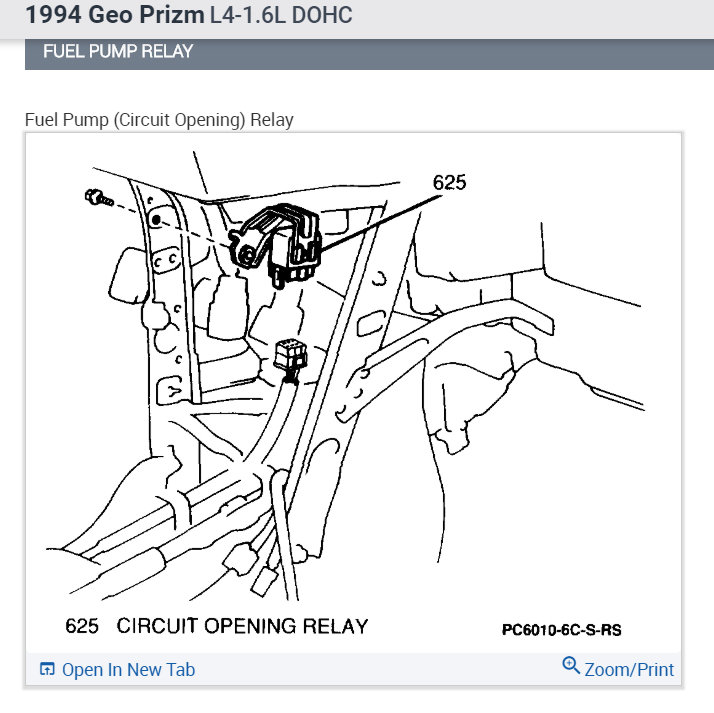

Fuel pump will not come on. It turns when I crank but I cannot hear the pump come on.
Oct 15, 2018 at 11:02 AM
  • 55,433 POSTS
It sounds like the relay is bad or the pump needs to be replaced. Here is a guide to help us find out which and diagrams below of the relay location:

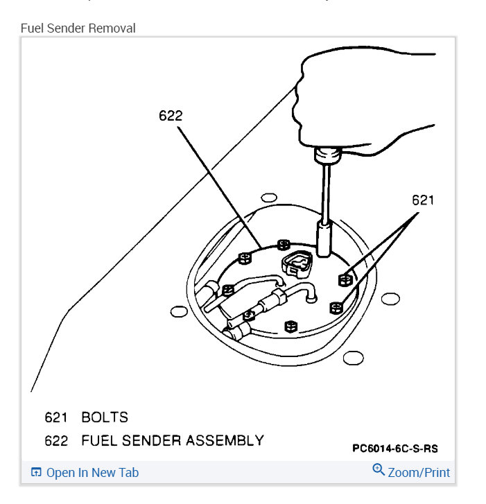

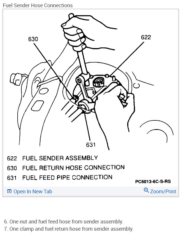

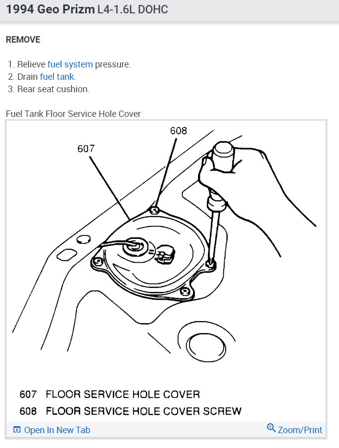

If the relay is good the pump has failed, here is a guide to walk you through the steps:
https://www.2carpros.com/articles/how-to-replace-an-electric-fuel-pump
Your car has a trap door so you are lucky. :)
INSTALL
1. New fuel sender gasket.
2. Fuel sender assembly to fuel tank; secure with eight bolts. Tighten bolts to 4 Nm (35 in.lbs.)
3. Fuel return hose to sender assembly; secure with one clamp.
4. Fuel feed hose to sender assembly; secure with one nut. Tighten nut to 30 Nm (22 ft.lbs.)
5. Fuel sender assembly electrical connector.
6. Floor service hole cover; secure with four screws.
7. Rear seat cushion.
8. Refill fuel tank.
9. Negative battery cable.
NOTE: Turn ignition switch on and momentarily connect a jumper between DLC terminals "+B" and "FP" to pressurize the fuel system. Check for any fuel leaks.
