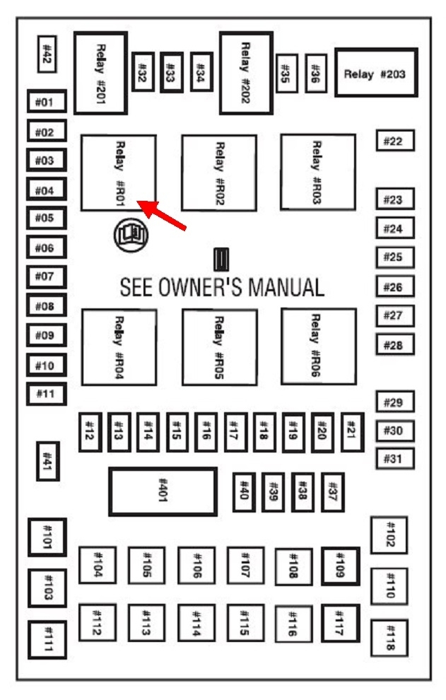

What connector can I disconnect to just crank the engine and not start?
220,000 MILES • 5.4L • V8 • 2WD • AUTOMATIC
DANNYBOY5474
  • 35 POSTS
Just installed a new oil pump and I want to circulate engine oil (prime the system) before running. Truck/engine been sitting for a year.
Mar 31, 2024 at 4:51 AM
CARADIODOC
  • 34,414 POSTS
You're over-thinking this. On the assembly line, they put the oil in the engine, then start it and run it before sending it down the line to be installed. The oil will get sucked up and pushed into the bearings within a few seconds. Your engine already has a film of oil in the bearings and passages, so they won't be running dry.

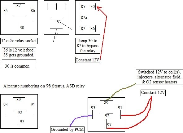

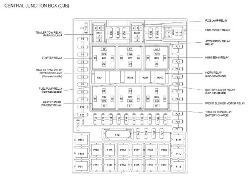

To prevent the engine from starting, you could unplug all of the injectors or remove a fuse for the injectors. A much easier way is to just bypass the starter relay with the ignition switch off. On vehicles I'm not familiar with, I pop the cover off the starter relay, then squeeze the contact. When I am familiar with the style of relay, I may use a stretched-out paper clip or a piece of wire to jump the two terminals in the relay's socket. Either way will make the starter crank the engine without it starting.
This first drawing shows the location of the starter relay in the fuse box under the hood. Pull that one out, then compare the terminals to those in the top left corner of the last drawing. Terminals 30 and 87 are the two to connect to make the starter run. They form the letter "T", so they're easy to find in the socket.

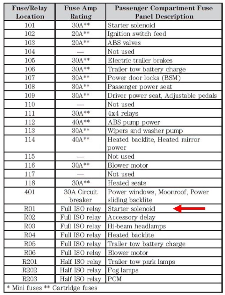

As usual, Ford does everything very differently from all other manufacturers. After an hour of searching, I'm starting to understand why this is so frustrating. It appears they combined the two fuse boxes, and used the names of both of them for the one box. For 2007 models they put it behind the right front kick panel next to the front passenger's feet. That keeps it away from salt and water spray. I hope it's the same for your 2006 model. I apologize for sending you in the wrong direction.
I understand exactly what you're trying to do, but this is still pointless. No professional would go through what you're trying to do. When you change oil, the new filter is full of air. That air can be compressed, so the oil pump has to move a large volume of oil before any gets to the bearings. With your new oil pump, it's going to be considerably easier for the pump to catch a prime.

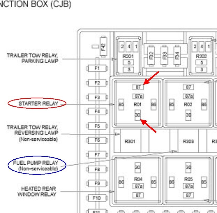

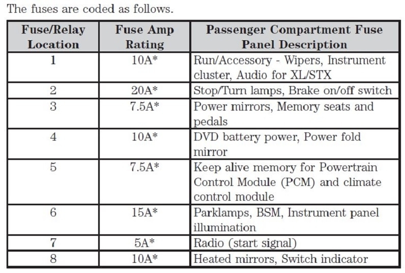

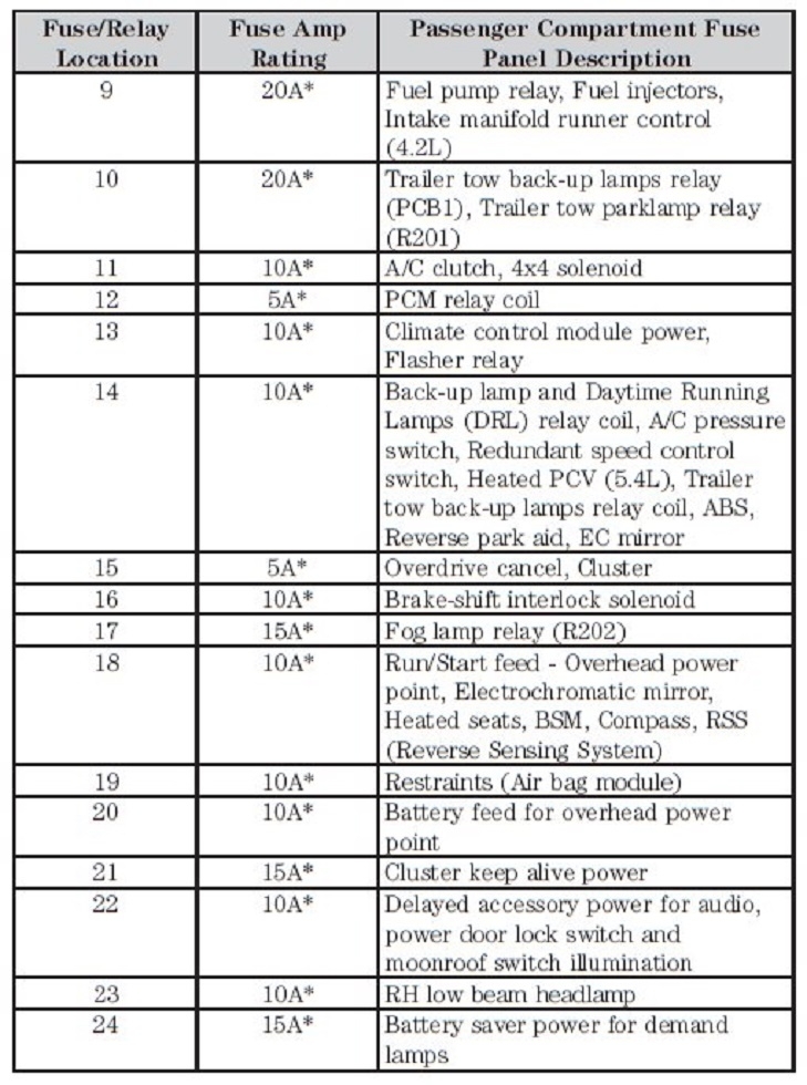

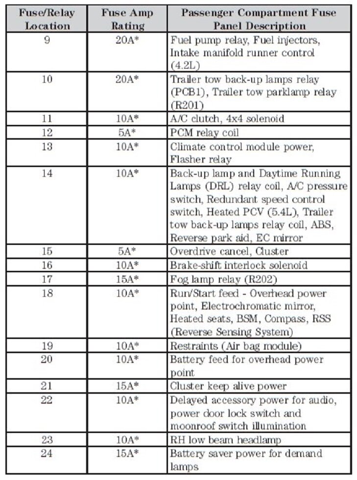

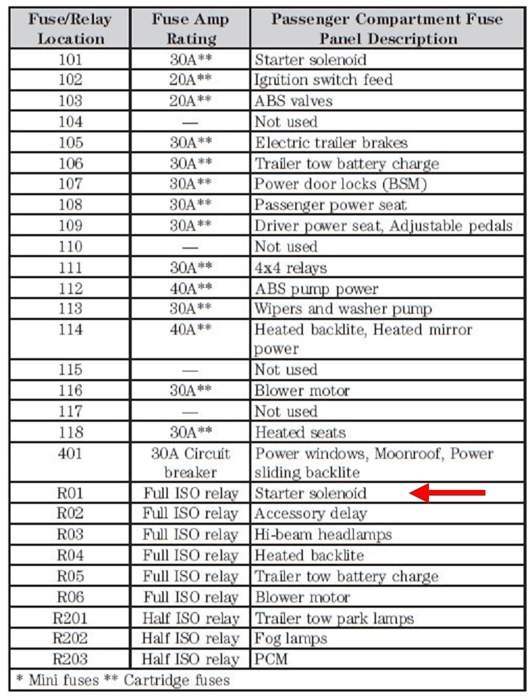

By far the easiest way to do this is what I mentioned previously. Just turn on the starter relay manually, without using the ignition switch. The first drawing below shows the fuse / relay box layout. It's not particularly easy to read, so I expanded the part with the starter relay. This is the same 1" cube relay Chrysler and a lot of other manufacturers use, and here, Ford is using the same standardized numbering. I added two red arrows to show the two terminals to connect. A stretched-out paper clip works fine, or any piece of wire. Notice how terminal 87 lays flat, or left to right, and terminal 30 goes up and down. Those two lines form the letter "T". Any time you see this style relay, look for those two terminals when you want to jump, or bypass the relay.
Another way to do this, since you have the relay out now, is to pop the cover off, reinstall it that way, then squeeze the movable contact. Sometimes the cover can be hard to remove. Sometimes they pop off very easily. Most of the time, when I push them back in without the cover, I accidentally press the contact, then get surprised when not expecting the circuit to activate. If you do that, you can usually pop the cover back on while the relay is still plugged in.
You can't possibly find an easier or faster way to crank the engine without it starting. Be aware though, the truck has been sitting for a year, and I don't know if there is a related history for that, but under normal conditions, the fuel pump will only run for one or two seconds when the ignition switch is turned on. It won't resume running until the engine is rotating, (cranking or running). There is going to be no fuel pressure now, (unless you've been turning the ignition switch on recently), and when you do try to start the engine, the starter will naturally draw the battery's voltage down quite a bit. That means the fuel pump will run much slower than normal. It can take a little time to build fuel pressure high enough for the engine to run.

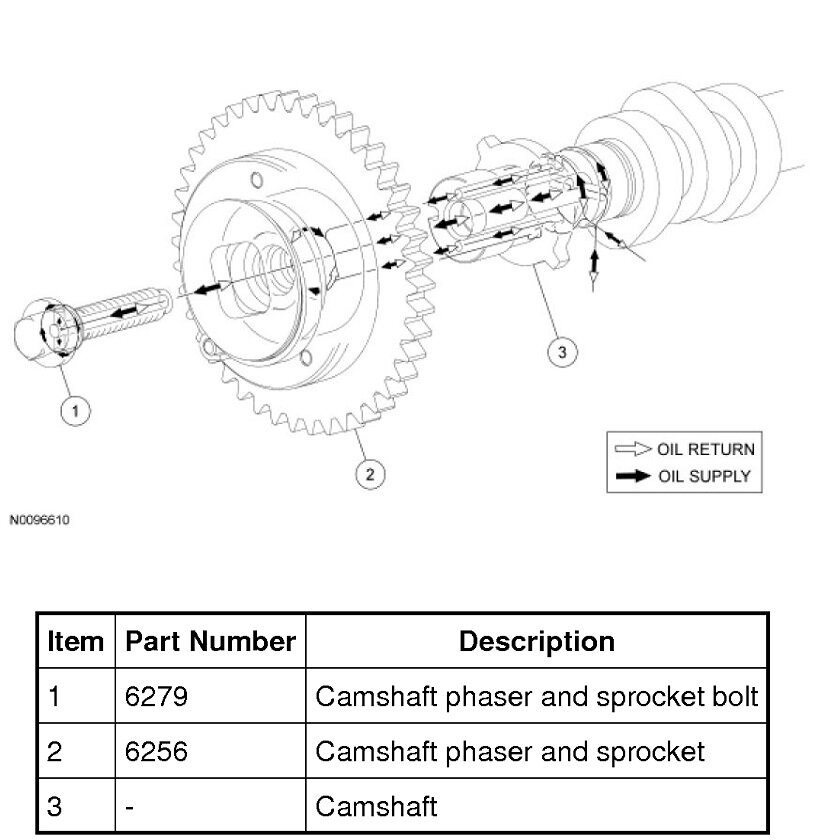

I'm just more concerned about initial fire-up with the top end (valve train). I did this repair with the engine in the truck and the valve covers were off for quite a few months. Yes, Oil pump is driven off the front crank so the whole front cover was removed. The hood was closed but still the valve covers were opened up for quite a few months.
Apr 1, 2024 at 9:57 AM
CARADIODOC
  • 34,414 POSTS

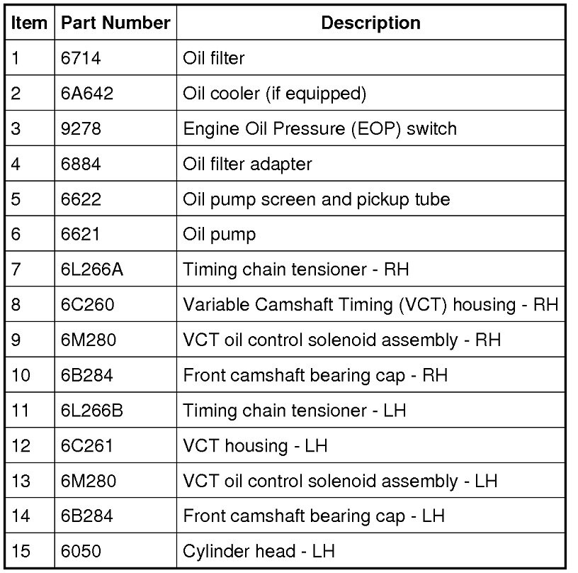

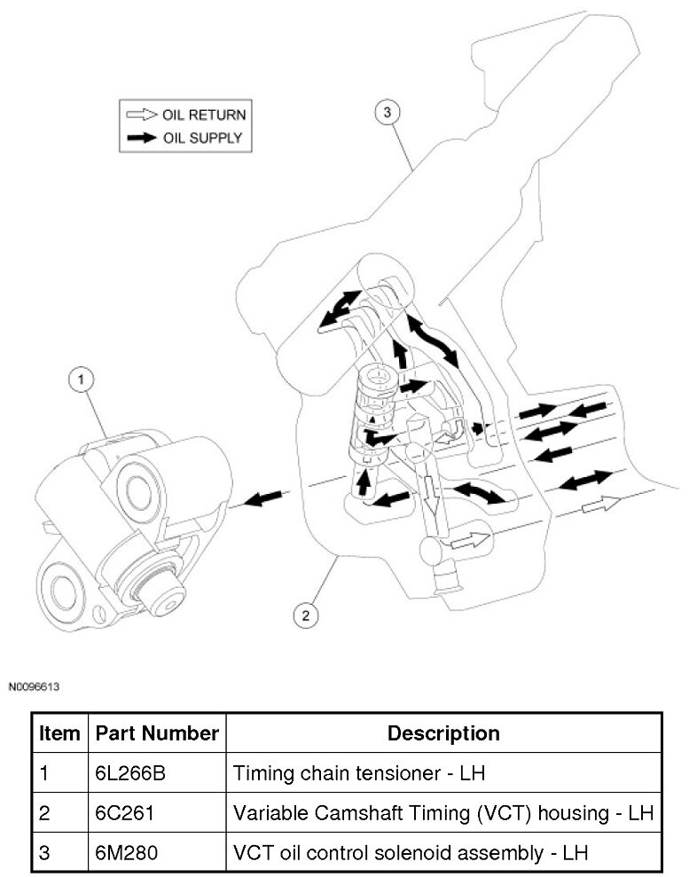

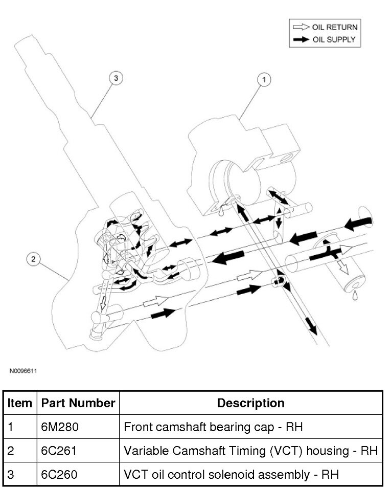

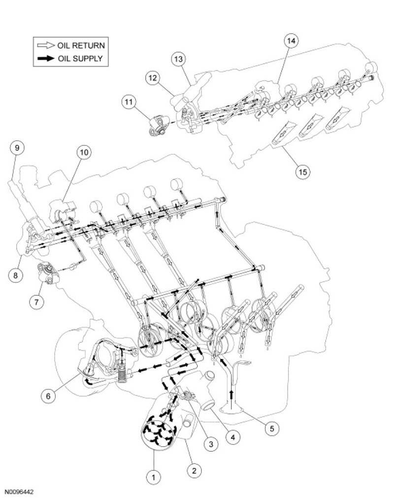

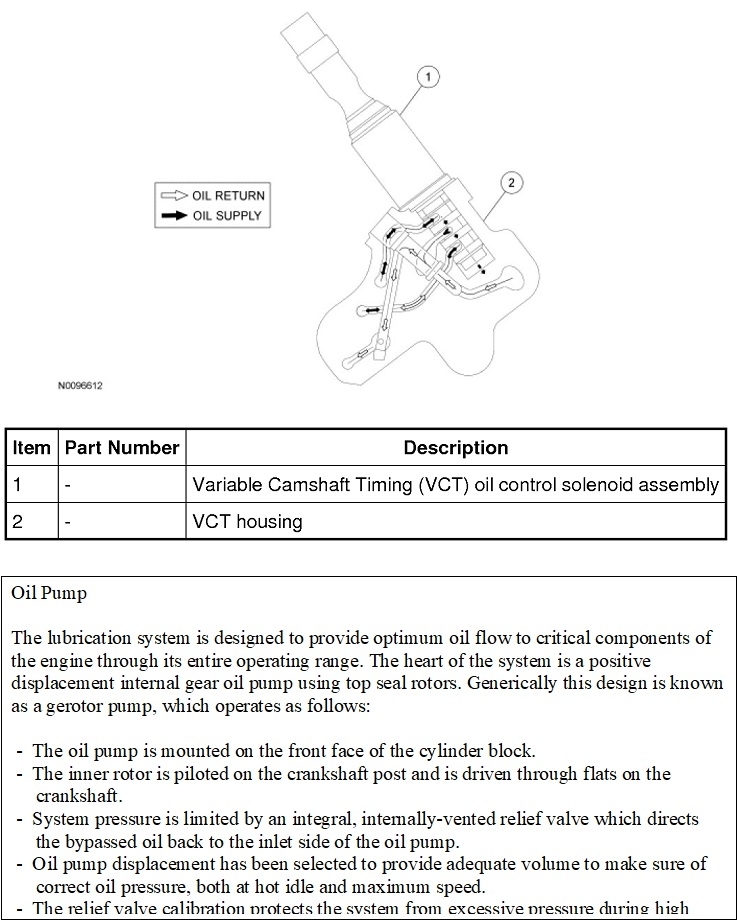

I don't know if it will help, but here's the flow charts for the oiling system.
As a point of interest, there's a drilled passage through one of the main bearing journals at the rear of the crankshaft. Pressurized oil has to go through that bearing, then through the drilled passage, to go up to the valve train. Chrysler did the same thing with bearing number two feeding one cylinder head and bearing number four feeding the other side. This means oil only flows to the valve train when the crankshaft is in that one certain position. That limits oil volume and prevents overloading the valve guide seals. I turned the crank slowly on my 318 while the drill was running. That's why I had a real lot of oil coming up to one rocker arm shaft when I hit that sweet spot.
The point is, even though you crank the engine, very little oil is going to go up that passage. I suspect it could take half a minute or more of cranking before you see oil on top of the head, less time if none drained down while the engine was sitting.
