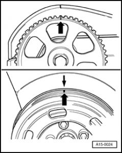

The timing marks on the crank and cam line up where they are suppose to, are there timing marks for the timing chain that drives the other cam?
Thursday, November 29th, 2018 AT 12:36 PM (Merged)
CHREKO
  • 12 POSTS
I have passat and I would like to know if there are timing marks from one cam to the other, the timing marks are good for the crank to the cam, would like some help thanks
  • 75,992 POSTS
Try this
https://www.2carpros.com/forum/automotive_pictures/12900_v1_6.jpg
https://www.2carpros.com/forum/automotive_pictures/12900_v2_1.png
