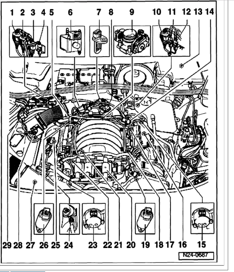

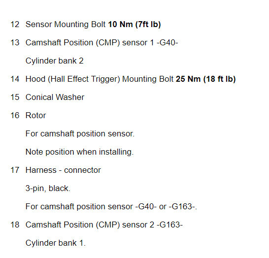

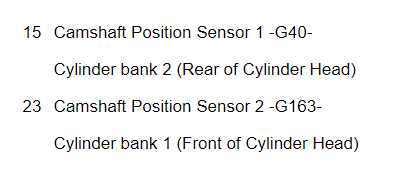

This sounds like you have a crankshaft angle sensor that needs to be replaced. Here is a guide to show you what you are in for when changing the sensor.
This cars had a problem with them
Here is the location for your sensor for your car (below)
Cheers,
Cheers,

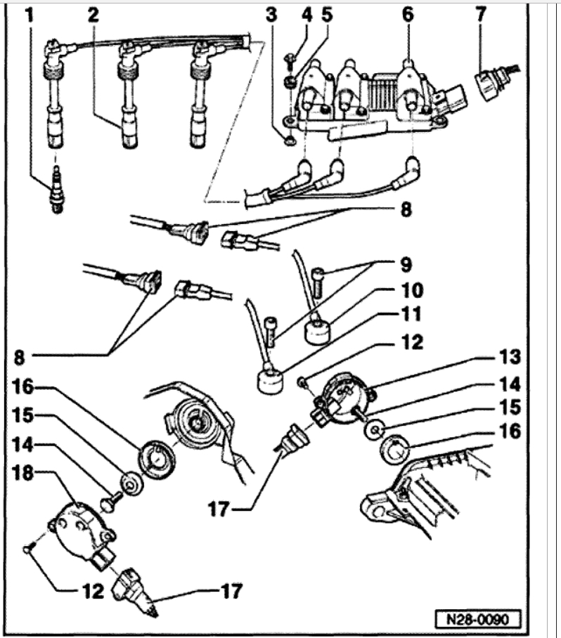

2000 Volkswagen Passat 4 cyl Automatic 115500 miles
Recently I discovered that when I tried to start my car it well, wouldn't. I recently put in a new battery and it was working fine, for several weeks and then nothing. The radio and the head lights are working, but the interior lights do not. I checked the fuse and it looked undamaged.
I believe it is the Ignition Coils. I had to replace the cylinder head gasket and as a result of it failing oil filled up the chambers that housed the spark plugs. So at that time I replaced all my spark plugs, but couldnt afford the ignition coils at the time. I also had the check engine light on and the shop mechanic said it was due to a miss fire of some sort. I'm 98% sure he said it was because 3 of the 4 ignition coils were not working properly, which would make sence because of the oil damage, and essentially it was just a matter of time before the final one failed.
So my question is, do you agree it is the ignition coils or do you think it could be something else, and how would I be able to check?

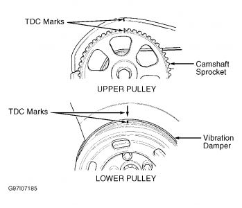

sorry bout that, no crank just a cam sensor. are timing marks lined up as shown below
Nov 29, 2018 at 12:36 PM
(Merged)
yes the marks are right on
(Merged)
if timing is good and sensor is good then only things left that will cause poor compression is internal mechanical issues such as worn piston rings, valve seals etc... would have to tear down the motor and inspect all the components to find the issue.
