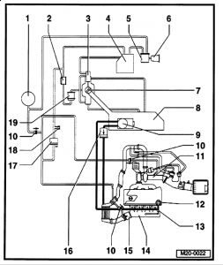

Oh man.I had to laugh also about being so dumb! Of course, the telephone only dials 7 numbers. Duh! I called but they were busy. I am going to recall this morning. I haven't blown the lines out yet. Tomorrow I am spending the day on the 'dub. You have given some good ideas. Hopefully they will end this nightmare for me! Question, I know where the return line terminates into the pump. Where is the other end? Thanks

SERVICE WRITER
  • 9,123 POSTS
Look at the fuel rail
9 is the pump
16 is the pressure line
13 is the rail
https://www.2carpros.com/forum/automotive_pictures/30961_fu_1.jpg

Great schematic. That helps alot. I just talked to Delphi and they are kicking in the wind like we are. I am going to check the lines tomorrow as you suggested. It has a black and blue fuel line on top of the pump, what color is output and what color is input? Dephi wanted me to check that it was installed correctly and not touching the bottom. I lined the pump up to the hole facing the trunk which is where I think I remember it was. I have the blue line hooked up to the return side. Right?
