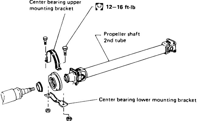

The idea that it grinds with the clutch out, tells me the input shaft is turning as it should. However, if nothing is happening when you release it in gear indicates something (like you said) has broken after that point. Don't laugh, but did you confirm the driveshafts are attached? Will it move if you place it in 4wd?

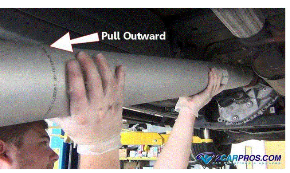

Do me a favor, crawl under the vehicle, and check the driveshaft. Since it isn't making any noise, check at the transfer case.
I attached a pic of a driveshaft so you know what to look for.
If everything is attached, the transmission and transfer case need to be removed and inspected. If I had to guess, I suspect there is an issue after the transmission, likely the transfer case.

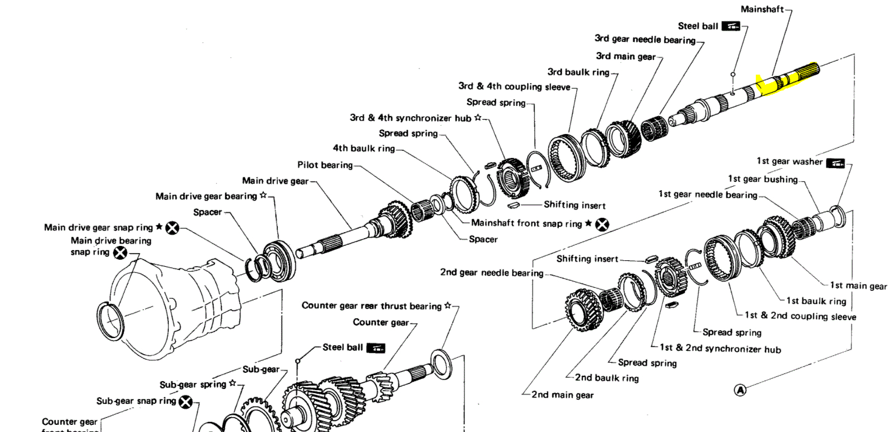

If you can shift through all the gears with the engine running and without grinding, the transmission needs removed. I suspect the input shaft is broken and there is no longer a connection between the engine and transmission.

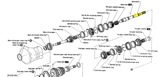

I attached a pic below showing an exploded view of the trans. I highlighted the main shaft. If the transmission feels like it is shifting normally and it's not moving, something has come apart somewhere on that shaft. Without it connected, the vehicle won't move unless the clutch is no longer functional. However, that would prevent you from shifting when it's running.
Do me a favor if possible. Put the vehicle in 2wd and safely lift the rear wheels from the ground. See if the wheels turn at all when in gear.
Dec 19, 2020 at 7:05 AM

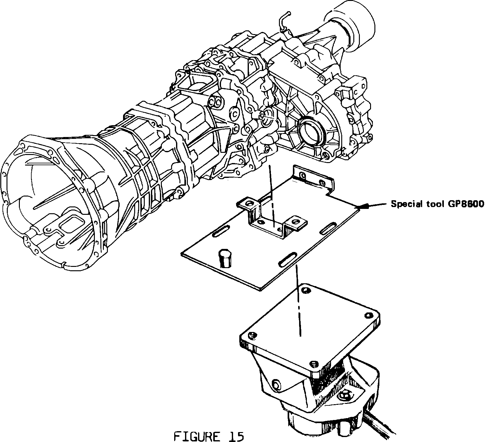

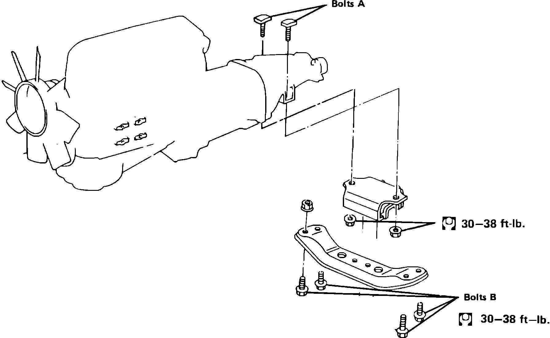

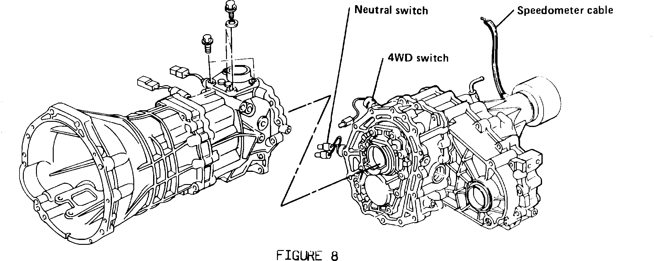

Here are the directions for removal. This is what I would do, but that is your call. The attached pics correlate with the directions.

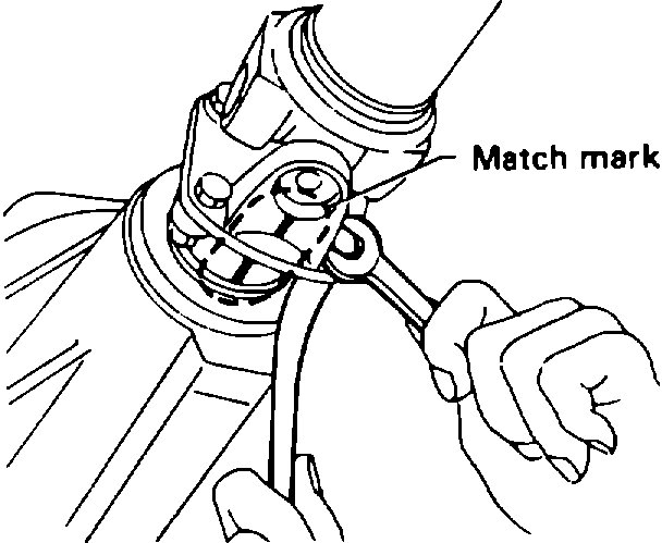

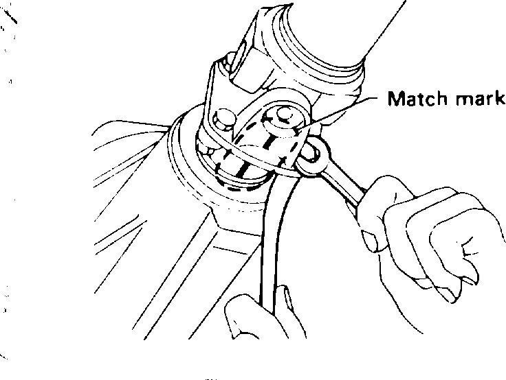

4. Place match marks on the rear propeller shaft/rear axle flanges (Figure 1).
5. Mark both front propeller shaft flanges (at front axle and transfer case) (Figure 1).
6. Remove the four (17 mm) nuts and bolts between the rear propeller shaft and rear axle (breaker bar or impact wrench required) (Figure 1).

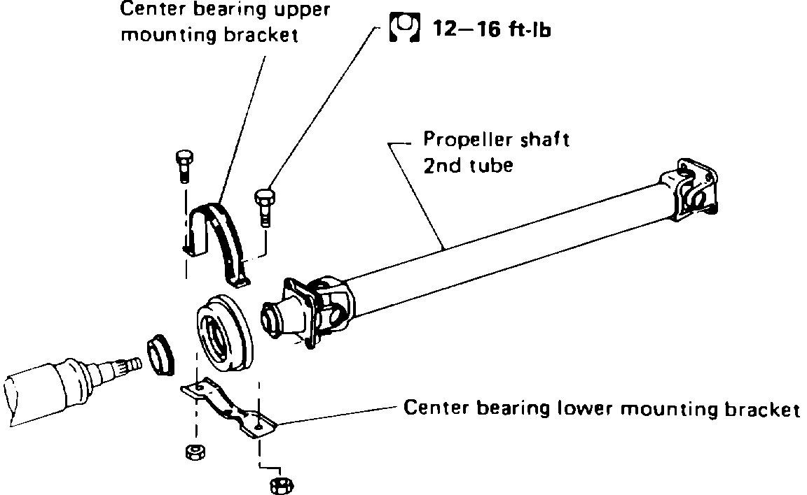

7. THIS STEP IS FOR LONG WHEELBASE VEHICLES ONLY. Remove the two propeller shaft center bearing bracket bolts (17 mm) (Figure 2).

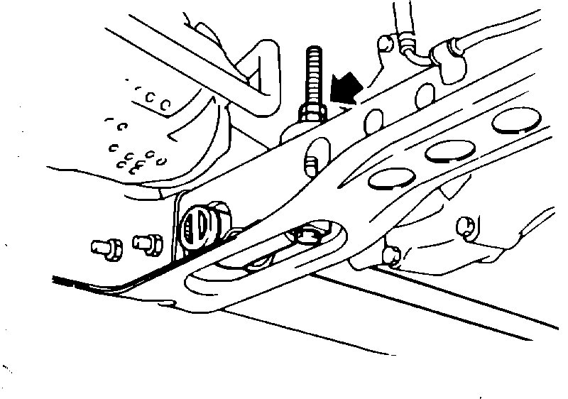

9. Loosen (do not remove) both torsion bar adjusting bolts (19 mm) (Figure 3).

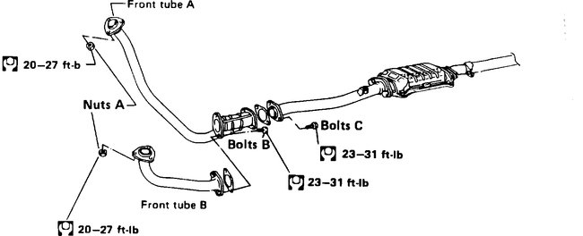

13. Remove the exhaust system as follows:
a. Disconnect front tubes A and B from each exhaust manifold (3 [17 mm] nuts on each side) (Nuts A in Figure 6).
a. Disconnect front tube B from tube A (2 [17 mm] bolts) (Bolts B in Figure 6).
a. Remove the two bolts (17 mm) between front tube A and front tube C (Bolts C in Figure 6).
a. Remove front tubes A and B from the vehicle (Figure 6).

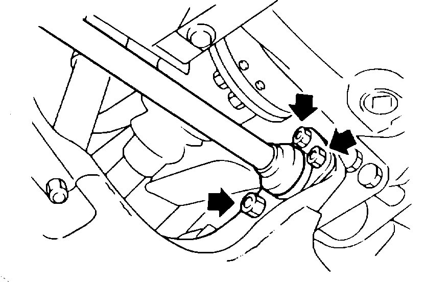

15. Remove the four bolts (14 mm) from both front propeller shaft flanges (Figure 7).
16. Remove the front propeller shaft from the vehicle.

17. Remove the speedometer cable and vent tube from the transfer case. Disconnect the neutral switch and 4WD switch harness connectors from the main harness (Figure 8).

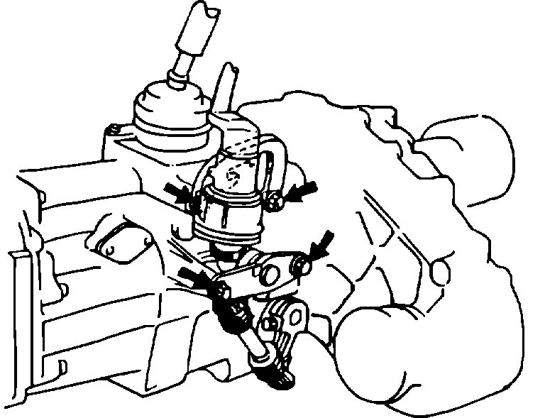

18. Remove the transfer control lever from the transfer outer shift lever (Figure 9).
FIGURE 10

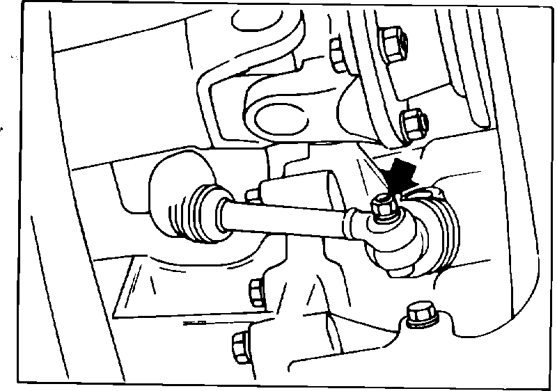

19. Disconnect the transfer case linkage assembly (two 12 mm bolts on each bracket) from the transmission (Figure 10).

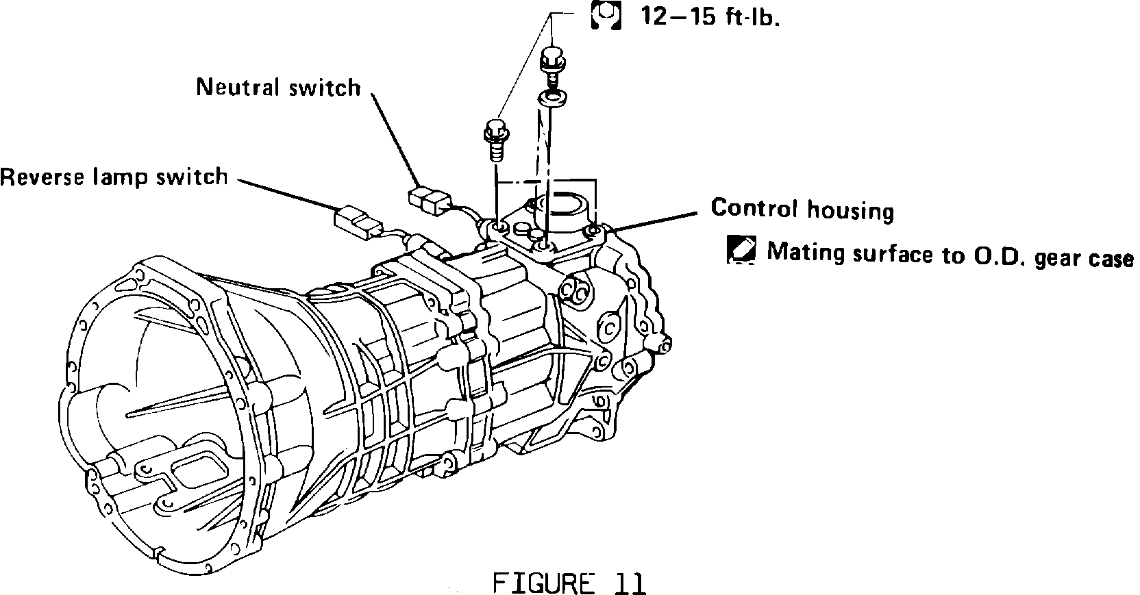

20. Using an open end wrench, remove the two (13 mm) and two (12 mm) bolts from the shifter control housing (Figure 11). Loosen the control housing from the transmission.
21. Disconnect the neutral switch and reverse lamp switch harness connectors from the transmission (Figure 11).

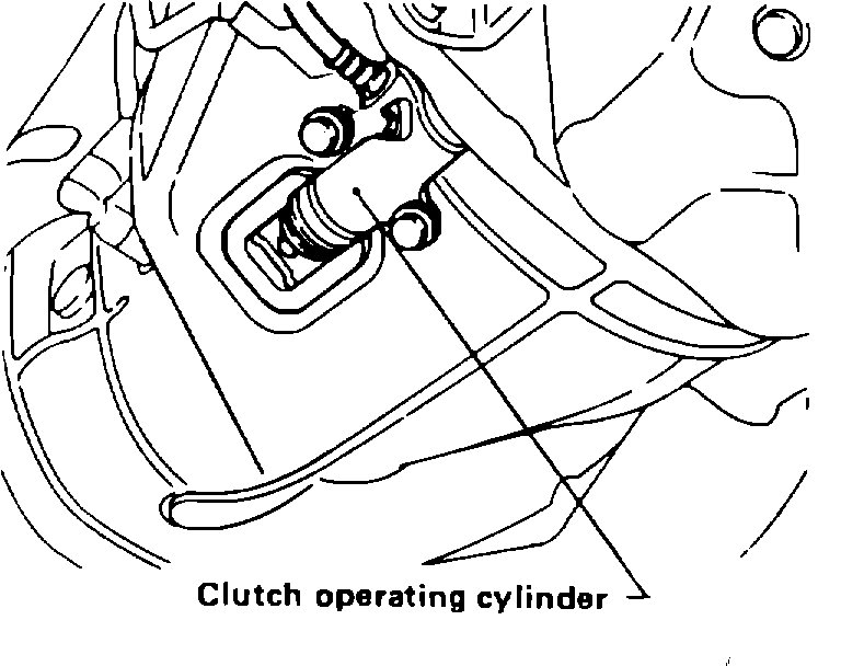

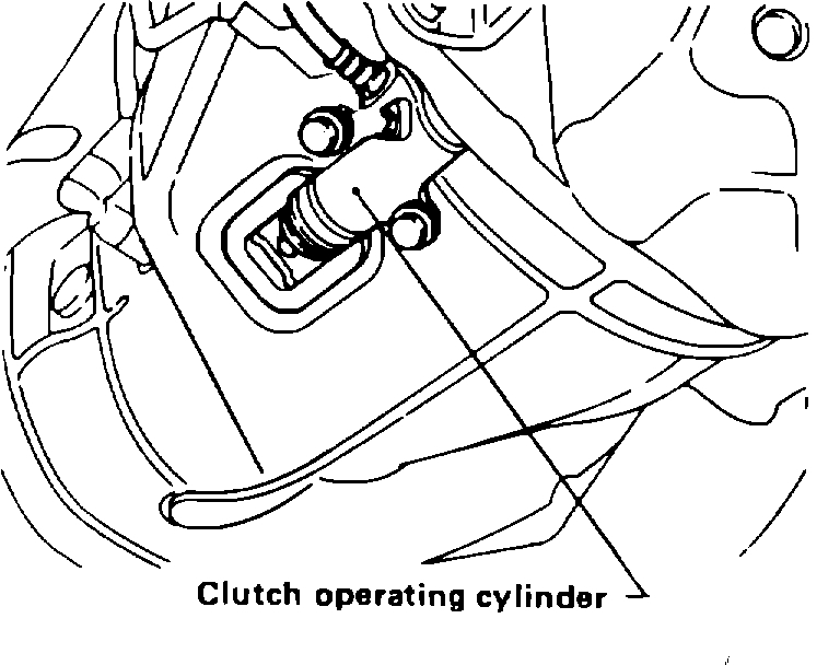

22. Remove the clutch operating cylinder (two 14 mm bolts) (Figure 12).

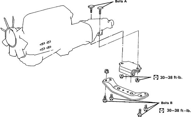

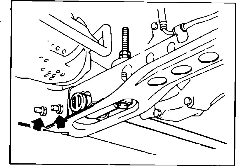

29. Remove the two bolts (17 mm) between transmission mount and transmission (Bolts A in Figure 13).
30. Remove the four bolts (17 mm) between the transmission cross member and vehicle frame (Bolts B in Figure 13).

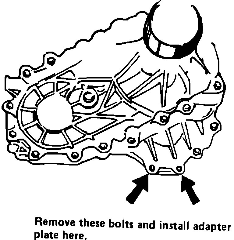

31. Remove the two lower bolts at the rear of the transfer case (Figure 14).
FIGURE 15
32. Mount the transmission/transfer case jack adaptor (Special Tool # GP8600) to a transmission jack using shop bolts.
33. Raise the transmission jack and mount the jack adaptor to the transmission/transfer case (two bolts at cross member mount and two bolts at rear of transfer case) (Figure 15).

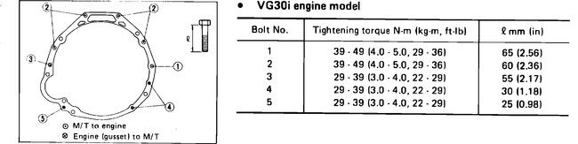

35. Remove the four front mounted bell housing bolts (14 mm) (Figure 16).
36. Support the engine with a jack stand under the oil pan. Use a block of wood as a spacer between jack and oil pan.
37. Remove the remaining five bell housing bolts.

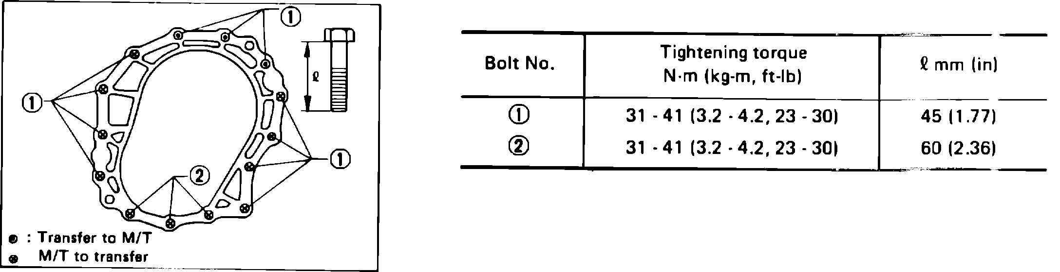

39. Remove the transfer case from the transmission (thirteen 14 mm bolts) (Figure 17).
