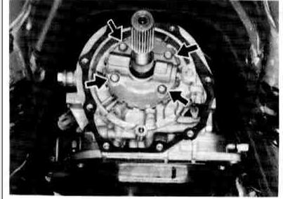

1989 Nissan D21 Pickup 6 cyl-3.0L Two Wheel Drive Automatic Transmission - L4N71B 89000 miles
The transmission is shifting throiugh all four gears but, at very high RPM's which causes the vehicle to jerk as the shift is completed. The fluid and the filter has been recently changed and no leaks appear.

i found that there is a bulletin for this only when cold, you replace the fluid with a special fluid, but this is only when cold. also the other thing i found is the governor(controls shift points and is located in the tailshaft housing.) i would suggest having a transmission repair shop road test for you. i was hoping i was going to find a vacuum controlled modulator valve, but you dont have one. hope this helps

https://images.2carpros.com/forum/automotive_pictures/139033_gov_1.jpg

I,m going to try replacing the modulator because i found tranny fluid in the tube.

I Checked the modulator that was located on the drivers side of the transmission, A little bugger to get to. Modulator Okay. I then followed the vacuum line to the intake and realized that the vacuum line was deteriorated and needed to be replaced. What can you expect for such an old girl. Runs sweet. Next time when you guys receive a donation, try researching the problem a little closer.
