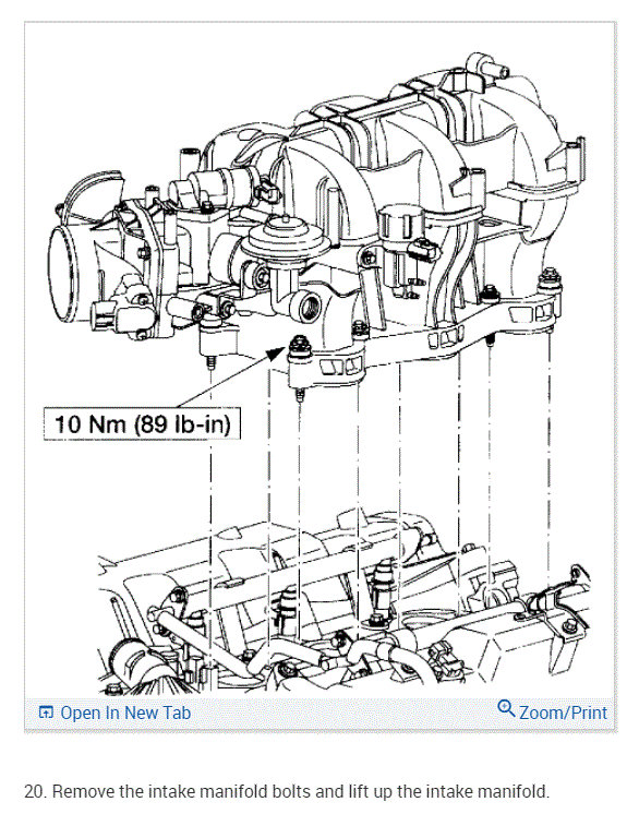

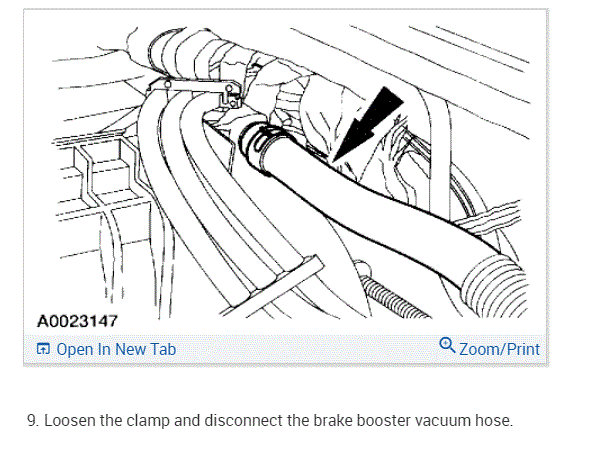

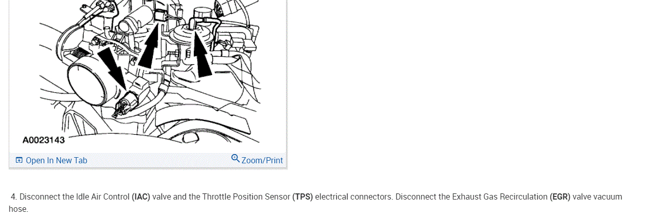

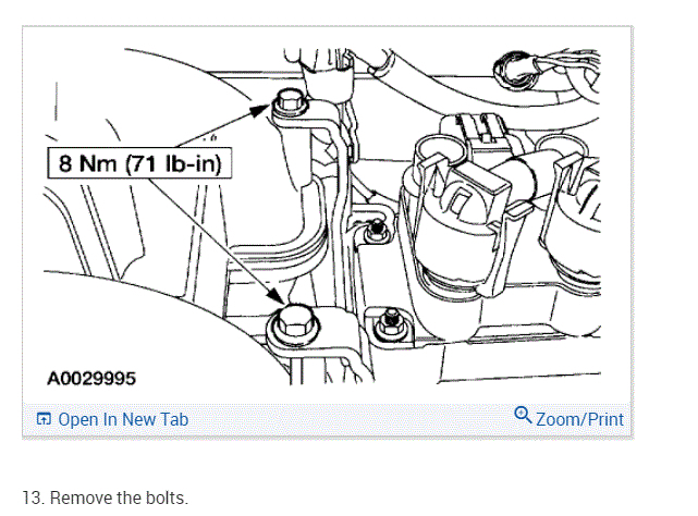

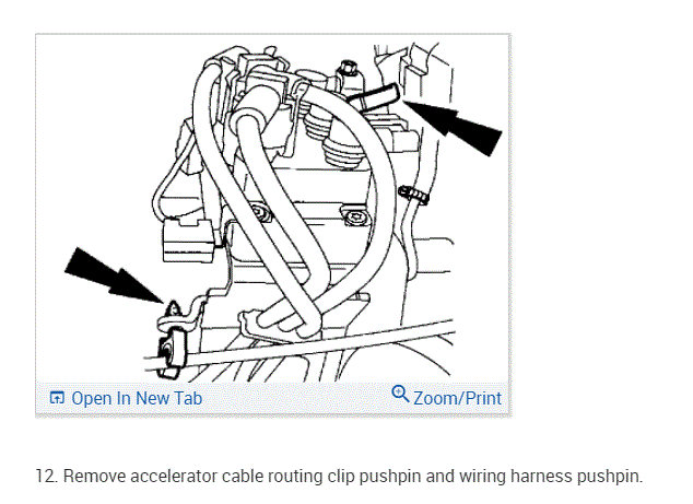

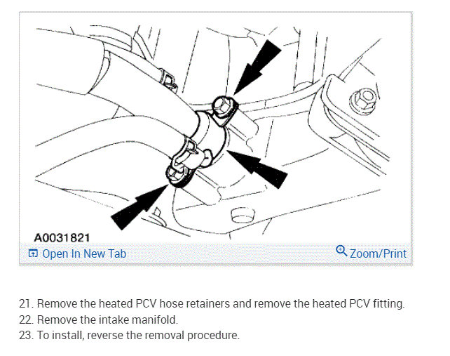

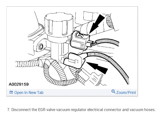

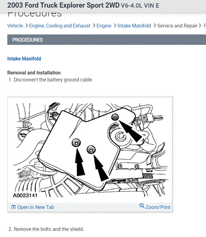

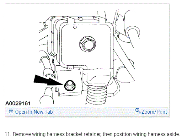

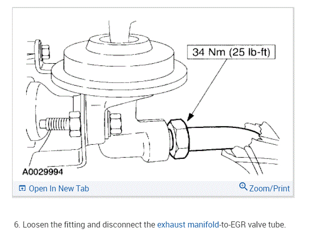

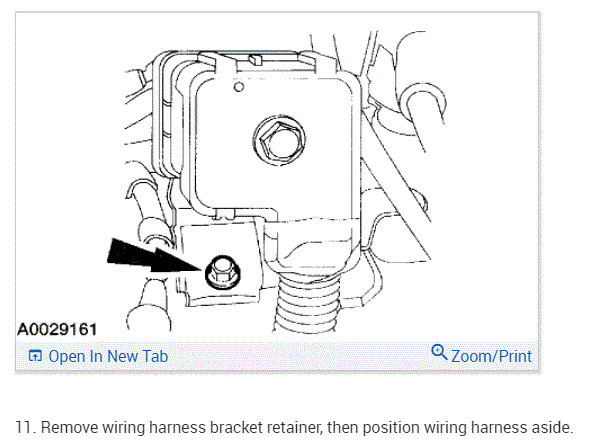

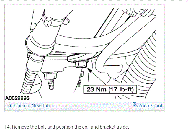

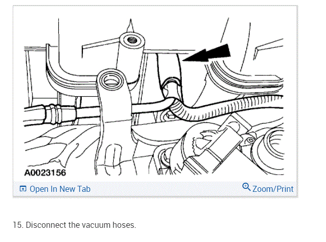

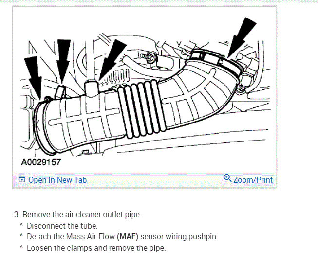

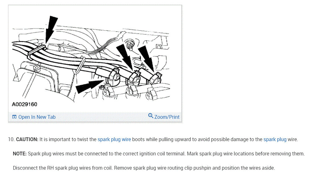

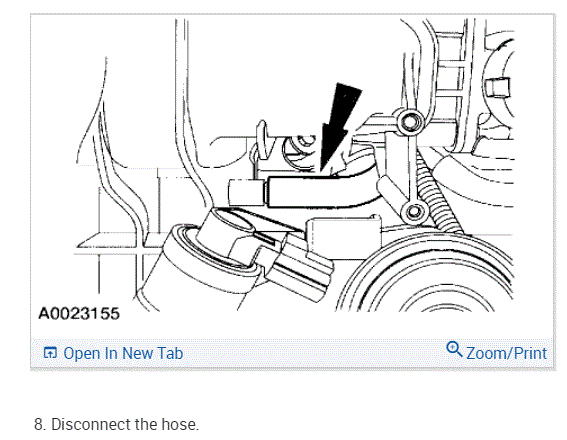

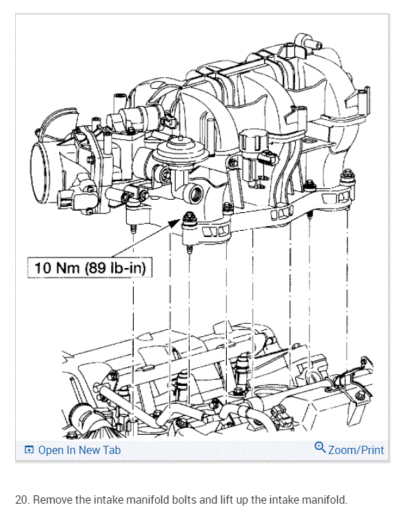

Based on how short it is, it must be something really close to where it is located. Do me a favor. I attached the directions below for the removal of the intake manifold. It explains all the vacuum hoses involved. See if you see anything that you may have missed.

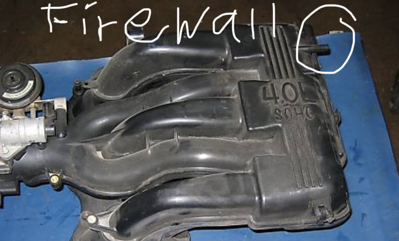

Yeah, that’s why I’m confused because it is so short so the only place for it to go is the firewall because it is connected to the back of the one that goes into the intake, but there is nothing for it to go to on the firewall. I don’t see it in any of those pictures either and I have everything plugged in from what I can see in those photos.

It attaches to the back of the one that goes where the white circle is.
Monday, February 7th, 2022 AT 5:43 AM
  • 109,885 POSTS
That is the main supply port. I just listed a question regarding this. I am hoping someone has a solution. Hang in there. If it is running well and there are no issues, it will be fine.
