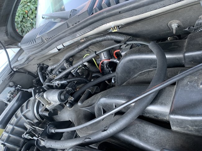

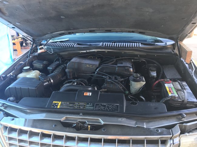

Where does this go? Everything else is already plugged in. Is it supposed to be capped?

Just looking at it, it's hard to tell. Do me a favor. First, start the engine and place your finger over the end of the connector to determine if there is vacuum present.
Next, at idle, have you noticed any vibrations or a rough idle?

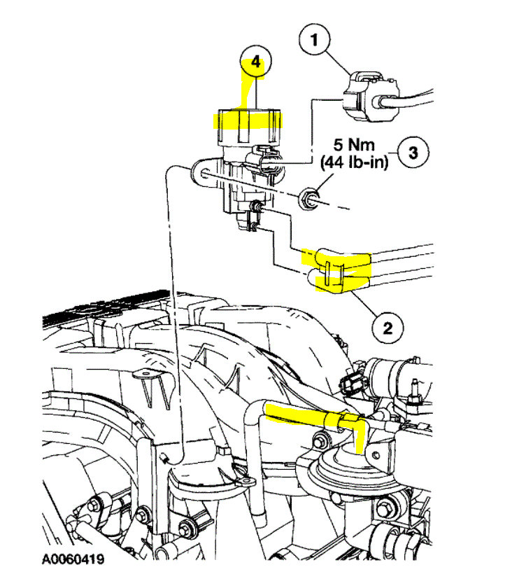

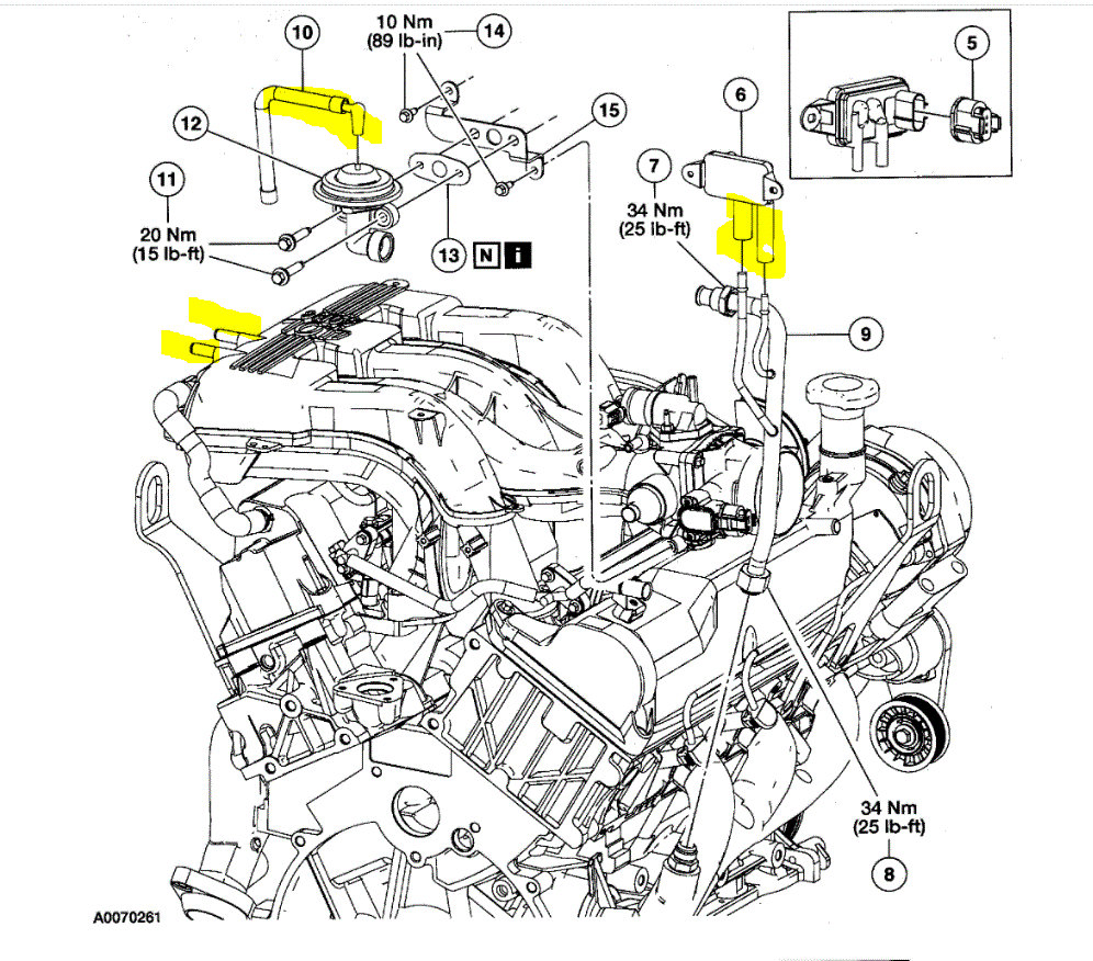

I attached a pic below showing the vacuum hoses I suspect it could be related to. I highlighted them. If possible, take a pic further away from the engine so I can see more. Also, see if you can follow that hose to determine where the opposite end is.

The A/C hasn’t worked since I was like ten. I’m 27 now, lol. Someone said it was a leaking line or something. I know the blend door motor, or something is out because it just clicks when it’s turned on. And here’s the pic.

Yeah, it’s the same engine. And it’s connected to other ones that go to the HVAC the evap canister the EGR and something else that I can’t remember right now. They’re all connected into a big one that goes to the intake and the little one I Can’t figure out directly behind the big one in the intake. All the colored ones in the photo are the ones that connect to the one I’m talking about.

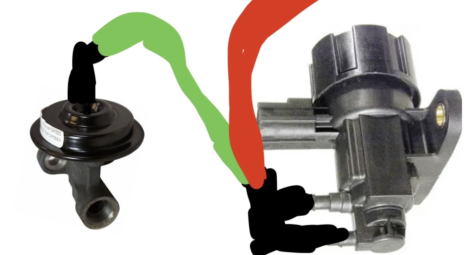

When I look in the manuals, the only colors indicated for engine vacuum are related to the HVAC system and you are not having trouble with that system. So, that leads me to think it is either the EGR valve or the vacuum regulator solenoid.
If you look at the attached pic, it shows the items I'm referring to. Let me know if either is disconnected.

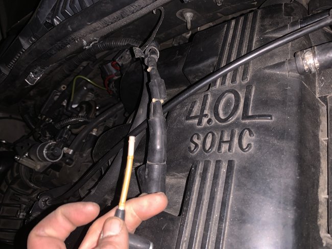

All of those are already connected and yes there is suction from the hose in question. I put a bolt in it, and it seems to have made the idle less rough, but I’m not sure how long I should keep it like that. And thank you, Joe. Likewise. I am not sure if the bolt effects anything because after the rebuild I only got to drive it for 3 days until my trans cooler lines went started leaking. I replaced both of those and the cooler itself but had to call for a jump because I didn’t disconnect my battery when I was working on the cooler, so it drained. The technician put the negative on the positive and positive on the negative which resulted in a huge spark and a damaged computer. So once again, my car is not working but for those 3 days the bolt in the vacuum hose seemed to work.

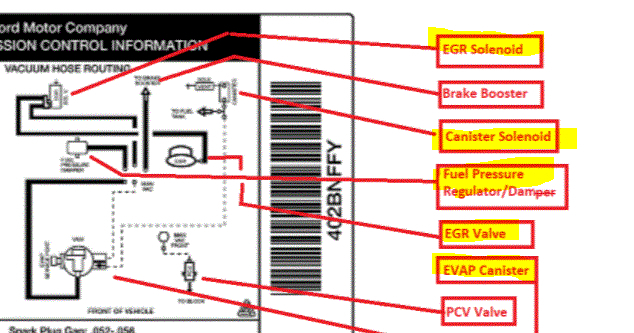

I certainly see it. The only thing indicated as a yellow hose is for the HVAC. Since you have no issues with the HVAC, there is a chance a different vacuum supply was attached in place of this one.
The idea you put a bolt in it is perfectly fine. You basically stopped a vacuum leak. We just need to identify where it goes.

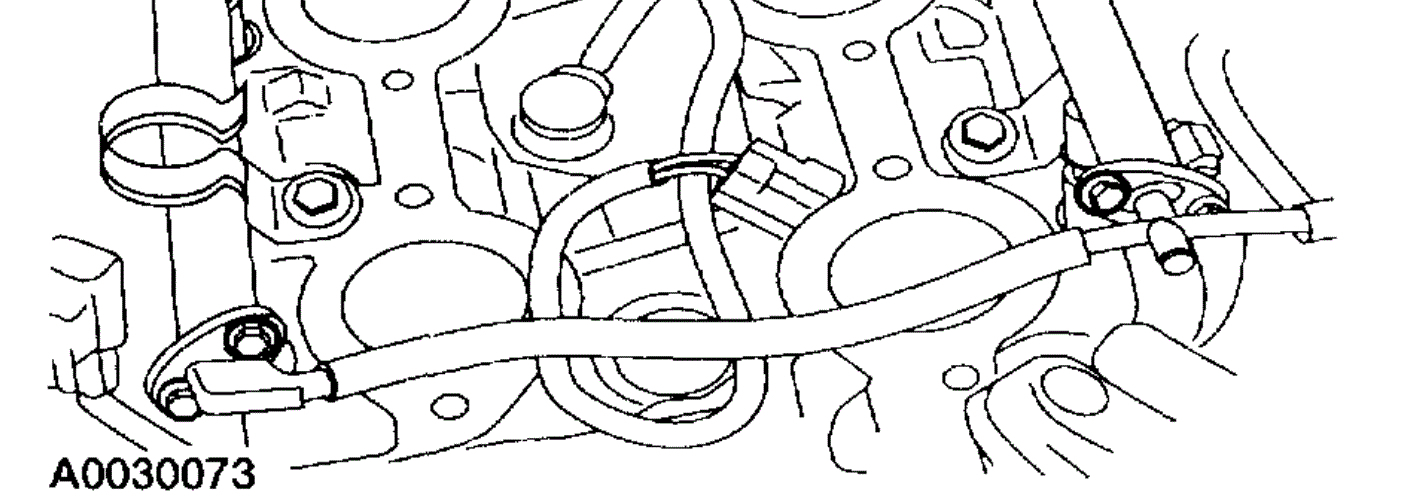

1) Fuel pulse dampener (Between fuel rails).
2) EGR valve.
3) EGR vacuum regulator (firewall).
The three things mentioned above are components that require an engine vacuum to operate. I tried to get the best pics I could find for you to identify the parts. Also, the last pic shows a schematic that identifies each hose in the pic. Check these things and let me know what you find.
Jan 30, 2022 at 10:02 AM

Wow. You got me stumped on this one. I have looked through everything. Now that you have the bolt preventing a vacuum leak, are there any noticeable issues? For example, is a rough idle, something that doesn't work, any fuel smells, or anything out of the ordinary?
The last pic I attached above and labeled is a vacuum schematic from Ford. LOL That doesn't mean something isn't missing, but it matches the ones from my manual.

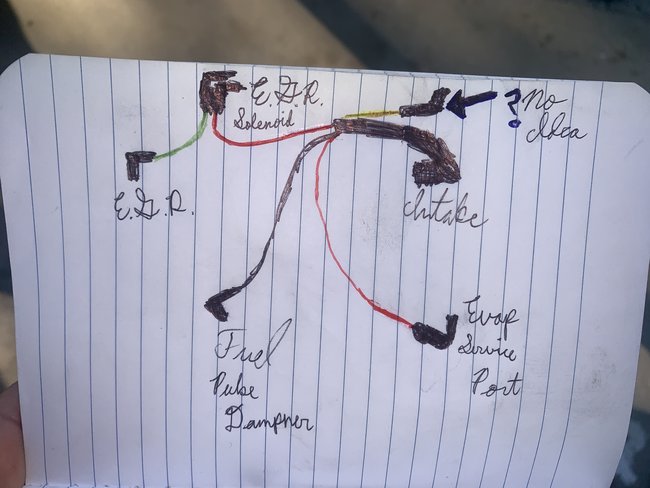

Thank you, I really appreciate it. And yes, there is vacuum and no there was a rough idle until I plugged it. Here is my attempt at drawing how everything is plugged in, lol. they all connect to the big one that goes into the intake.

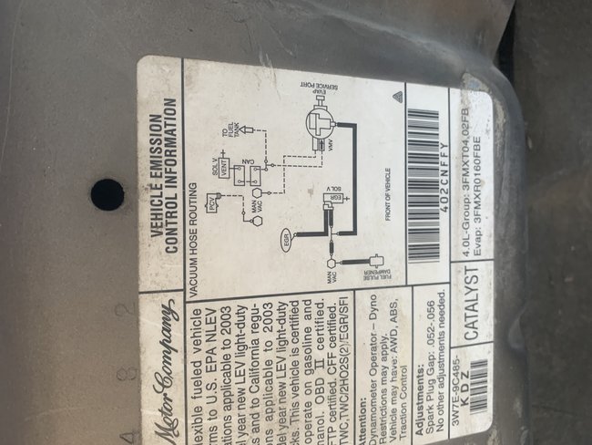

Also, here is the schematic from under my hood.

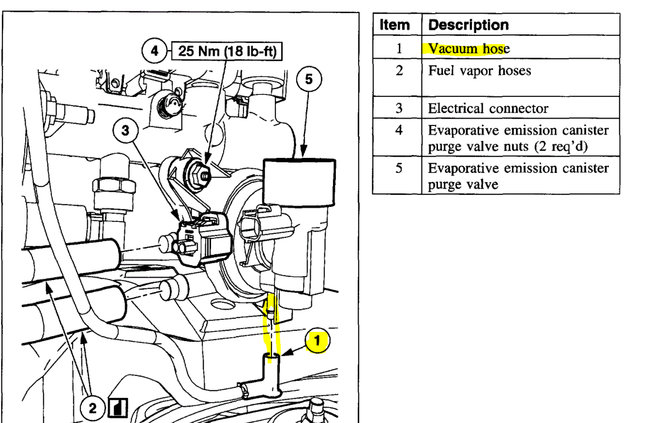

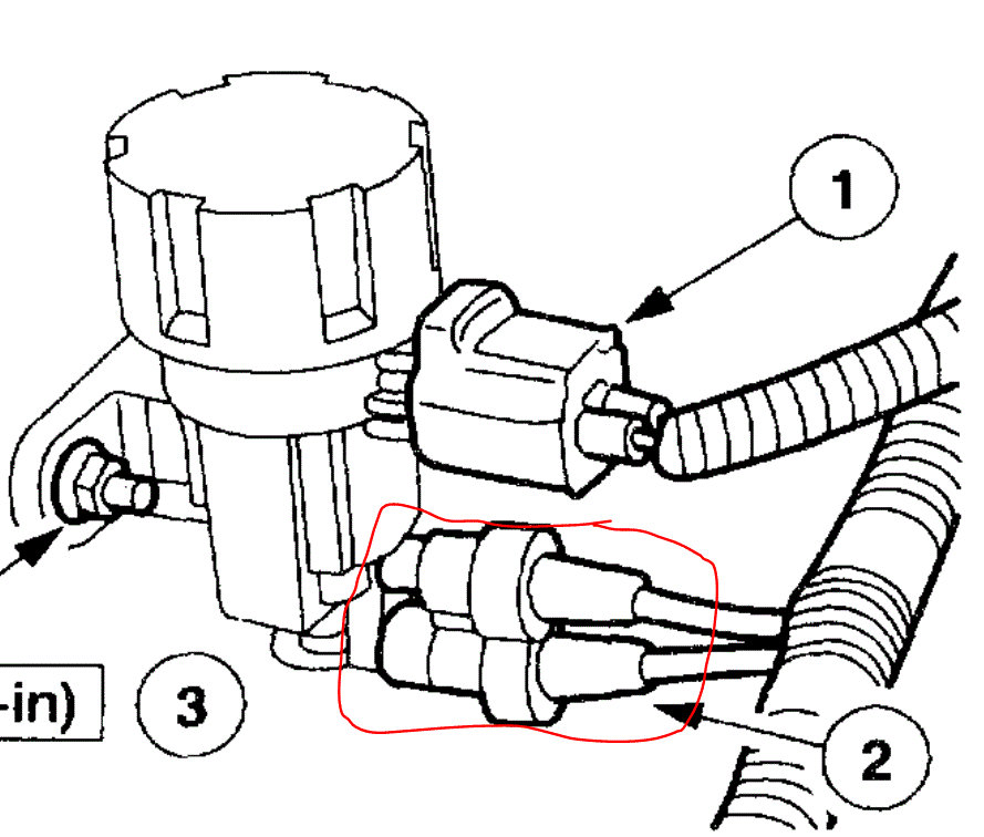

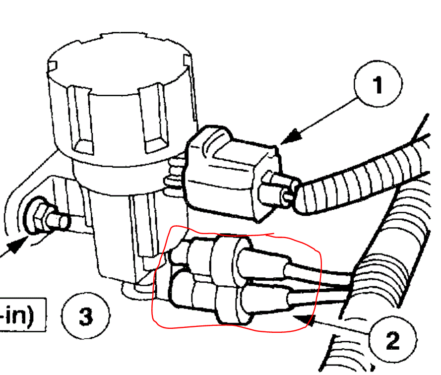

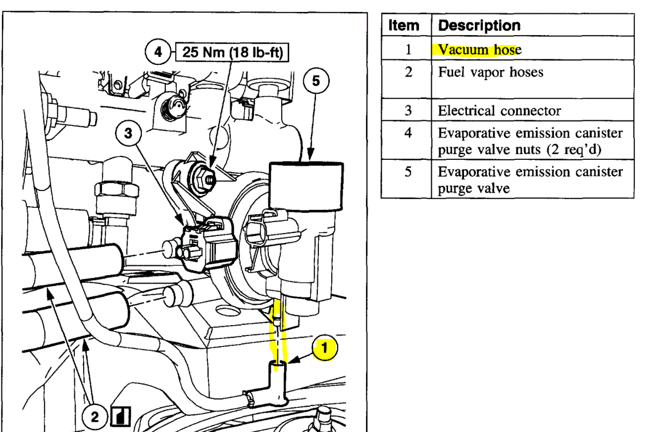

Your drawing is perfect. I went through things again. Looking at your pic, the only thing not connected is the canister purge valve. You have the regulator, EGR, and EVAP service port connected. The only thing left is the purge valve.
Look at the pic below and let me know.
Feb 5, 2022 at 5:52 AM
ARIANADANIELLE5345
  • 402 POSTS
That’s what the red one on the bottom right of my drawing is connected to.

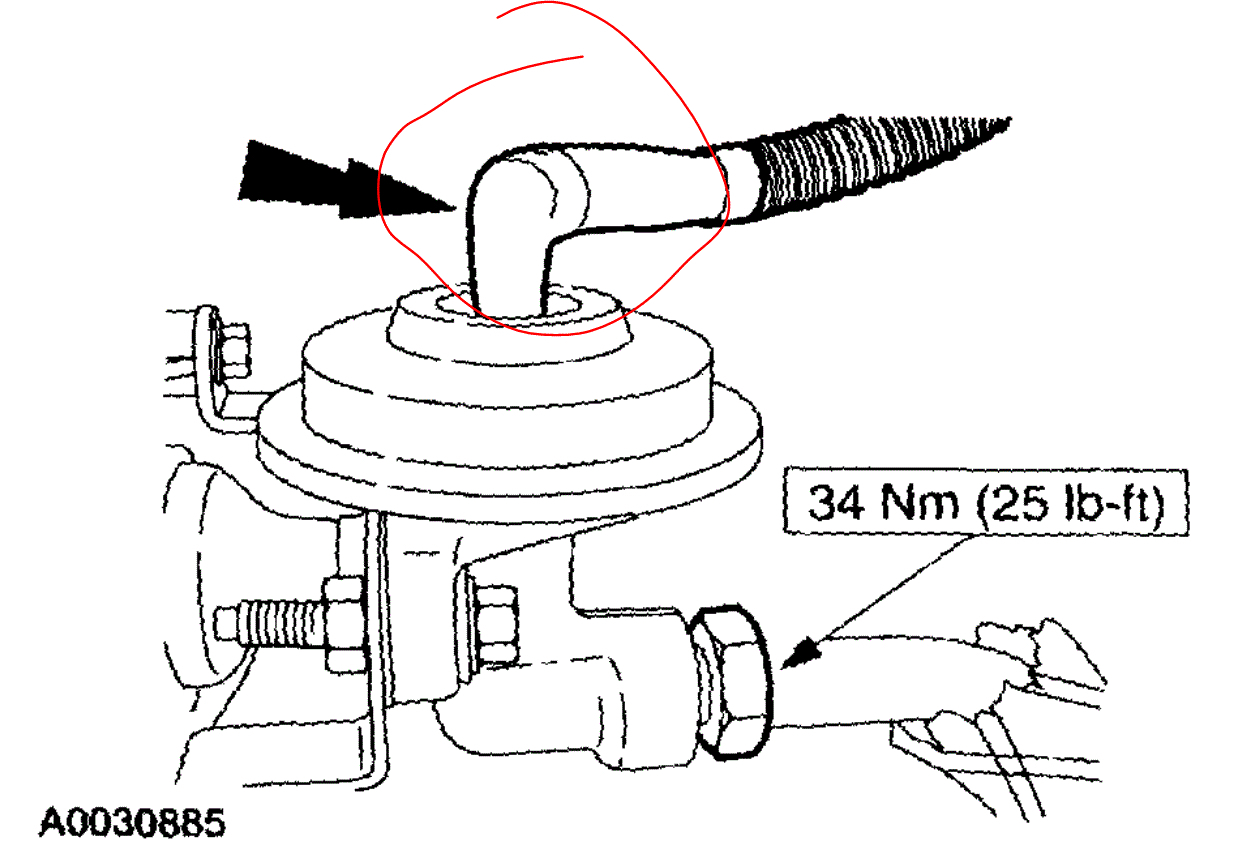

You have me stumped. The schematics all show three lines off the supply tree. I am going to ask a different tech for his opinion.

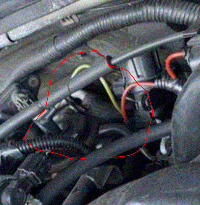

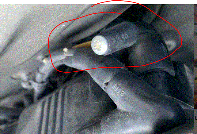

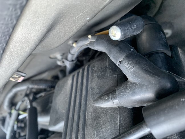

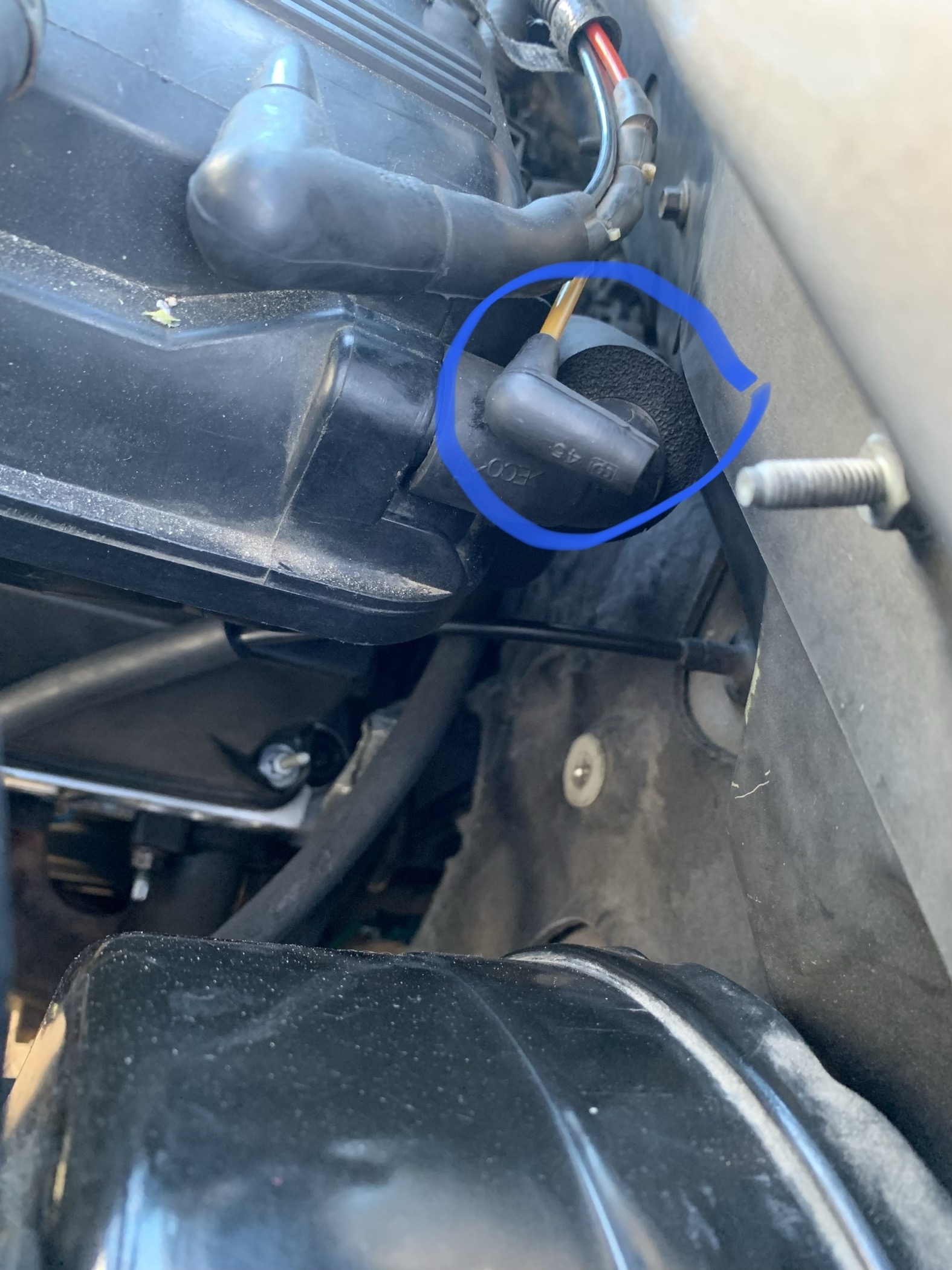

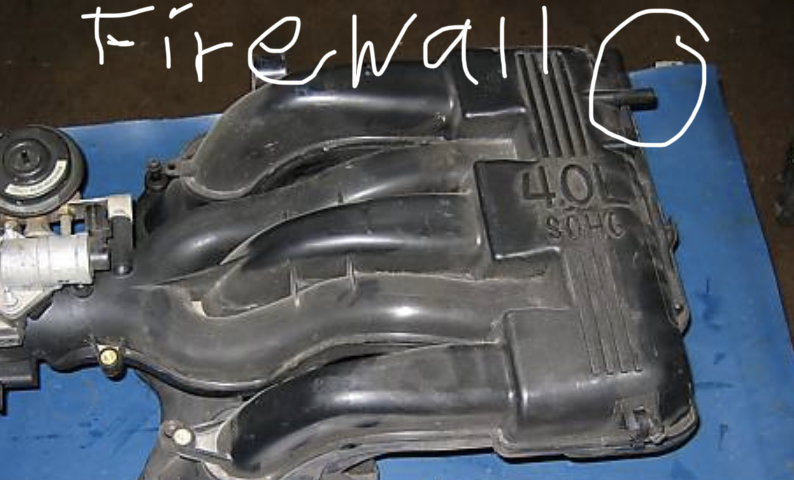

Ariana, I looked at the pics you attached above. I copied, circled, and reattached two below. What am I seeing in pic 1 that has a yellow vacuum hose going to it? EGR? Also, in pic 2, where is that physically located (shows the screw in the hose)?
Feb 5, 2022 at 9:31 AM
ARIANADANIELLE5345
  • 402 POSTS

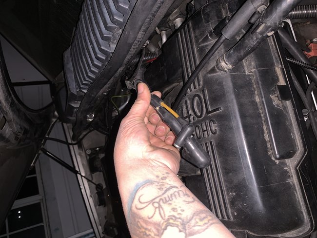

Second pic is when I pulled it off intake and third pic is when I pulled the orange one that I plugged with a screw out of the big one that goes into the intake. The big one is what all the colored ones end up connecting into.

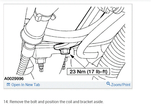

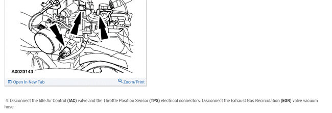

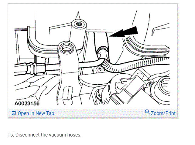

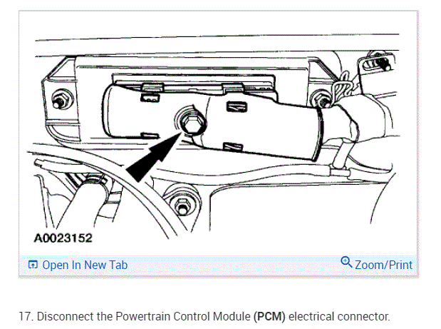

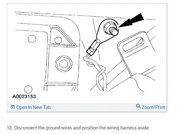

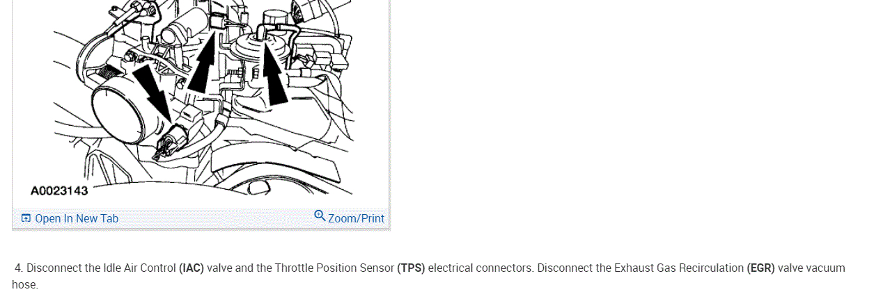

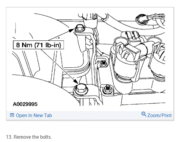

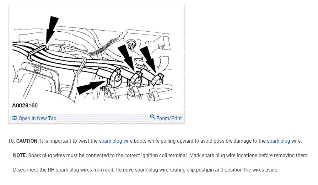

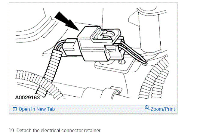

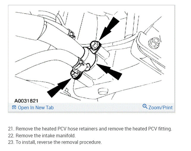

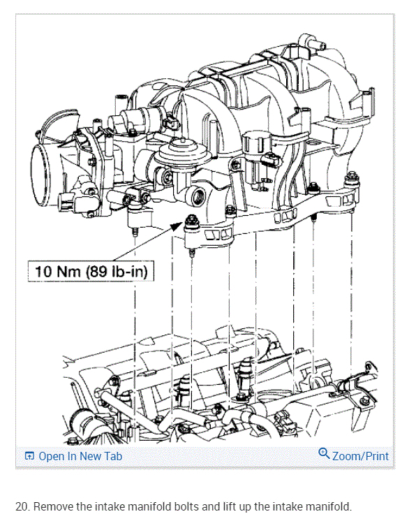

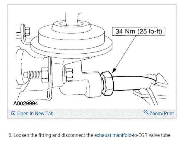

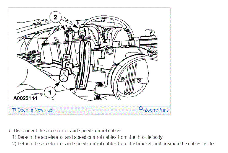

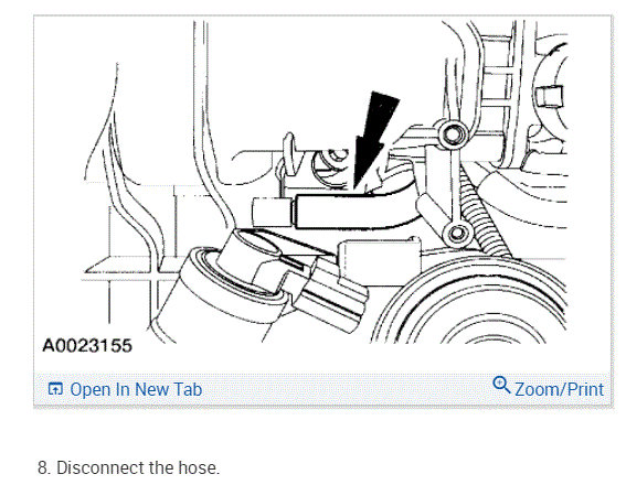

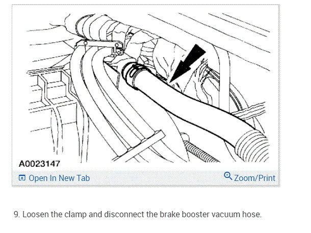

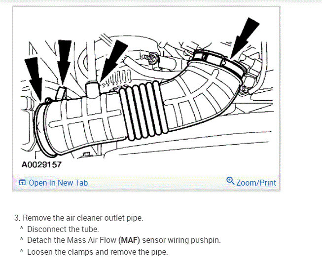

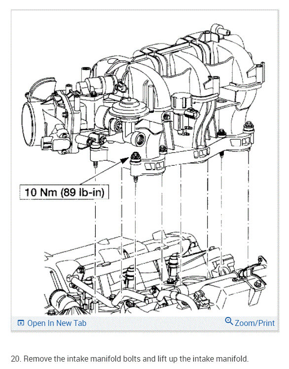

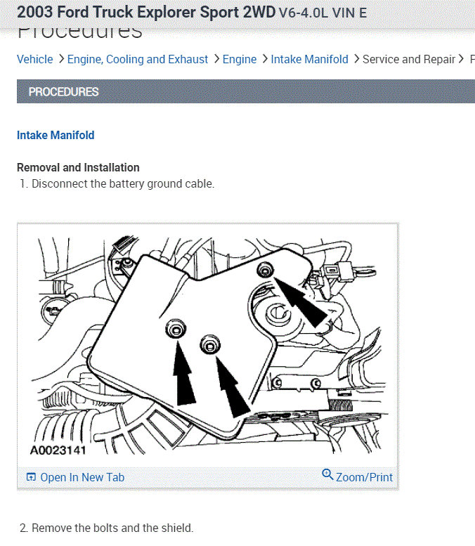

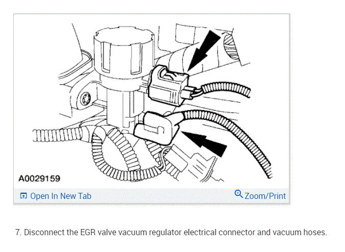

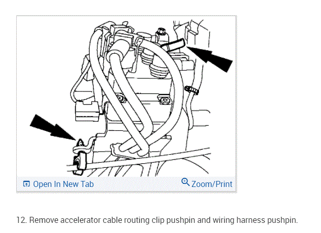

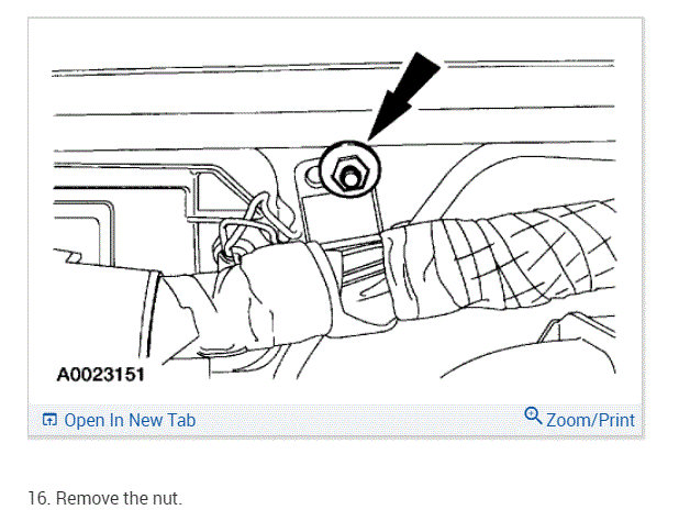

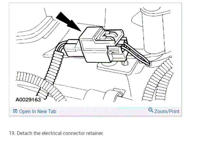

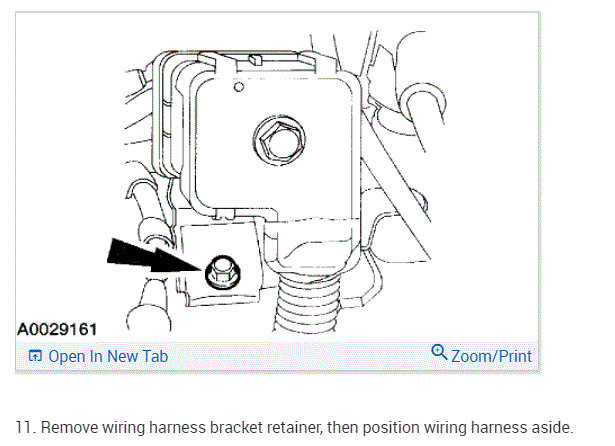

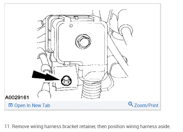

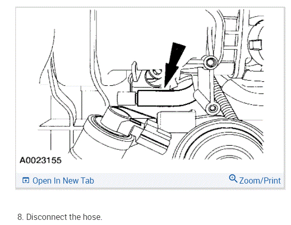

Based on how short it is, it must be something really close to where it is located. Do me a favor. I attached the directions below for the removal of the intake manifold. It explains all the vacuum hoses involved. See if you see anything that you may have missed.
Feb 6, 2022 at 10:31 AM
ARIANADANIELLE5345
  • 402 POSTS

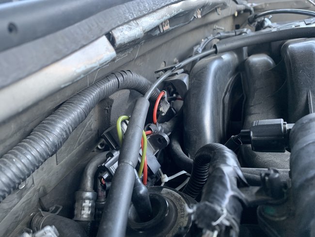

Yeah, that’s why I’m confused because it is so short so the only place for it to go is the firewall because it is connected to the back of the one that goes into the intake, but there is nothing for it to go to on the firewall. I don’t see it in any of those pictures either and I have everything plugged in from what I can see in those photos.
Feb 6, 2022 at 9:36 PM
ARIANADANIELLE5345
  • 402 POSTS
It attaches to the back of the one that goes where the white circle is.
Feb 6, 2022 at 9:43 PM
  • 110,244 POSTS
That is the main supply port. I just listed a question regarding this. I am hoping someone has a solution. Hang in there. If it is running well and there are no issues, it will be fine.
