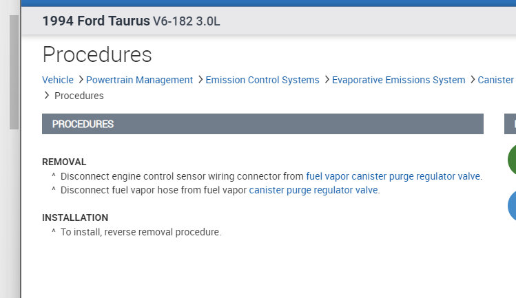

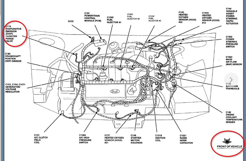

Thanks for the reply, and your experience! All I basically need is the location for both items on the car. Sorry, all I worked on in the past were printing presses and occasionally an oil change! Thanks again.
Apr 17, 2022 at 10:01 PM

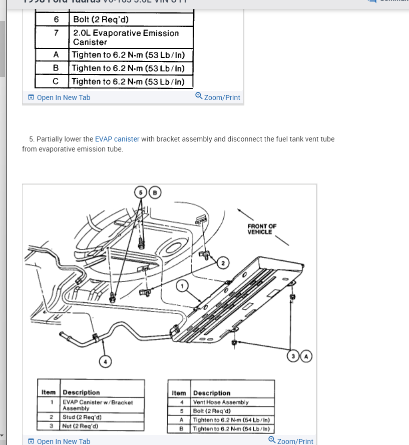

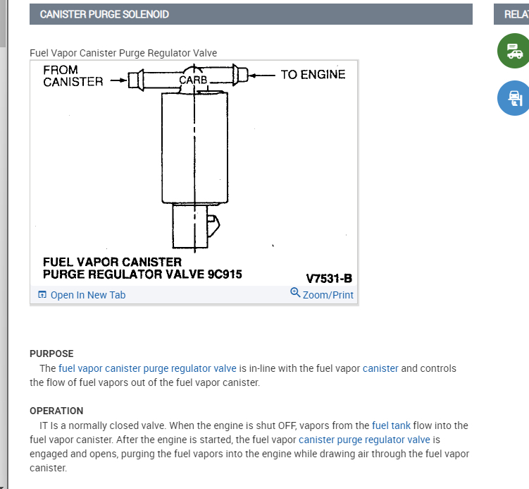

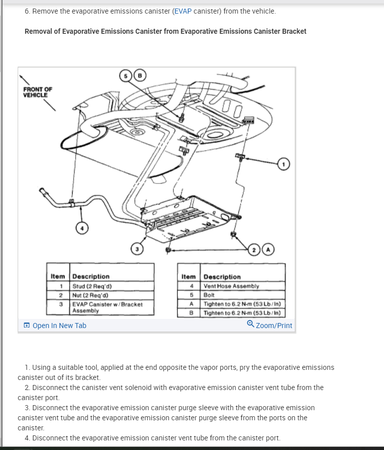

Got it. No problem.

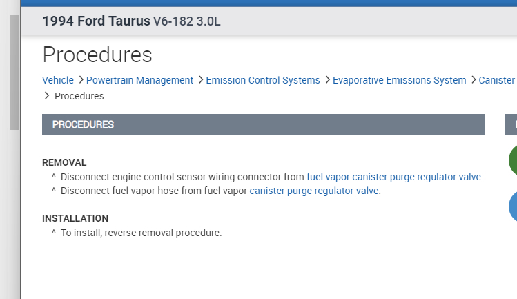

I am attaching info out of a 1998 3.0L because the manual for a 1994 does not show any location info.
However, these engines are going to be nearly identical because they were basically unchanged over the years.
So, take a look at this info and let me know if you still can't find them.
The solenoid is going to be on the passenger side of the engine towards the rear of it.
The canister is back under the vehicle by the fuel tank. This is easier to find because you will see lines running from the tank to the canister.
