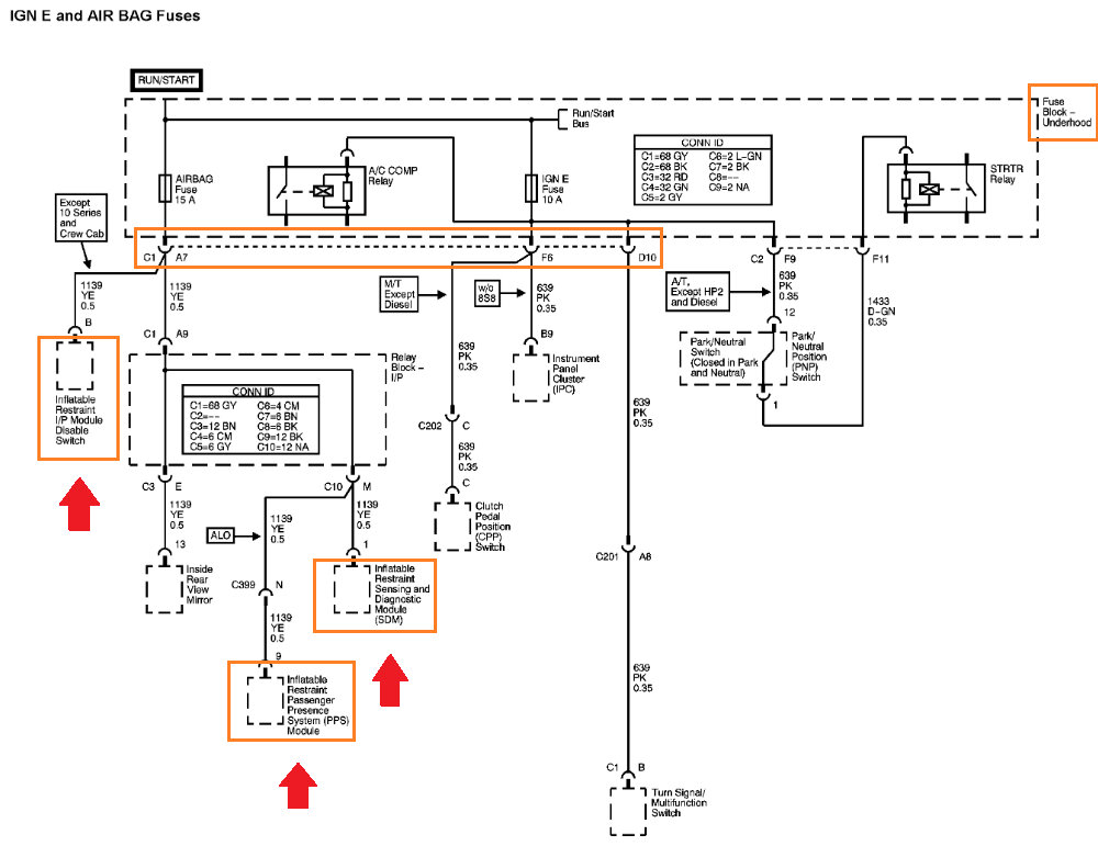

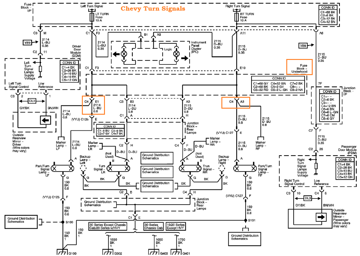

I had a rat chew a few wires in my under hood fuse block and I had to replace the c1 connector because the threads
Stripped.
While I was repinning the c1
I got distracted by someone and when I started repining again, I was interrupted again
As I was trying to repin wires.
We're mixed up and I'm need.
Help figuring out how to fix this problem.

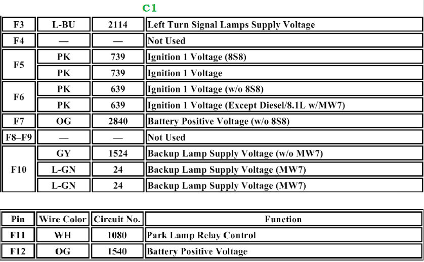

If I knew each module or sensor or whatever is in the c1
I could continuity test back the the fuse block a put back in the right pin location.
Any info on
Circuit, color wire , function, and what is the item is.
Thank you for your help.

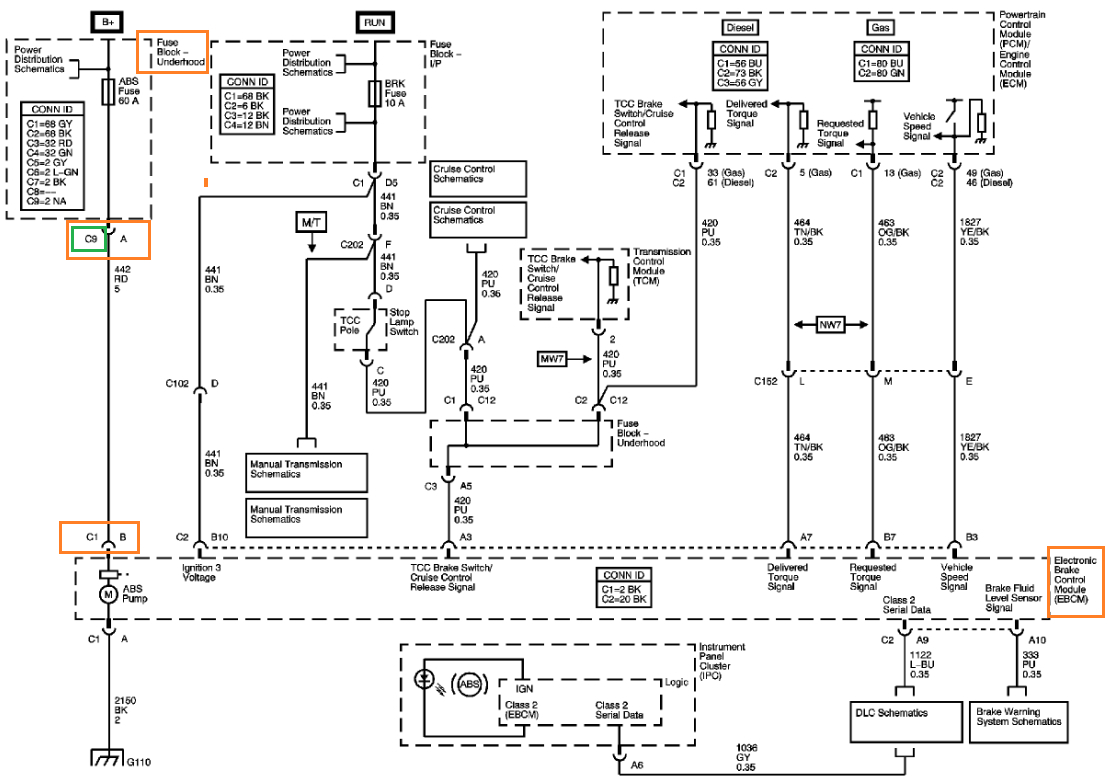

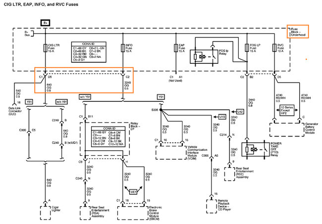

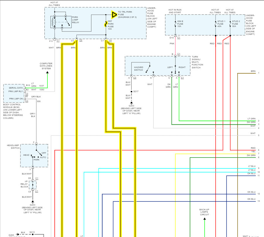

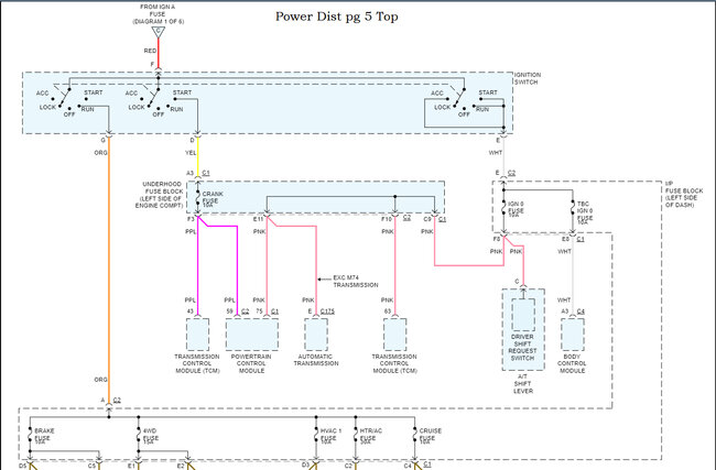

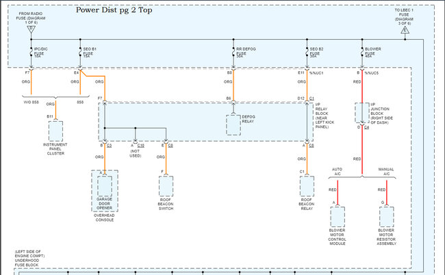

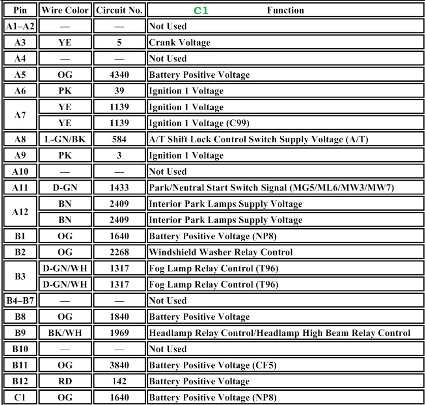

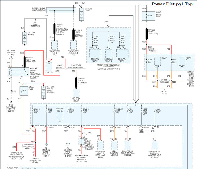

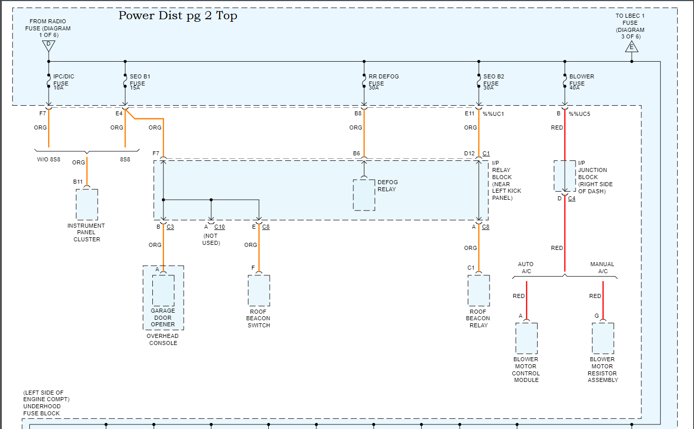

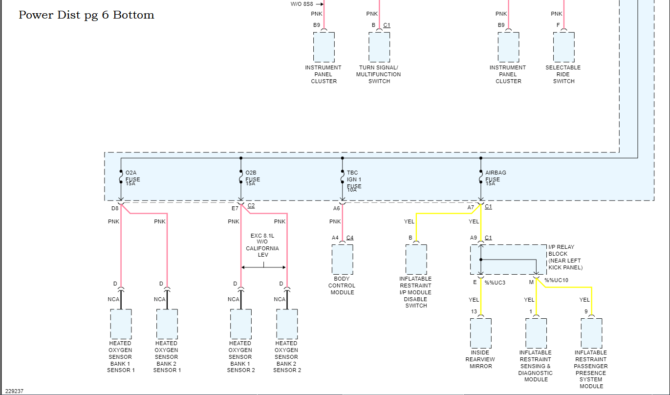

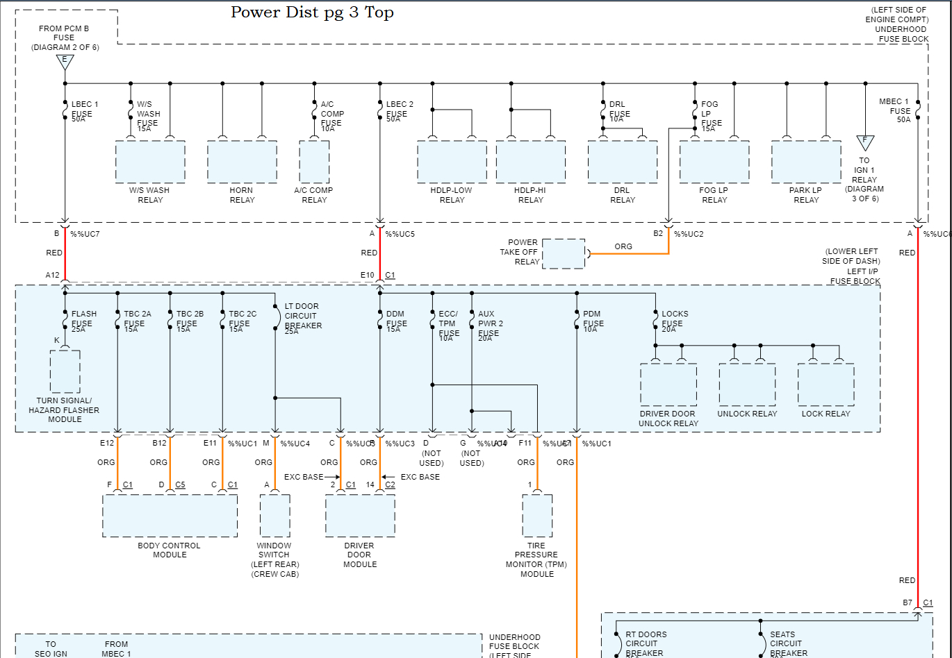

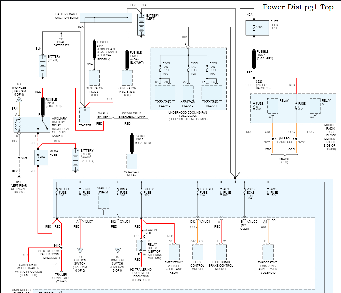

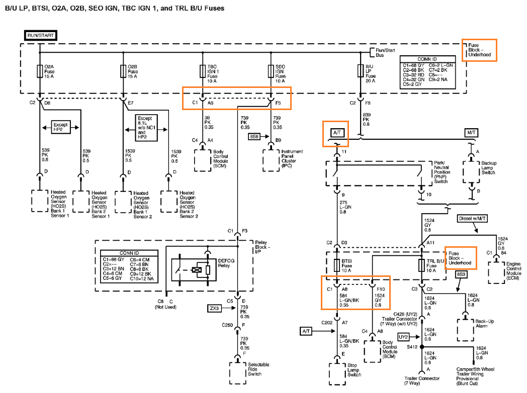

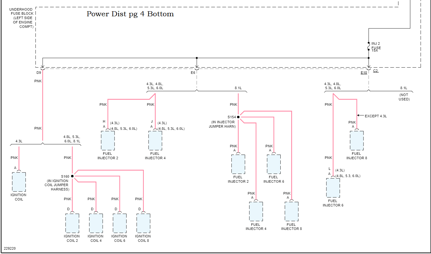

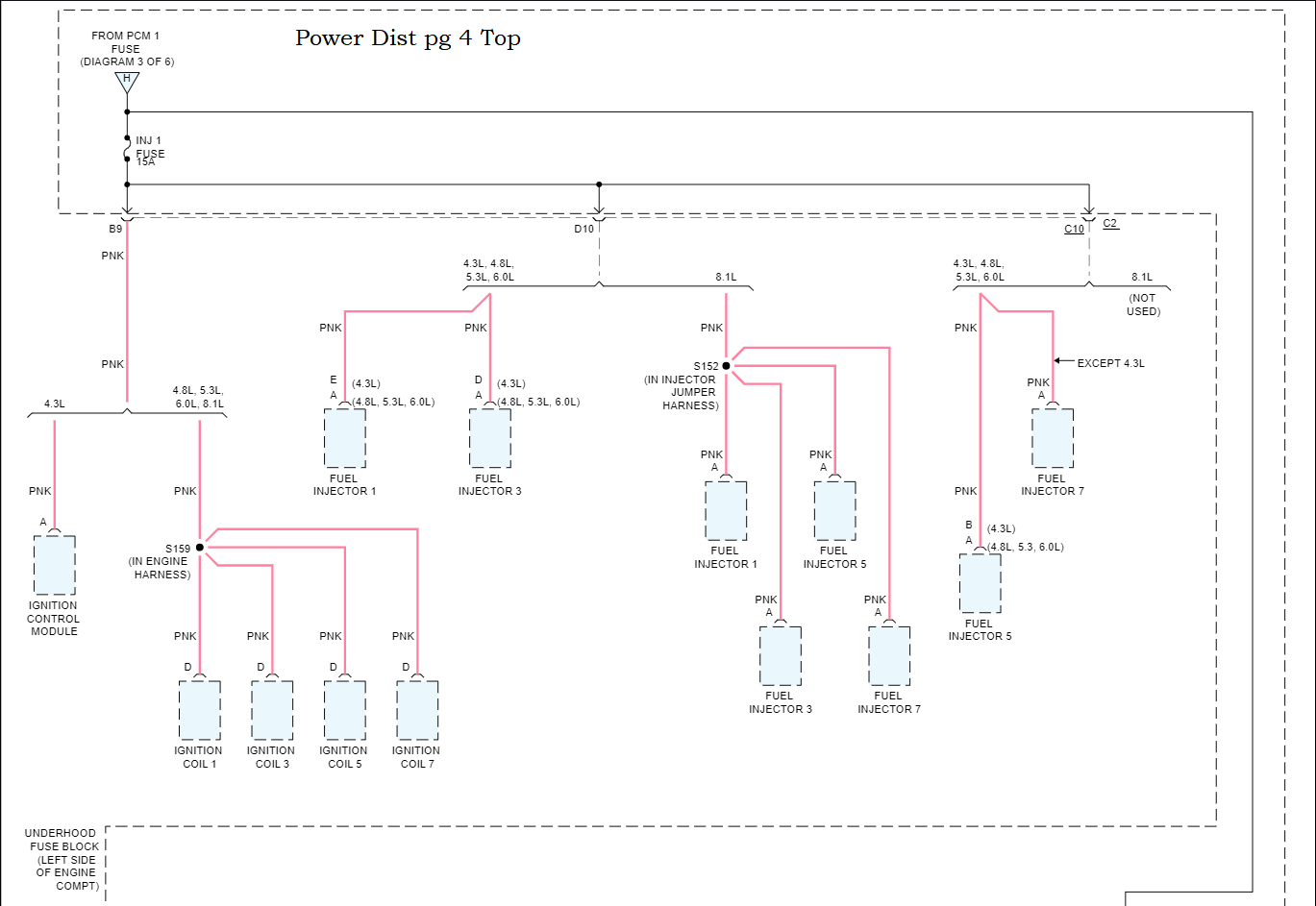

Hello, so, you need the power distribution diagrams for the entire engine compartment fuse block. I do have C1 pulled up here already for you ill post
They are all pretty much the same, but is this the 1500 series 6.0? And do you need more than just C1? Do you want C2-C7, C9 as well?

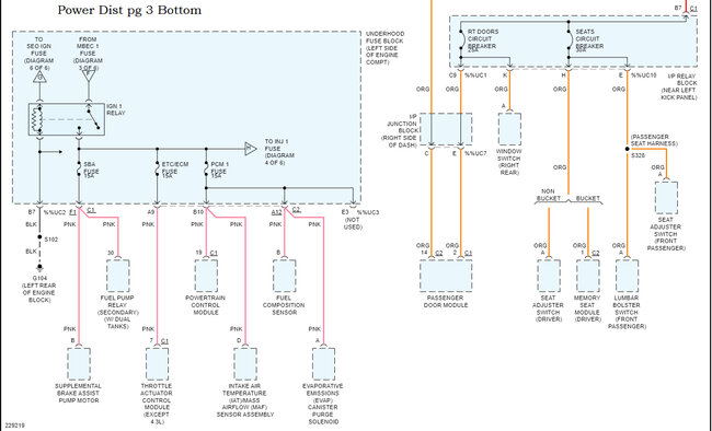

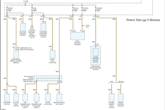

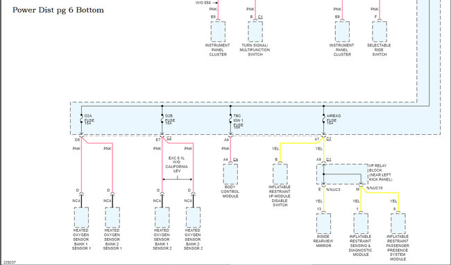

I'll post the Power Distribution diagrams as well, they aren't as specific, it shows the entire under hood fuse block with all its circuits, but they are all labelled with a connector ID.

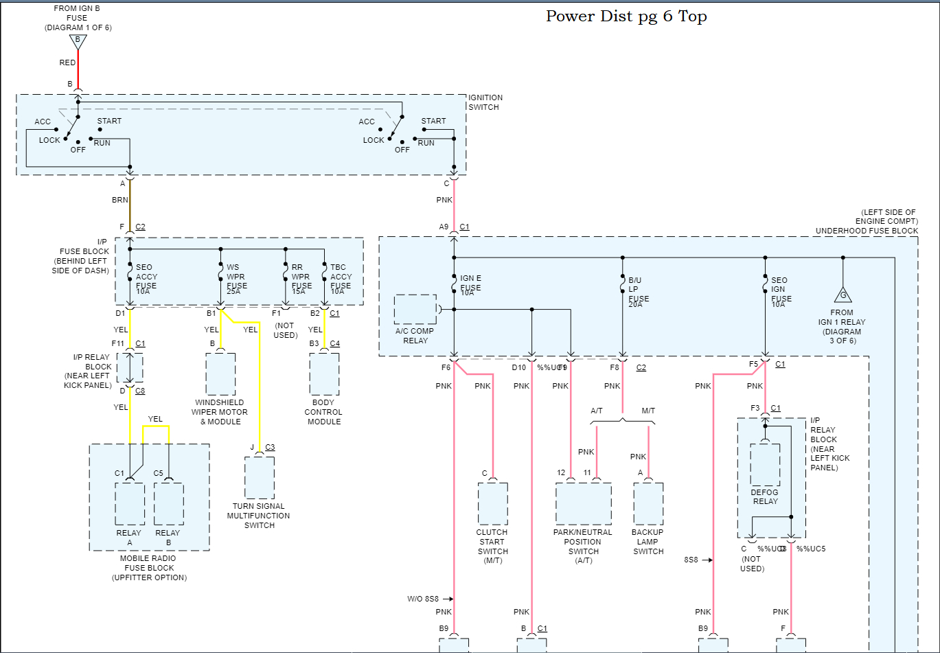

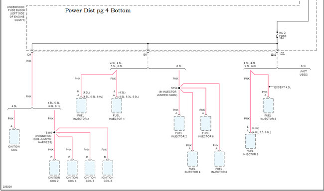

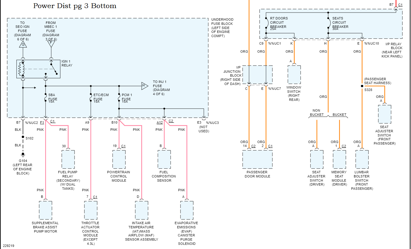

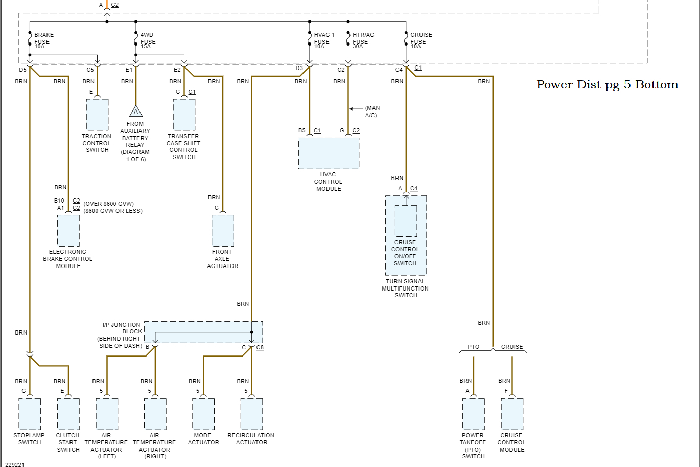

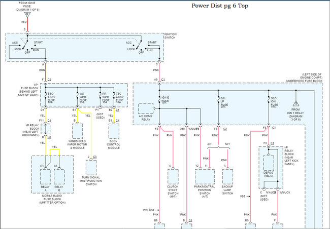

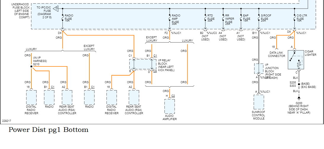

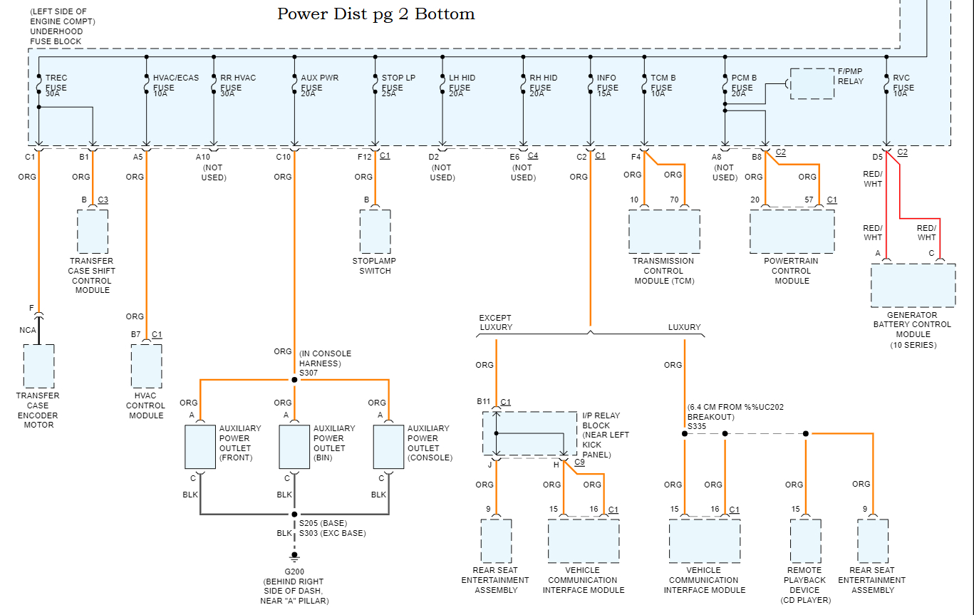

These are the Power Distribution diagrams, there 6 pages, but everything is marked Top and Bottom so you can print them out if needed and they will line up. I know how bad rodent damage can get, they love to eat the insulation on the wiring due to the chemicals in it. But let us know if you need anything else.

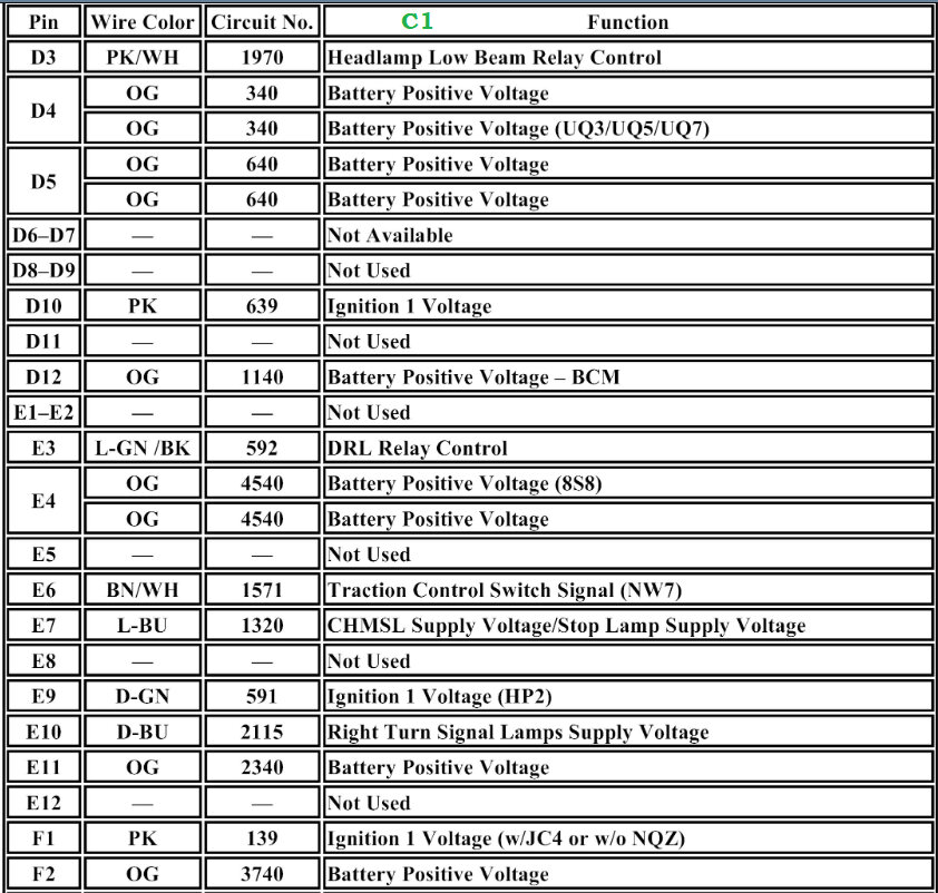

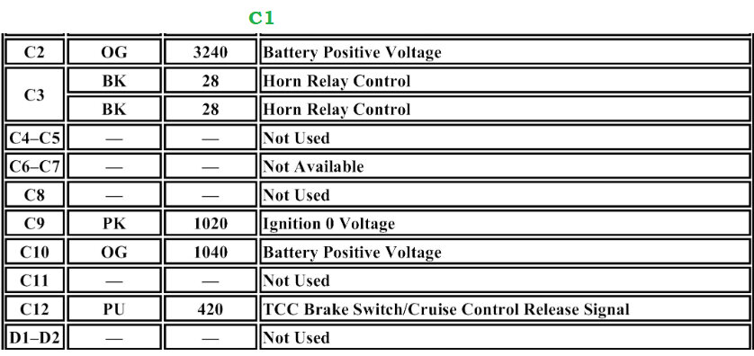

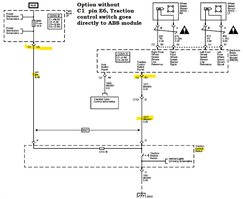

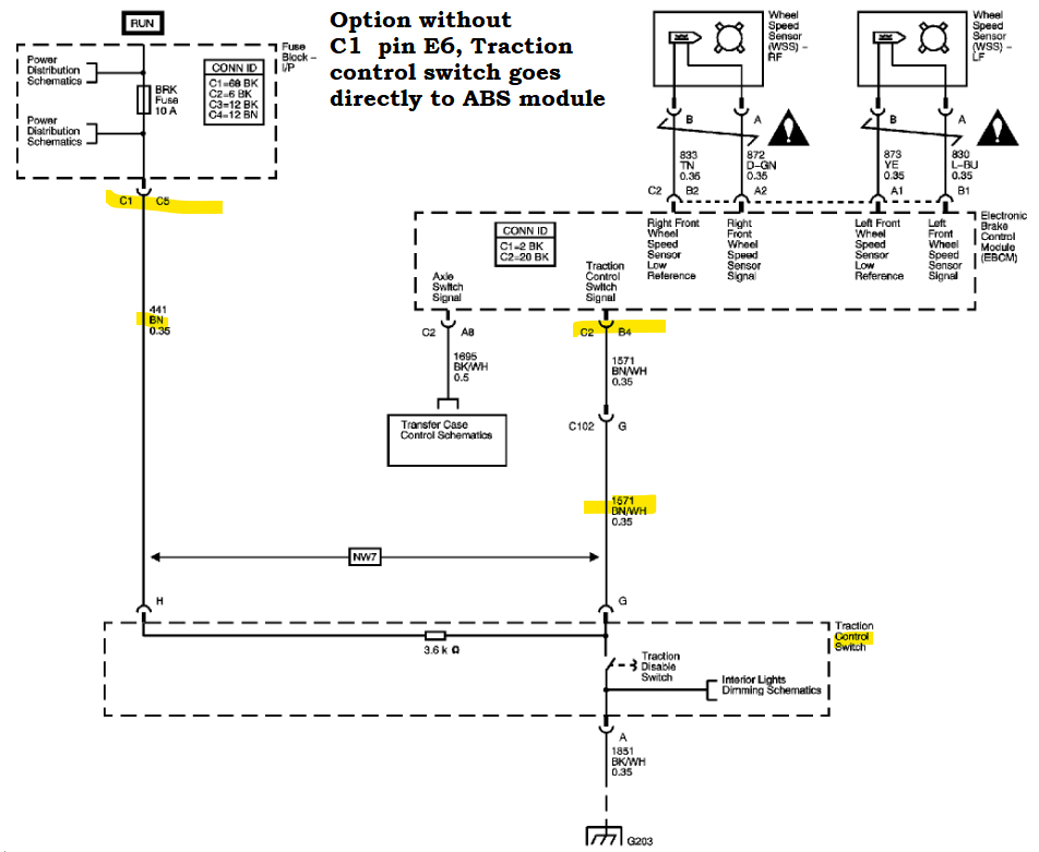

In the pinout description of circuits
Pin E6 brown/white
Circuit 1571
Traction control
There is or was no brown/white wire in the c1.
Oct 16, 2023 at 11:45 PM

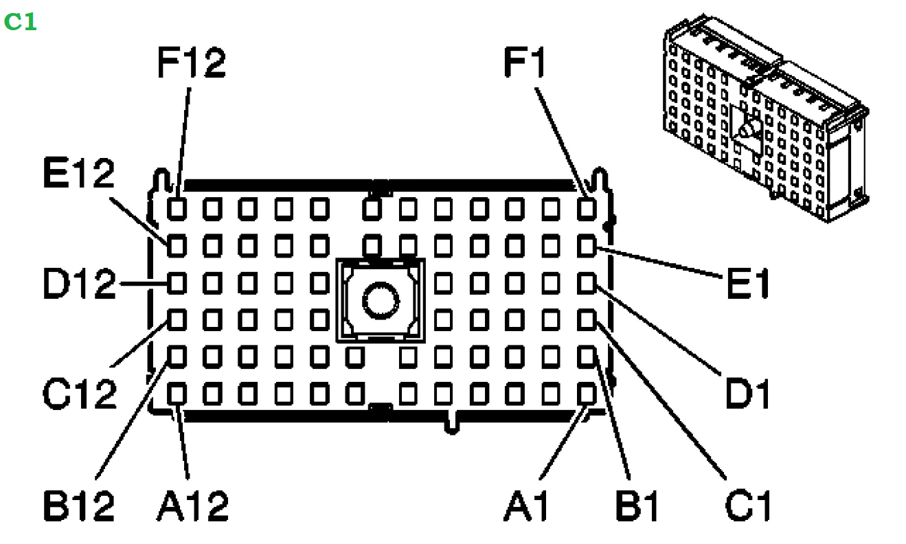

I can pull up the other connector pinouts for you, A1, A2, A3 etc.
What is your VIN, I can look that specific vehicle up by that, these are aftermarket diagrams from All Data as well, they don't get everything correct sometimes, but Ill check for some OEM diagrams.
Do you just need extra diagrams for exterior lighting?
The issue is there are multiple 06 Chevy Silverado 6.0 2wd. There are a couple different Vin numbers, I've been under 06 Chev Silverado 6.0L 2wd VIN N, there is also a VIN U. Most of the diagrams look exactly the same for both VINs but the OEM may differ somewhat, but I can pull up separate diagrams for each individual system.

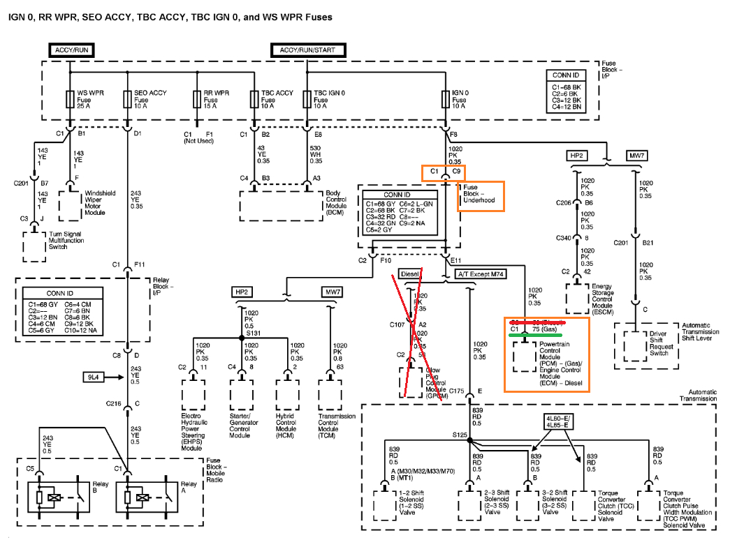

I do see the C1 E6 brown/white wire (Traction control switch), under the OEM diagrams for the ABS/Traction control it gives 2 options for the Traction control switch, the first does come from C1 E6 Under-Hood fuse panel (brown/white wire) and then a 2nd option which the Traction control switch signals directly to the ABS module, I'll post both diagrams showing the difference. Obviously, you would have the 2nd design without the C1 E6 pin.

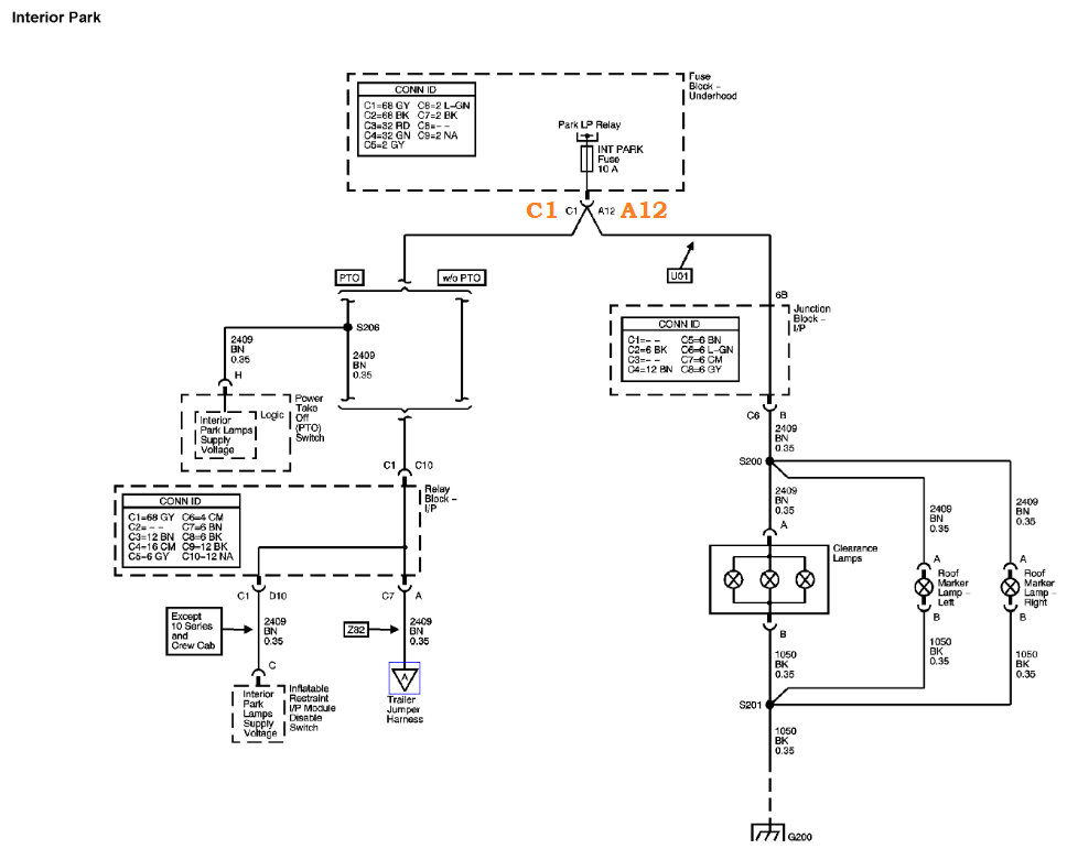

AL514
  • 5,700 POSTS

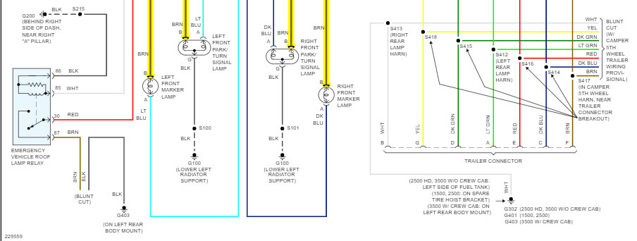

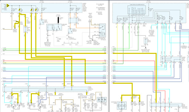

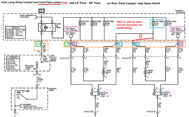

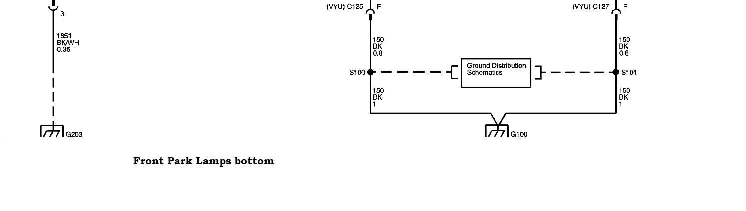

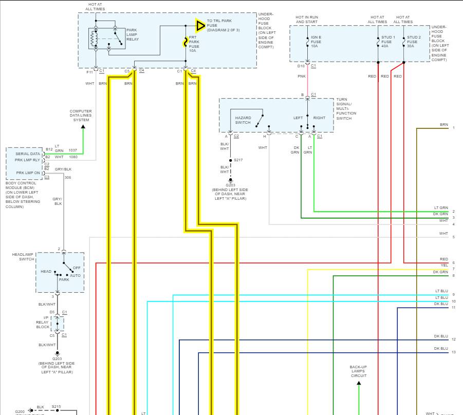

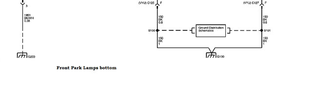

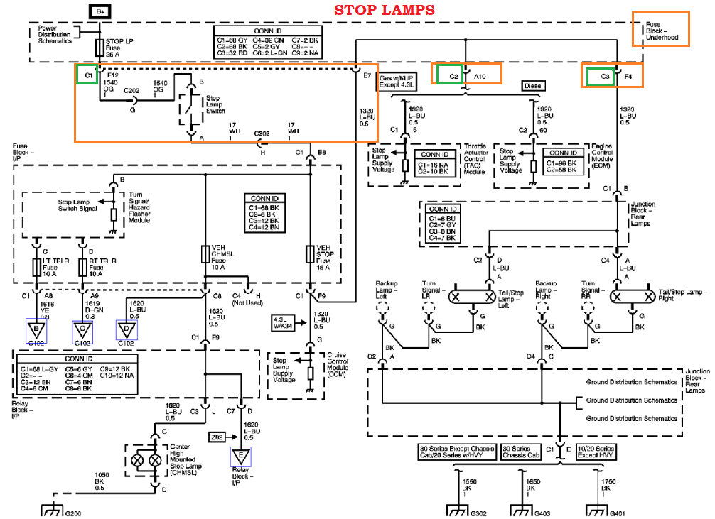

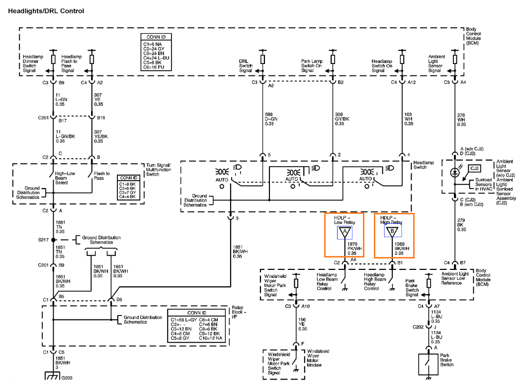

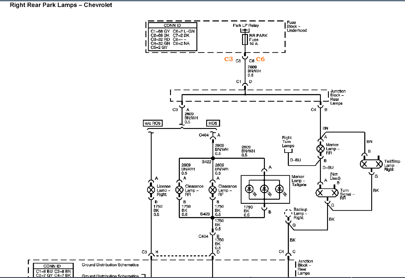

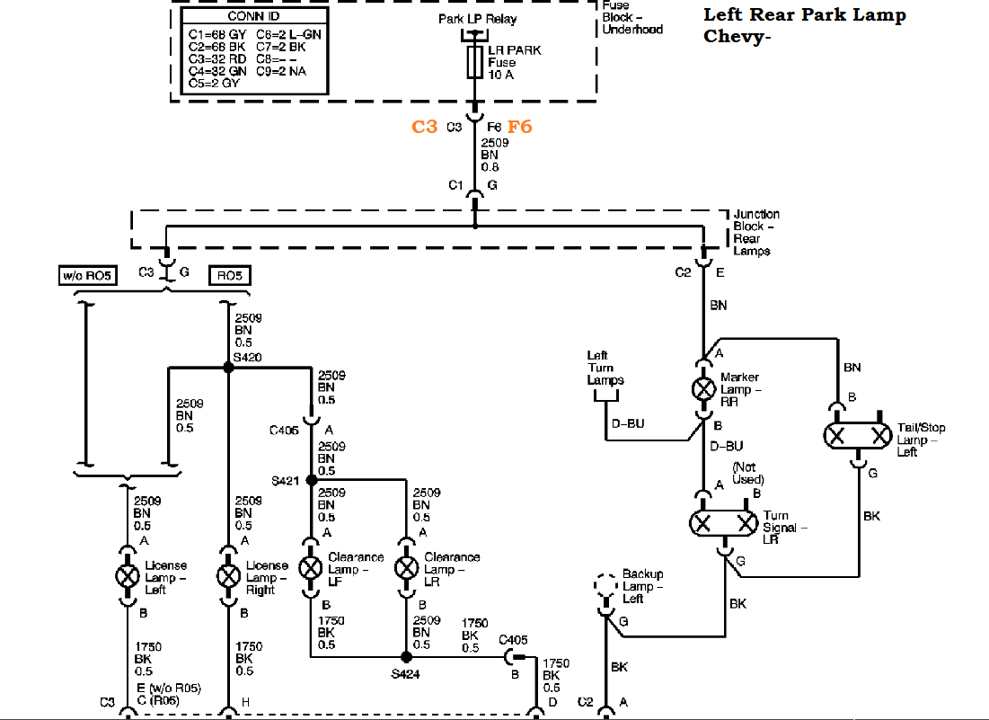

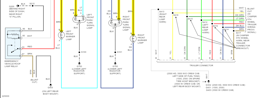

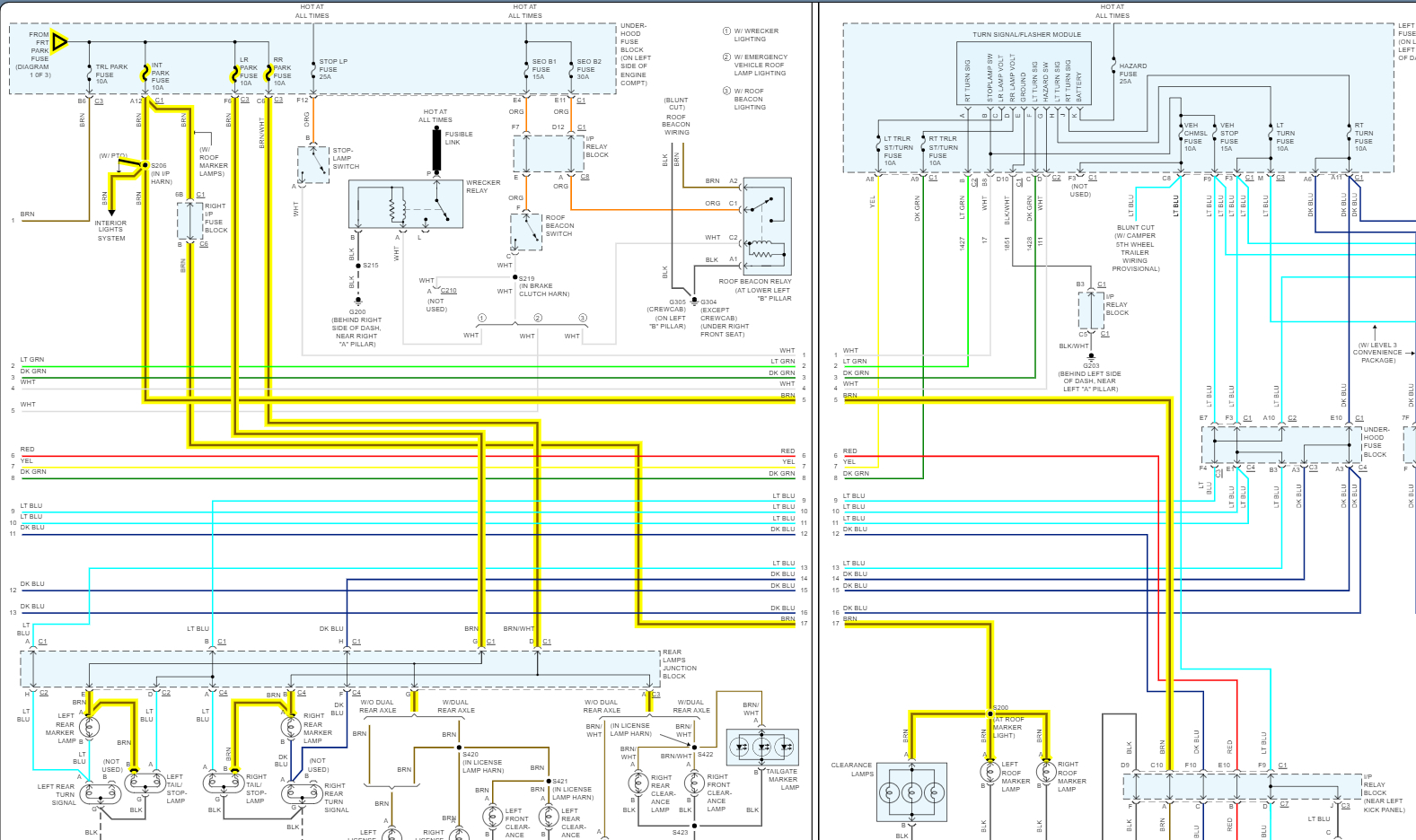

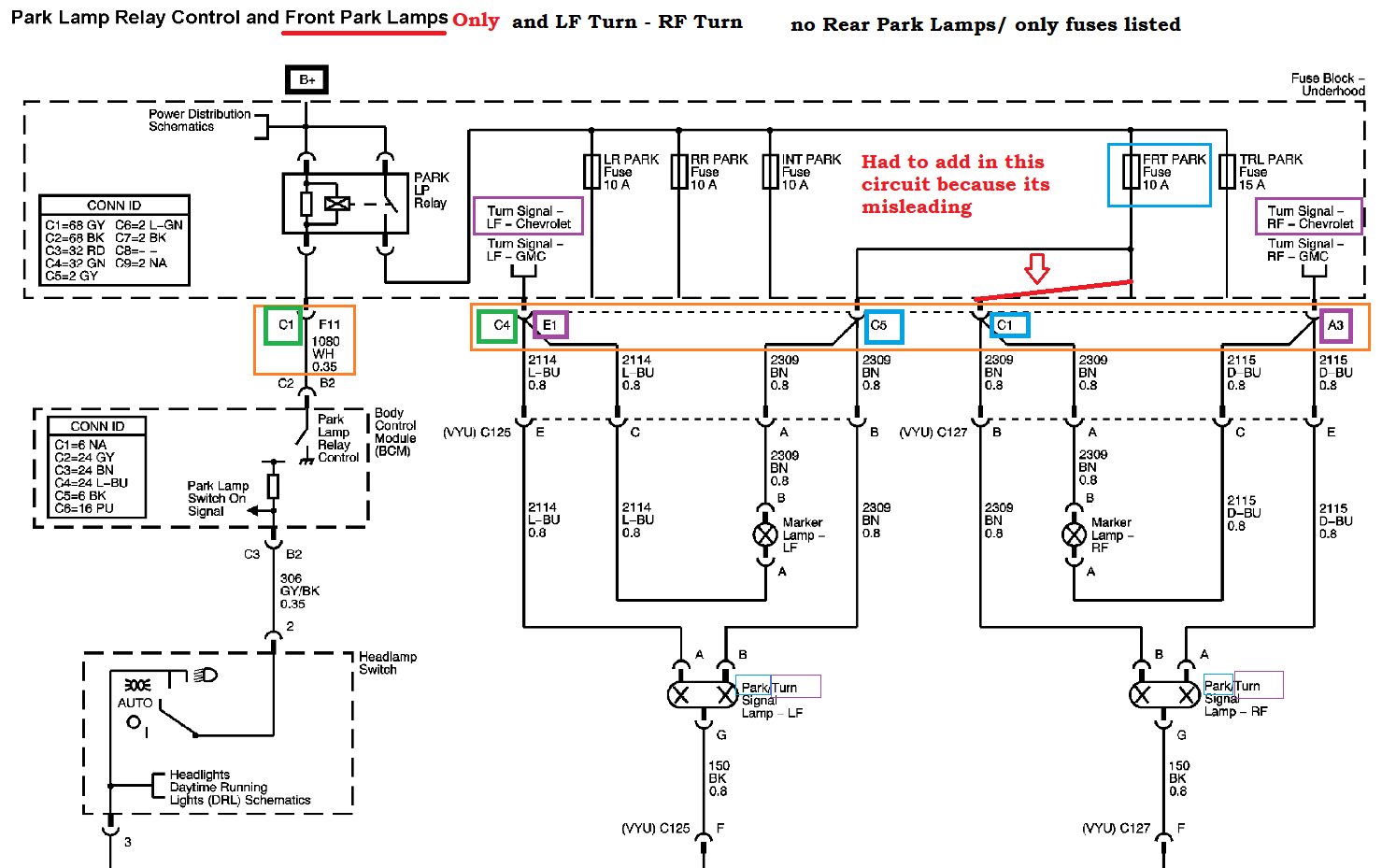

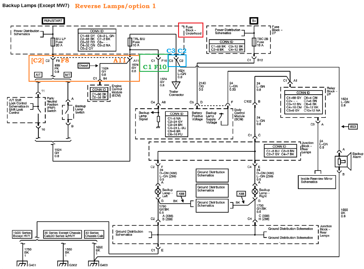

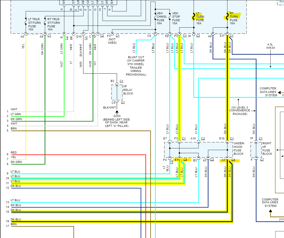

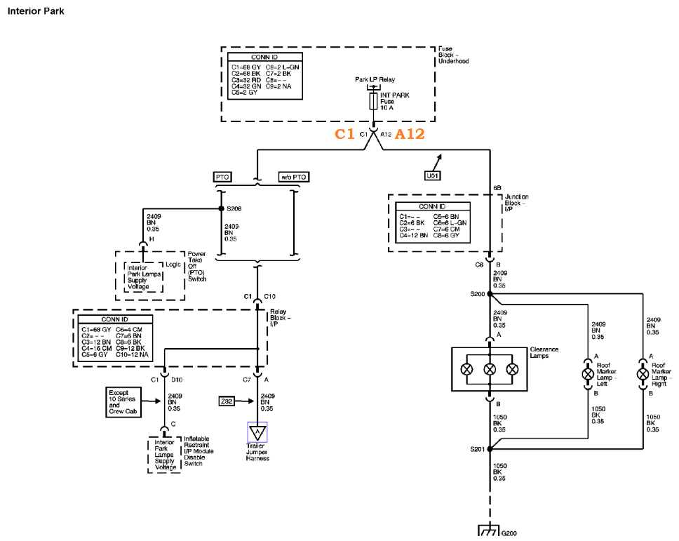

These first 4 diagrams (1-4) are only the Front Park Lamps, I added the OEM and aftermarket diagrams because they are misleading as you'll see.
Diagrams 5,6,7 are Internal Park Lamps, Left Rear Park, Right Rear Park lamps and 8 is the aftermarket diagram.
*Note on the Front Park lamp connectors C125 and C127 the (VYU) is the RPO code which is found on a RPO list somewhere on the vehicle, for different options each vehicle may or may not have. The owners manual may have the location of the RPO code in it, on cars it's usually in the trunk, so I'm not sure where it would be exactly on this truck.
Diagram 9 is Reverse Lamps, there was another option, but it looked to be Diesel.
Diagram 10 is Stop Lamps,

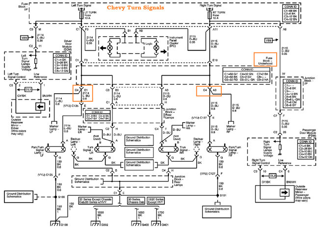

11 and 12 are Turn Signals, they had some listed as Chevy and GMC, so that's why its labelled as it is.
13 is the Traction Control Switch you must have, it's not coming from the Under-hood fuse panel, but the ABS module. That would explain why you are missing the C1 E6 wire.
14 is the rest of the Traction Control and ABS from the under-hood fuse panel.

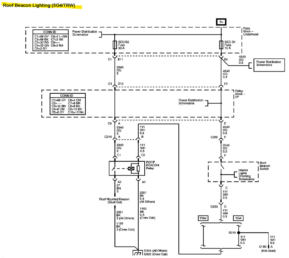

and finally, 15 is a Beacon Lighting option if you have that, it was coming from C1 E11 and E4 orange wire, so I added it, hopefully these are all correct.
Oct 17, 2023 at 5:01 AM

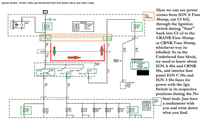

Another thing to keep in mind is pin tension in any connectors you have either unplugged or tested, loose pins can really send you down a rabbit hole while trying to diagnose intermittent issues like this. So, if you go to check pin tension on female pins, use something that is a little bit smaller than the male pin on the fuse box for example. If C1 has any loose female pins in that connector for whatever reason, they can sometimes make contact and sometimes not, depending on vibration, temperature, if the harness has been pulled on, etc. I will go over the C1 pinout again with this new VIN number and see if there are any differences now.
This is why we're having so much trouble here, your VIN comes up as a 2007, so it might be a later build date. I was just looking for your folder and I thought I had deleted it by accident, but it's labelled as a 06'. Although I don't see much difference in the C1 connector pinout yet, there is definitely a year difference.

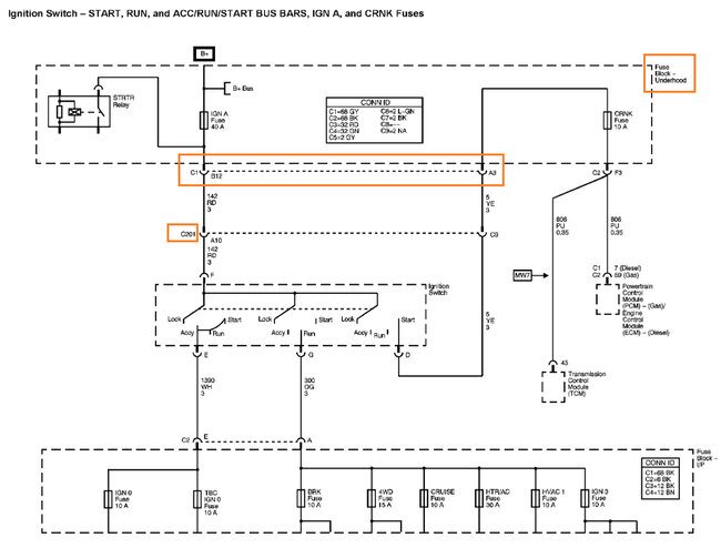

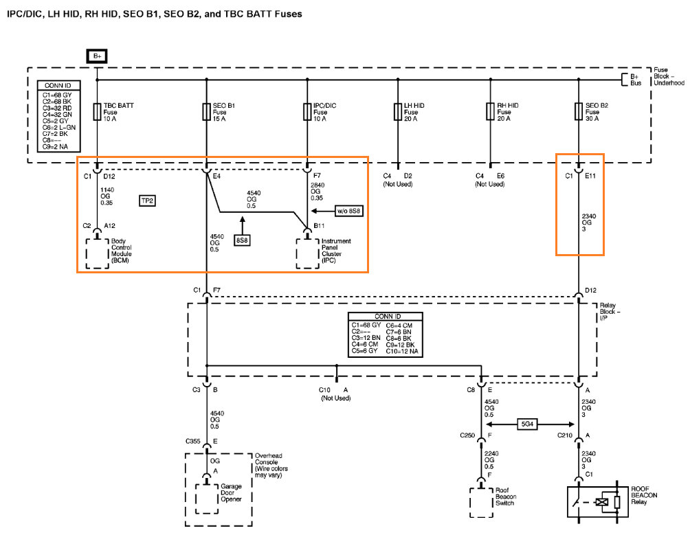

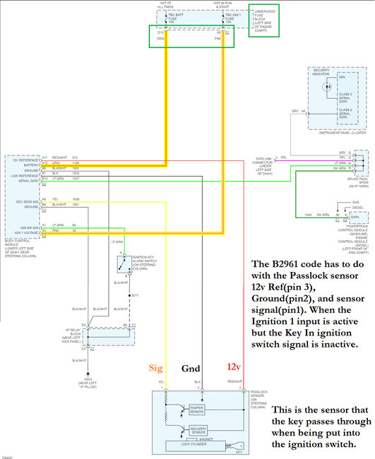

Okay, right away I see that the Charging system diagrams are showing the Instrument Cluster "IGN 1 VOLT" feed wire comes directly from the Under-hood fuse block C1 connector. It's one of the Clusters circuit board feeds, depending on what fuse you have listed in your vehicle, it's going to be from either IGN E Fuse 10amp C1 pin F6 or SEO IGN Fuse 10amp C1 pin F5. It's a pink wire. I'll double check this with the OEM charging system diagrams. So, I think you probably have some pin fitment issues or loose wires to those pins. maybe in a crimp connector or whatever it is you're using to connect the broken/chewed up wires with.
Oct 20, 2023 at 2:01 AM
AL514
  • 5,700 POSTS

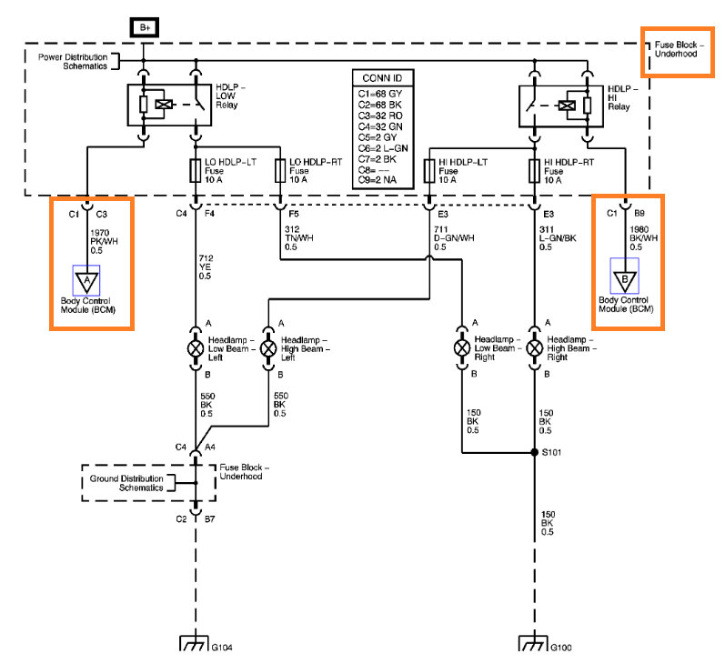

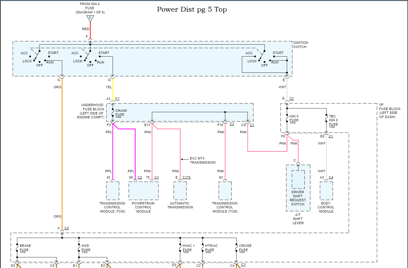

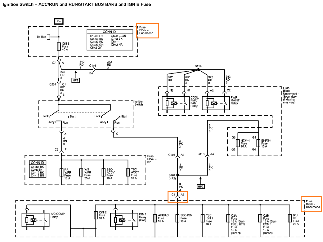

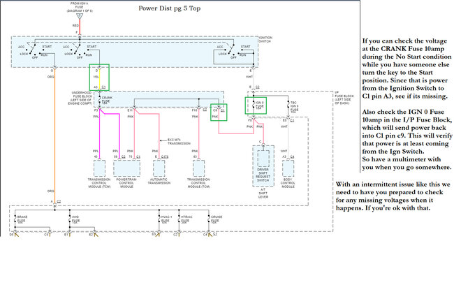

I've gone through all the power distribution diagrams that have the C1 connector, with pins that are related to the issues you're having. The 6th diagram has the feeds for the Airbag system, the others have to do with starting and a lot of other power feeds. I think that most of the problems might be related to the BCM losing power at some points, especially the headlamps, since the relays for the headlamps are controlled by the BCM. So, I would go through and make sure all the pins are tight in the connector. If there are still problems after the pins are all checked out, then back probing C1 when certain issues come up to see if there are power losses happening on any wires is the only way to find out what's actually being lost.
For example the headlamp relays are grounded through the BCM, so if they are not working, we can have you check at C1 pins B9 and C3 which are the headlamps High and Low beam relay control wires, so if they are still reading 12volts after turning on the headlamps, then the BCM is not grounding them, Those pins should go to 0volts when the relays are activated.
And for the Starting issue, you'll see some of the diagrams have Ignition Switch at the top and show which pins should have power coming out going to the ignition switch. But check for pin tension in C1 first and make sure your wires are correct.
Oct 20, 2023 at 6:21 AM

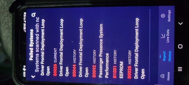

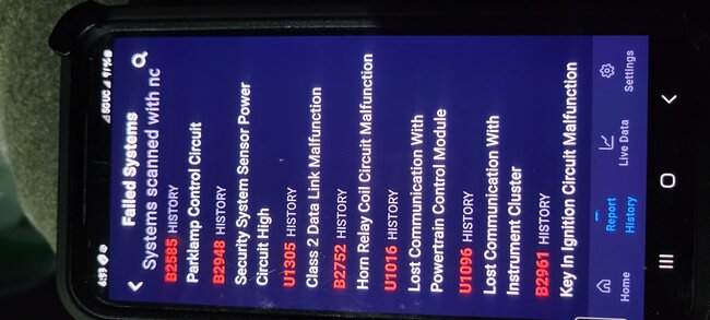

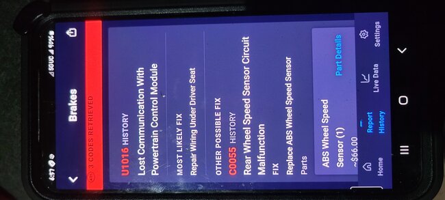

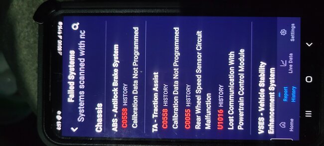

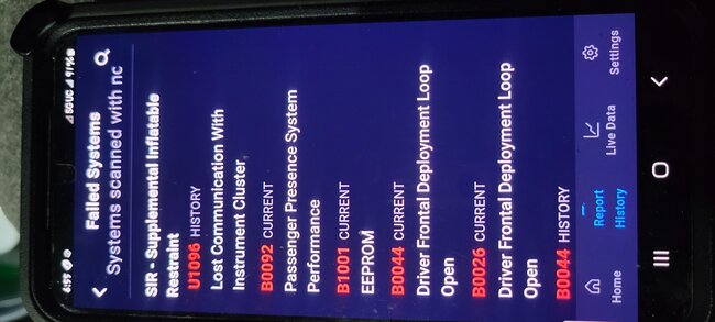

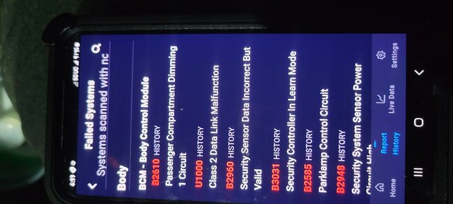

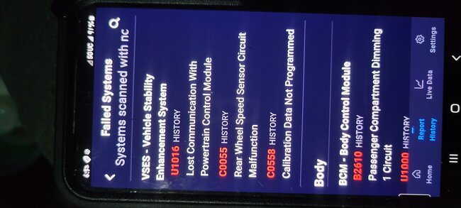

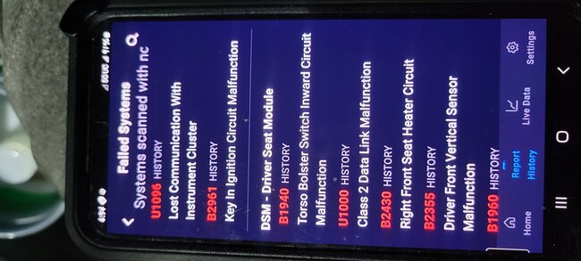

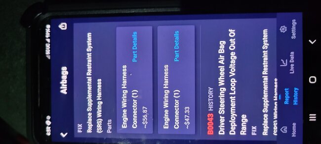

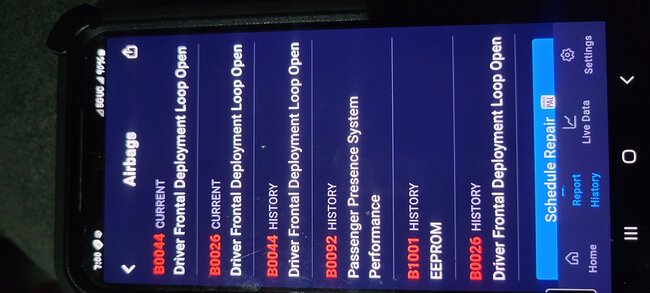

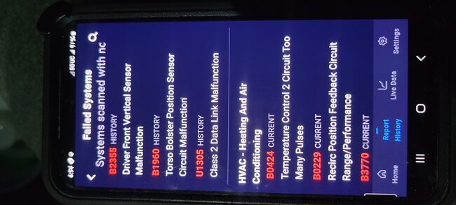

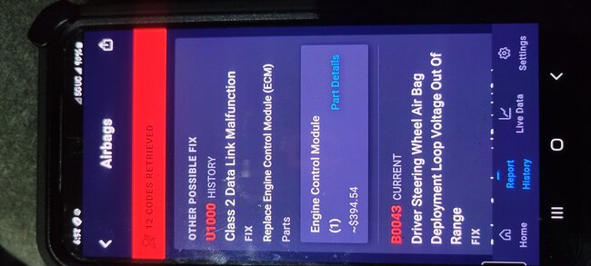

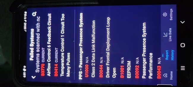

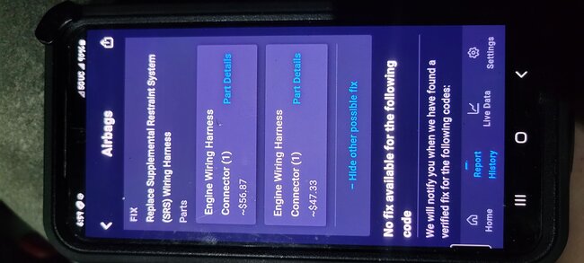

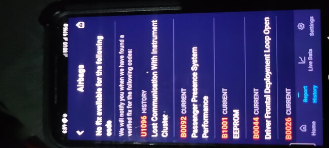

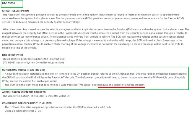

I'm sending you screen shots of my obd2( there was more but my Innova RS rest it's self.
Can you explain what the conn id boxes are for or mean?

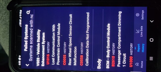

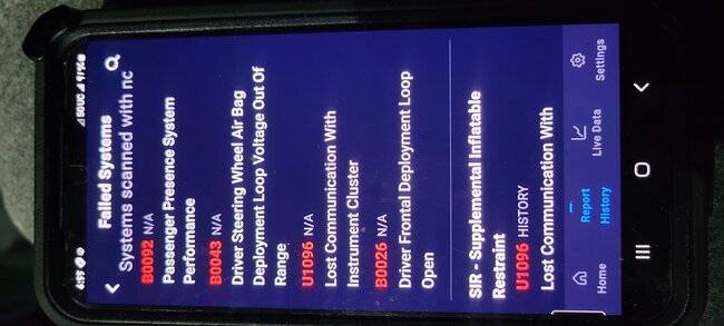

I'm sending you screenshots of my obd2 tool (there was more, but my Innova 5160RS reset itself).

I hope you got the pictures of the codes.
I have a couple questions,
What does conn id mean?

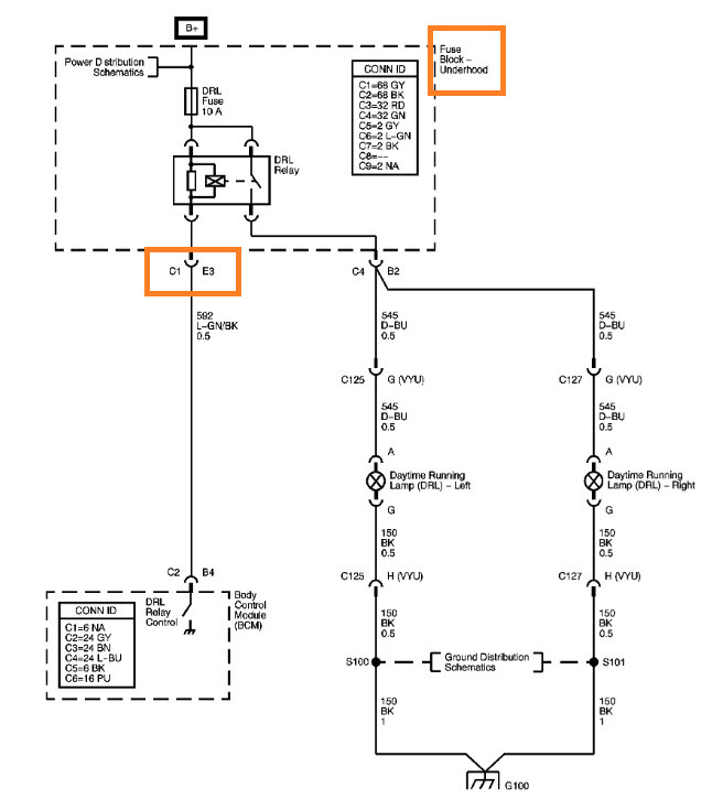

I don't see anything listed as "conn id" but I would assume that means connection ID. For the grounds you mentioned, that may refer to some as "Floating Ground" which is its own circuit and returns only to the specific module that is using a sensor (for example) that its ground only goes back to the module and not the battery negative. A normal Ground will end up back at the battery negative whereas a Floating Ground will be ground internal to the module, this is done to help with interference to the sensor.

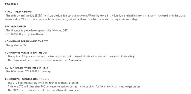

As for the codes, I've been going through them, and I see that most of them are History
codes, so that fault is not occurring right now.
And if I understand you correctly, did you swap out the entire engine wiring harness?
Because I can see that it causes a lot of issues, especially connector issues. These vehicles have a lot of problems, definitely when connectors have been pulled apart and reconnected more than a couple times.
But there are a lot of U1000 codes stored, those are communication codes for the vehicles network. I'm still going through them, but the BCM has lost communications codes for the PCM, Cluster, Class 2 Serial Data (which is the low-speed network). And these codes have to do with the "Key In Ignition circuit malfunction", "Security System Sensor power circuit high" Those type of faults will cause a no start condition. If the security system is not seeing the key in the ignition, it will not allow the vehicle to start.
We couldn't go after all these problems at once, there's just too many codes set. So, we would have to address one issue at a time, or we'll end up here back and forth for a year.
Any module that is setting a Lost Communications code, right away that code is the first to deal with in any situation. Other codes will be set for that module if it's not communicating on the network. There is just too much clutter here,
But clear all these codes out and see what comes back first. What codes are Current after these are cleared out.

The CONN ID box is on the diagrams from ALLDATA.

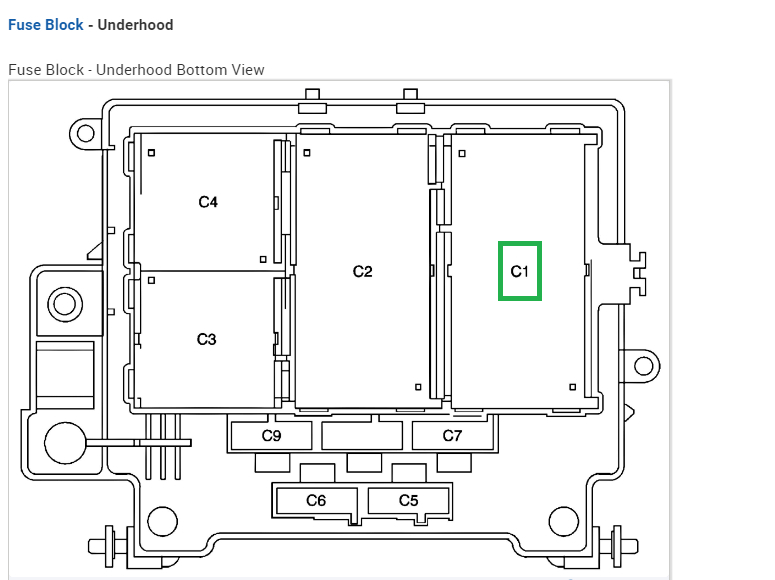

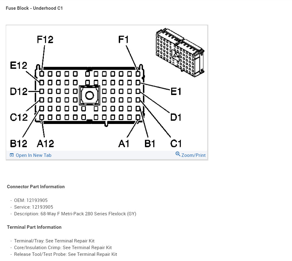

is the C1 connector, 68 pins, and its Grey in color.

Pin tension is going to be a huge factor here, many people dont really see it effecting things because connectors can snap into place and seem fine. But pin issues can cause these intermittent problems to come and go with temperature, humidity, how much the connector has been plugged back in, or the harness been moved around. We have entire kits of just connector pins that are all different sizes to check pin tension when intermittent problems act like this.
In your case, it looks like all of C1 pins should be the same size. So you'll want to find a pin thats a little bit smaller to be sure there is good contact inside that connector. I cant stress that enough.

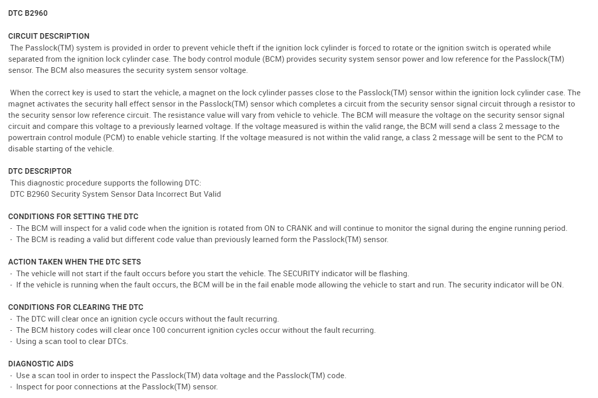

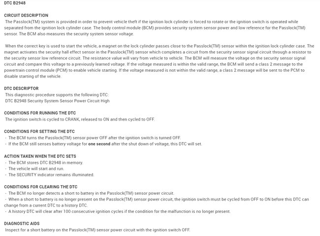

Some of the codes setting give us some direction already, such as the Ignition, key in ignition, security system, etc. Those right away will cause starting issues.
Especially when you describe driving for a bit then stopping and it wont restart. Thats heat causing things to expand, then contract, then you have a loose connector. Sorry for my long post here, but we need to find out what is causing the restarting issue first. All the lost comms codes and ones that come with it can all be power supply issues that just cause a domino effect. And there could be power supplies going to the wrong place as well, but we'll check those.

Hi al514,
I'm continuity testing the c1 and so far, they are correct.
í thinking about the if there could be damage on more wiring and since I'm checking and testing while going to checking and tracing and testing I should to other areas.
So, I'm looking for the diagrams and pinouts for the c luster, HVAC control module, the PCM, BCM, stereo, mbec ,lbec and c201 and clock spring.
I can give you the part #'s for those if you need.
I was wondering if you used the PCM, BCM, TCM and cluster, all from a similar vehicle a n d or same part numbers and installed in my vehicle would be able to use them in mine ?

Good evening,
To answer your question as to where I'm at with my demonic possessed truck.... It runs and drives but is still has an electrical diva fit. We are still currently in Washington State and trying desperately to move to Cherryville N.C. Hoping by the grace of God that you are located relatively close to our destination.
Nov 1, 2023 at 2:11 PM
AL514
  • 5,700 POSTS
We can communicate here, I'm staying on without pay so I can continue to help you and a couple other customers out. Your case is a rather difficult one, and I want to help you get this resolved. It looks like you will be 1:15min from me, so not terribly far.
Did you get to clear the codes out by chance and see what codes come back at just key On first? I know the starting issue is related to the Ignition switch sensor and ignition switch itself. There is a ring around the ignition switch where you put the key in and it reacts to the magnetic field that the key produces when put into the switch. A Hall Effect sensor reacts to magnetic fields and sends a signal that the key is being put into the switch. I'm just going by the codes that had set, and parts of the ignition switch seem to be losing the 12v feed, which comes from C1. So, I think that is what is causing the restart issue.
These trucks are known for the ignition switch itself getting hot in some cases and the pins in the connector loosen up. I have seen that happen. The trick here is catching the circuit that is losing power or lower than normal voltage, which will cause modules to do all kinds of strange things. The interior lights losing power is most likely going to be all related. You still have the old BCM just in case, I hope.
Are you still getting the situation where you get stuck somewhere after a drive? When that restart issue happens is when we need to find out which wire power is missing from. Low or complete voltage loss is what is probably causing the "U" communication codes. Once a module loses its voltage feed, anything connected to that module goes down too. Which is why so many codes are setting.
So, if you can be prepared somewhat to take some voltage readings when the no start condition happens, that will really give us some direction. But circuit codes will set when the key is turned to just the on position, because modules will be monitoring circuits at that point. I have to go through your folder again, but I do remember seeing a lot of Cluster loss communication codes set in other modules. Let me know what codes are setting after clearing them all out, and just turn the key on to begin with.
Here are some fuses to check when it won't start, since this happens after you drive for a bit, you could even try letting the vehicle run at home for a half hour and see if that is enough to duplicate the fault.

Good evening,
I'm 1chevyssguy Fiancé Cherie, and I'm going to fill you in on a few gaps that are missing, so we are up to speed on our current Divas electrical issues.
The very first thing that set us on this nightmare was the airbag light came on. Ran a scan and clock spring needed replaced. Bought, installed and after that it's been a sporadic electrical nightmare. Interior lights would flicker 3 times, steering wheel controls stopped working, MIL light would come on but no codes. Cluster would do weird things but come to find out these cluster are notorious for failing. Replaced last year right around time of rat chew problem. BCM, Clock spring, Cluster, Engine fuse block and C1 part of fuse block replaced. C1 wring was replaced/fixed. Few other things... Sensors, throttle body, center console wiring harness, rewired the main engine grounds. Battery, alternator (shops said alternator was bad, but we don't really think was). The truck voltage was always at 14.5 until alternator was replaced, now it won't go past 13.5
Starter was replaced and that was an issue (not on our part). Starter was replaced but the truck wouldn't start. Looked through everything and truck would only crank but no start. Come to find out when Starter come out, it kind of slipped and broke 2 wires off the crankshaft position sensor. Well, someone stopped to help us and he connected them back together but switched the wires fuel to him being colorblind (found that out later). Truck started and he accidentally zapped the battery pretty darn good with a wrench and put a nice weld chunk in the wench. We were mobile but the truck didn't quite run right. Had a stumble, finally replaced Crankshaft position sensor and that's when we found the crossed repaired wires. Not sure what kind of actual damage that could've/did cause or if it's part of our issue now. Transmission was replaced at the end of April this year. Wiring still isn't 100% and need it to be. Seems as though we haven't made it worse considering we're doing this by ourselves with very little electrical knowledge. Issues are still arising... sometimes we have high beams then we don't, but we do have flash to pass. Battery light is constantly on, MIL code but no MIL light. On/off P0455 code. Ignition housing was replaced, we are thinking the cylinder itself needs replaced (cylinder is slightly loose but tumblers are fine).
Just one question on my part. (I know the answer, but my head is tired), what engine grounds should go where and in what sequence? Battery to alternator/starter, then frame, engine, chassis? I feel like my IQ drops 1 point every time we open the hood.
Oh, and I was able to write down quite a few of the codes before the Innova software update that wiped our codes from the scan tool, if that does help with anything.
Again, thank you so very much. We owe you so very much and it's greatly appreciated.

Okay, just to keep things simple and not spiral out of control here. I think a lot of sections of wiring harness have been replaced that may not have needed to be. And I've stated this before, the harness connectors are not designed to be unplugged and reconnected more than a few times during the life of the vehicle. It causes the pins in the connectors to loosen up creating poor connections. I'm not sure why the dash harness was replaced, but this case has been going on for a very long time now. With lights flickering and things coming and going, you won't be able to figure everything out at one time, there is no overall grand fix for these issues. Too much has been messed with and replaced.
Let's just start with the Alternator for instance. I'm willing to bet anything it's a remanufactured alternator from AutoZone or some other aftermarket place. And as you stated, it's not charging over 13.5, that's not good. Sounds like a junk alternator. If it is putting out any AC voltage due to a bad diode inside, it will eventually cause the ECM to do all kinds of strange things, and then fail. The Alternator has a pack of diodes that rectify the AC voltage is produces into DC voltage that the vehicles modules can work off of. i didn't know if it was replaced or about the battery being shorted out.
Your Fiancé had mentioned that starting issue was the biggest concern because you're trying to get here to NC. So, we need to concentrate on that first. You guys are way down the rabbit hole on this as we would call it.
Now whatever code set that caused you to replace the Clock Spring, it was most likely not the problem, I'm sure the SRS light is still on. There are TSB (Technical Service Bulletins) on the SRS setting codes and the issue is connector problems that are not even near the steering column. Never replace a component because of a code. The circuit needs to be checked first. I have a huge list of codes from your vehicle already and many of them begin with a U1000 code or one like it. Which is a network communications code. If a module is not communicating, everything that has to do with that module will set codes as well. Reestablishing communication is the first step when a communication code sets. Then if there are still codes for that module, you deal with those after.
Start Here:
If there are codes stored, write them down with the date so you have a record, clear them all out. And do a full system scan with just the key on engine off for right now. Thats the first thing, modules will be monitoring circuits when first powered up.
Next check what battery voltage is with nothing on. Just to know if the battery is holding a charge. Should be at least 12.6v minimum.
And next check for any AC voltage ripple with the red meter lead on the Alternator post and the other meter lead on battery negative and meter set on AC voltage. Check it at idle, then check it at 1500rpm. write it down. It should not be more that 50mv (0.05v) If there is excessive AC voltage. right away that's a problem.
I will check for your replies at least once a day. . But I would like to help you get to NC. You'll only be a little over an hour from me then. I did give your fiancé a list of wires to check for voltage on C1 when the no Start condition occurs based on some of the previous codes that set having to do with the ignition circuits. I think there are possibly some connector pins that are not making good contact. C1 feeds a lot of the ignition switch circuits power. Sorry for the long post, but we haven't gotten anywhere with these issues yet.
