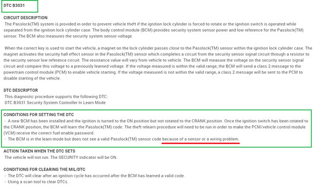

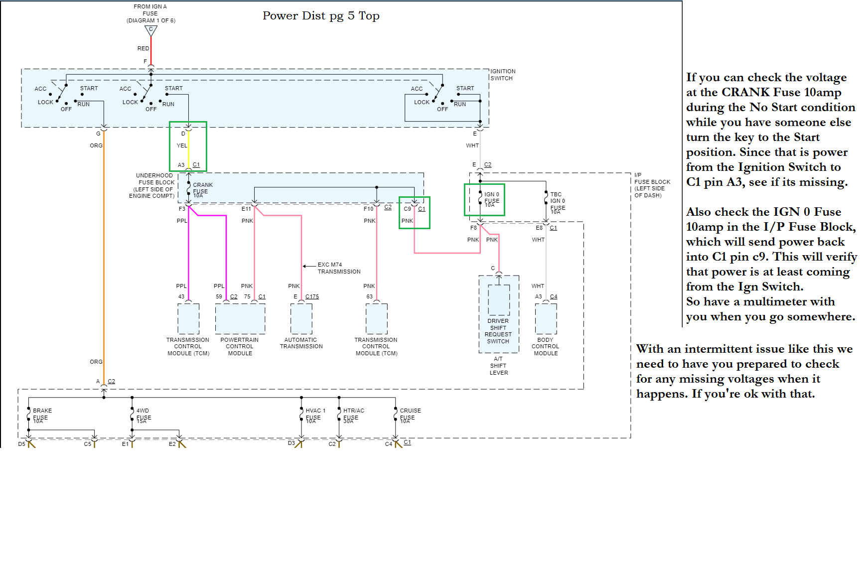

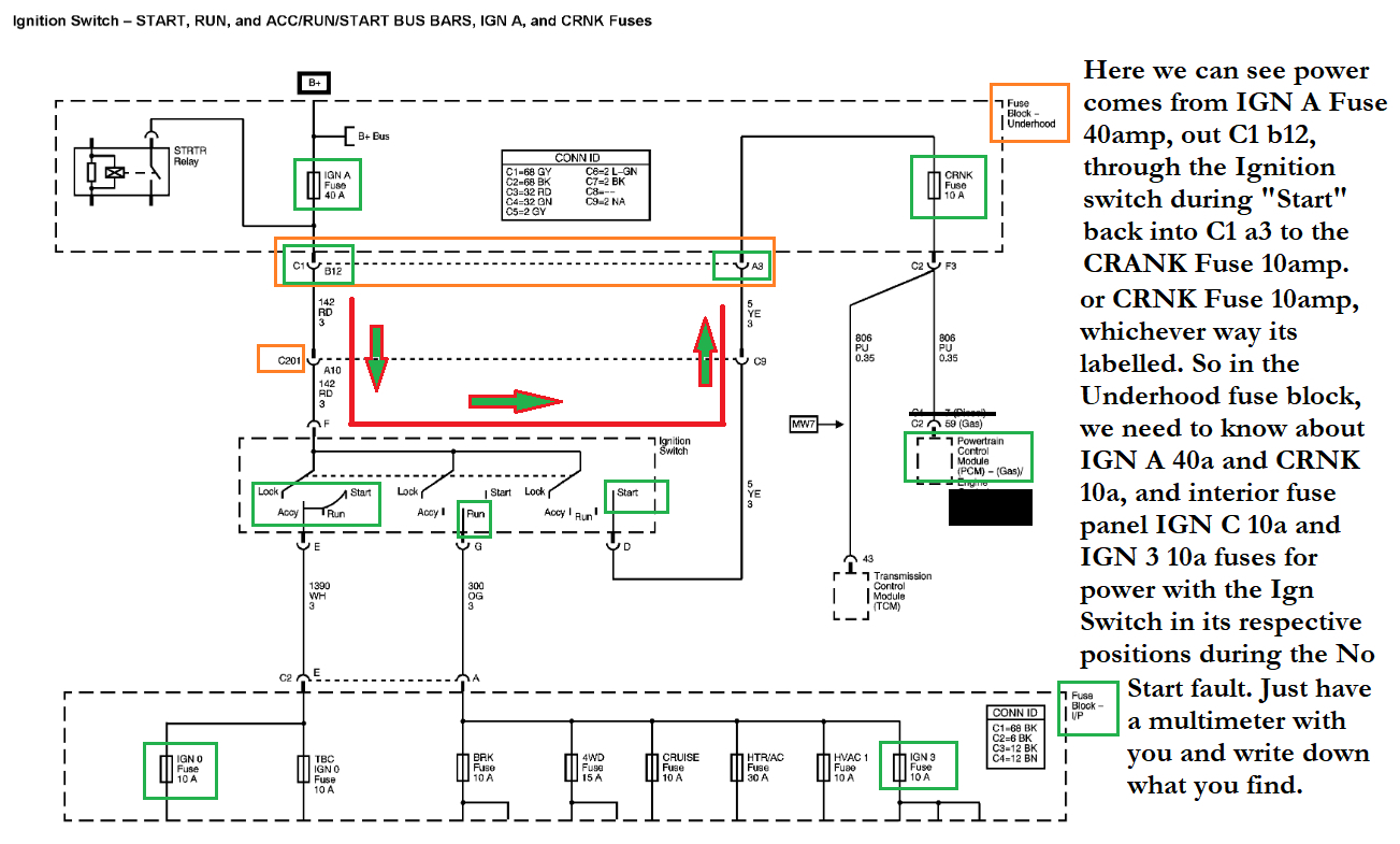

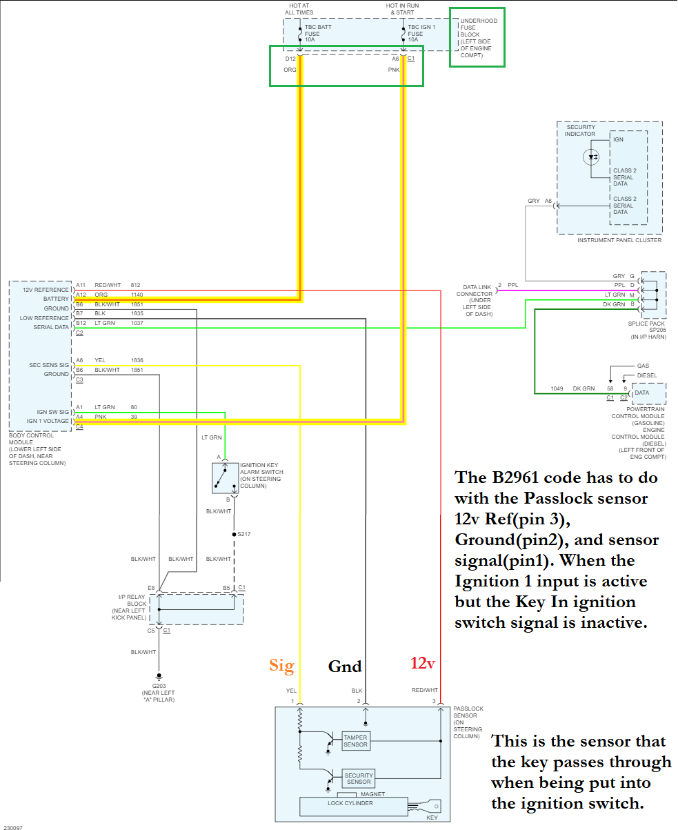

Did you get to clear the codes out by chance and see what codes come back at just key On first? I know the starting issue is related to the Ignition switch sensor and ignition switch itself. There is a ring around the ignition switch where you put the key in and it reacts to the magnetic field that the key produces when put into the switch. A Hall Effect sensor reacts to magnetic fields and sends a signal that the key is being put into the switch. I'm just going by the codes that had set, and parts of the ignition switch seem to be losing the 12v feed, which comes from C1. So, I think that is what is causing the restart issue.
These trucks are known for the ignition switch itself getting hot in some cases and the pins in the connector loosen up. I have seen that happen. The trick here is catching the circuit that is losing power or lower than normal voltage, which will cause modules to do all kinds of strange things. The interior lights losing power is most likely going to be all related. You still have the old BCM just in case, I hope.
Are you still getting the situation where you get stuck somewhere after a drive? When that restart issue happens is when we need to find out which wire power is missing from. Low or complete voltage loss is what is probably causing the "U" communication codes. Once a module loses its voltage feed, anything connected to that module goes down too. Which is why so many codes are setting.
So, if you can be prepared somewhat to take some voltage readings when the no start condition happens, that will really give us some direction. But circuit codes will set when the key is turned to just the on position, because modules will be monitoring circuits at that point. I have to go through your folder again, but I do remember seeing a lot of Cluster loss communication codes set in other modules. Let me know what codes are setting after clearing them all out, and just turn the key on to begin with.
Here are some fuses to check when it won't start, since this happens after you drive for a bit, you could even try letting the vehicle run at home for a half hour and see if that is enough to duplicate the fault.

I will check for your replies at least once a day.. But I would like to help you get to NC. You'll only be a little over an hour from me then. I did give your fiancé a list of wires to check for voltage on C1 when the no Start condition occurs based on some of the previous codes that set having to do with the ignition circuits. I think there are possibly some connector pins that are not making good contact. C1 feeds a lot of the ignition switch circuits power. Sorry for the long post, but we haven't gotten anywhere with these issues yet.
